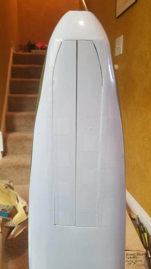

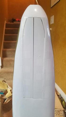

  • Tim Anderson
    Nice job on the gear doors guys! Something to ad to my to do list, thanks for posting. Mine is getting closer now still always to go…

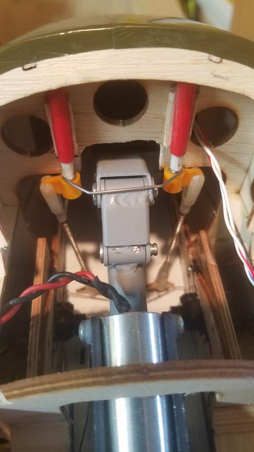

  • sam51401
ID:	318742Click image for larger version

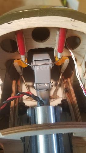

ID:	318743 Great work on the mains, here is my nose but i havent done the mains yet but rather like to get it flying.

  • sam51401
    Welcome Tim!!, Im starting mine back up myself so looking to finish it out in short order.
    I asked recently for hinging ideas on the flaps as with the CA hinges i felt it limited the throw some what and being only one servo per wing, the hinges were stiff and felt may strain the servo when holding in the deployed position.
    Well problem solved as i removed the flap sections and removed the CA hinges by using a dremel cut off wheel, CAUTION!!!! That was a most unpleasant operation in heating up the cured CA and cutting the slots again. MUST BE WELL VENTED AREA, a fan blowing away would have helped. The trailing edge is ply so it would be more work to use an exacto and risk splitting the wood or worse slipping and stabbing my self. Ask how i knew that...... Any way, I found some regular Dubro pinned hinges, medium i believe, and have now full throw to the mechanical limits and no strain to the servo due to stiff hinging.
    Full movement on here is roughly a little more than the 20 degree half flap setting on the real one so as already been mentioned, its all it needs.
    Just some of the things i have done beyond the stock kit.
    Robart electric with struts
    Nose landing light using a Mag Light reflector and bulb
    full nav lights
    Nose gear doors, mechanical actuation with strut
    Recovered to the 76' VMO-2 at Camp Pendleton
    Dee's exhaust nozzles, Awesome they are!
    Heli pilots for crew
    Now if i can add hard points to the sponsons to mount some Zuni or 2.75 pods. Would need some internal support to tie in beyond the supplied screws to hold the added weight.
    Looking forward to your "build out" Tim and feel free to ask away.
    Sam
    PS, I got my Bronco fix when the FL version came out and its in the VMO-2 Desert Storm scheme....

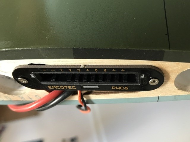

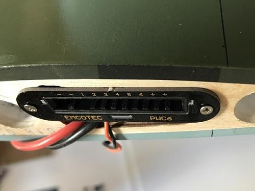

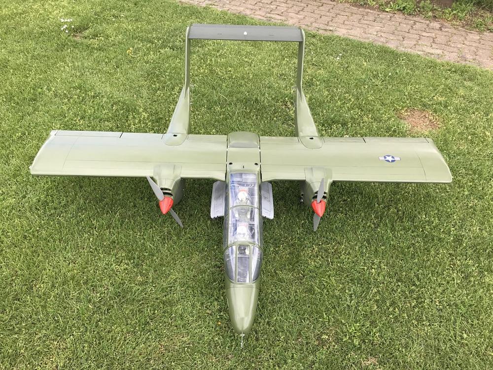

  • Axelowski
ID:	313165 You have keen eyes!!
    the gap between center fuselage and the main wings is the result of my emcotec power connection (PWC6).
    I did not dare to mill the center fuselage more
    Axel

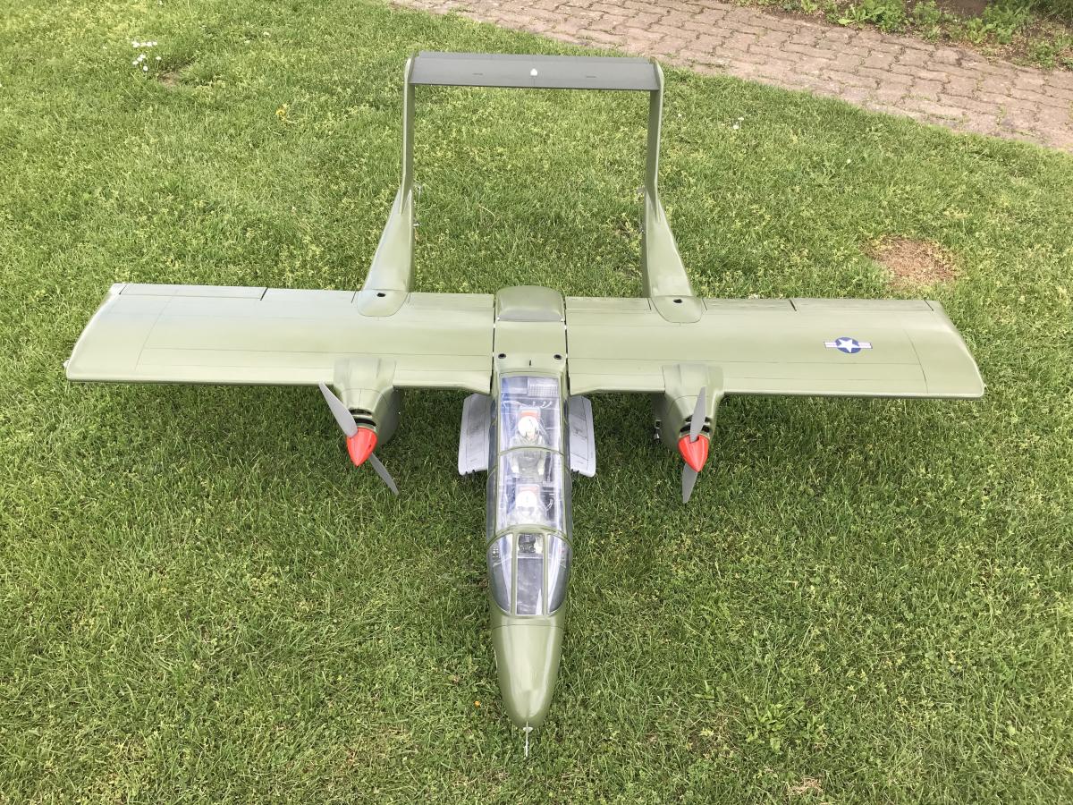

  • didier n
    Congratz on the maiden, but on your photo's the main wings are not completely pushed in against the center fuselage....
    What is wrong there?
    grtz,
    Didier

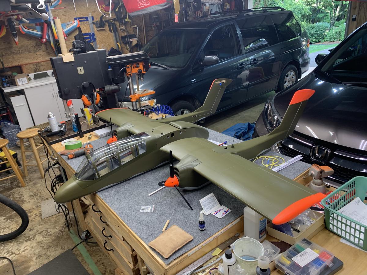

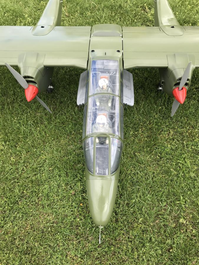

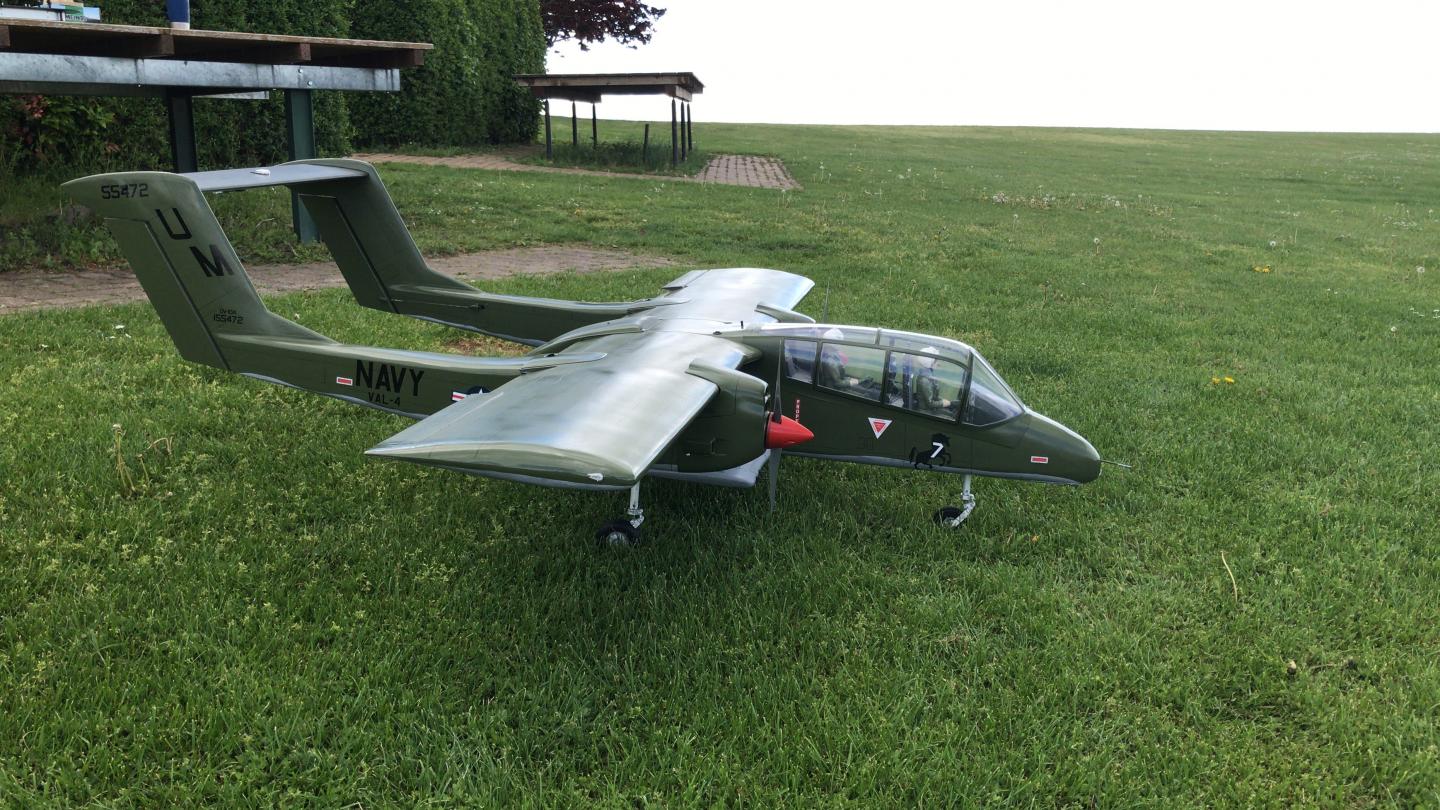

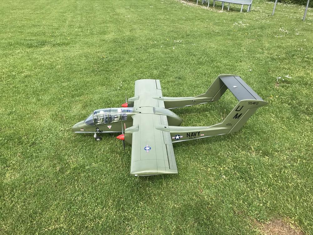

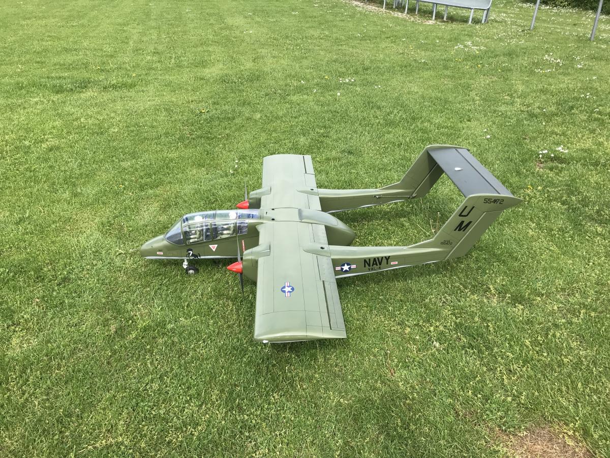

  • Axelowski
    Hi all,
    on friday I have maidened my OV-10 and it went smoothly!
    Thanks for your help and information, especially your advice regarding the M-60s (Den and Didier).
    I did a full repaint, the German Airforce scheme was not my first choice.
    Thanks a lot,
    Axel
