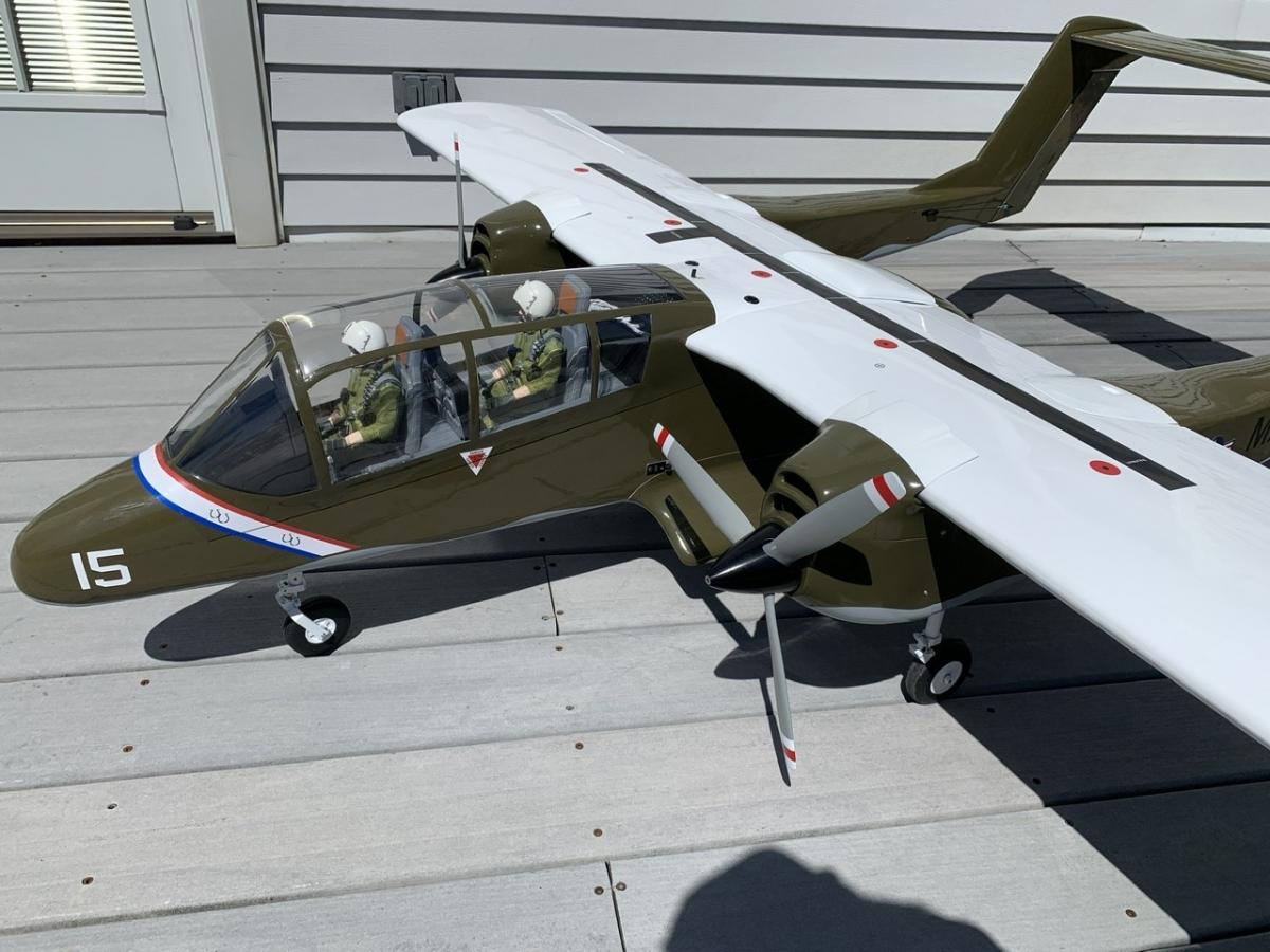

  • caddguy6
    The Bronco is complete, except for the Propeller warning decals. AUW is 19lbs and a quick CG check appears almost spot on at 85mm. I need a nice table to assemble and setup the model and until conditions upgrade due to social distancing restrictions at my flying sites she'll stay in the hangar. Hopefully a few more weeks til maiden.
    Cockpit instrumentation is looking

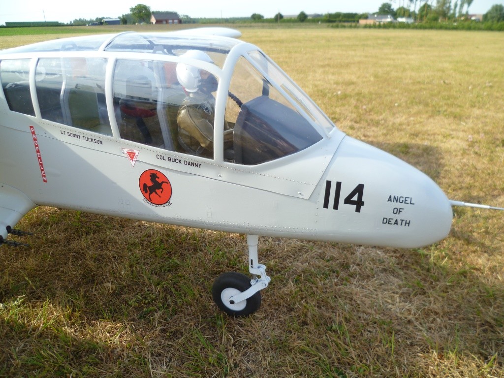

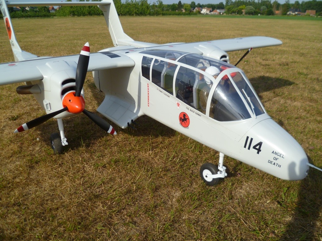

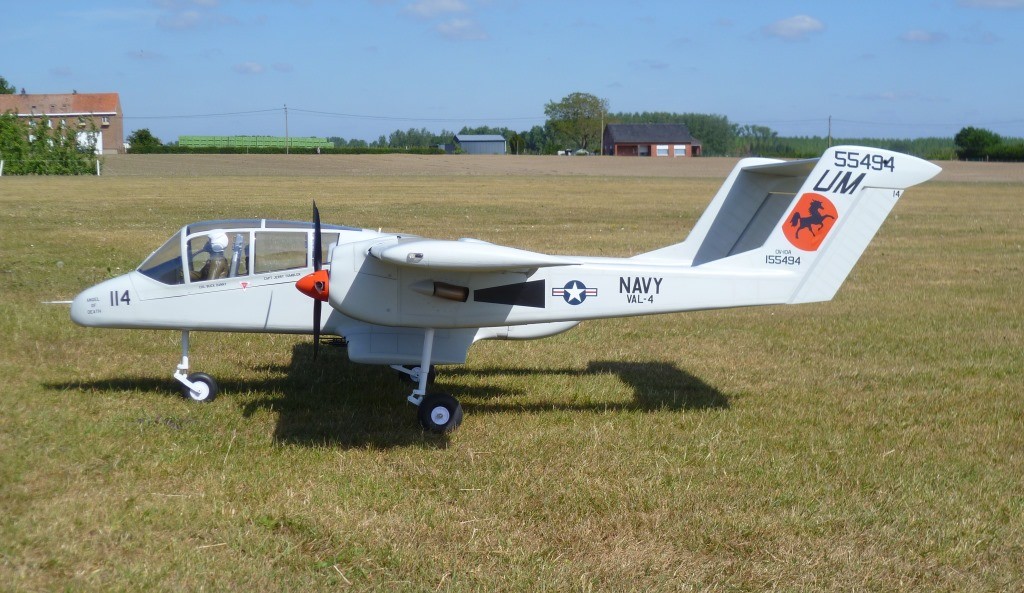

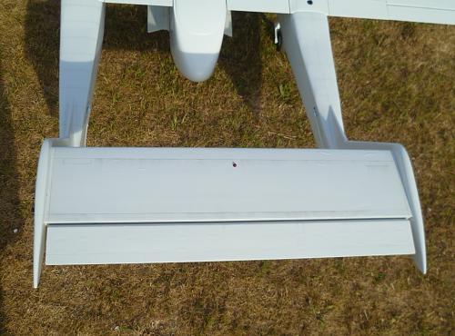

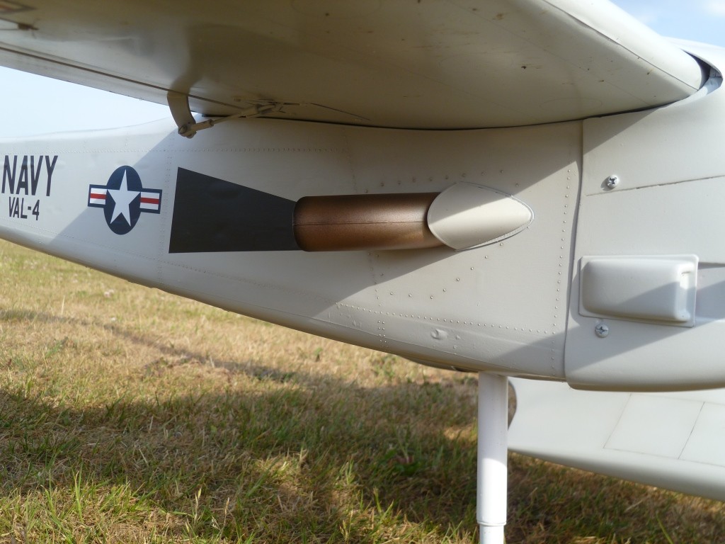

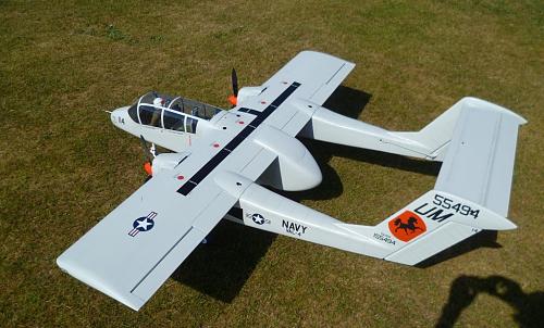

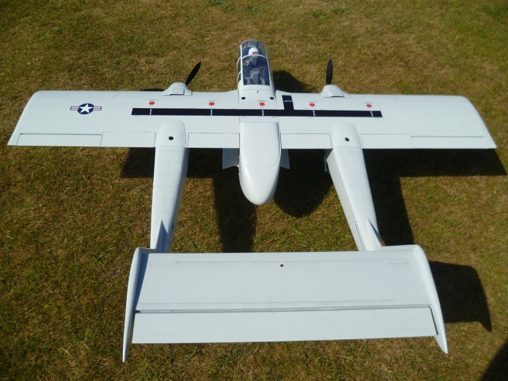

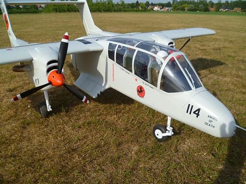

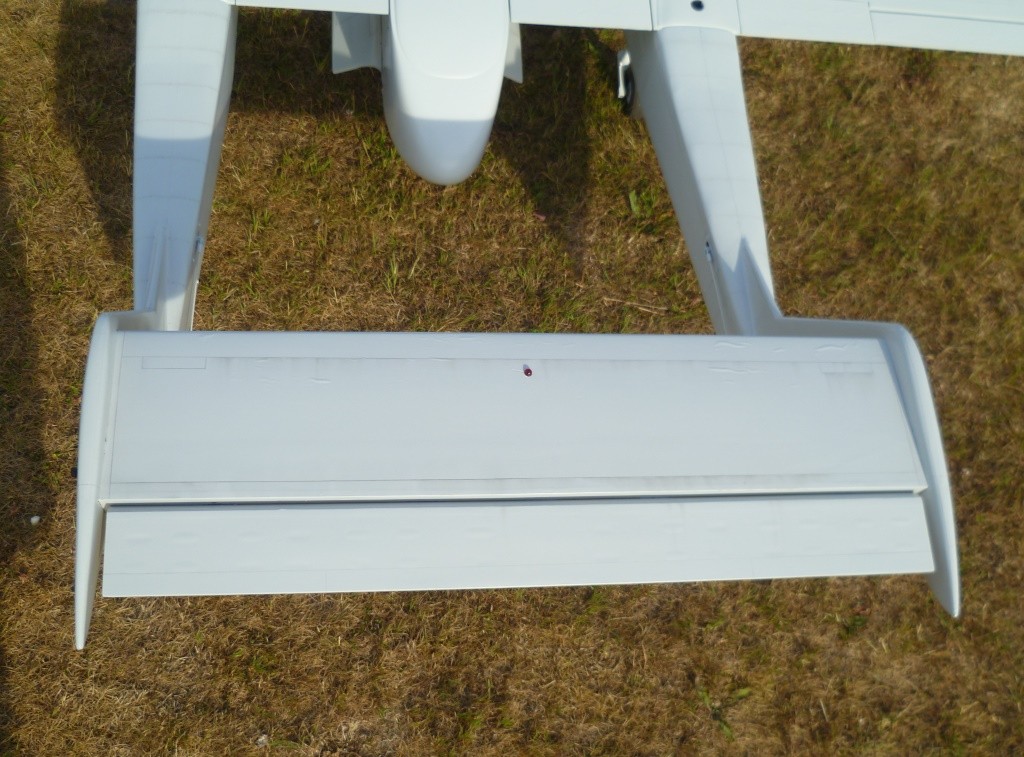

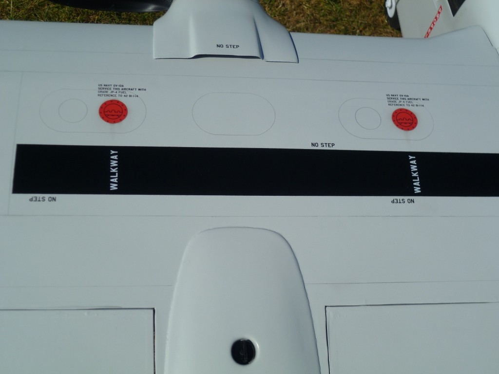

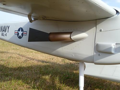

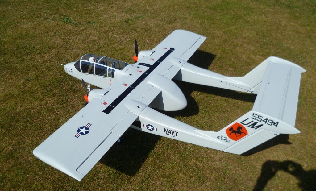

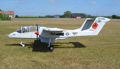

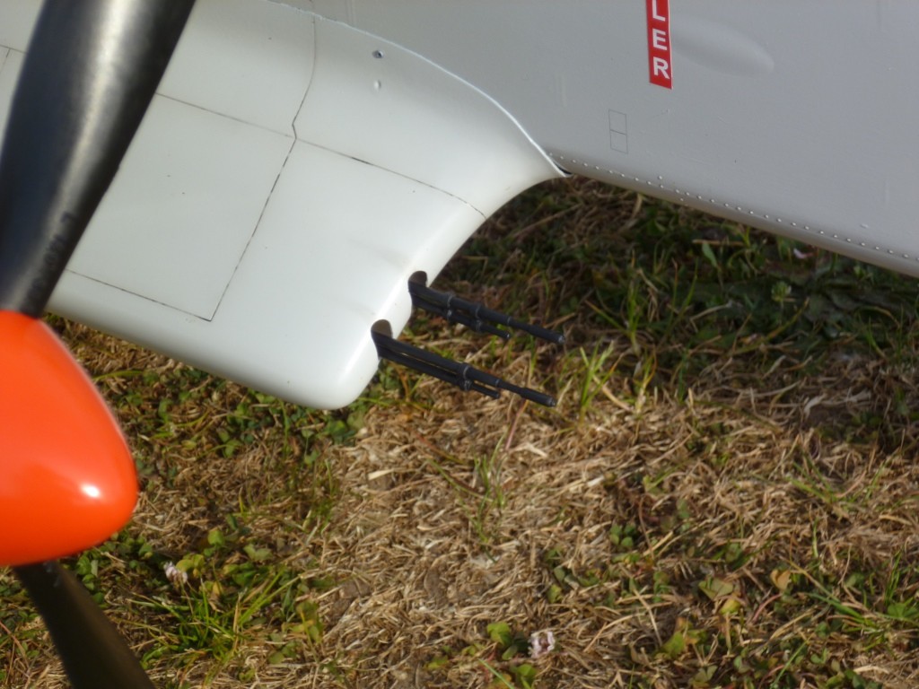

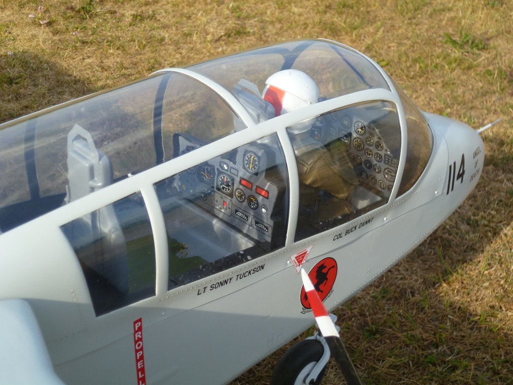

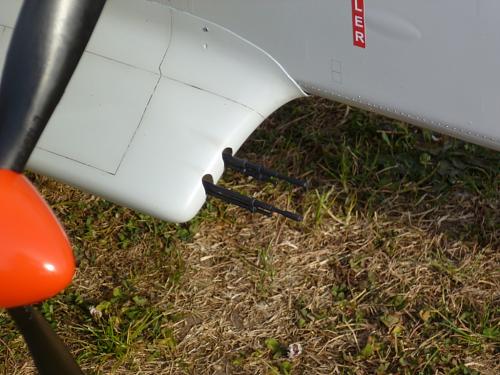

  • didier n

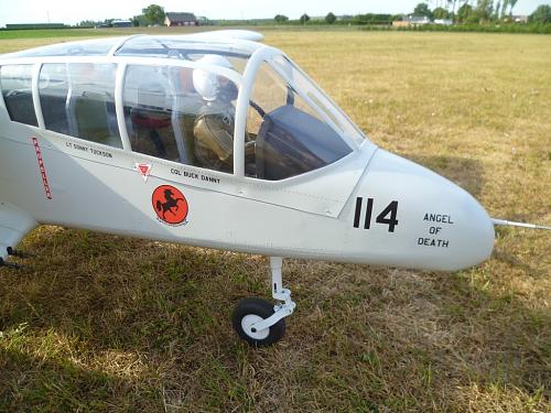

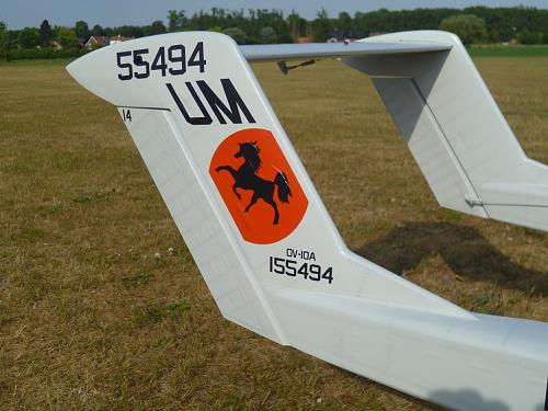

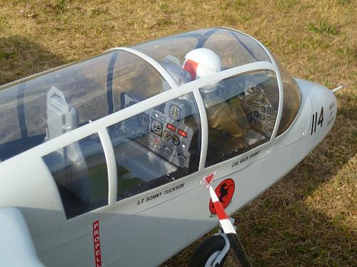

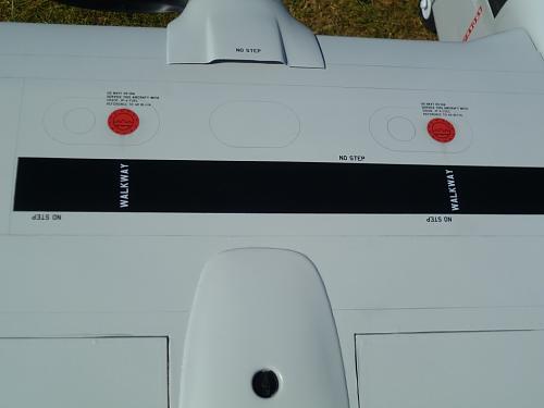

    I got some more flghts using the 6s lipo's, and i'll stick with them... plane fly's great, no need to change anything...painted the prop tips and i'll call it done...
    Took more detail photo's, happy with it !
    Didier

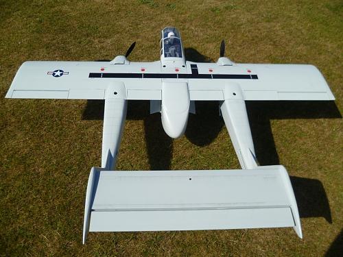

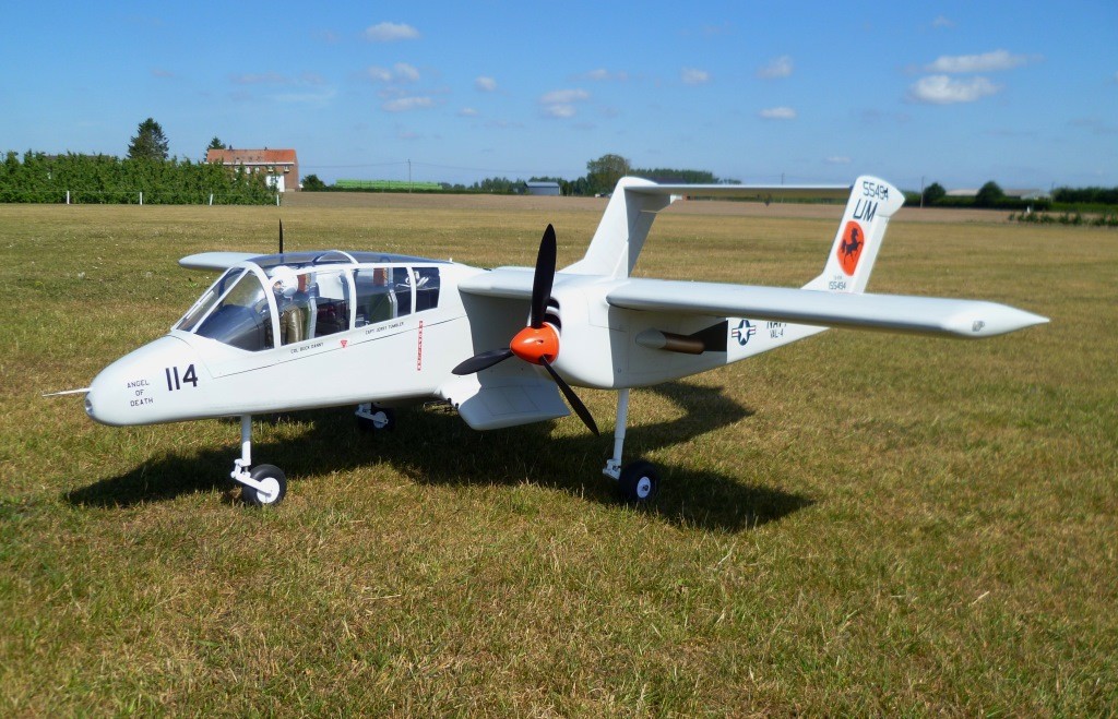

  • Spinny Testaverde
    Originally posted by didier n
    Maiden done ! It's a nice flying plane, no trimming necessary at all, i went with the CG at 85 mm... AUW was 9kg. Speed was good, but i did not have enough power for a steep climb or a looping, so i'll have to change things. Upside was after a 10 min flight i still had 30% left in my 5000mah lipo.. i run 2x 5s 5000 in paralell... max amp draw was 54amp for each motor. My Ramoser varioprop is 13.9, and pitch set at 14.5... i've ordered a set of 15.2 diameter props, should help the vertical performance...
    Some photo's i took before the maiden..
    Grtz,
    Didier
    That is one sweet looking bird!
  • didier n
    Thanks !
    While waiting for larger prop's, i've done 3 flights with 6s instead of 5s, needless to say the performance was very good, but at WOT i exceed the max rpm tolerance of the prop's...Well, in therory i must admit... maybe in flight it's ok....
    I will still try the larger prop on 5s once i've got them, will report back...
    Didier

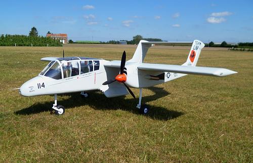

  • caddguy6
    Grtz,
    Didier
    Congrats on a good, smooth maiden.

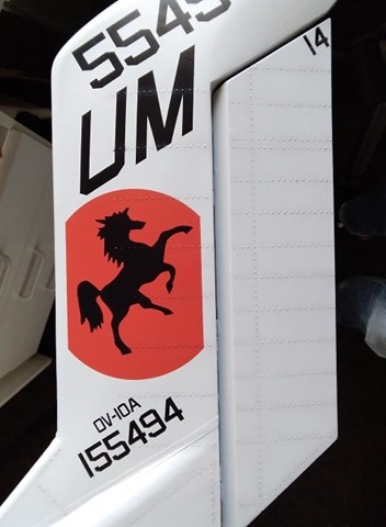

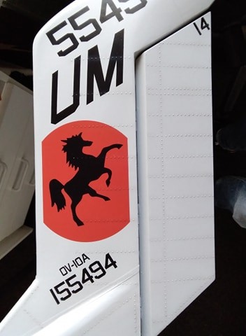

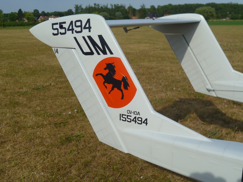

  • didier n
    part two of the weathering process, rivets show up really good now...
