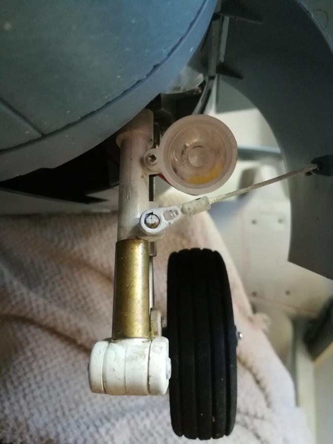

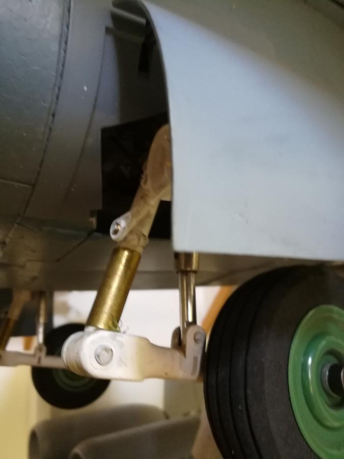

    DC, what is leading me to my inquiry is that in the first pic above, those open slots in the lower arm seems to indicate that a wire is placed in the mold and then it incases the wire/axle to form the lower strut I dont see similar slots in the upper portion of the other strut unless they may be on the opposite side. Maybe we can get MRC guru's to give some insight to our inquiries and offer some help. I believe these are the best bet in a working conversion for the OV-10 and with possibly some minimal work to "play" the part.
    Can you give the diameter of the nose wheel please just for clarification?
    Sam
    I will get you guys more pics and info when I get home from work this evening, I don't have a nose gear retract to have I'm my hand, only the mains but I can do my best to measure the nose gear that's installed on my Yak and take some pics of that as well, also will show you what the guy did that I bought the Yak from and how he made the weak part of the rear retract stronger, it's held up well.:Cool:

        Ok, I called the guy that modded the rear mains on my Yak, he said the wire coming out of the retract is molded into the plastic and not that far down either and the rest is solid plastic on down and with the Yak being heavy the plastic part of the strut will crack, don't know how heavy your Bronco will be but these might be kind of weak for something heavier than the Yak.:Cool:

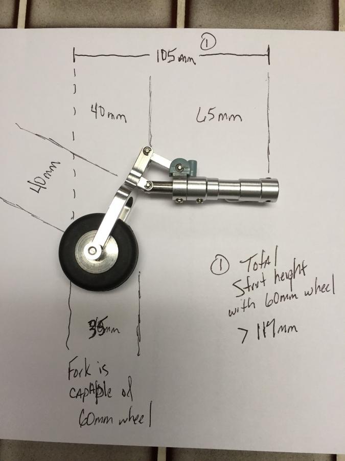

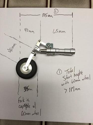

        • I’d like to see pictures/dimensions of the Yak nose gear CB! Unfortunately, I just don’t think there’s space for the Yak gear, unless you don’t install tires that is!:Thinking:
          • I hope to be proven wrong on the LG, but if you don’t want tiny tires you’ll likely have to use straight struts and not much of a trailing link.

                    • Ok, here is a picture of my Yak gear that has been modded to be stronger, this is where the part is solid plastic and will break in half.
                            :Cool: That idea keeps it in the running but am leaning towards the T-45 mains now
                              Yep, I would go with the T-45 or something else, these Yak mains are huge anyway, don't see how you guys could get them retracted up into the bays of that Bronco..:Confused:

                                  • Here is the 90mm Vampire nose gear with its 45mm wheel. Overall 120mm.
                                      Not the whole strut, just one of the wheels :Whew:
                                      It's only 44mm dia which is 20mm too small:Straight-Face:
