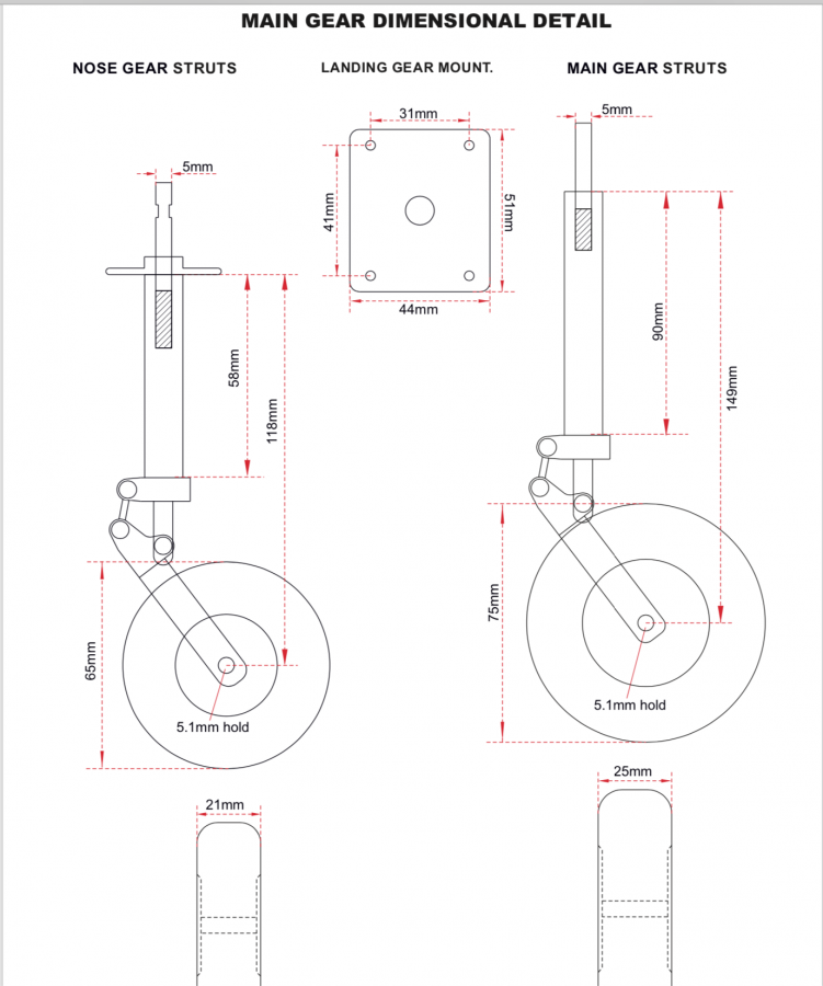

                I'm busy doing my equip mod research and posted earlier on my power plant selection. My next task is a better LG. Just as Boots wasn't too excited based on his remark about them, I too am looking to remedy the not so stellar stock provision. Since I don't have a bird in hand.........yet, maybe one of ya'll that does could provide some measurements of the struts(both nose and main) to further my research.
                Possibly a rough drawn hand sketch posted as a PDF.:Cool:
                I'm close and can't wait to share but don't want to jump the gun if my discovery dimensions aren't gonna hack it.

                  Hi OV10, this is taken from the manual that's on our site ;) Hope this is helpful and that you get your's by the weekend.
                  S.

                          Stuart...........Thanx for posting those dims. When this was first announced the manual hadn't been put on the site.
                          I have now D/L'd the manual. It is a better rearrangement of the PICHLER manual and more comprehensive at 45 pgs versus 36 :Cool:
