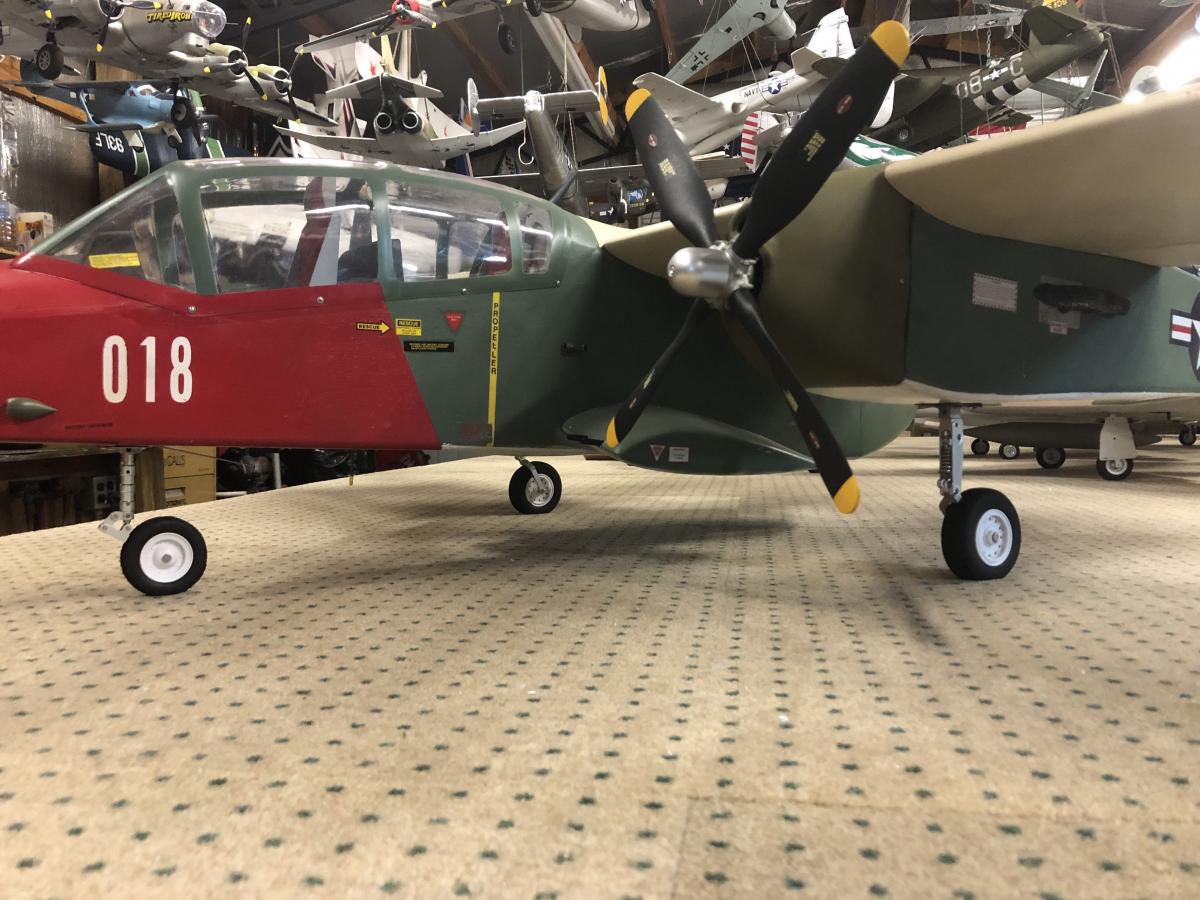

                                Yeah but I don't think they would be an issue and should up as good as the wood around them on a rough landing...I'm hoping the A-10 retracts I have in my 92" OV-10 will hold up ;)

                                    Is that Corsair props you have on her? :Thinking:
                                      #138
                                      Or FMS P-47? So many options!!! Very cool none the less...

                                        Hey there TI, looks like your bucking Bronco has a bad case of the tiny tires!LOL:P
                                        what does she weigh, may I ask?
