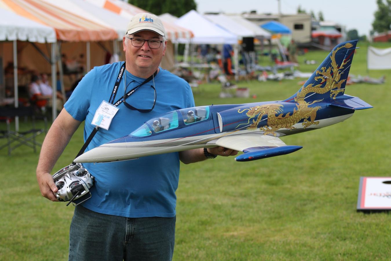

    Here are several pics of my current project FW L39 with Callie graphics. As you can see this is more intricate than the mouth you wish to place on the Bronco so yours should be an easier placement. I did have to cut this into several pieces to be able to work it and you may have better results doing same depending on the curvature where it goes.
    IT is very doable, just takes a little time to work it down.

      Here is the finished L39 by the way.

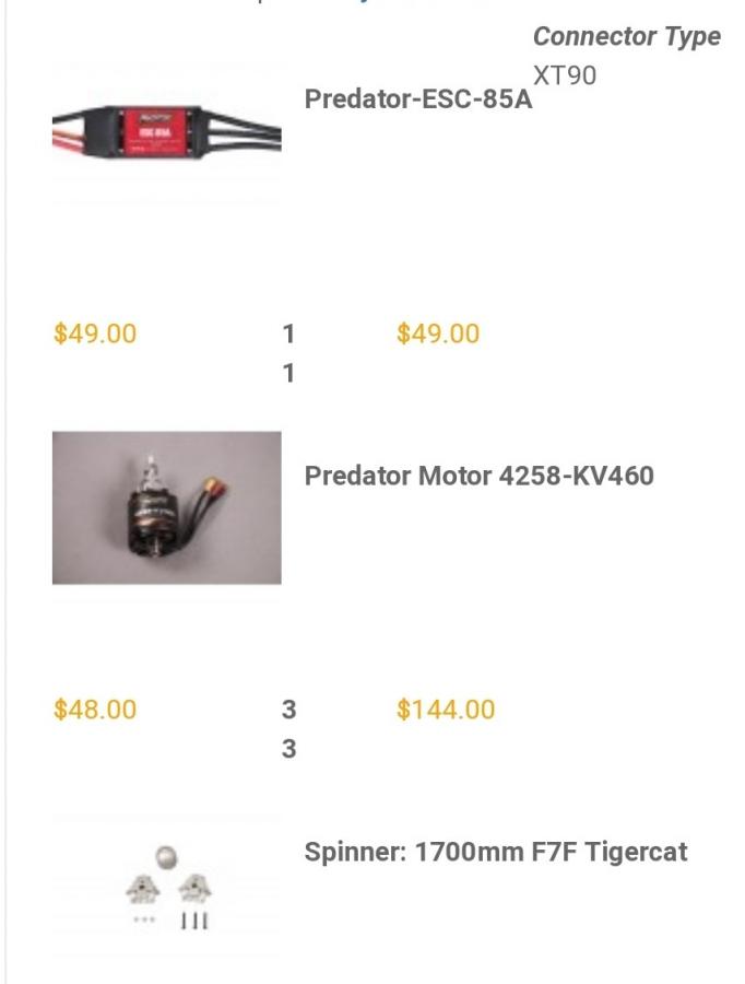

        Well, i just pushed the button on these....lets hope for the best !!!

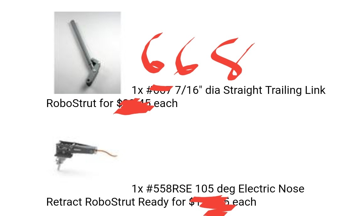

              You just nailed my almost exact order i was thinking of. I already have the mains but i think the nose retract and strut will be a great choice.
              Wrong strut PN in above post, should be 668

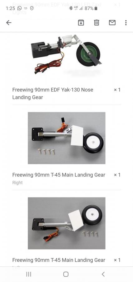

                  Has anyone noticed that the nose mount has a built in incline? Haven't really checked the angle but i think it was planned for a retract with greater than 90 degree rotation. Im going with the 105 degree and the 7/16" strut that takes up to a 3" wheel just as wrangler 1 picked.
                  wrangler1
                  *****Dont order the 667, it needs to be the 668 Forked strut for the nose ******
                  Any other options out that that are being considered? Lets see what else the master minds have put together.

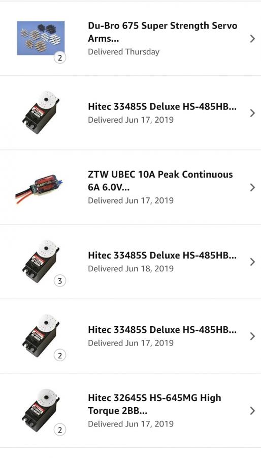

                          I went crazy...i hope my wife keeps loving me after this jajajaja. Here are part of the things ordered for the Bronco Project.

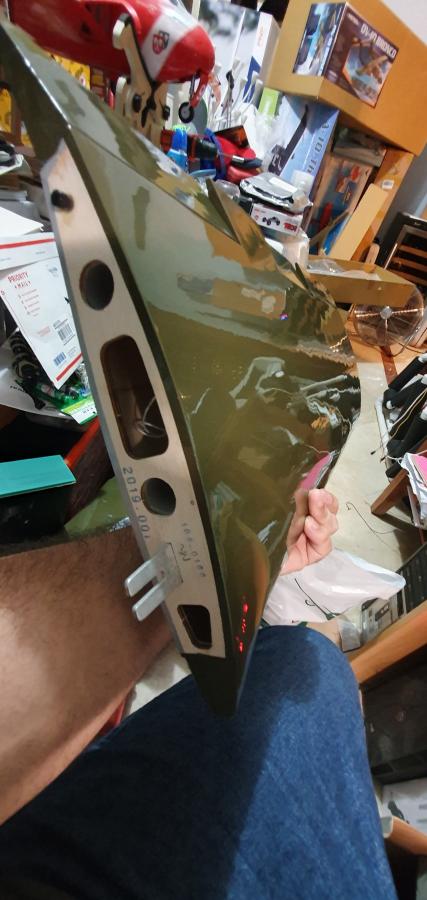

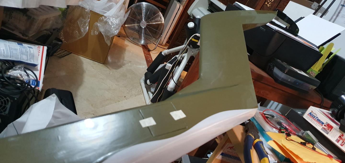

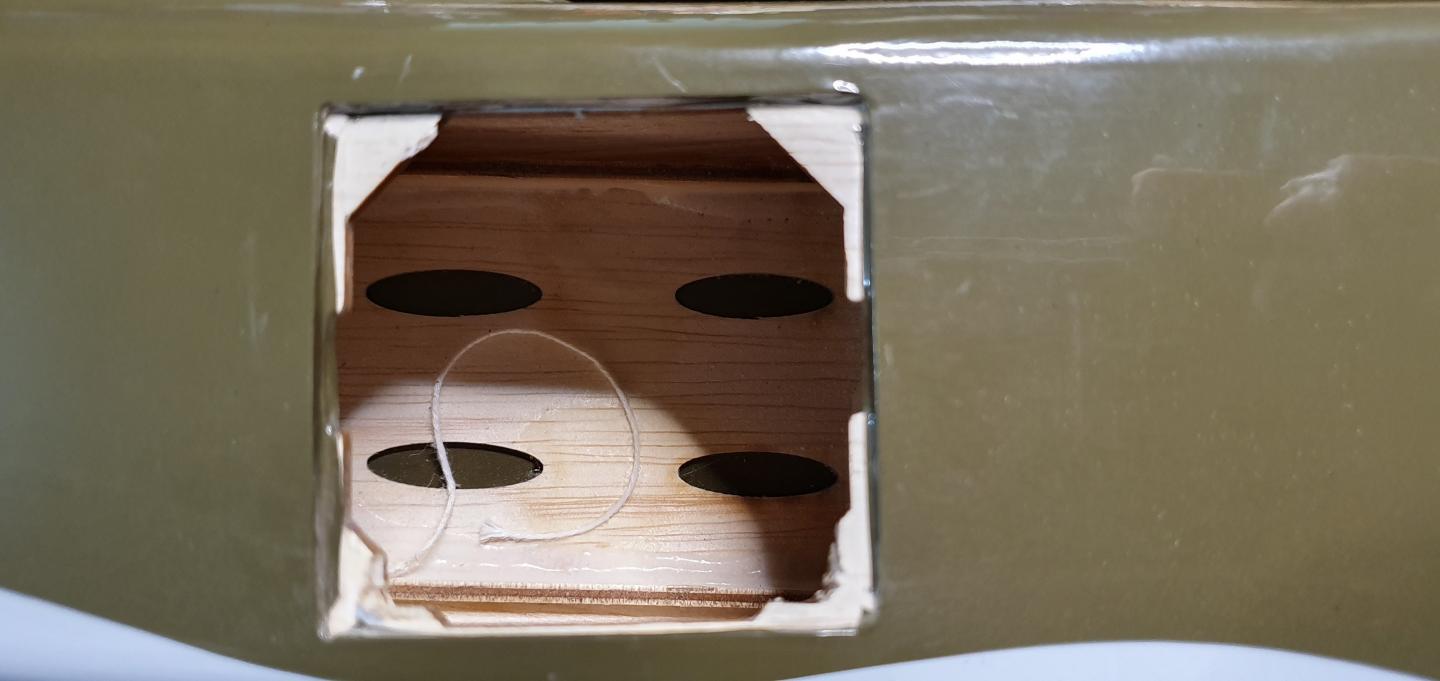

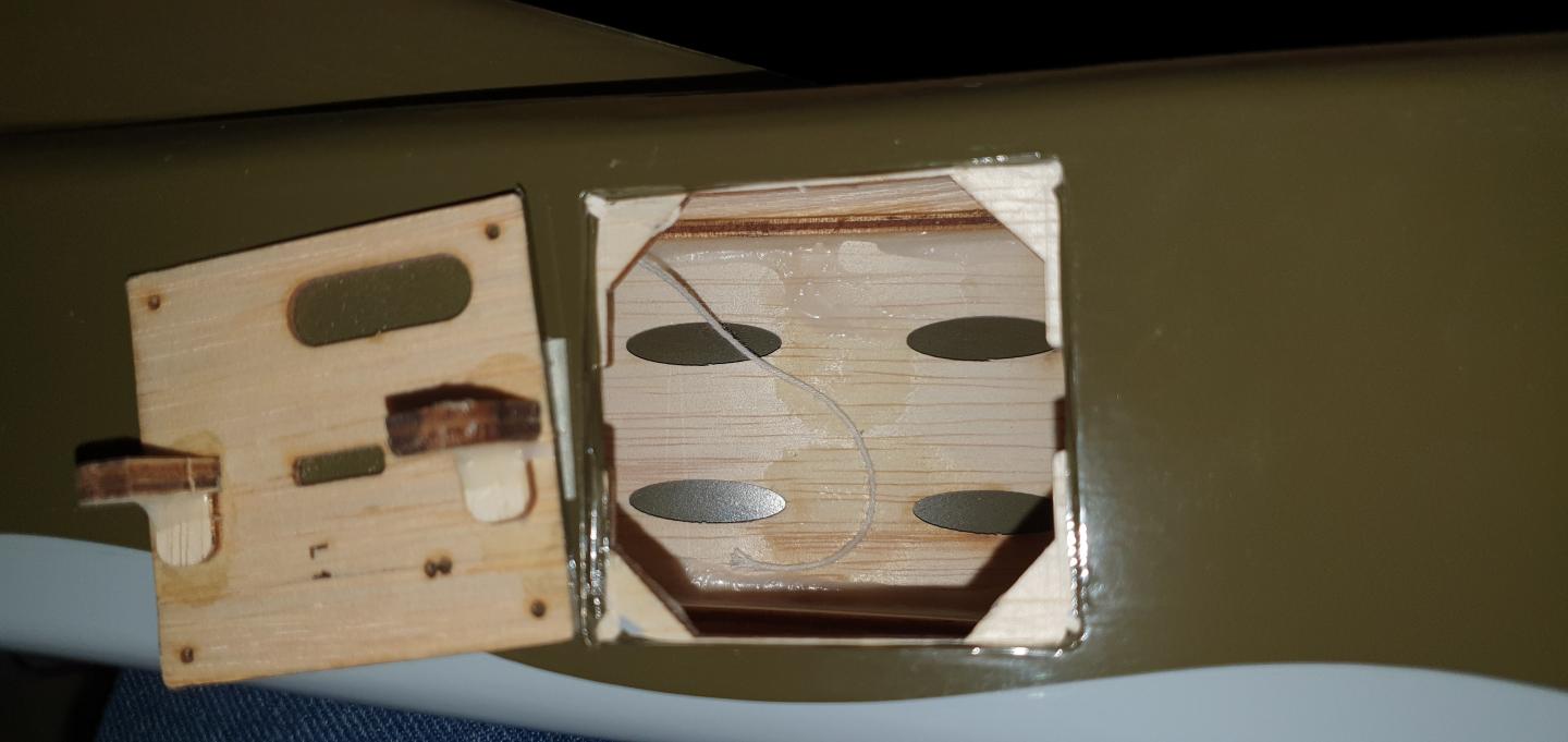

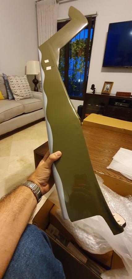

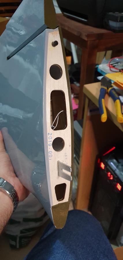

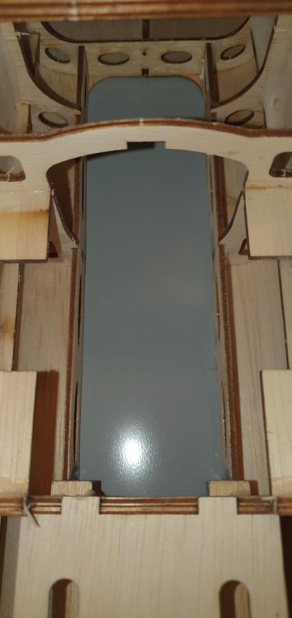

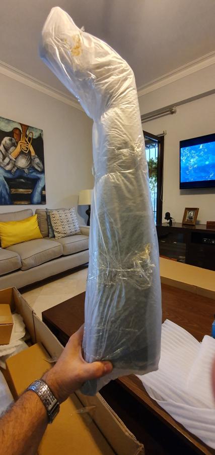

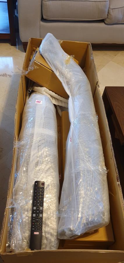

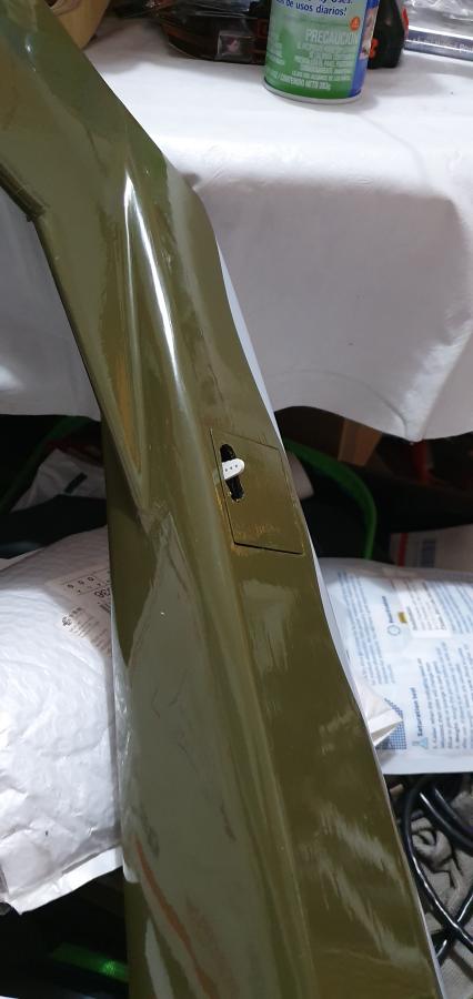

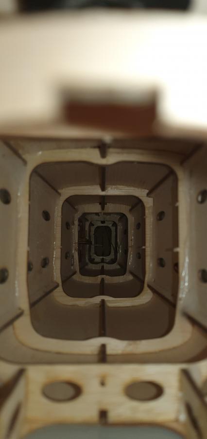

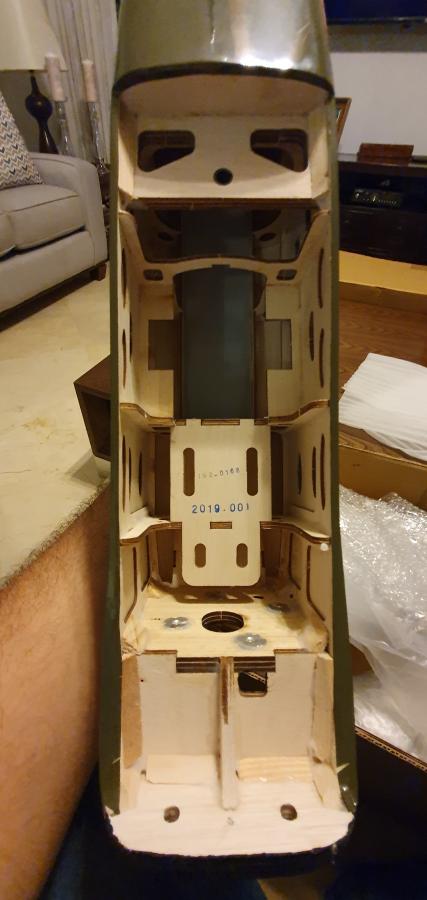

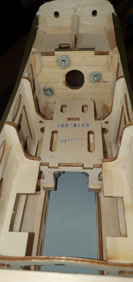

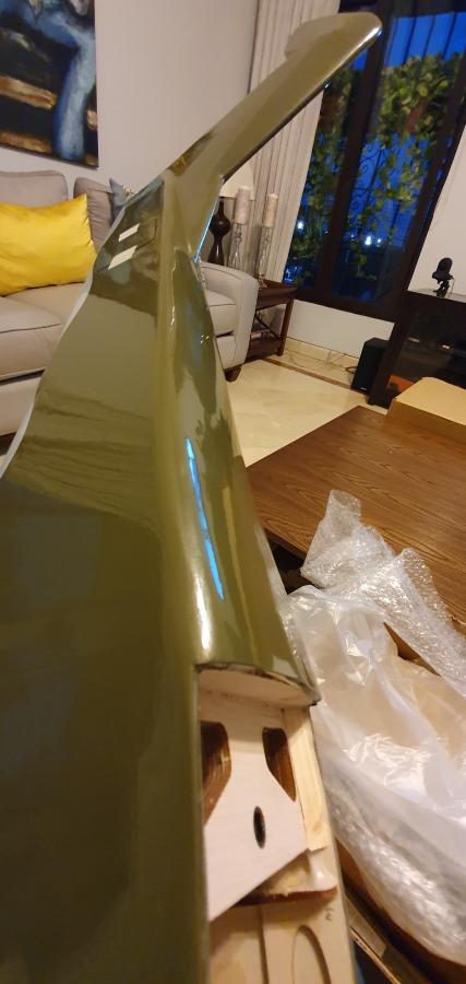

                                  Well i just started part of the unboxing, but since i'm so tired i'll do just one boom in this post. these booms seems to be very well made, they used elastic glue instead of CA to reinforce the wood joints and the cover looks excellent.

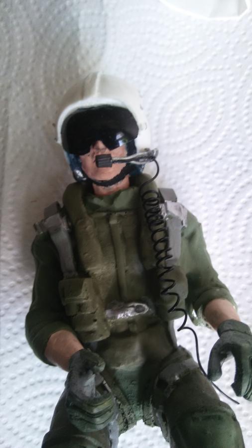

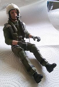

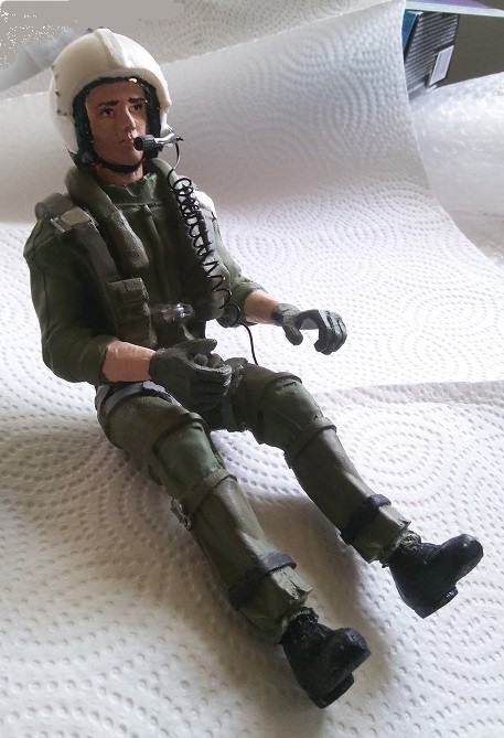

                                    I got a preview from Mike Hicks who is offering 1/7 scale pilots for our Bronc's. The crew is inbound reporting for duty maybe tomorrow.

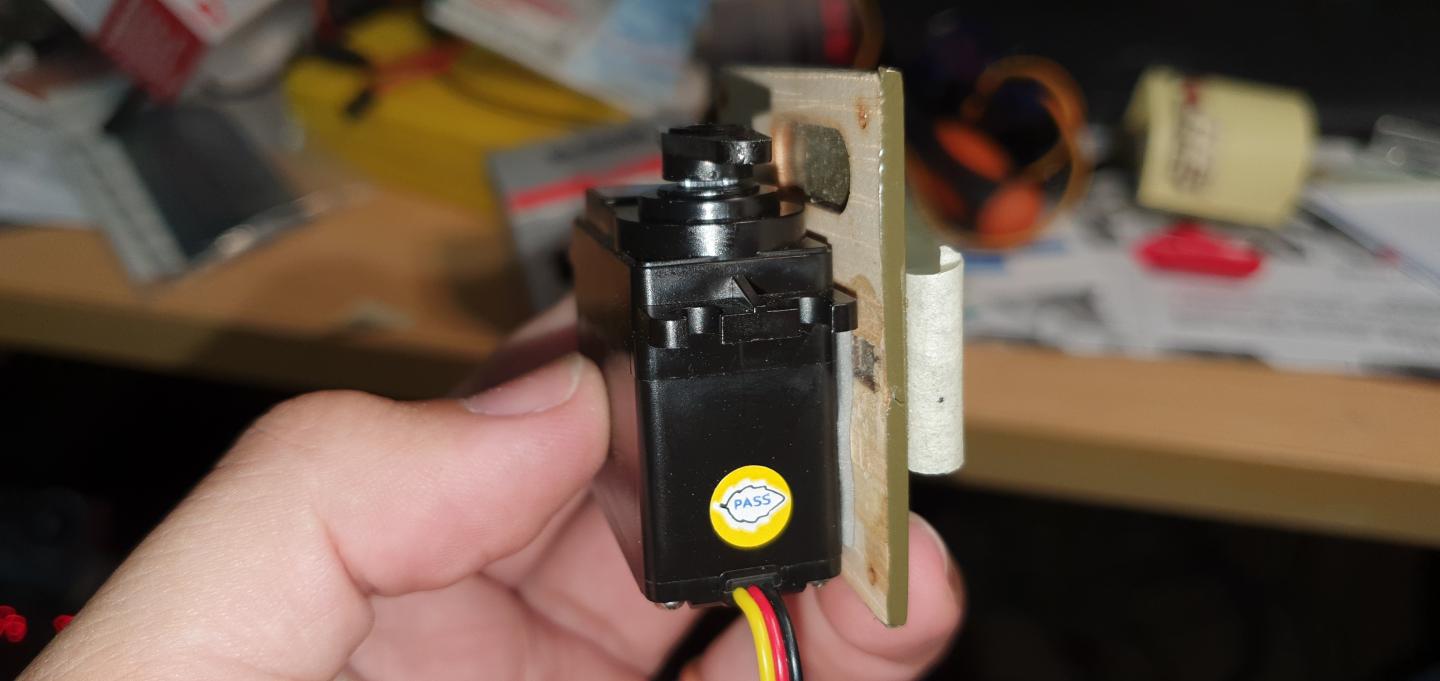

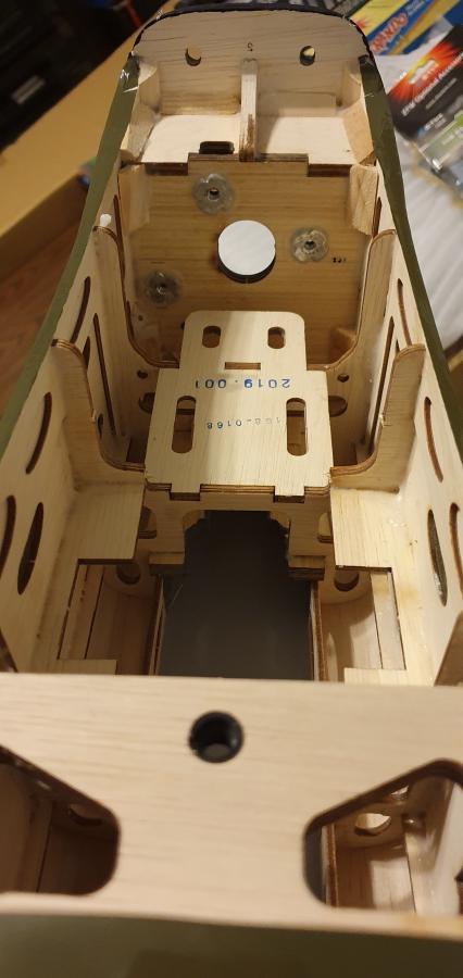

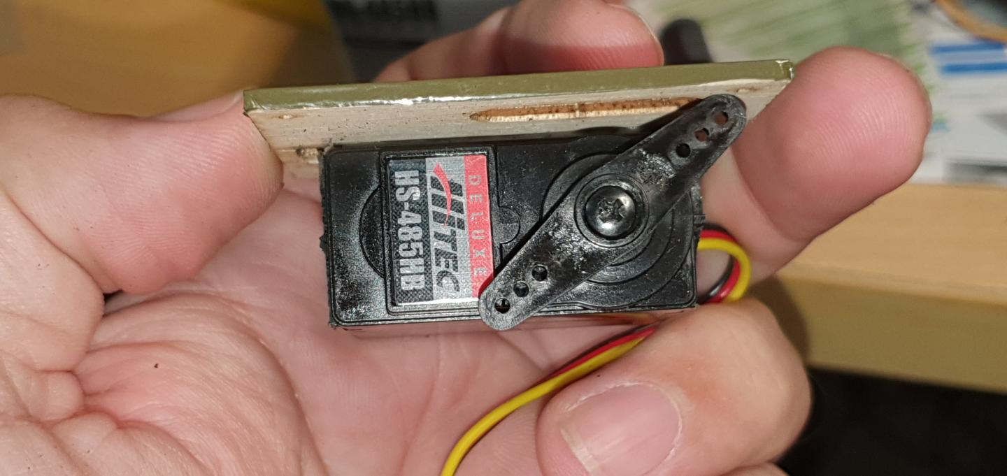

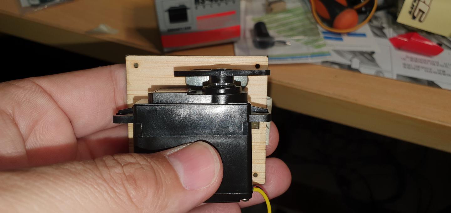

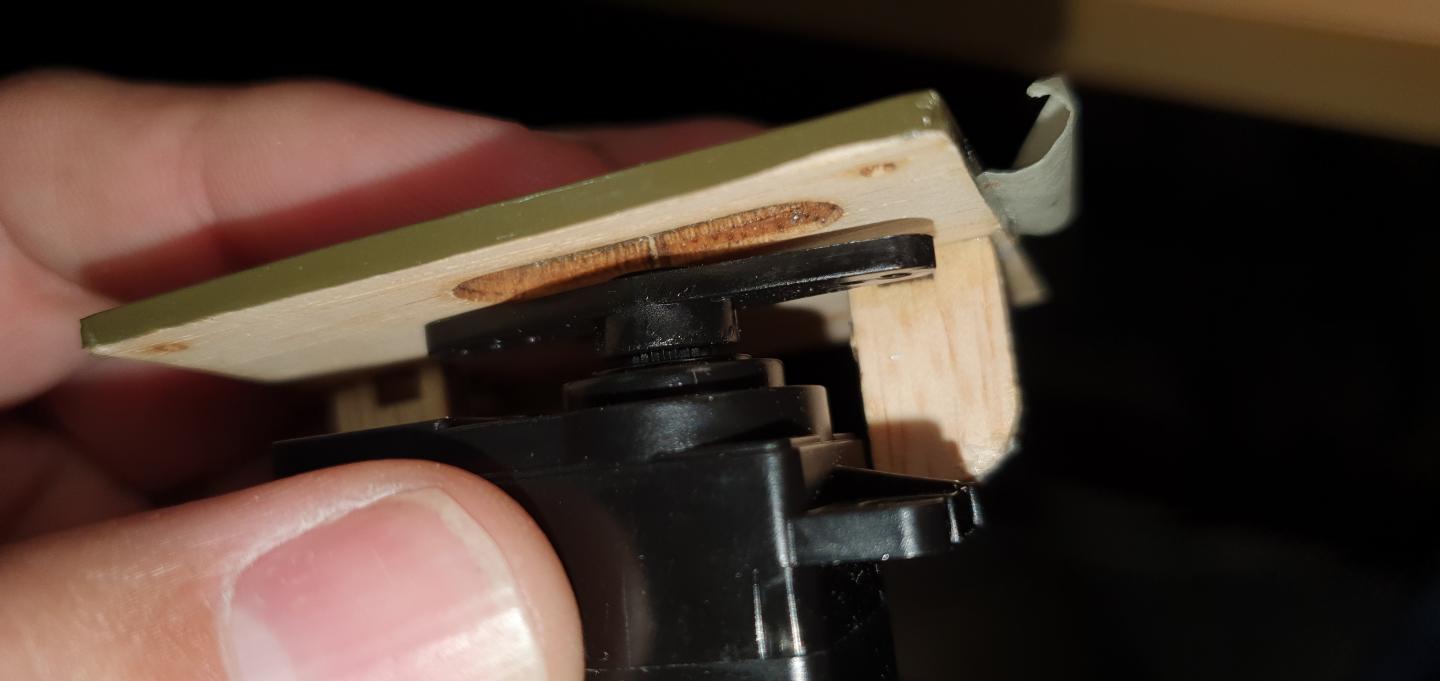

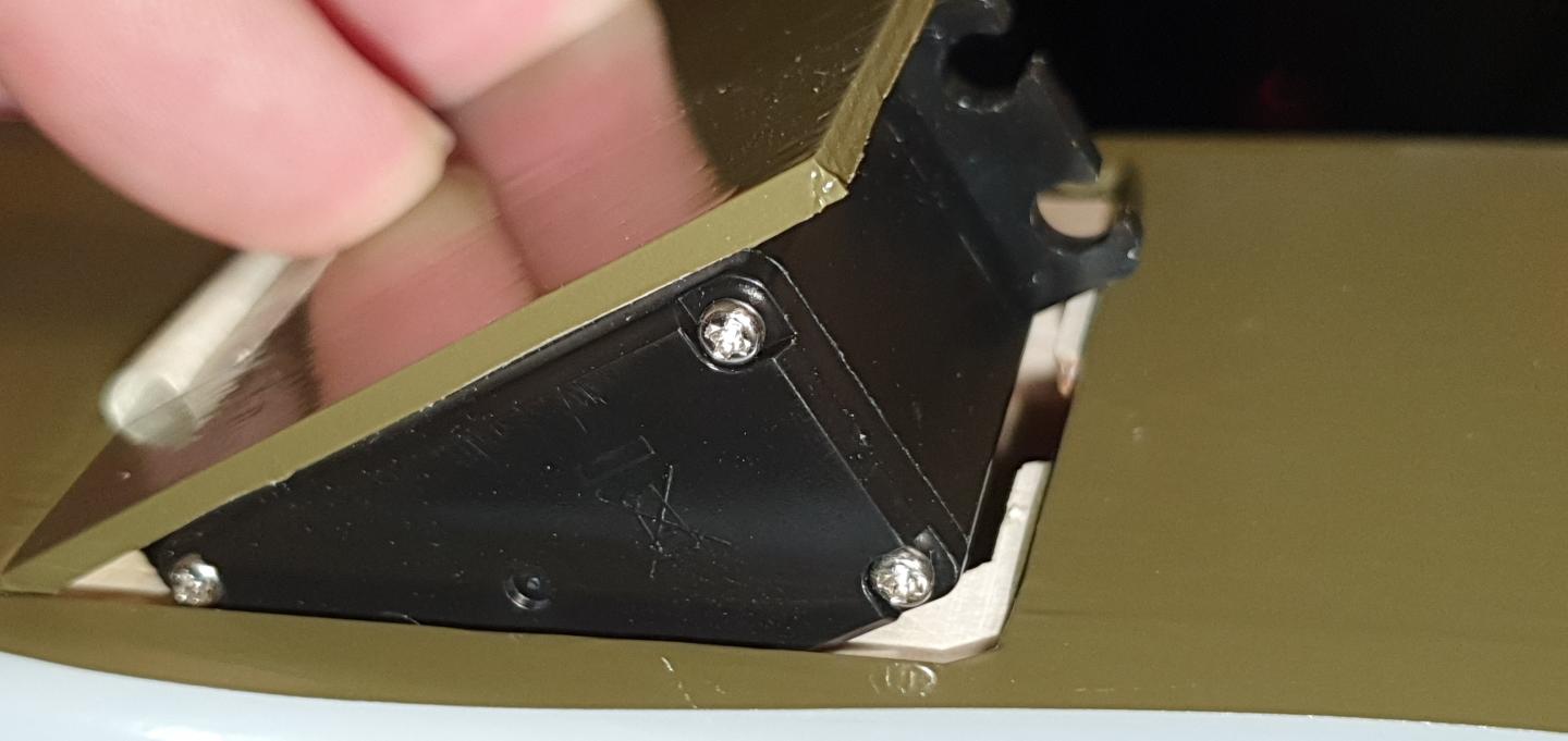

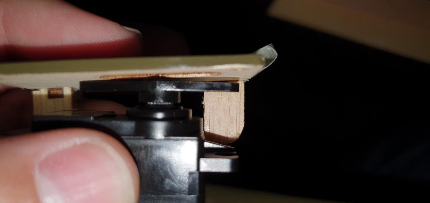

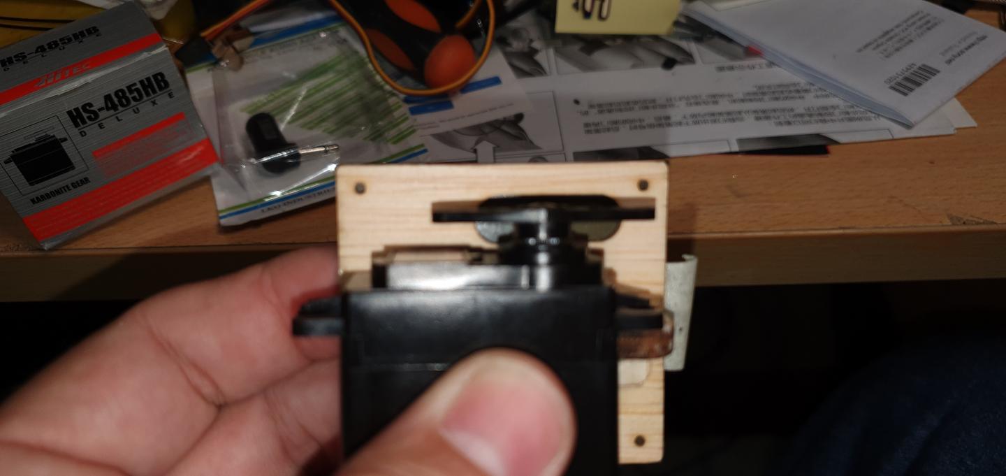

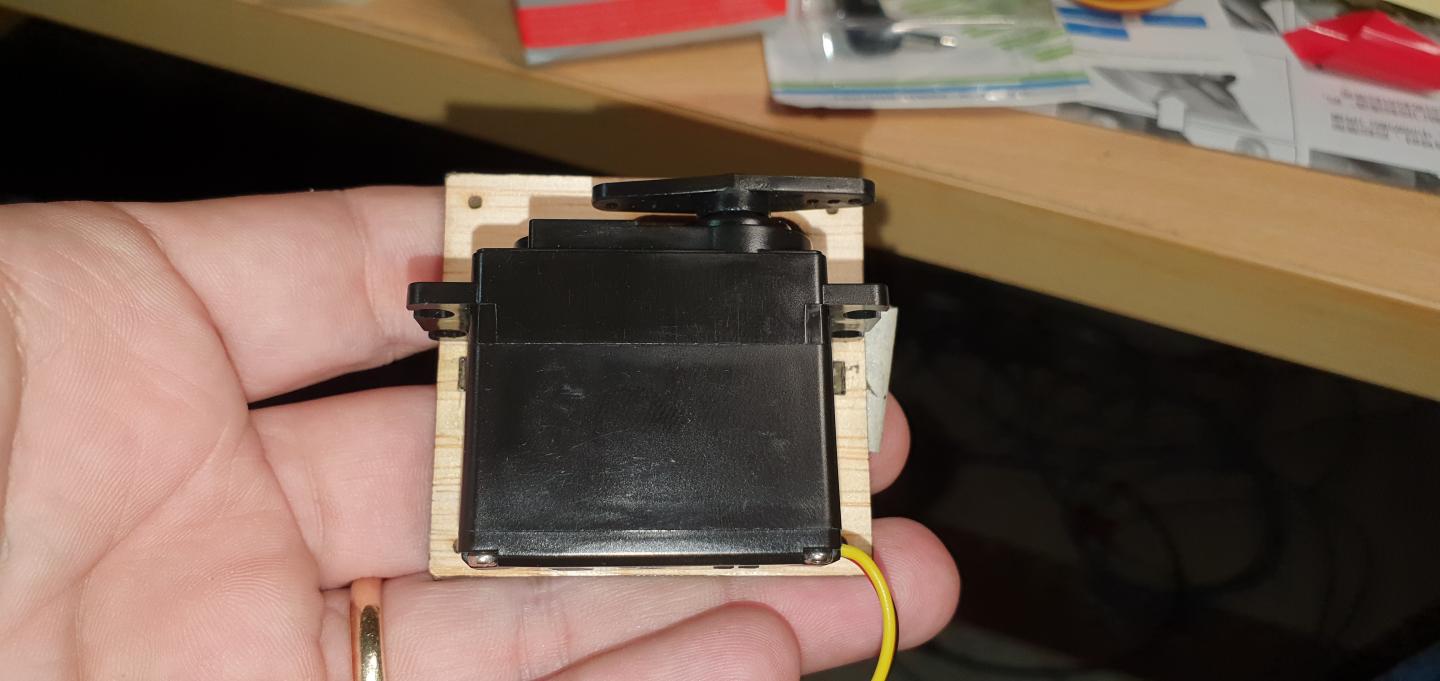

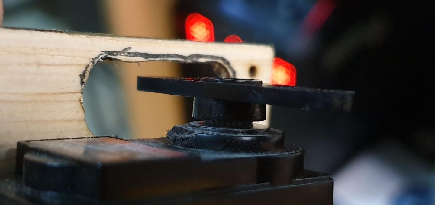

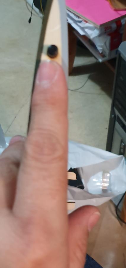

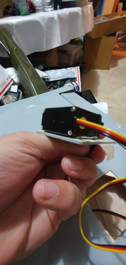

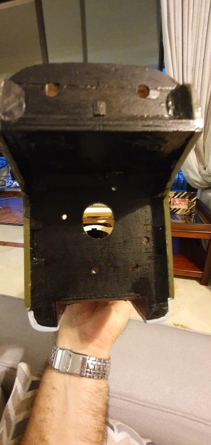

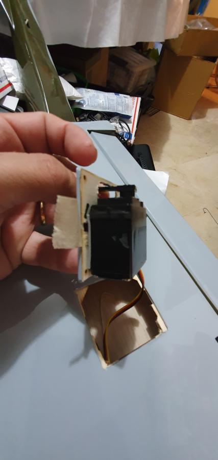

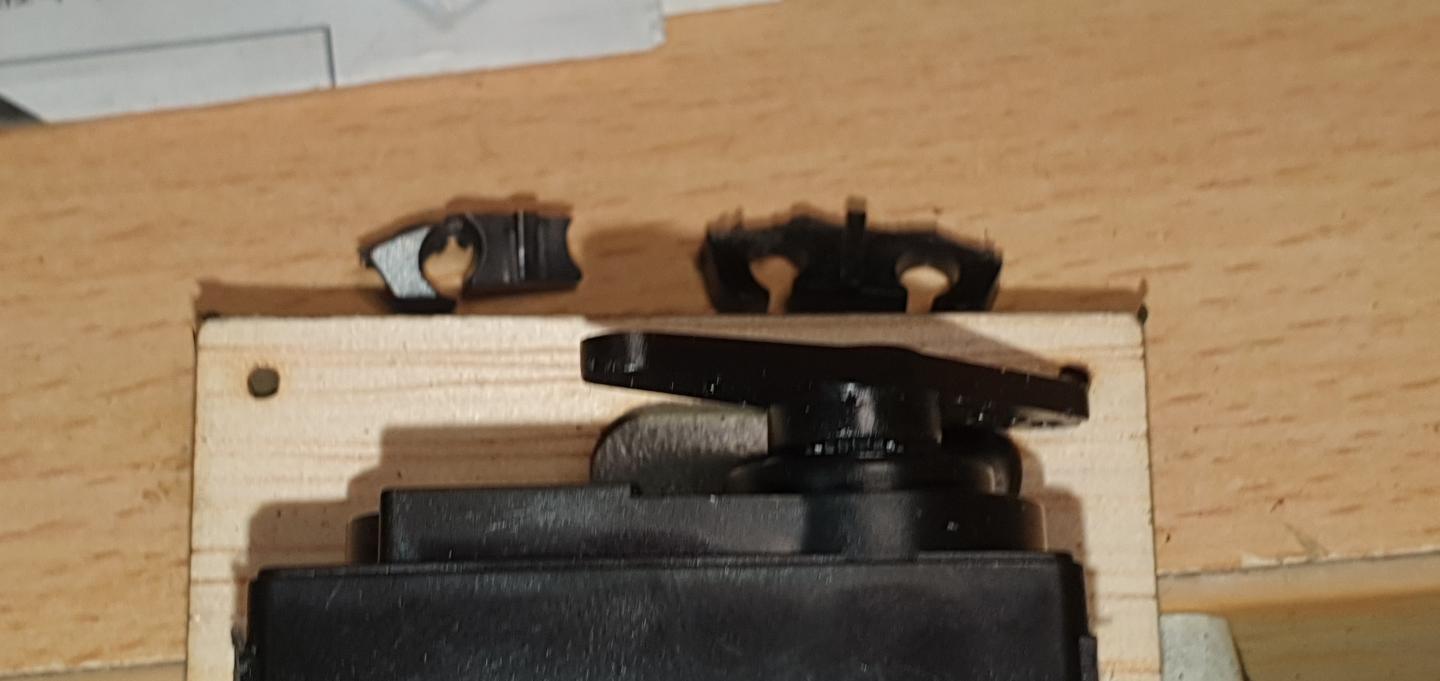

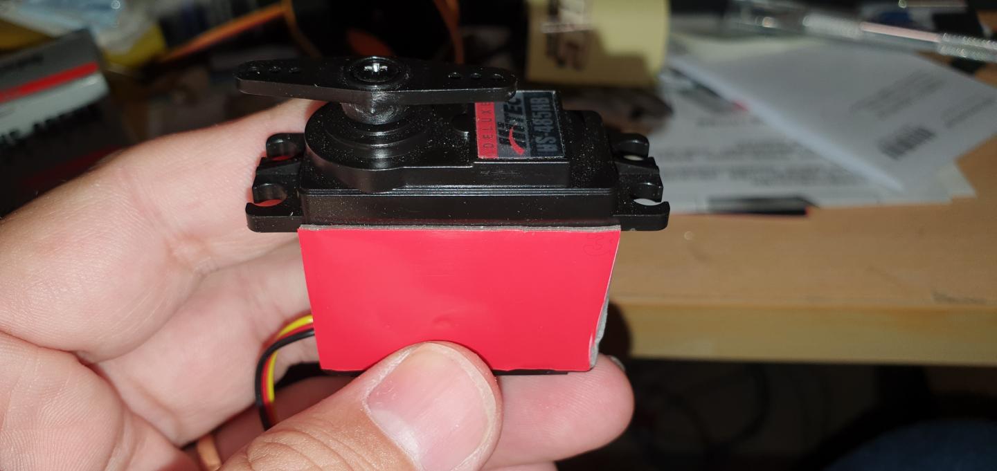

                                      Well, i started the building process and as soon as i grabed the servos, i encounter a situation.........they are bigger than what the plane ask for. Since i don't want to buy more servos i used what i have in my head....imagination. jeje. here are the pictures and also how i fixed the servos in position.
                                      • wrangler1
                                        • Feb 2019
                                        • 116
                                        • Dominican Republic
                                        #299

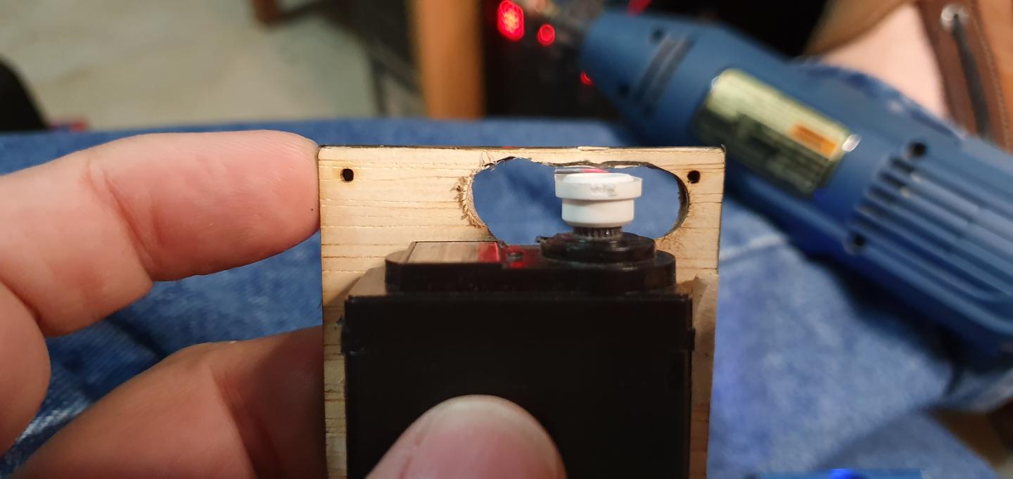

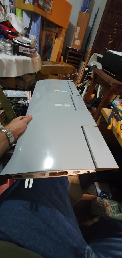

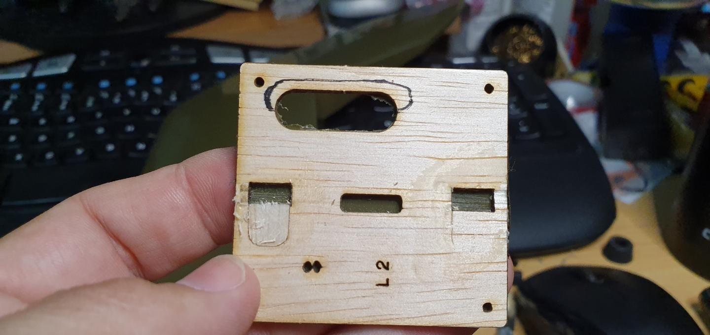

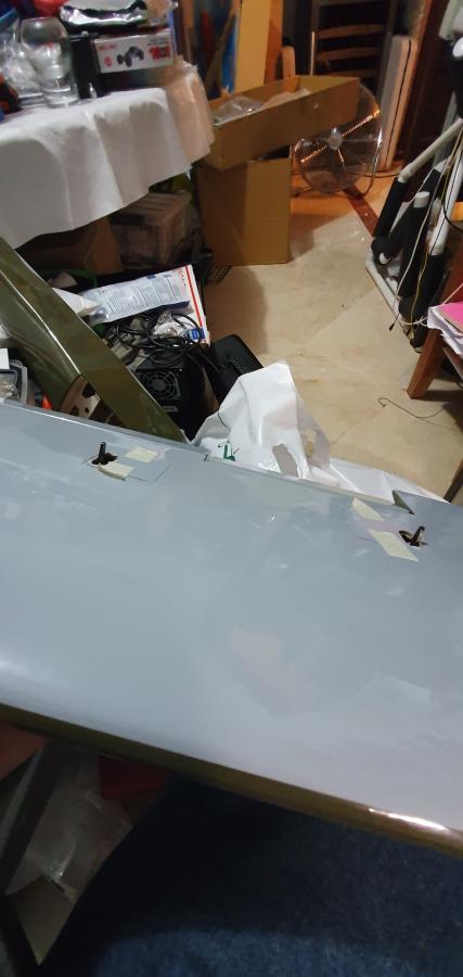

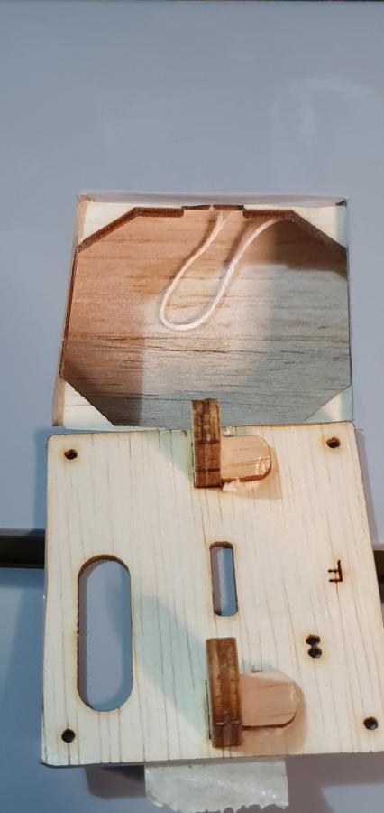

                                        I just did the same on the wings with flaps / ailerons servos base.
                                        • wrangler1

                                          #300

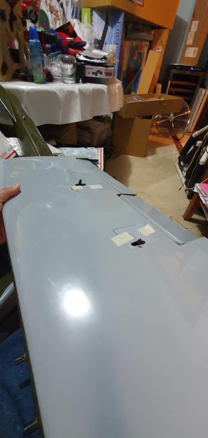

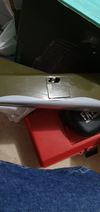

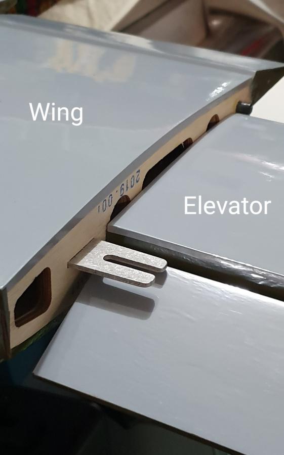

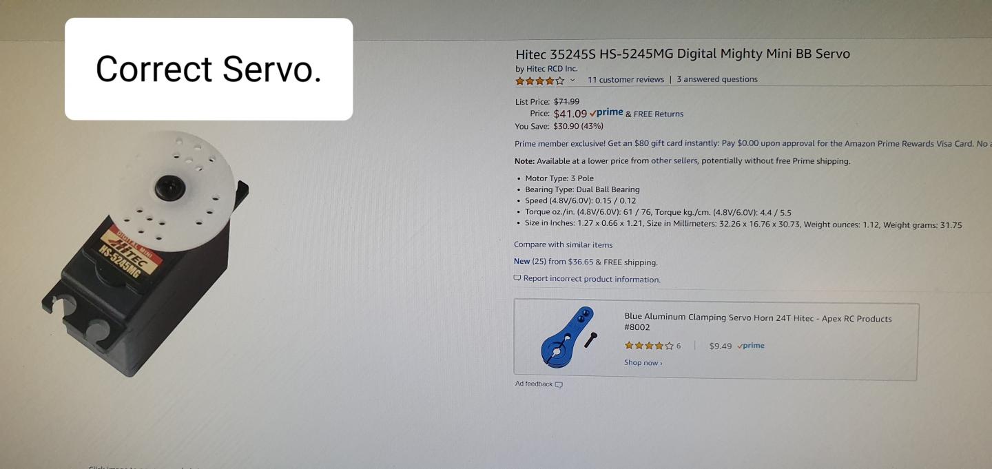

                                          In the case of the elevator, since it is much thinner than the wings i was obligated to search for a servo that can fit. I bought the Hitec 35245S HS-5245MG Digital Mighty Mini BB Servo. By the way, this one has the right measures for the plane. ( Use the Mini type Servos) so you guys don't confront what i did because of buying the standard ones.
                                          Photos showing what i meant.
