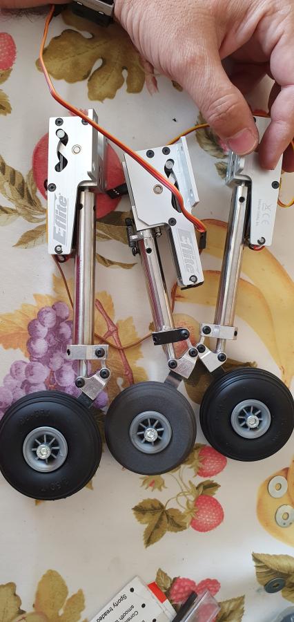

    I went with the 2 1/2" Dubro Low Bounce wheels for the mains and on the nose the 2 1/4" Dubro Super Lite Wheels. (Was the one i found stored in my boxes) 😉

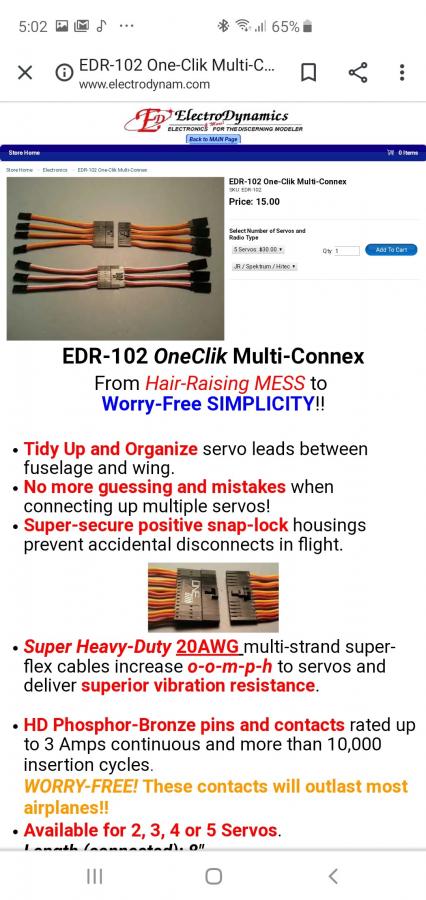

      #362

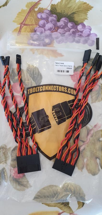

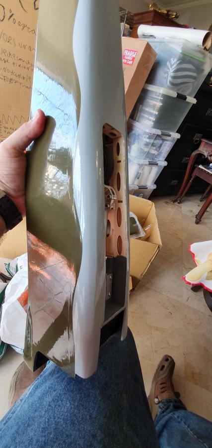

      On the booms wiring, i decided to use this type of connectors, one side with 4 terminals and the other of 5 terminals (ailerons, flaps, gear, rudder, elevator).
      Attached is the link for the ones that want to buy those connectors ( they are not cheap) 😟

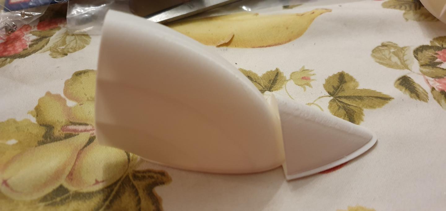

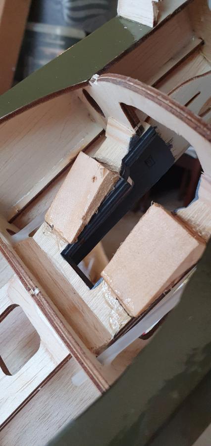

        #363

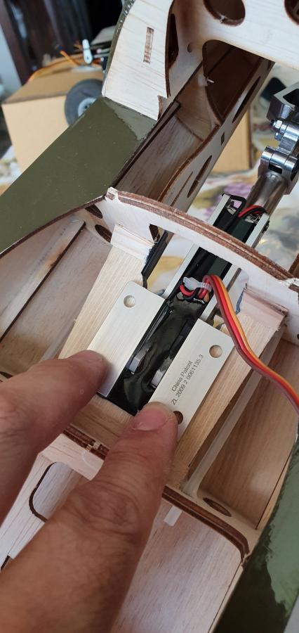

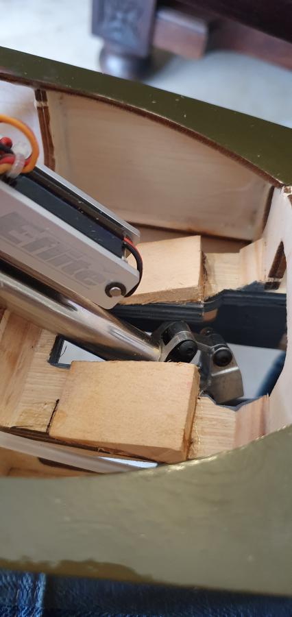

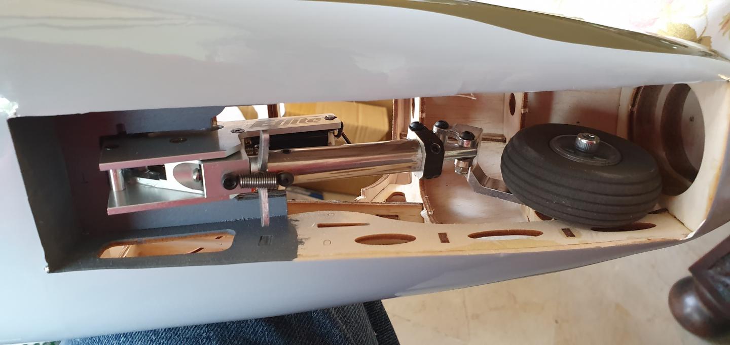

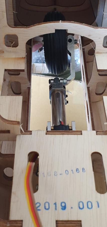

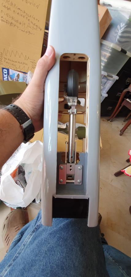

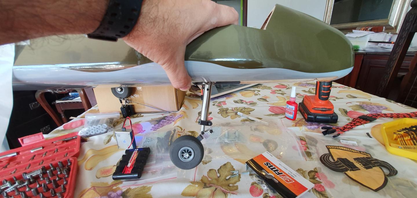

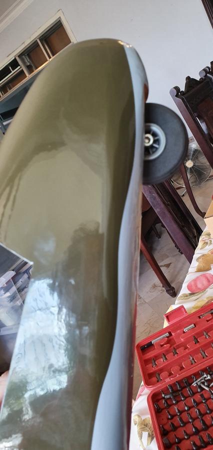

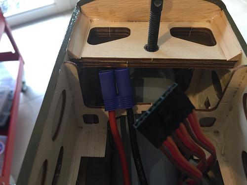

        I'm on the gears installation and the mains are flawless but on the nose is another story... the wheel protrudes a lot from the fuselage, so i think i will need to do some base attachment to gain degrees inside on the retract base to hide the wheel when is retracted.
        • wrangler1
          • Feb 2019
          • 116
          • Dominican Republic

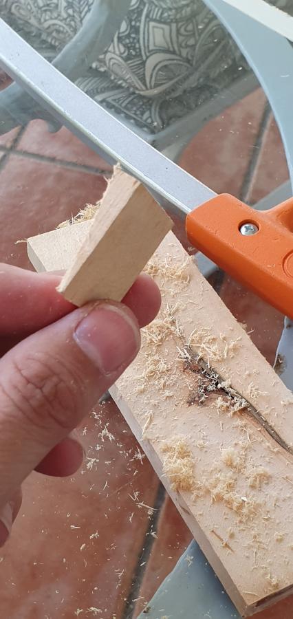

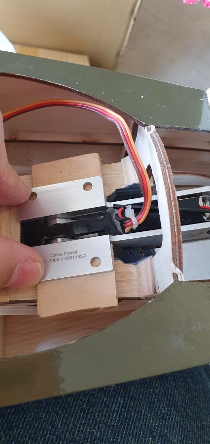

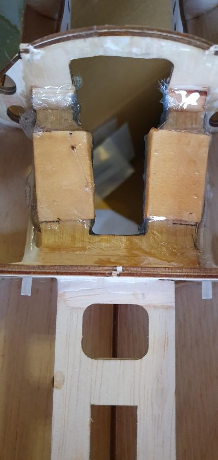

          #364

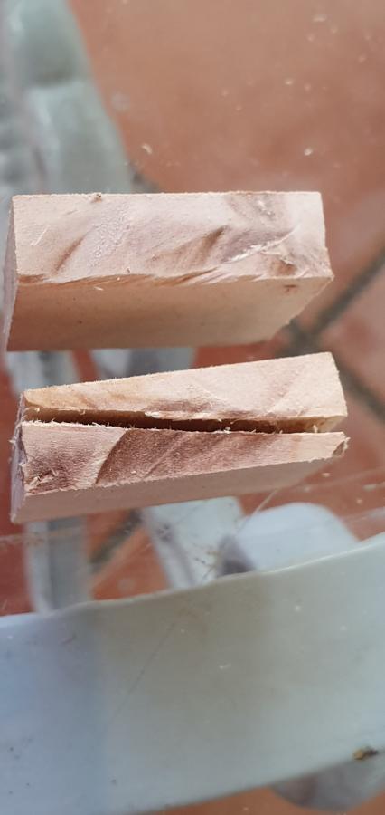

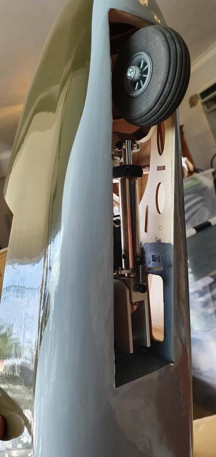

          i just fixed the situation with the nose Retract, i made 2 wood triangles and glued those to the base. That gives me the exact position to hide the nose wheel.
          And to be secure i will cover the base with a coat of epoxy and fiberglass so the wood doesn't broke or separate from the base.

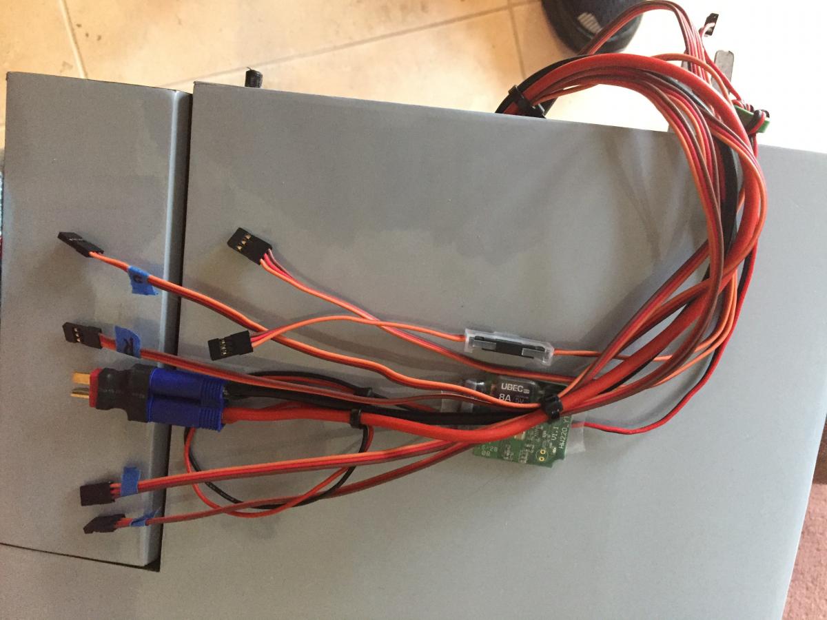

            #365

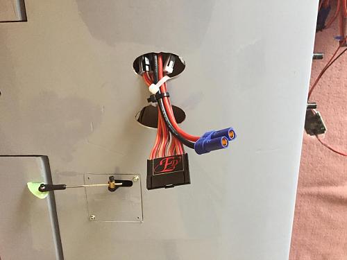

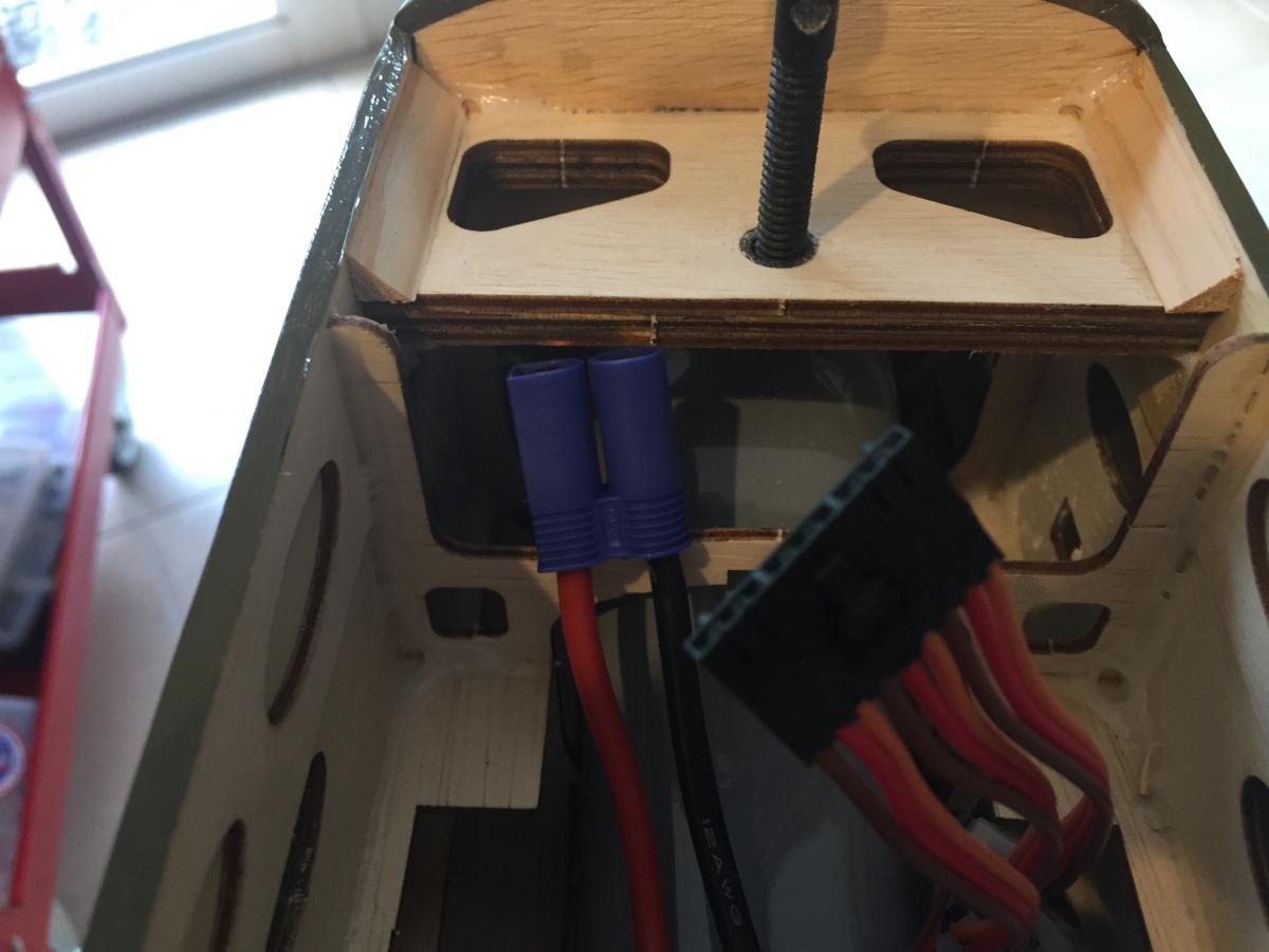

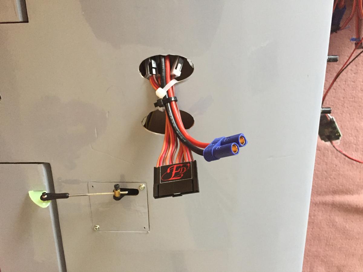

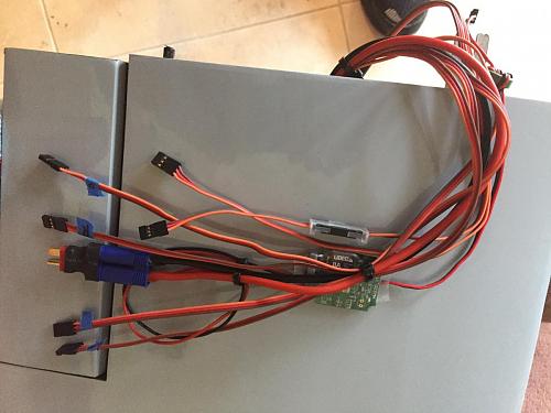

            Wrangler, just thought I'd show you what I did for wiring. I used the connectors from Electrodynamics. As you can see, the motor pods only have 3 connectors on one side, throttle, rudder, and gear, and the other pod has 4, throttle, rudder, gear, and elevator. The ailerons and flaps will come out of the wing into the main harness. Then both harnesses have to be joined by wyes for the receiver. It looks complicated but labeling each wire is essential. One of my previous photos show just what you found in that the front nose gear does stick out a bit. Wait till you have to rig up the pull-pull system for the steering. I tried to put a steering arm on the nose wheel but there wasn't enough room without cutting away balsa. I will revisit the steering if I have a problem. Click image for larger version
ID:	205668Click image for larger version
ID:	205669Click image for larger version
ID:	205670Click image for larger version
Name:	IMG ov-10 2.JPG

              #366

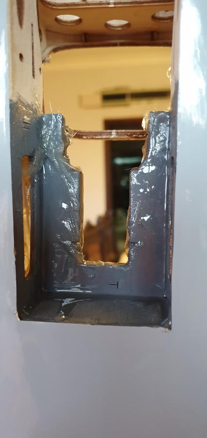

              I just fiberglass the base of the nose retract. Lets wait a few hours to see the results.

                #367
                Your on it wrangler, as i believe the retract mount for the nose still would allow the wheel to hang out if using a 90 degree unit? As in one of the pics with the nose strut extended, it has a fair amount of rake to the rear being its 105 degree so the wedges are a perfect fix. I received my Robart order today so i also can start on gear install. Ill post pics as i go through the setup.

                  #368
                  Originally posted by Rosytime
                  Wrangler, just thought I'd show you what I did for wiring. I used the connectors from Electrodynamics. As you can see, the motor pods only have 3 connectors on one side, throttle, rudder, and gear, and the other pod has 4, throttle, rudder, gear, and elevator. The ailerons and flaps will come out of the wing into the main harness. Then both harnesses have to be joined by wyes for the receiver. It looks complicated but labeling each wire is essential. One of my previous photos show just what you found in that the front nose gear does stick out a bit. Wait till you have to rig up the pull-pull system for the steering. I tried to put a steering arm on the nose wheel but there wasn't enough room without cutting away balsa. I will revisit the steering if I have a problem. Click image for larger version  Name:	Wire 1.JPG Views:	0 Size:	76.4 KB ID:	205668Click image for larger version  Name:	Wire 2.JPG Views:	0 Size:	77.8 KB ID:	205669Click image for larger version  Name:	Wire 3.JPG Views:	0 Size:	102.5 KB ID:	205670Click image for larger version  Name:	IMG ov-10 2.JPG Views:	0 Size:	48.8 KB ID:	205671
                  Thank you so much, i will keep in mind what you did on yours,.. and why do you have a UBEC attached to a wing instead on being on the fuselage?
                    I didn't realize that the Eflite nose gear had the flange opposite of the action, unlike the mains where the action is between the flanges. My nose gear hasn't arrived yet, only the mains. I will be interested to see what James has when he shows the Xwave nose retract. The nose gear retract in the manual looks nothing like the E-flite unit. Thanks for posting detailed pics of your solution. I'm gonna start working on the same.

                      #370
                      Great !!!!. yes i'm on it today and i hope tomorrow too. Yesterday i was thinking that i wouldn't be able to do more things on the plane due to the remodelation in my house. I had to give my office and working space to make a TV/family room and everything is a mess now, but i received a boost when the replacement wing got to my home this morning. So i put my dive mask 😆😆 and swim between boxes to find my tools. jejeje. and there is the result !!!.

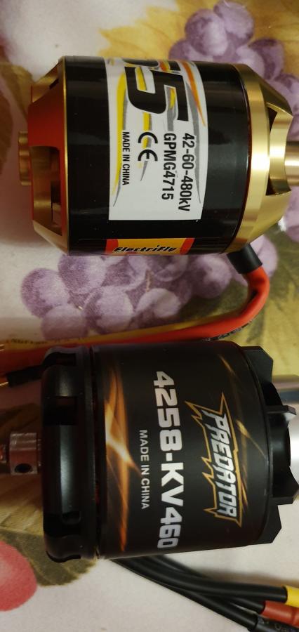

                              #374

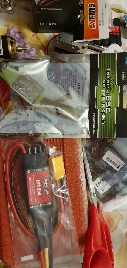

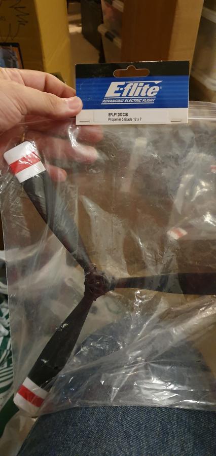

                              I'm jumping between ideas, and now a bunch of silly questions but i need opinions.
                              What engine should i use for this plane?
                              - Rimfire .55 (46-20-480kv) or
                              - Predator (4258-kv460) the one that the FMS F7F TIGERCAT has.
                              Also what prop too?
                              - The Eflite 3 Blade 12x7
                              - The FMS 3 blade 13x9
                              And what ESC is better?
                              - Predator 85A ( installed on the tigercats)
                              -ZTW MANTIS 85A ( recommended by MRC)
                              • wrangler1

                                  #376
                                  Also what prop too?
                                  I have the Rimfire 55 in a 7.5 lb Phoenix models Spitfire and with a 5S battery, that puppy moves. Unlimited vertical. I like the FMS 13x9 T-28 3 blade prop. Especially with the Rimfire motor. I think it looks like a turboprop prop. I will absolutely separate the stabilizer from both booms when disassembling the bird.

                                    #377
                                    Thank you, i appreciate your opinion. and it will look as a turboprop when i put these on..well that's what i wish . 😉

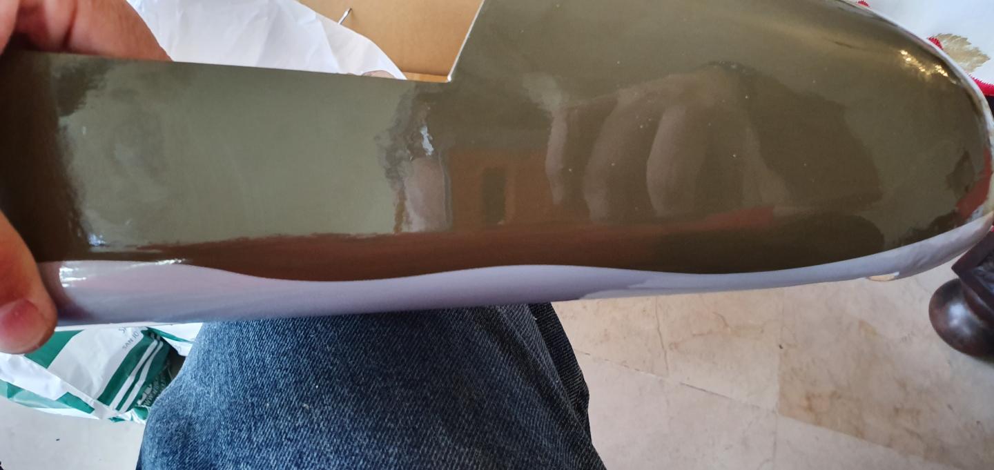

                                      #378

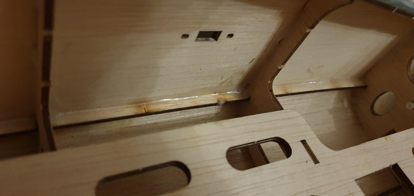

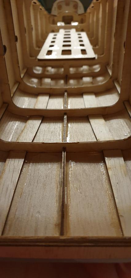

                                      I just did some reinforcement on the fuselage with CA. A little just to be on the safe side.

                                        #379
                                        What ESC are you using with the Rimfire?

                                          #380
                                          I'm using an E-flite 80 amp ESC. Mainly because I had one laying around.
