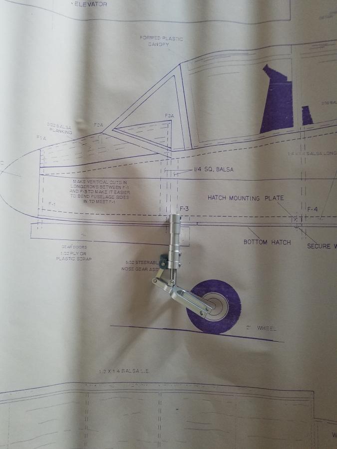

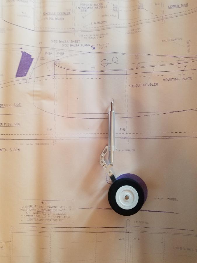

        Ok gents, I have the HobbyHangar/Uravitch 52" kit. Still virgin too!!! SO here are the pics of the T45 mains and Yak nose struts placed on the plans and can give a good size relationship
        for reference. I have a Turbinator jet and looking at the nose strut for that, i think it may work if i can machine a longer link to move the yoke closer to horizontal, not fully flat.

              Originally posted by sam51401
              Did they mention if the set will have just 90 degree range or would the nose possibly have greater like 105 degrees? EFlite made a 60-120 nose unit that was 105 but they are discontinued. I happen to have one in my 90mm Hawk so it may have to be reallocated to the Bronco. Would be nice if the mains came as 95 degree!
              I was thinking the same. 90 degree I don't think will cut it. I need to look at all my options.

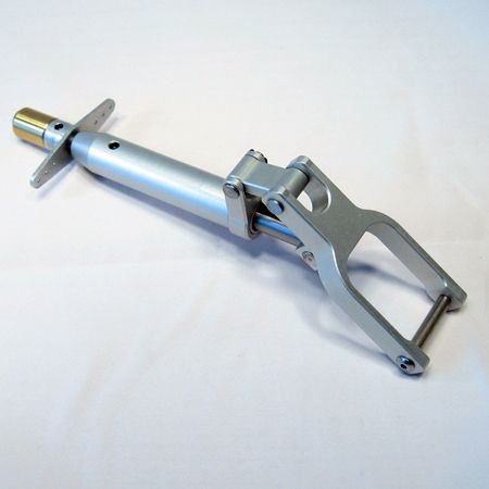

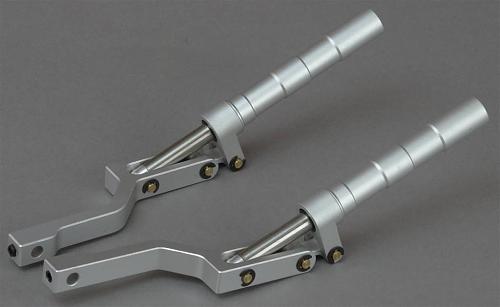

                Here's what I've been eye ballin from JP Hobby for the main gear struts.
                https://www.falconhobbysupply.com/jp...-jp-hobby.html
                Click image for larger version  Name:	Bronco jp-hobby-jphst1004-10mm-main-landing-gear-jp-hobby.jpg Views:	0 Size:	49.7 KB ID:	201647
                I'm right there with Sam and haven't changed my mind yet about the YAK 130 nose strut.
                Just will have to pony up on this Bronco;) :Silly:for the 105 degree nose etract by Robart............two options.
                https://robart.com/collections/retra...obostrut-ready
                https://robart.com/products/105-deg-...obostrut-ready

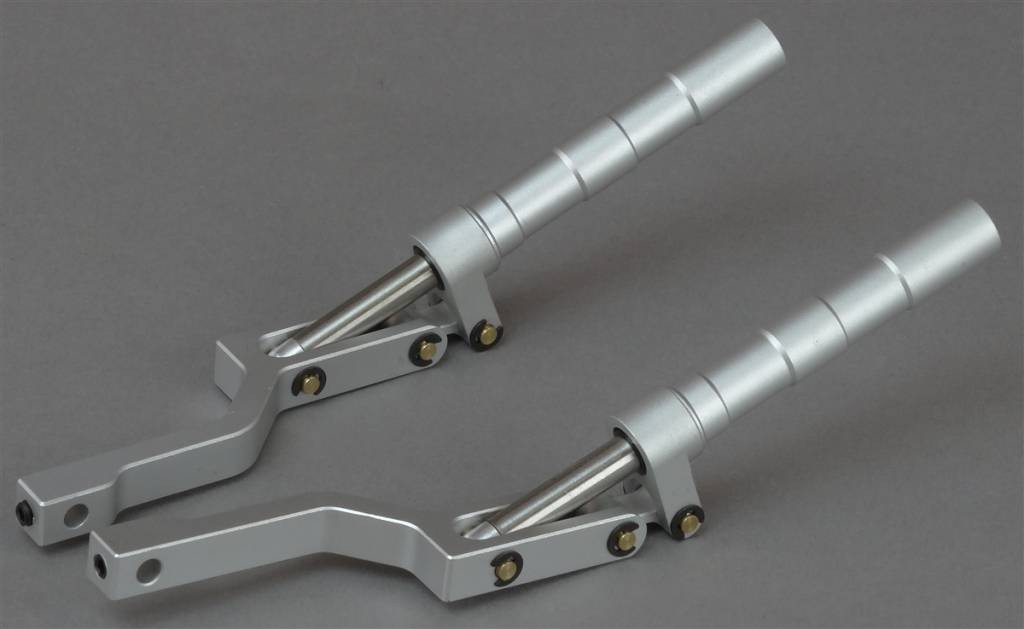

                  Any measurements on those JP struts to get a size ref?
                    #269
                    I'm pretty confident that they are for the Sebart 1.8M Avanti XS ;)
                    See the link to the complete JP Hobby electric landing set for that Avanti at RC Castle
                     - Suitable For Sebart 1.8M Avanti XS Jet or Other Plane Up To 6 - 12Kgs.- With 65mm Electric Brake System.- Working Voltage:  7.4V - 8.4V ( 2S Li-Po )- Strut Diameter: 12mm- Retracts Mounting Plate Sizes: 36mm x 48mm- Front Wheel Diameter: 50mm- Rear Brake&nbsp

                            Our thoughts are that the stock struts would be fine with the recommended 90 degree retracts and all work as designed. Now if a more scale looking strut was to be installed then a 105 degree on nose would be needed to fully raise the trailing link wheel enough to not hang out. I’m still working out ideas on this and searching with what’s offered on the market without doing costume work. My go to on the front so far could be the 7/16 trailing link gear strut from Robert that takes up to a 3” wheel. This would need the 105 retract to raise it up fully. There is a next size up of same design at 1/2” strut and up to 3 1/2” wheel. Since EFlite disco’d their 105 degree unit, the only option I have seen is the Robert for a nose retract.
                            As for the mains, after posting pics of the T45 mains laid on the plans of the 52” kit, I believe a more sturdy strut is needed due to the higher weight over what those struts were designed around. At this point I may go with stock supplied main struts till a more suitable solution comes along or I break down and build my own. If Century Jet was still around, they would be my go to. I may ask around to see if any parts or anything was left after they closed shop.
                            The reason I say this is that they were local here in Louisville and club member has built from plans from MAN article a 70” Bronc. He has installed the full CJ retract set and they are perfect. He had to stop work on it because there was no full canopy offered once he got to that part of construction, that was until now that the ProFly canopy is an exact fit to his and new interest in completing his build has risen.

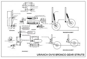

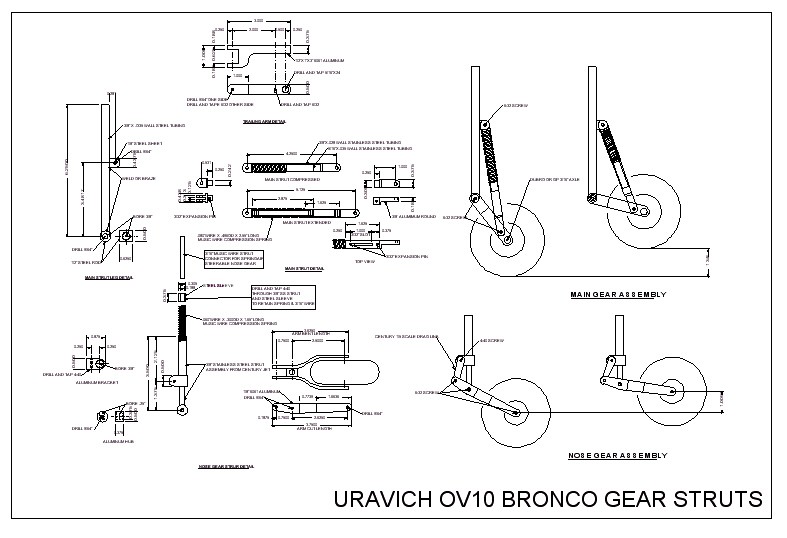

                                          I found the web site and here is the link to his offerings for the 80" and 96" ws Bronco's. I like the work but since i and others aren't looking to fly at Top Gun, the price doesn't fit the goals that this ARF can offer us of a lower cost alternative to the KMP Palmer and ScaleTech planes. It would be truly nice if he could offer a set of struts at a price point under $200 and they dont have to be totally scale nor would i expect them to be at that price. A nose strut that could work with the Eflite(105 degree) and the new Xwave units that can hold a 2.75"-3" nose wheel would be great. If the mains could look the part and maybe hold the "on ground" position with weight off but with a little absorption, this could work great in that they would fit up in the booms without modifying the wheel well area or moving and carving bulkheads.
                                          Now in a build thread for the 81" version( onr RCU) there is a drawing of some home made struts for the 52" version. Check it out!;)http://www.rcuniverse.com/forum/twin...o-81-a-14.html
                                          gsmith is the designer and his email is in the post, but warning ***its a 2006 post***, to request a cad file.
