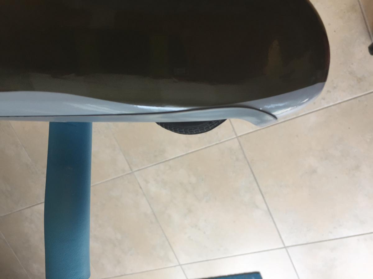

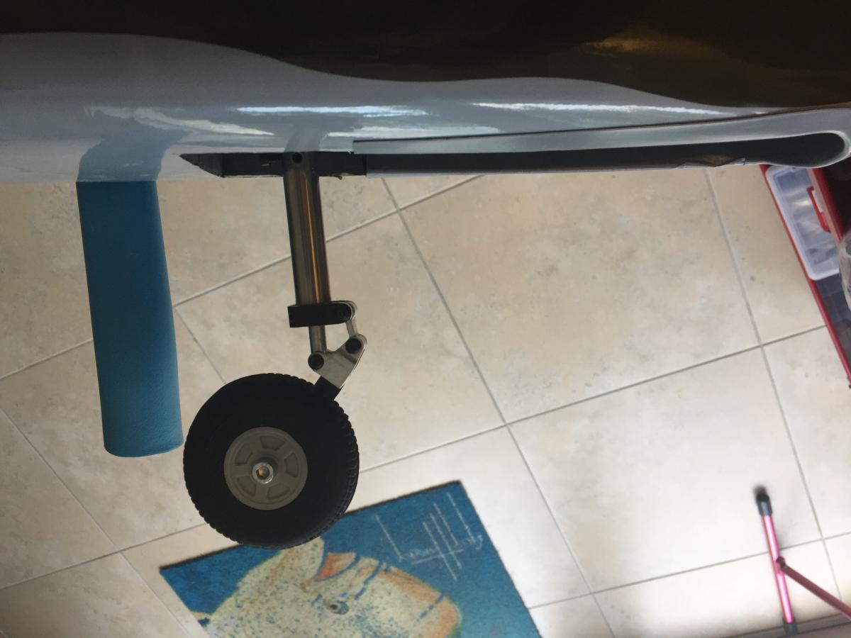

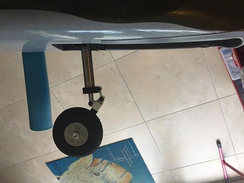

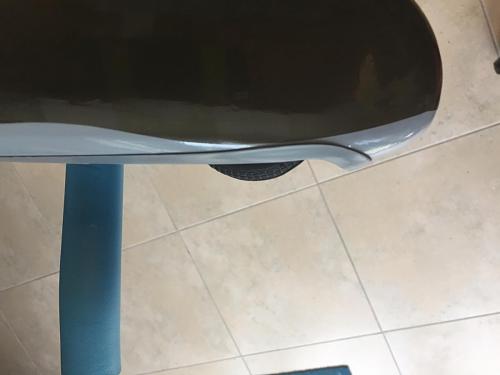

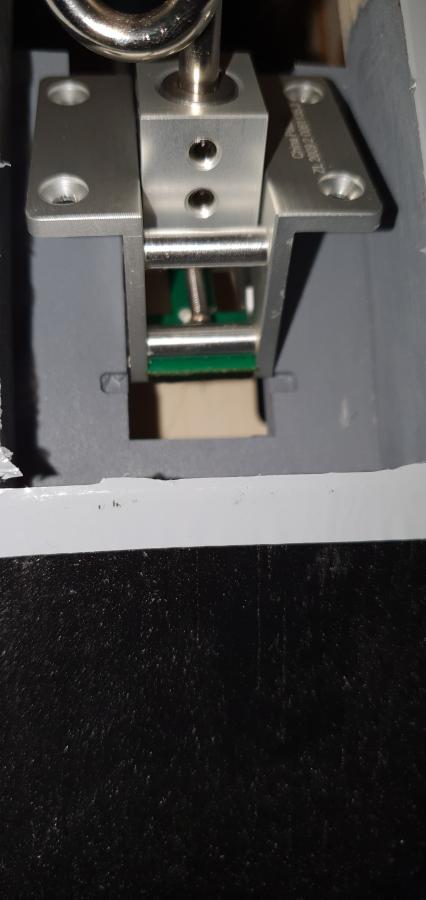

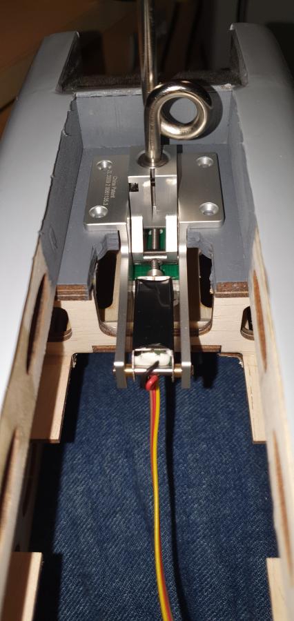

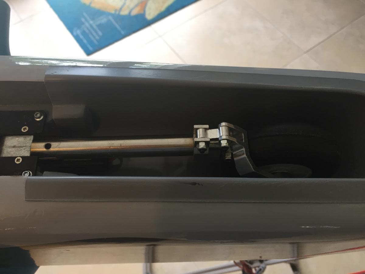

    I just did a fitting test of the Main Retracts. They fit perfectly !!!

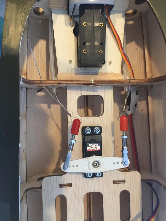

        Originally posted by Rosytime
        Stuart or Alpha, I just got the Bronco and looking at the specs it recommends for servos the HiTech HS-485HB. The problem is that it will be too big for the space allotted for servos in the hatches. It's 39.8mm long and as you can see by my pics the opening is only 32mm. A HiTech HS-225BB mini servo fits it perfectly. The manual also again says use a 6s lipo with a 25 3526 870kv or a 35 4220 770kv motor. So why the discrepancy from the web page and the manual. I never did get an answer on what motors and ESCs were used when it was flown on 6s.
        Rosytime hit on the servo issue back on post #59 and called out the 225bb servo. I went on the Pichler web site and compared their servo requirements to the 225 and decided on 225MG.
        Maybe Alpha can but an amendment in the original post and get the website page description updated before others find out the costly way or start complaining.
        Snip from my post #303
        ” I found 3.0kg/4.8v and 3.5kg/6v listed in the specs and looking at the HS-225MG, its 3.9kg/4.8v and 4.8kg/6v.”
        Im not not saying your wrong wrangler, just trying to point others to information that has come to light in prior post. Please keep your build pics coming so we all can have better insight.
        Like the highlight on the EFlite retracts as a option till MRC can get the XWave sets in. That will help greatly. I’m considering calling Sierra and ask for a set of struts but not sure of the cost.
        I did find the 668 Robert nose strut for much less than direct price from Robert so that’s ordered now.:Cool:

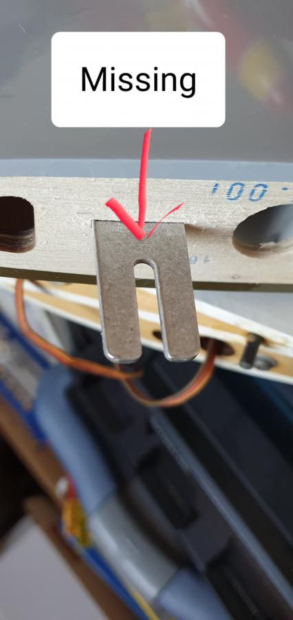

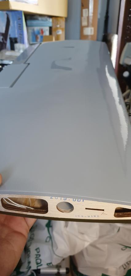

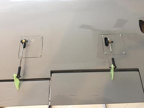

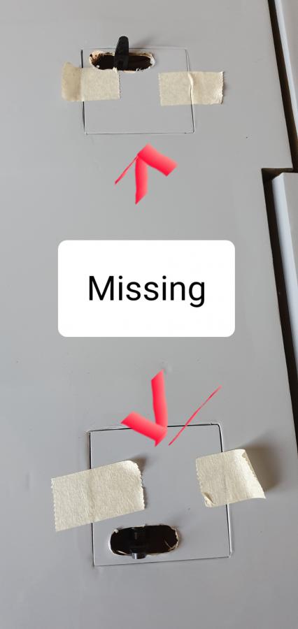

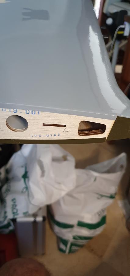

          Jajaja....the wing assembly is on a halt now, my right wing came without the servos base made and without the wood piece that goes on those holes too. and the "U" shape metal bracket that attach from the wing to the fuselage is missing too.
          I just wrote an email to MRC to see what they will do. Is a shame because i was on a good rythm building to stop !! 🙄

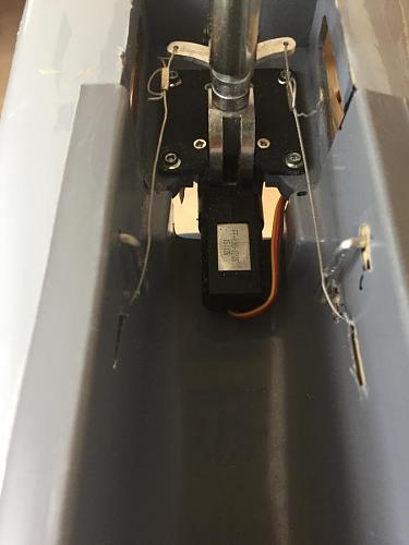

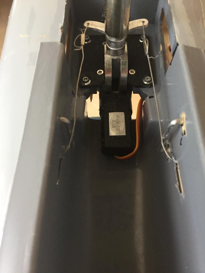

            I continue to plod along on this build. I found that the retracts from the Freewing A-10 work perfect . The A-10 weighs just a tad less than this model when loaded with batteries so they should be okay for now. I'm waiting for the recommended retracts to come into stock and then I'll use them since the A-10 retracts are all plastic. I guess it's a good thing I kept all those parts from my crashed A-10 since it's providing the retracts, ESCs, BEC, and the long battery leads needed for this bird. I'm sorry that I haven't provided any photos but I'll try and get some posted in the next few days. I tried to use a steering arm for the front nose gear but it just wont work with the space available. I went ahead and use the pull-pull system they supply and what a pain. A little grind here and there and the steering arms don't hit the servo plate. I'm assuming that the metal retracts don't have this problem. The system is not a direct shot but turns a 180 in the fuselage. Look at the instructions and see what I mean. It works but I'm not happy with it. If I can figure out another way I'll try that.
            So now that the retracts are mounted, I just need to put some servo extensions on them and start getting all the wiring rigged in place. If you haven't looked, there's a lot of extensions used to bring it all to the fuselage. I then want to figure out a way to make it easier to take the plane apart and not spend 20 minutes putting back together all the wires. I know about the multi servo connectors but with all the wyes needed it's get complicated.

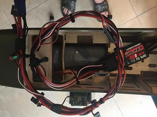

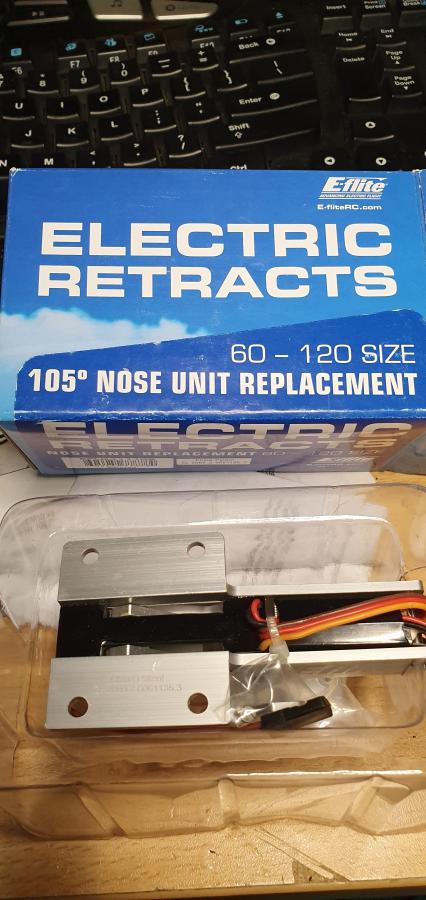

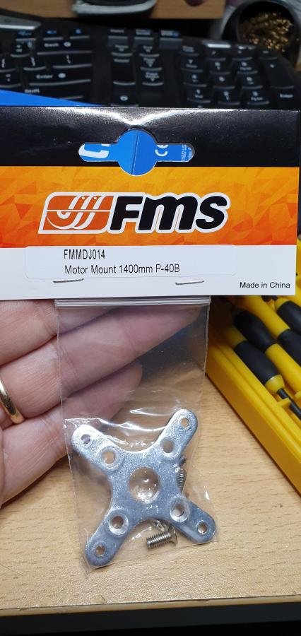

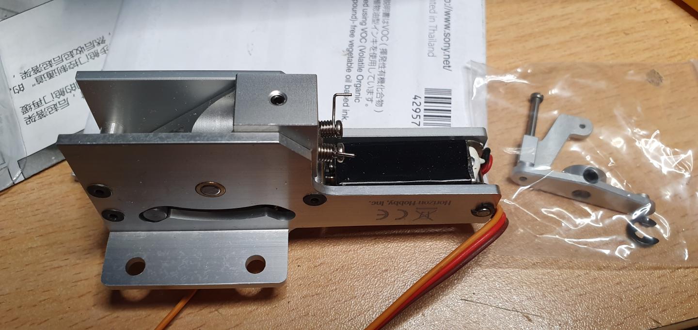

                                  Update..... MRC is sending a replacement wing in exchange for the incomplete one. Also i received the EFLITE NOSE RETRACT of 105 degrees, im just waiting for the YAK gears to arrive so i can test it.
                                  For the ones that choose to put the FMS F7F TIGERCAT power plant on this model, be aware that the motors comes without the metal "x" plate, you have to order separately ( That was my case and i ordered them directly from FMS).

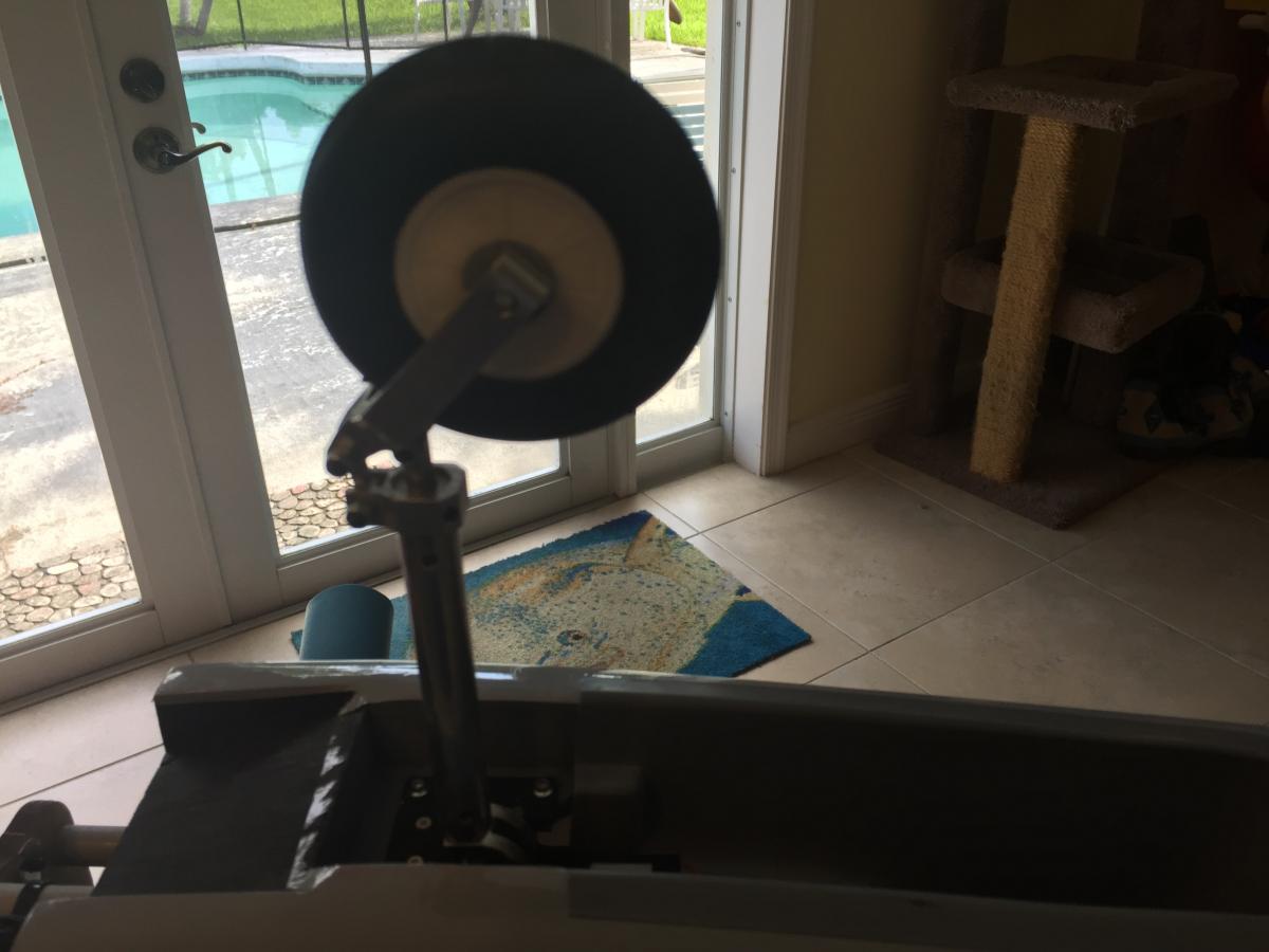

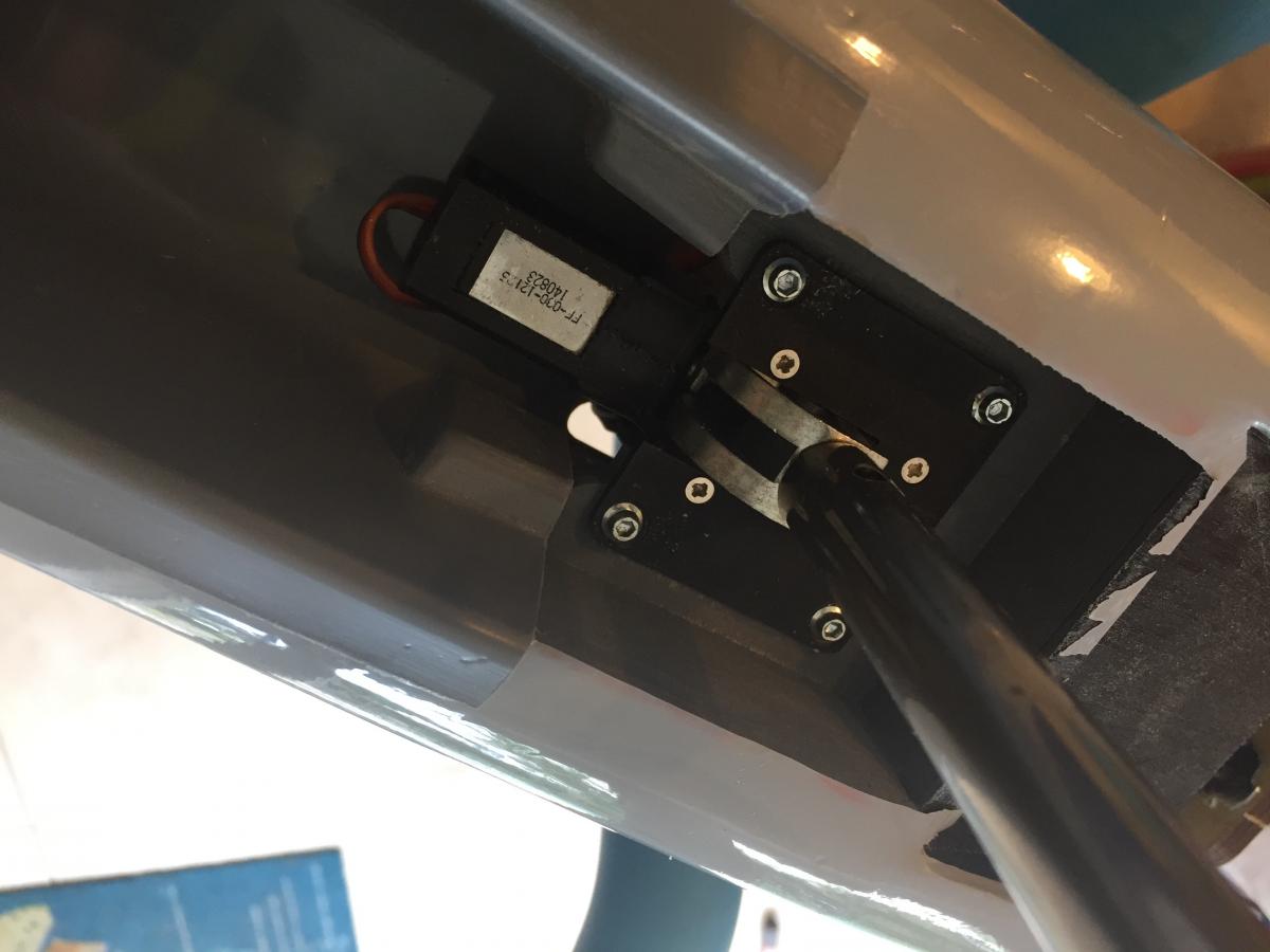

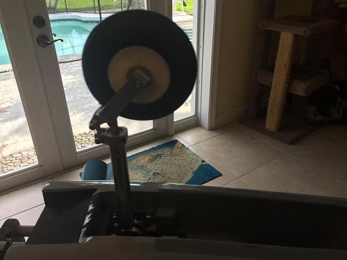

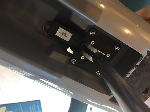

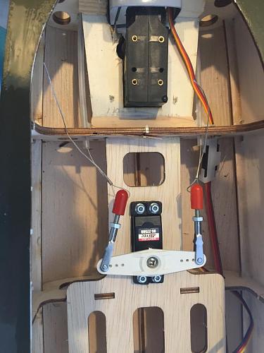

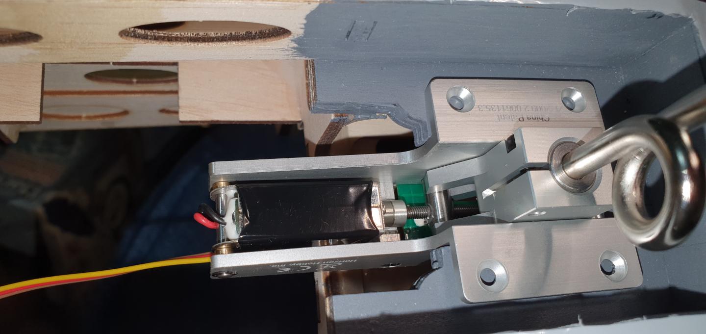

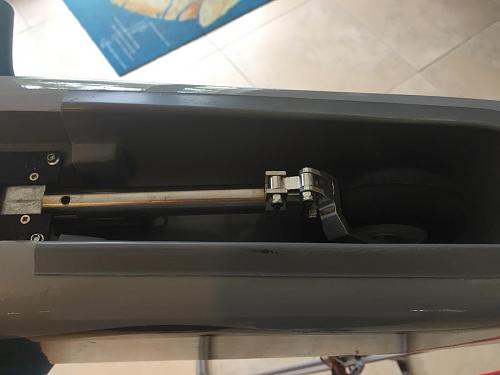

                                    I have some photos of my progress. You can see the nose gear retracted and extended and you will notice the nose wheel sticks out a bit. Also, it is raked forward as mounted. You can also see the wire harness that is for each boom. The only difference is that one has an extra servo wire for the elevator. I have decided to get the multi servo connectors for the booms so that when I want to disassemble the plane I can leave the bulk of the harness in the wing. The battery leads will have another EC5 connector in line to accomplish this along with the multi connectors. The harness comes out of the fuselage easy enough so that's not a problem. I might put another multi connector for the receiver to try and make it easier to hook all the servos up on that end. It's getting close to assemble and start doing the CG and servo throws. Also check out the pull-pull system for the nose wheel. Not to my liking but it works. Click image for larger version
                                      Where did you get the 105 degree retract? Thanks for the updates.
