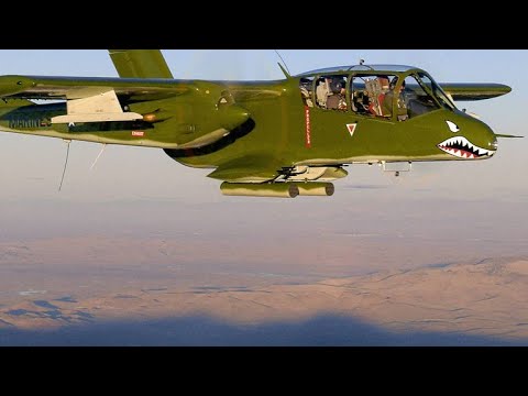

    A Bronco video on Youtube.

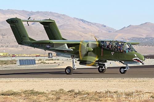

    Yeah, this video is why I chose this livery for mine.

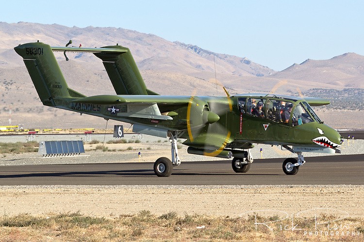

    My graphics should be here any day. I'm about ready for final assembly.
    Mike Click image for larger version  Name:	bronco-AV155506.jpg Views:	0 Size:	140.7 KB ID:	218424

    good to hear they fit. I ordered the same graphics, just had her change the Bureau number.
