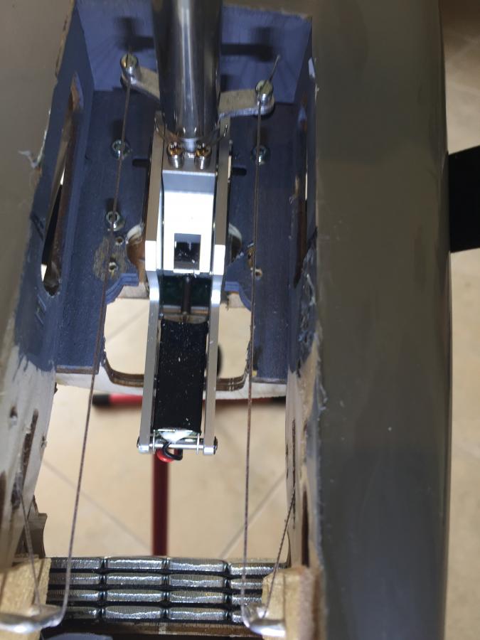

  • Rosytime
    I wound up putting almost 6 oz of weight in the front of the plane. . I might try and put it in the forward part of the nose to see if I can take some dead weight out. What you see in the pic is 4 oz of steel weights. They're bigger than lead weights for the weight but it's what I had on hand. If I go to a servo in the nose as another flier has, I can reduce the amount of dead weight needed. And yes, I was surprised how much was needed but this is a heavy plane all around.

  • axerhand1976
    wow rosytime that looks like a lot of dead weight in there? how much did you need. thx

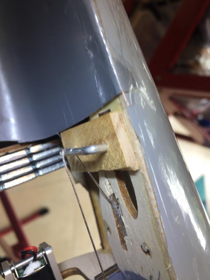

  • MikeT
    Originally posted by Kangi1954
    In 15 years in the hobby, this is my first pull/pull. And most of my planes have been balsa. But mostly tail draggers. I’ve also never had twin so that’s new for me too. Always learning.
    That's part of the fun doing different stuff and figuring out the best way to do it. Always learning even at 66.
    Mike

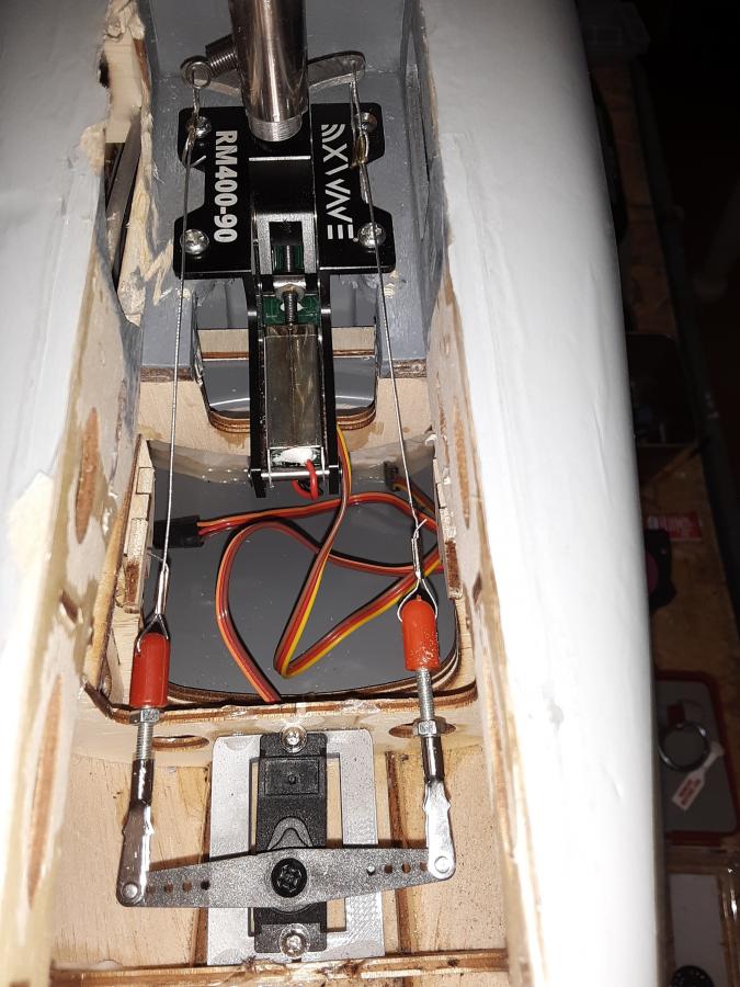

  • Kangi1954
    Originally posted by MikeT
    That's pretty much the SOP for most nose wheel pull-pull steering set ups. Straight forward and it works.
    Mke
  • MikeT
    That's an approach I hadn't thought of. Me like.
    Mke
  • Rosytime
    I was going to use a servo in the front but it didn't look like there was enough room with the wheel coming up. Might have to rethink it if this set-up gives me trouble.
  • Kangi1954
    Originally posted by Rosytime
    Somehow the pics didn't up load. Here they are. Click image for larger version
Name:	front gear 2.JPG
ID:	210227Click image for larger version
Name:	front gear 1.JPG
    This would certainly reduce/remove stress on the cable and tubing. nice solution.
  • Kangi1954
    Originally posted by walkerm45
    After trying the original directions, and not liking the results, here is my answer the nose gear setup..... then add doors or custom fit the plastic insert....... Click image for larger version

  • walkerm45
    After trying the original directions, and not liking the results, here is my answer to the nose gear setup..... then add doors or custom fit the plastic insert....... Click image for larger version  Name:	20190814_132638.jpg Views:	45 Size:	92.5 KB ID:	210250
