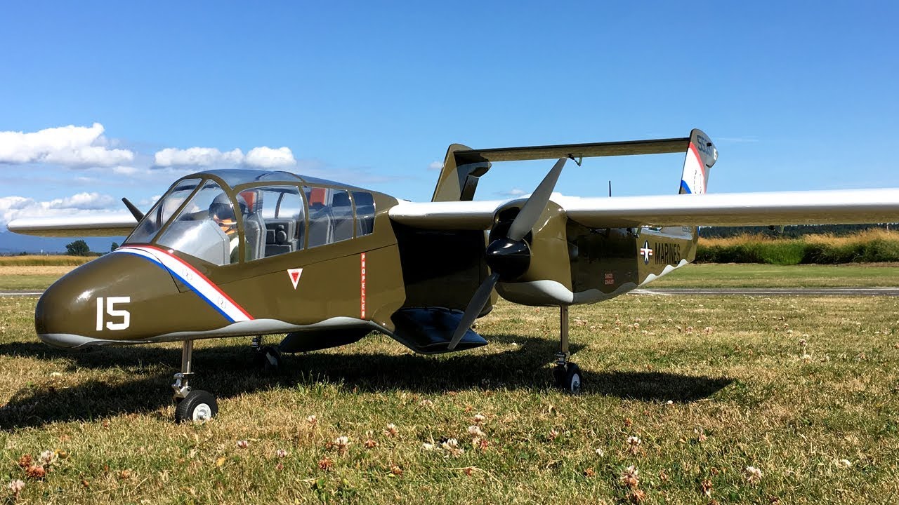

    I watched Robert fly his bronco all weekend, Ill have some vid eventually. What a sweet plane! I think the OV10 is one of those amazing designs like a T28, they just fly good!

    I got flight footage today of my buddy Pilot Robert (Different Pilot Robert lol) at Warbirds Over Whatcom. It is an electric setup and it flies so smooth. Anything indicating otherwise would be due to poor camera work, which is possible given that I recorded tons of flights with various Warbirds all day today.
    GB
