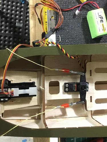

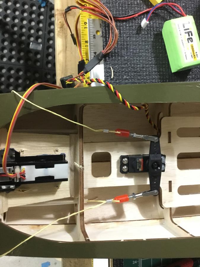

  • Kangi1954
    Originally posted by MikeT
    This is going to work. I used some of the included hardware Click image for larger version
ID:	218036Click image for larger version
ID:	218037 but not much.
    Mike

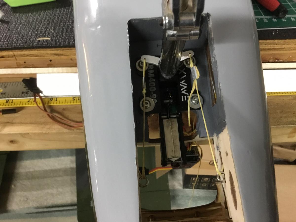

  • MikeT
    Mike

  • Rosytime

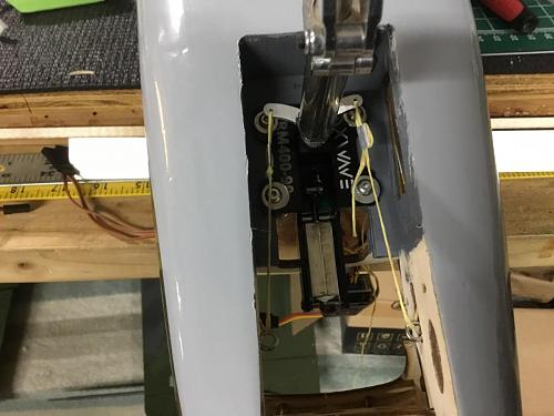

    I had problems after a few flights with the supplied steering hardware. Basically the wire started to dig into the plastic tube it comes out of due to the 180 degree turn. If you go back I had posted a pic of my solution, it was to move the u-shaped rod they supplied forward and have the wire go around it and then back to the steering collar. Haven't had any problems since. I also eliminated the turnbuckles and just used some ez connectors on both ends. Pull the wire tight and it works great. I did have to go to a bigger size wire but no problem. I do like the idea of the eye bolts to do the same as I did. As far as the other question about doing a loop, I haven't tried it yet. My set-up seems to have enough power but I usually fly it scale. It will do an aileron roll but it's not pretty. Not very axial. And yes I'm using 11x7 three bladed MAS props.

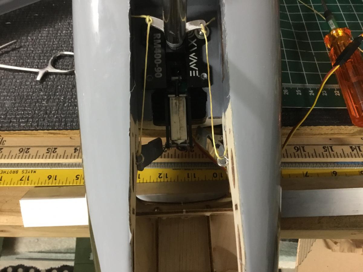

  • MikeT
    I think this will work out. Testing continues.Nothing is mounted or tighten yet.
    Mike
    Mike Click image for larger version

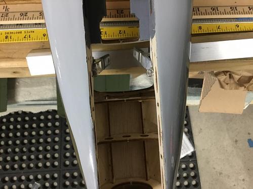

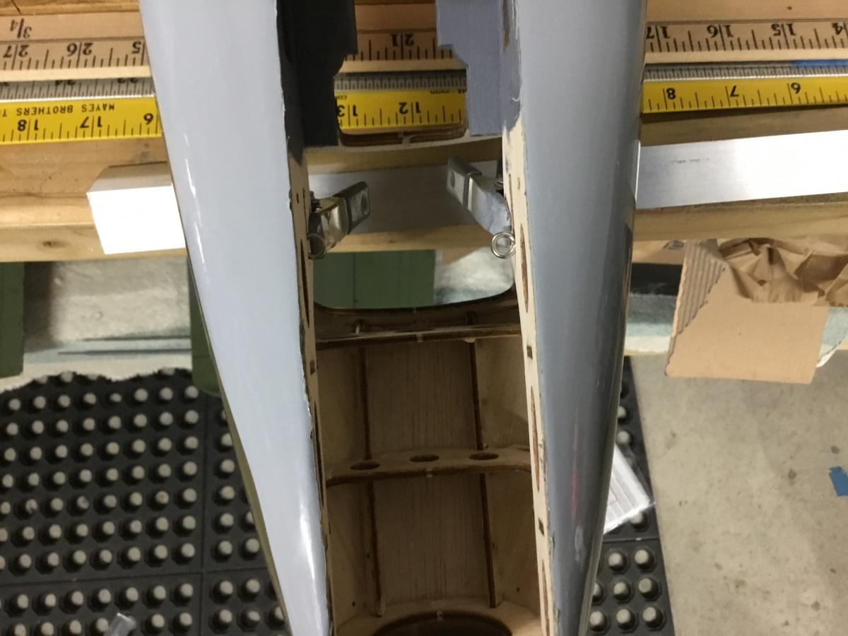

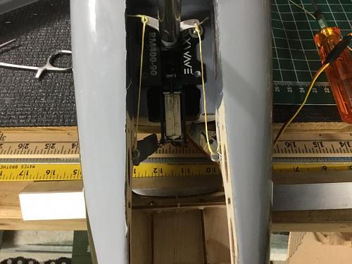

  • MikeT
    Thanks for the input. I'm mocking up my idea using small eye bolts rather than that aluminum bracket. It should serve the same purpose. I'm using different material that the supplied cable also Sullivan Kevlar pull pull stuff I had laying around. I'll test the set up before gluing anything.
  • James
    I had this set up in a balsa and ply sport/ trainer that was every bit of 7 1/2 lbs. and used a 13 x 6.5 APC and it flew really nice. It's a 640KV motor I'd like to go with a 3 blade prop. I'll be experimenting to find the best combo. I'm looking for scale performance. Mounted the mains yesterday with no issues and I'll tackle the nose gear today. I'm still not sold on the manuals steering set up but will just start on it and see where it takes me.
    Mike
    Hey Mike, I did the steering setup per the book on mine and it works great. Just make sure to tighten down the cables when the gear is extended and you should be just fine.
