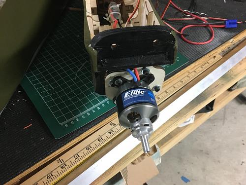

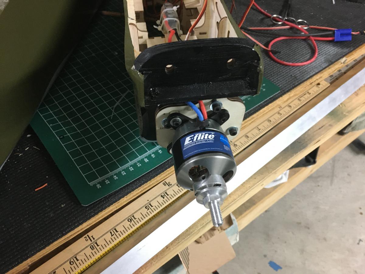

    I'm looking at 5S with Eflite Power 46's I think it will be a great match.
    Mike Click image for larger version
