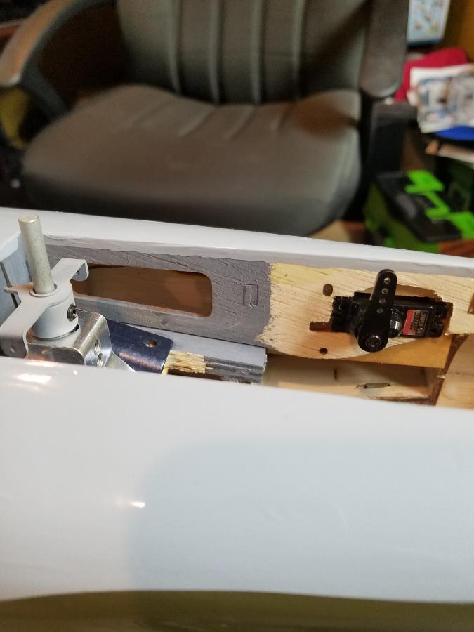

    OK, have the steering servos placed and the retract shim blocks in. The servos are HS65MG with 30 in/oz and since ill be using an arm connection shorter than 1", i should have over 55in/oz of torque from EACH servo on the steering. I placed a 1/8"ply mounting plate and made the opening in the existing frame big enough that the servo sits recessed. I plan to use a Dubro micro pull-pull kit but need to figure a suitable connection on the steering yoke that will allow the cable to go slack and not catch on any structure when the gear extends.

    Well i have decided on a steering solution using two HS65MG mounted forward of the retract. Ill post pics of the mounting tomorrow

    As far as the nose wheel goes, I also went with installing the servo towards the front, so it is a straight pull pull system.
