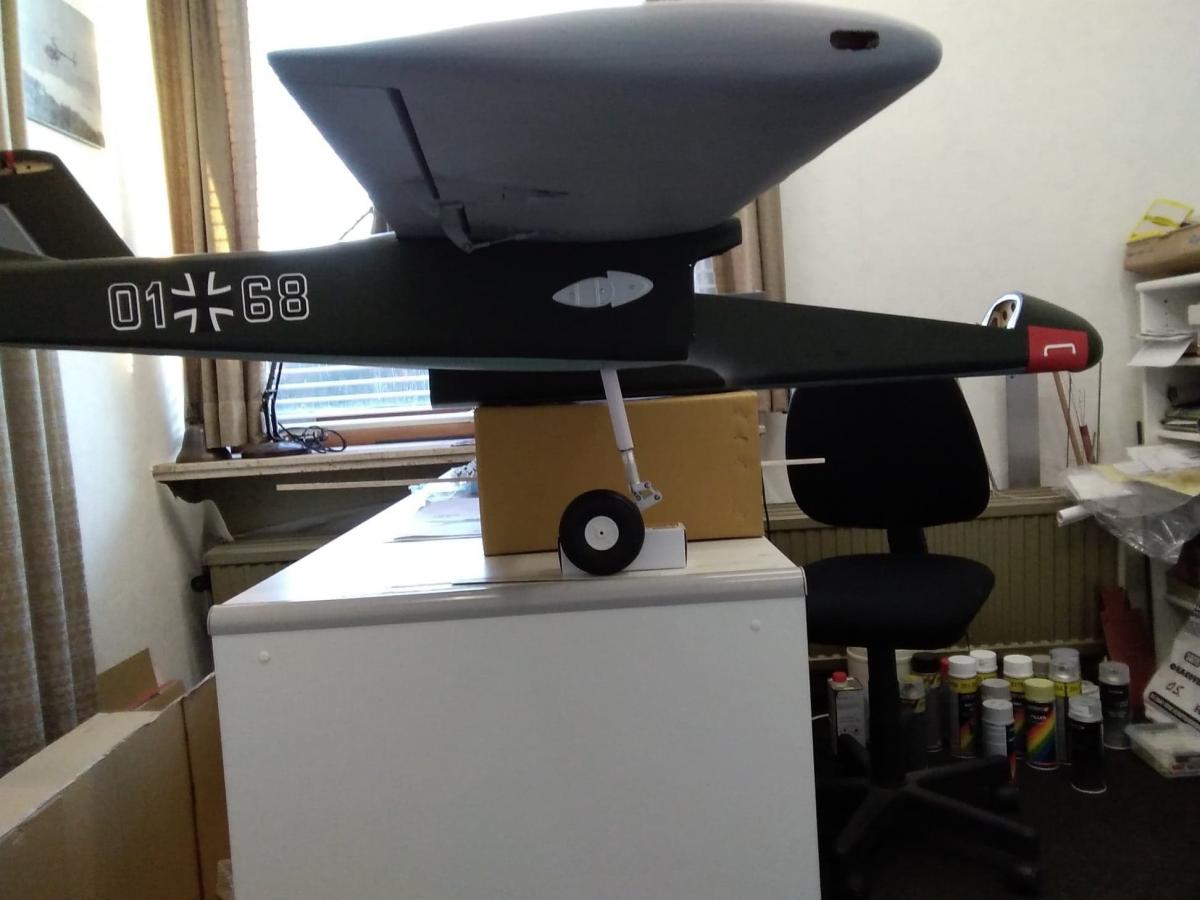

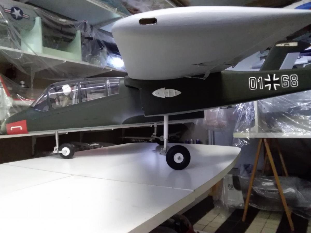

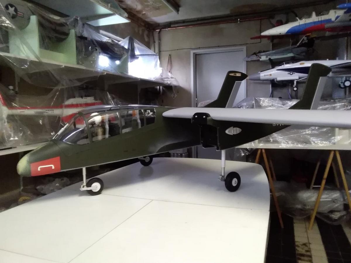

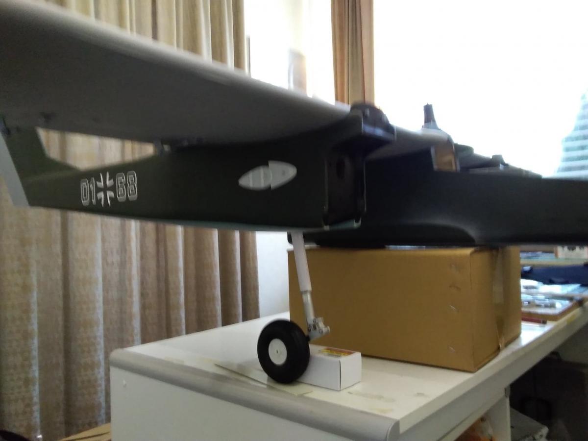

    Trial fitted the LG, i think this looks quite good... I calculated the lenght of the oleo, and will probably leave it this way... opinions? Wheels are 90 mm...
      Looks good to me, more so than the stock units it comes with. My runway appears smooth, but the geotex hides thousands of potholes under its stretchy covering. The functioning struts help. I got a couple flights in the other day. This is a low alt drop. I'm about ready to put a camera in the cargo box, but after the first attempt landed in the water, I've been a little cautious.

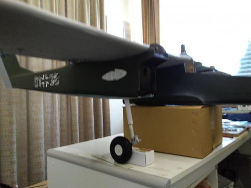

              Finally got the plane on it's feet to get the complete "look" I think it's almost spot on... Still need to add the springs in the oleo's, so it will sit a little bit higher, but not too much i hope...
                Didier
                I had originally thought the in box struts were way too stiff. Watching the slow video of what I thought were fairly smooth landings, I was surprised to see the suspension working so much. Your gear looks nicer. I'm curious to see how they perform for you.

                  That is something i noticed as well, they seem stiff but do work... Maybe a bit less would be even better... i'll see what i can come up with.. First need to finish the plane, finding the correct springs can only be done when it's fully loaded and finished.. still a lot to do...

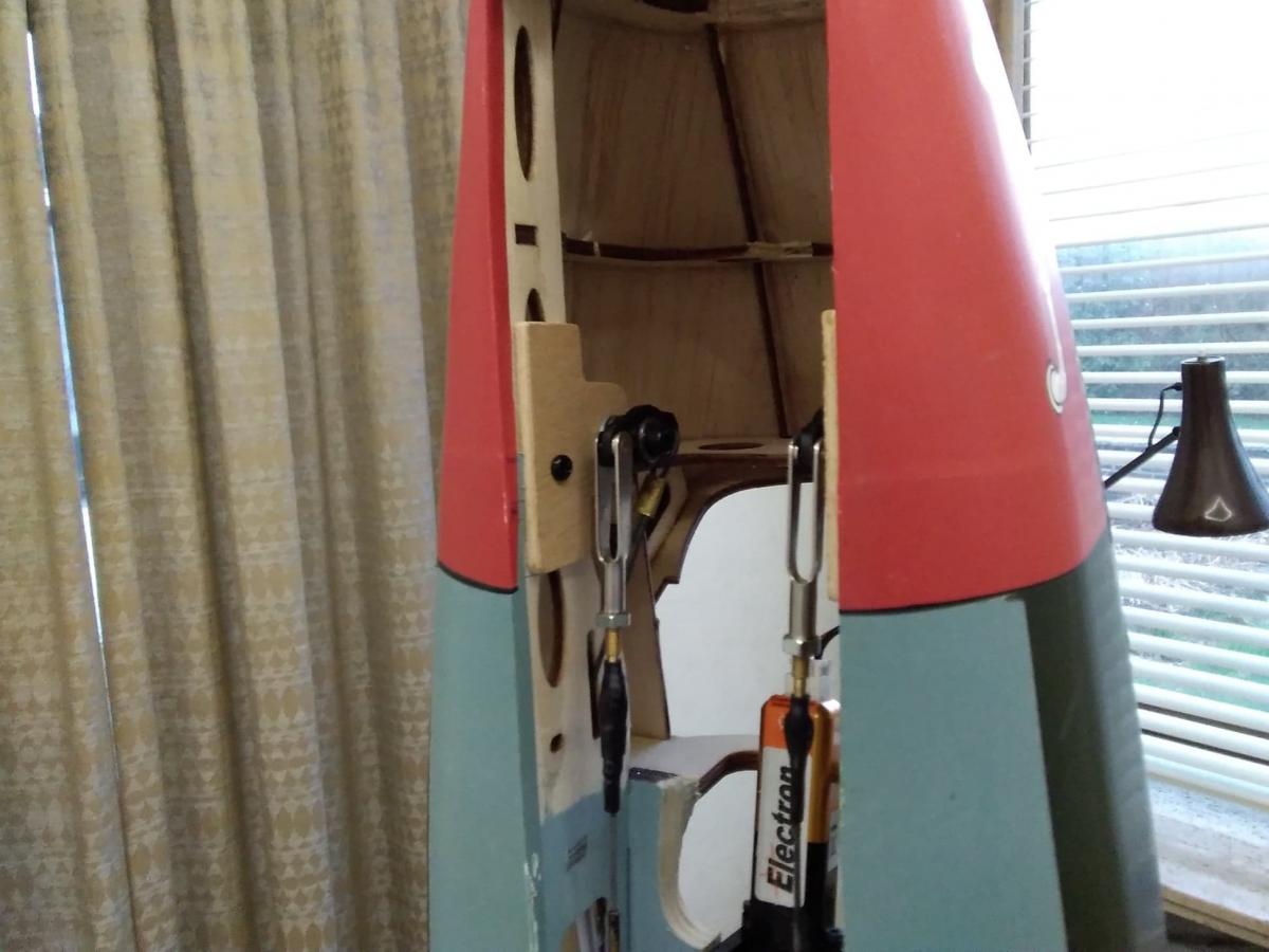

                                        In the meantime i've been working on the steering for the nose wheel, didn't like the original method used in the kit, so i came up with this... a servo arm with a bearing inside should work better i think...time will tell...

                                          didier n Nice modification, let us know how it works! Nice retracts, too... they're pricey but very dependable.
