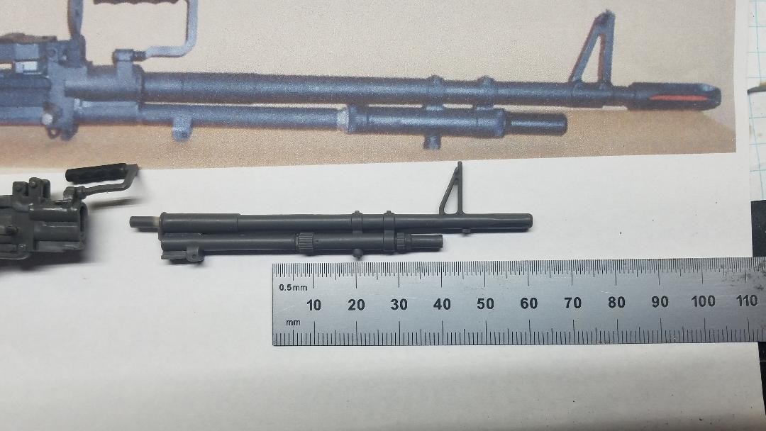

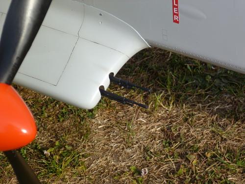

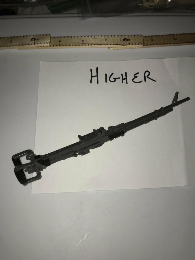

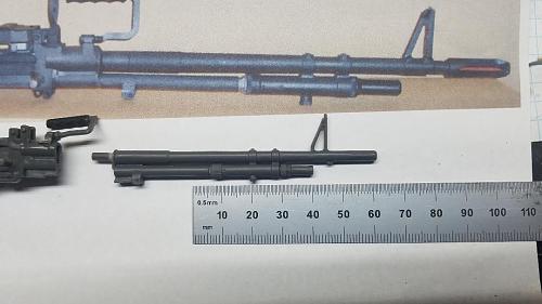

                  #948

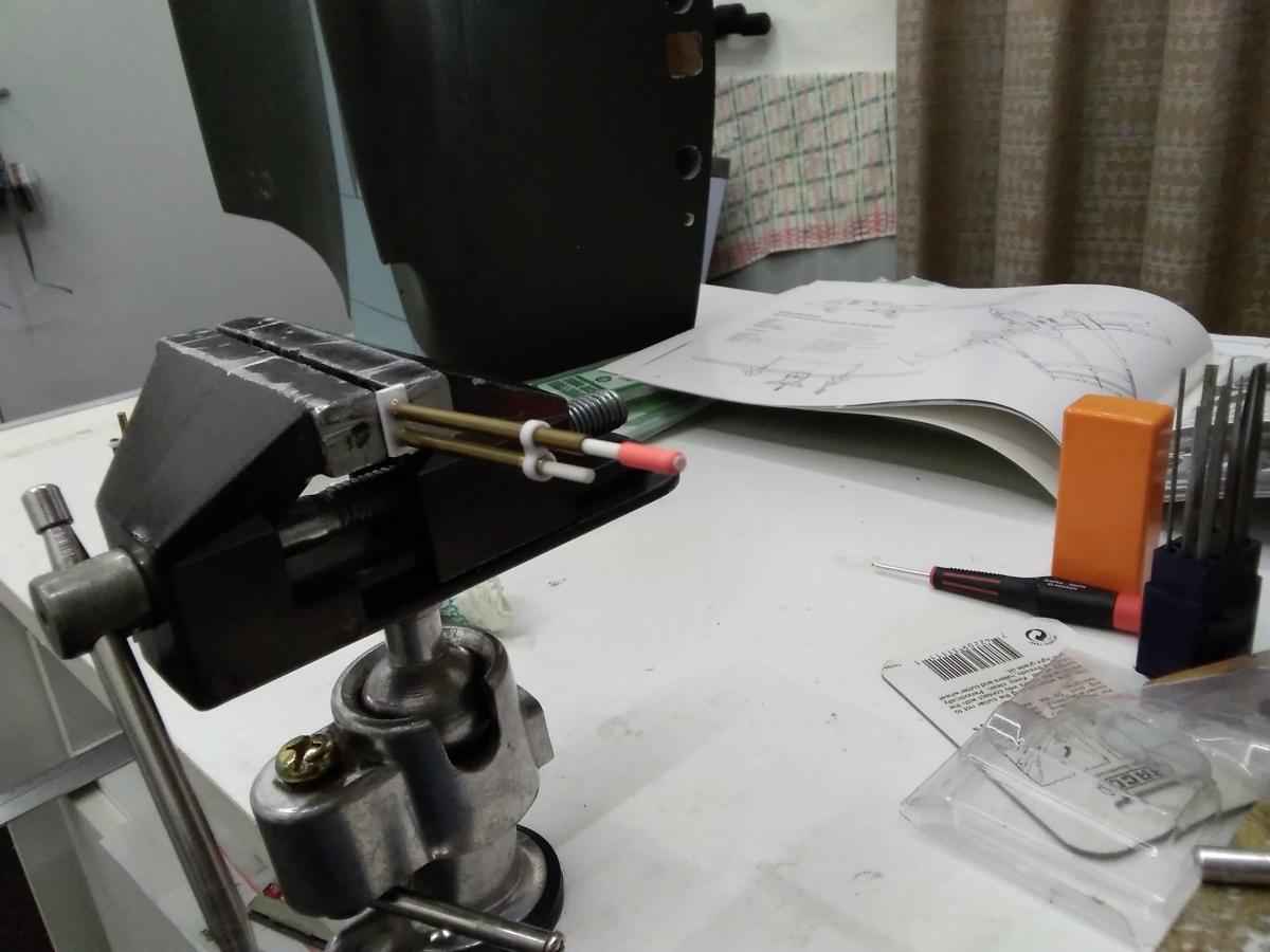

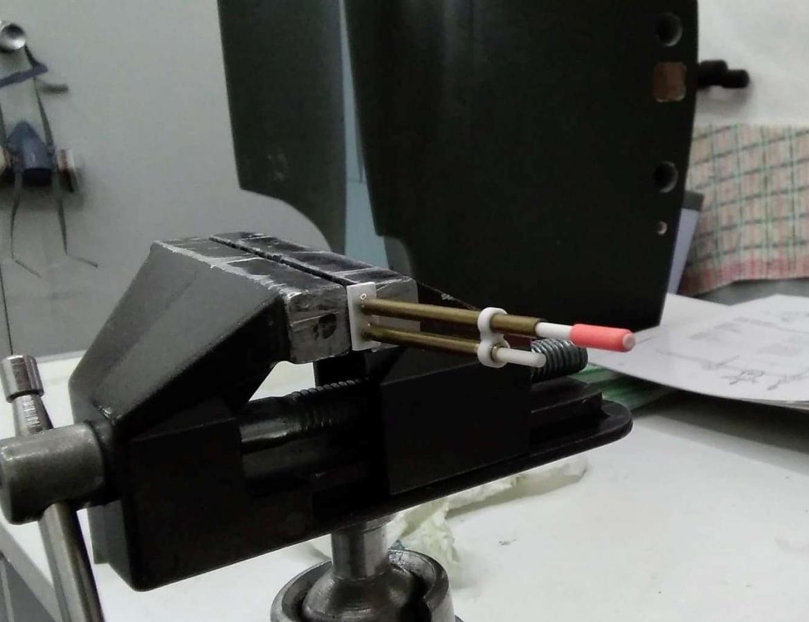

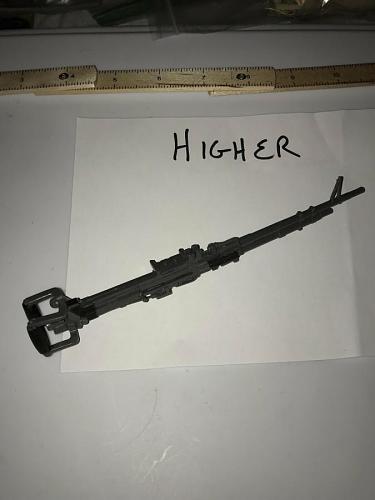

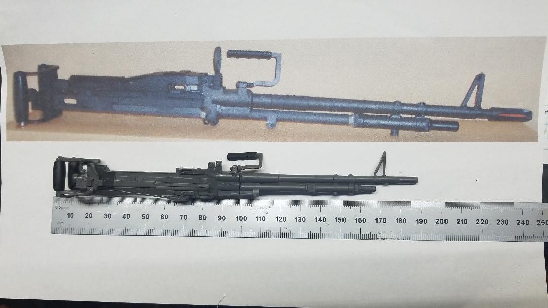

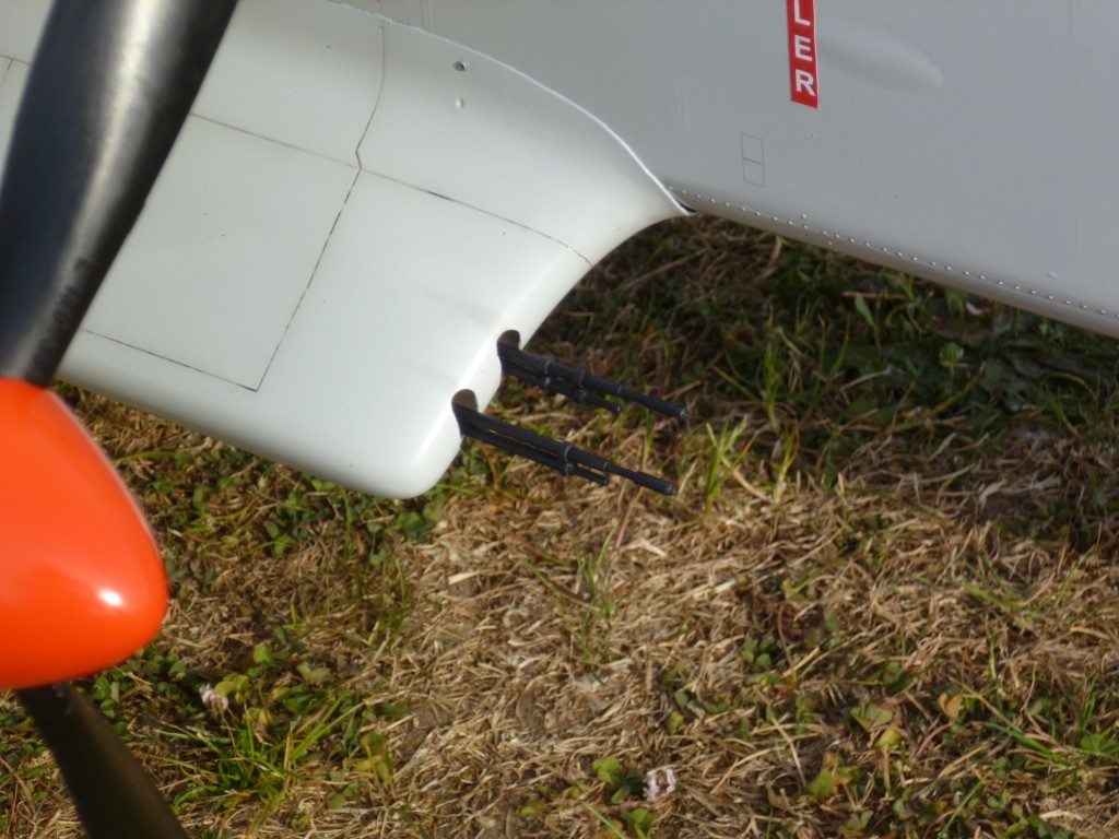

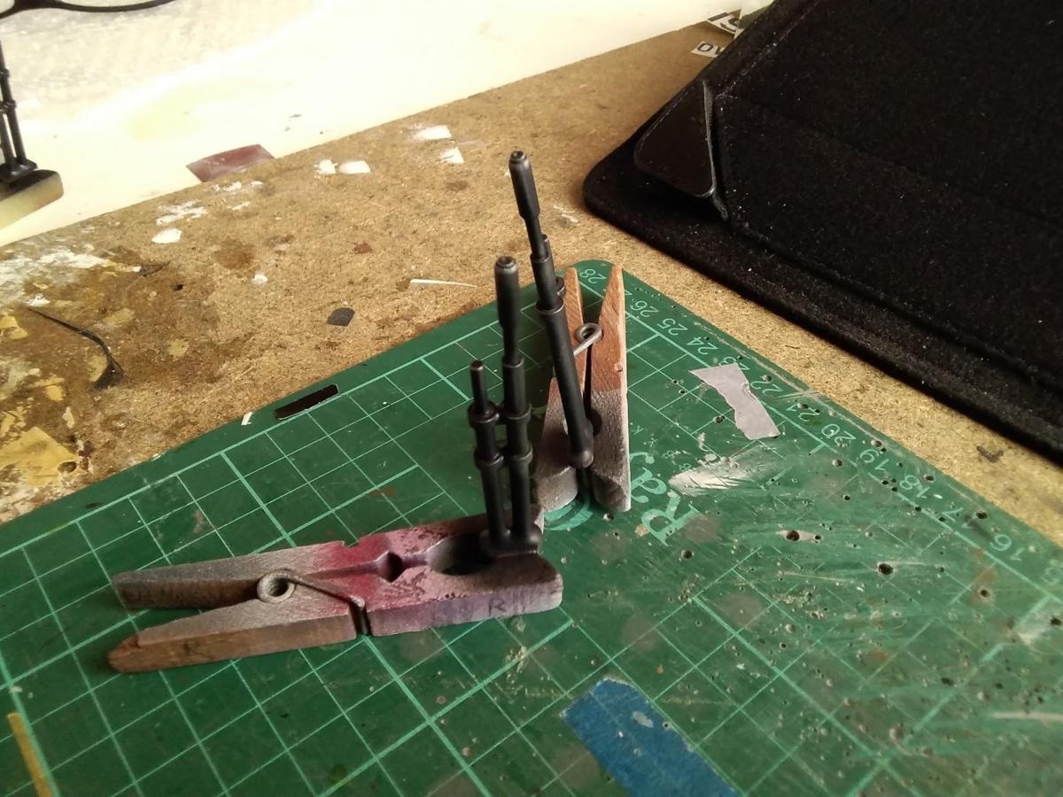

                  I used a combination of brass and plastic tubes to make it as good as possible, with some subtle weathering i'm pleased with the results..
ID:	322733Click image for larger version
ID:	322735Click image for larger version
                  Do note that the guns on the right sponson are on the outside, and on the left sponson on the inside relative to the fuselage!

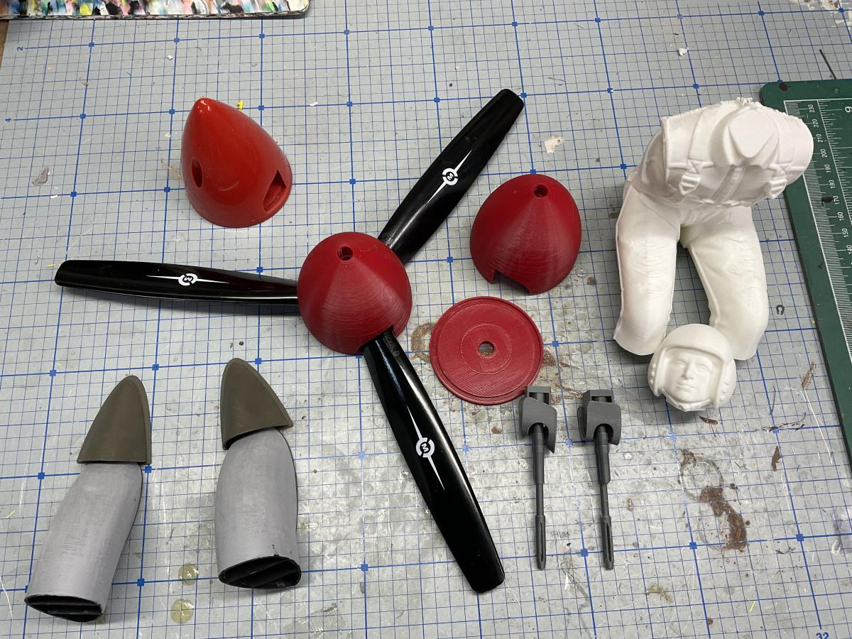

                    #949

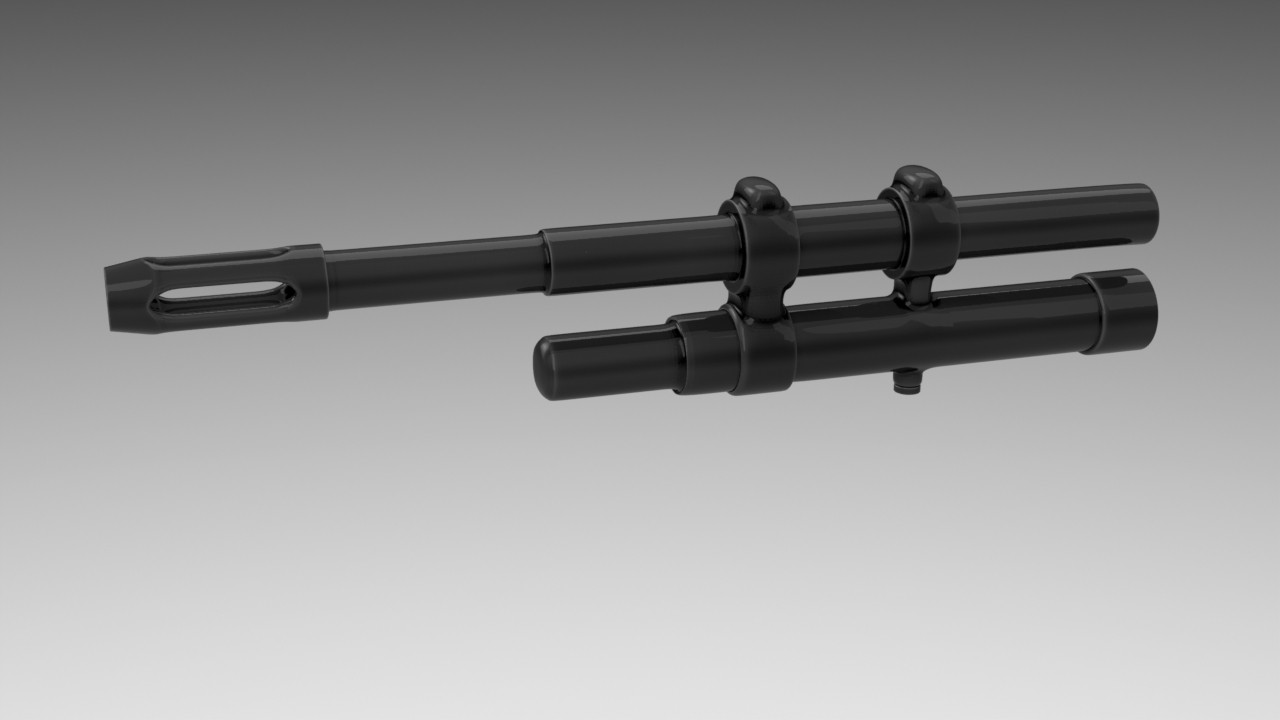

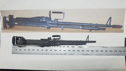

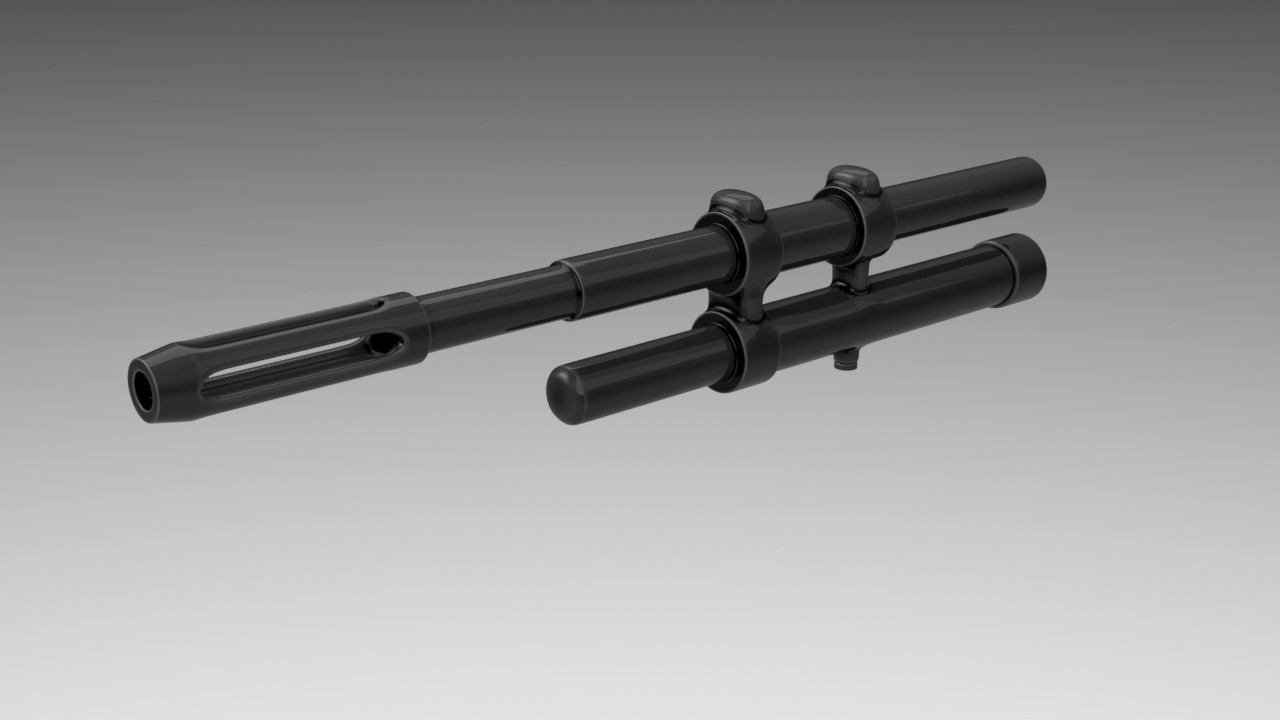

                    I sat down last night and built this in 3d, 6cm long which is just a guess but seems about the right size,i have not printed or tested yet! I have been swamped with work but can post an .stl file later today if there's interest?
                    Click image for larger version  Name:	m60.JPG Views:	0 Size:	51.7 KB ID:	322937

                      #950

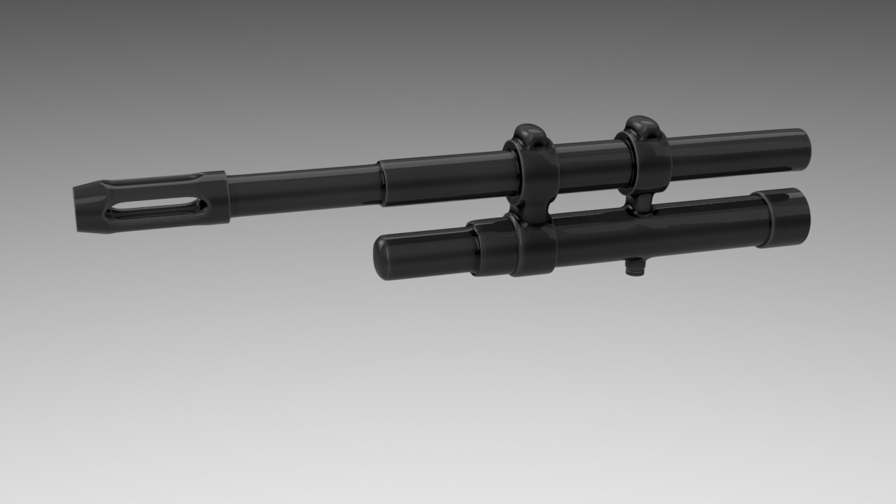

                      Wow, i dont check post over a couple days and then i catch up to find this!! Ill try it on my Geeetech A10 if you like to send the stl. I did find something but only one on EBay for the 1/6 scale figure series. My hope was to copy the front barrel assembly, which is detachable from the main breach assembly, make a mold and cast duplicates. Lengthy and old school but I'll try a stl file before going down that road.

                        Tim, your estimated length of 6cm looks to be right on. The pics of the one here is 1/6 which would work as well. Now if i had two of these, i could almost make the
                        gun bays complete for display. I had planned to make a mold for just the front half and then trim off the front sight. Your stl may be just the ticket along with the other one that was recently posted over in the thread on RCGroups but that one is for 5th scale and resizing stl files sometimes has issues.
                        Click image for larger version  Name:	m601-6pic2.jpg Views:	0 Size:	99.0 KB ID:	323262Click image for larger version  Name:	m601-6pic1.jpg Views:	0 Size:	109.9 KB ID:	323263

                          the first one I just knocked out and said that looks about right..... I found a good blueprint and went back and checked alignments and proportions so this one should be accurate. 60 mm length import .stl as millimeters. feel free to try it out!
                          m60 v2.STL.zip
                          Click image for larger version  Name:	m60v3.JPG Views:	0 Size:	50.2 KB ID:	323307

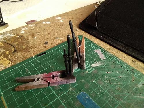

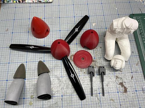

                              Don’t know if anyone has tried the gun barrel file, i finally did and the barrel breaks pretty easily, I am reworking and will post new file when available.

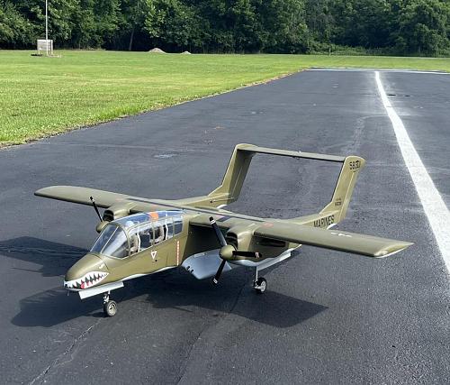

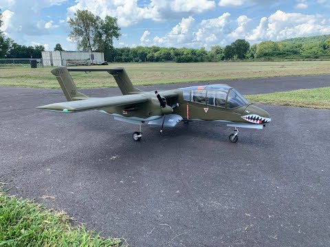

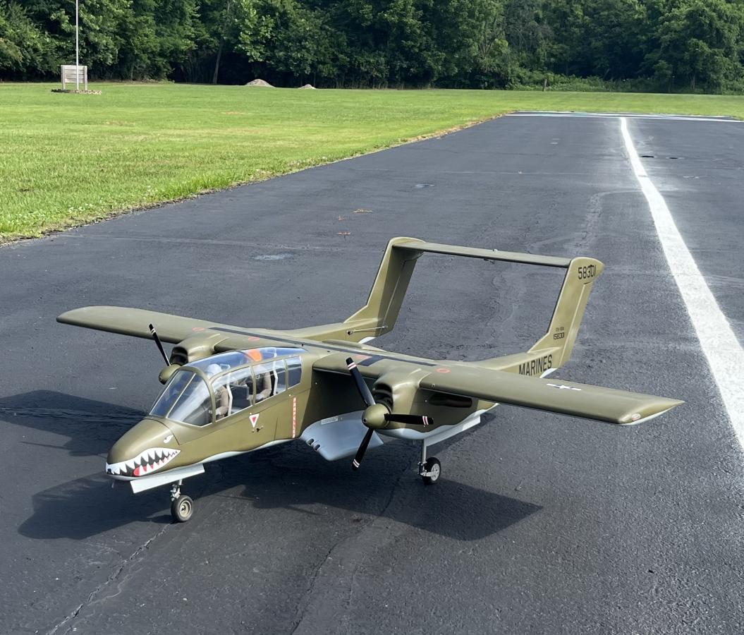

                                Well I finally managed to maiden my Bronco. Overall very happy with the flying qualities, performance of the power system and basically just the WOW factor. Such a great looking plane especially on a low level flyby, landings are quite easy. Only issue I need to resolve is to increase the total amount of elevator travel, an easy fix by means of swapping out the servo arm with a longer one. The guys at the field loved her too!
                                Here's a YouTube link of the first take off and most of the second flight. Bear with the video, it gets better a couple of minutes in. https://youtu.be/_Rh0l29WyKM

                                  Congrats on the successful maiden.... Great flight! Like the scheme you did for this OV-10 as well.

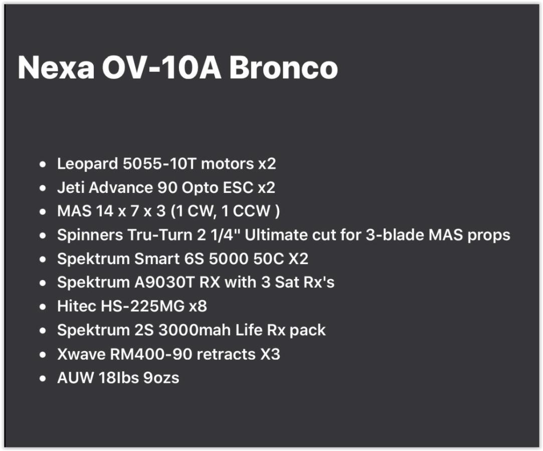

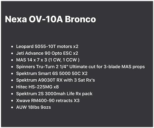

                                      In regards to my Bronco maiden a few days ago, here's the parts used to power and control her. Everything performed beautifully and provided plenty of power.
Name:	Bronco Specs - JPs Build.JPG

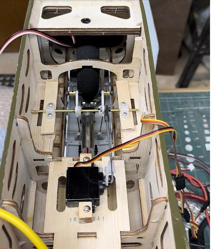

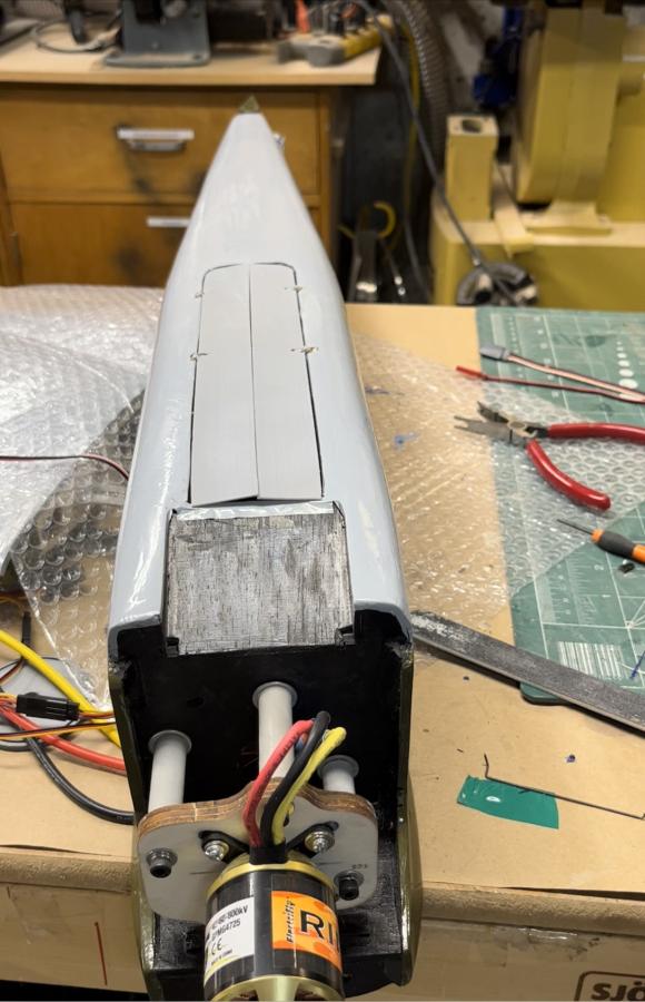

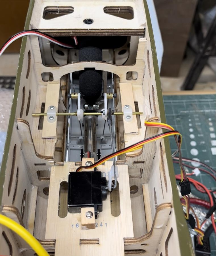

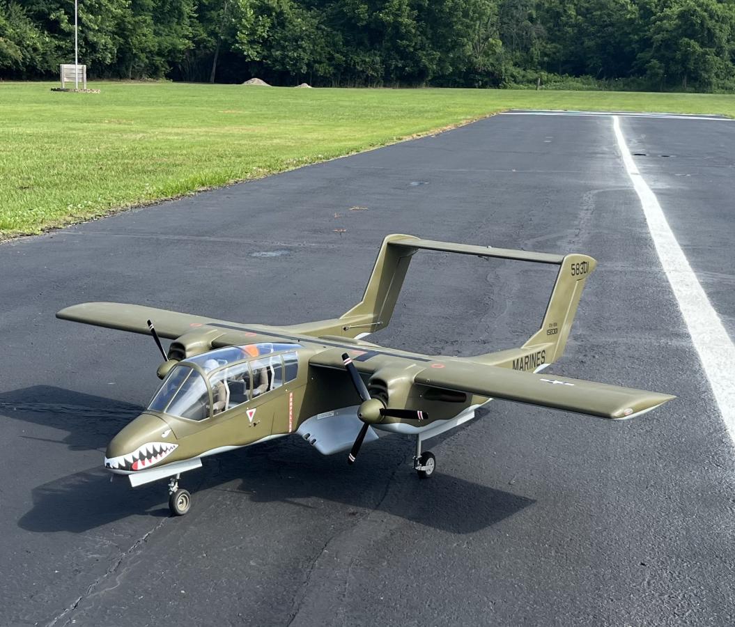

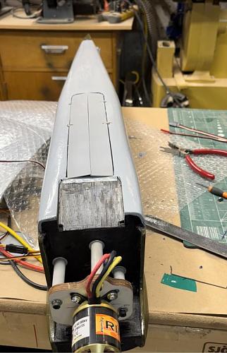

                                          #960

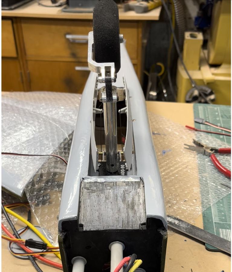

                                          Nospel,

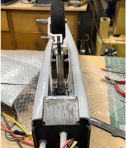

                                          A lot of questions. I can only speak from my experience. My setup: Rimfire 46 ( 800 kV), Castle Phoenix Edge Lite 75, 4S 5000 (x 2), Master Airscrew 12x8x3 ( counter rotating). 1995 watts at 135 amps full power. Empty weight 14 lbs 6 oz, flying weight 16 lbs 6 oz. I would definitely use a separate receiver battery. My battery wiring is two in parallel so that both batteries power both motors. The ESC’s are in the fuse. I also combined all the wiring to the wings in 2x6 multi pin connectors from Hansen Hobbies. I did a fair amount of 3D printing. Unfortunately, not in a position to print for others at this time, but in addition to nose gear doors have 3D printed the main doors as well. Other details are the counter rotating spinners, gun mounts and guns, turbo exhausts, longer main LG links that make the struts look a little more scale. Callie Graphics. Video of the maiden here.
                                          Craig
