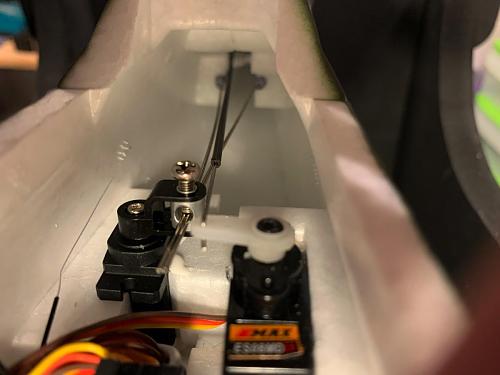

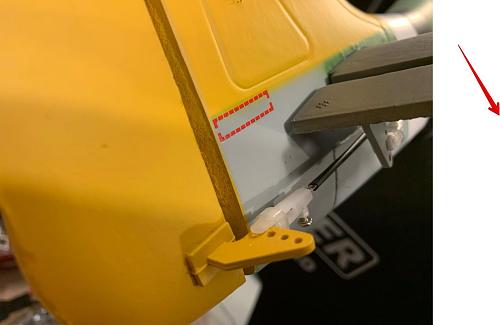

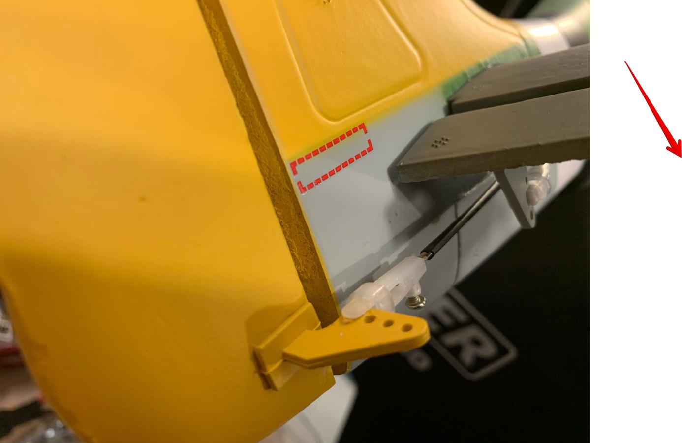

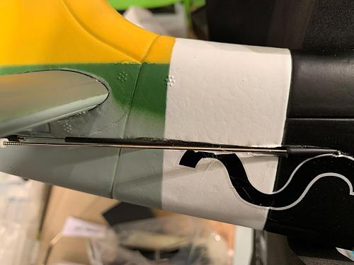

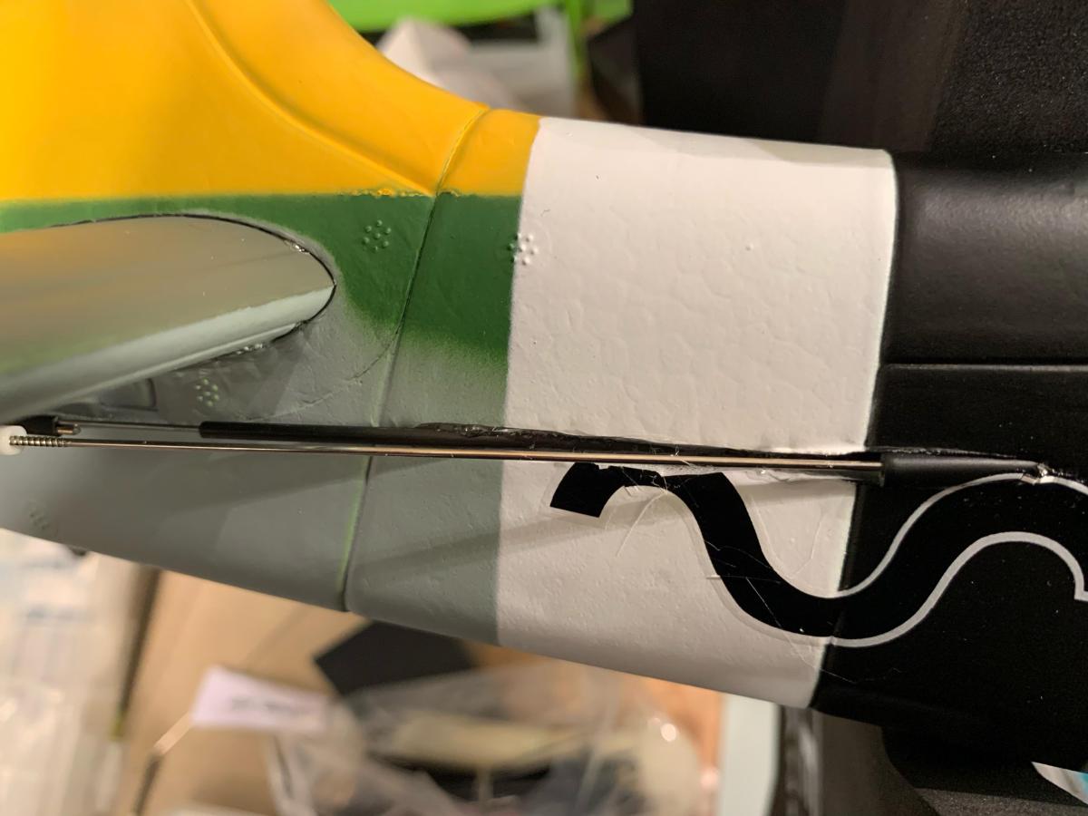

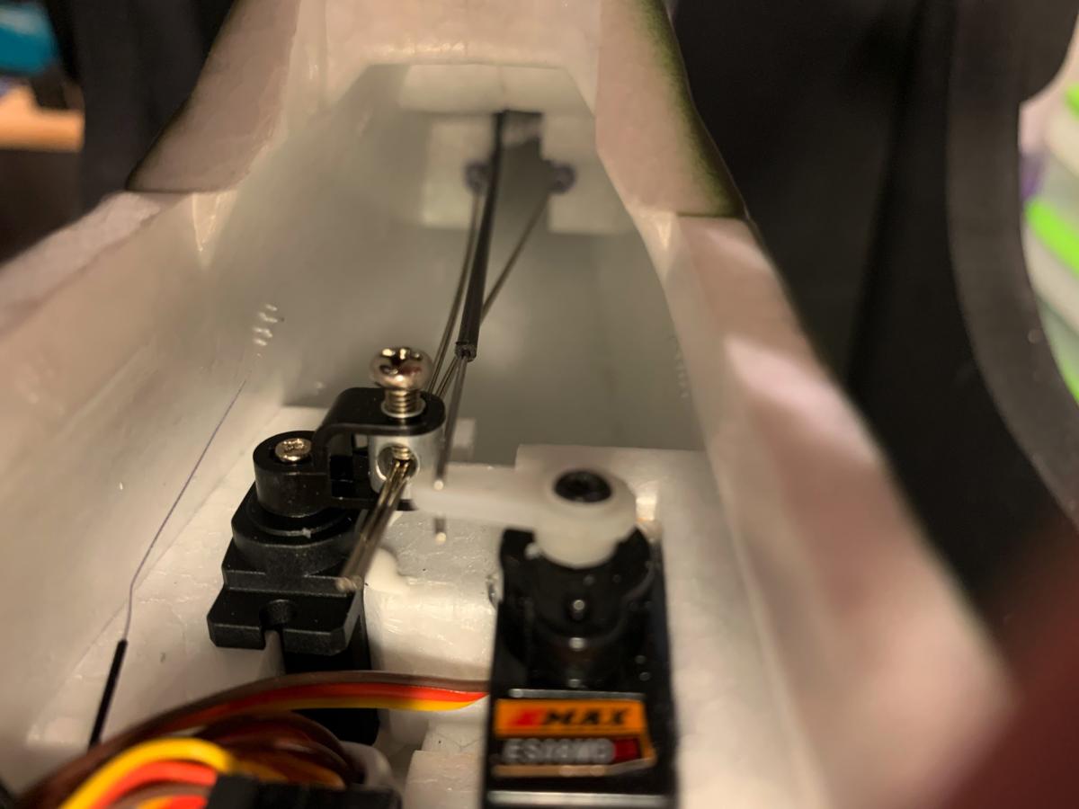

                Here is one way of making a rudder mod for the FW190D by using one of the other rod-holes.
                I used a 0.8mm stainless steel rod within a carbon fiber tube to make it stiff enough. Only had to glue it beside the elevator rod. The shrink tubing outside also gives some additional stiffness.
                There is enough space for both servos to work their full range. Elevator travel is also not affected.
