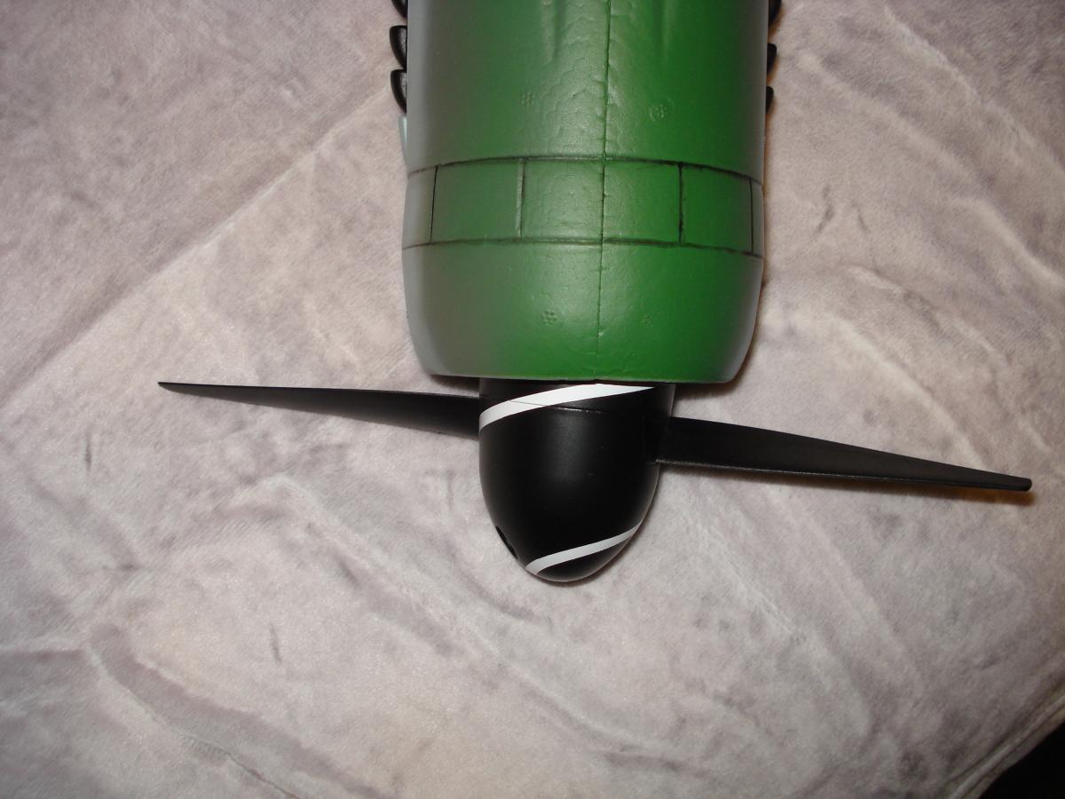

              Originally posted by FlightRC_Newbie
              Hi folks,
              I just got this nice bird as a birthday present and was all excited to assemble it and take it out for the first flight.
              But then I realized that the propeller axis is tilted. A closer look at the motor mounting revealed that there seems to be a production error with that part.
              On the second picture you can see, that the two screws on the right are protruding as compared to the two left screws. The screws seem to be mounted correctly, however, the plastic brackets that they are screwed into have different distances to the front of the plane.
              Did that happen to anyone else already?
              Any ideas how to fix this?
              I feel that I should get a replacement from the vendor....
              Any help is highly appreciated.
              Mine had a late night out too lol. Click image for larger version
