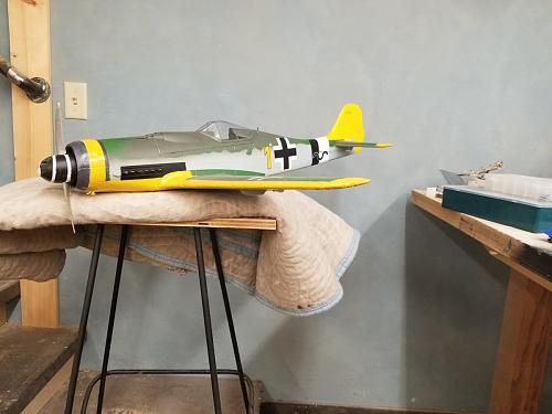

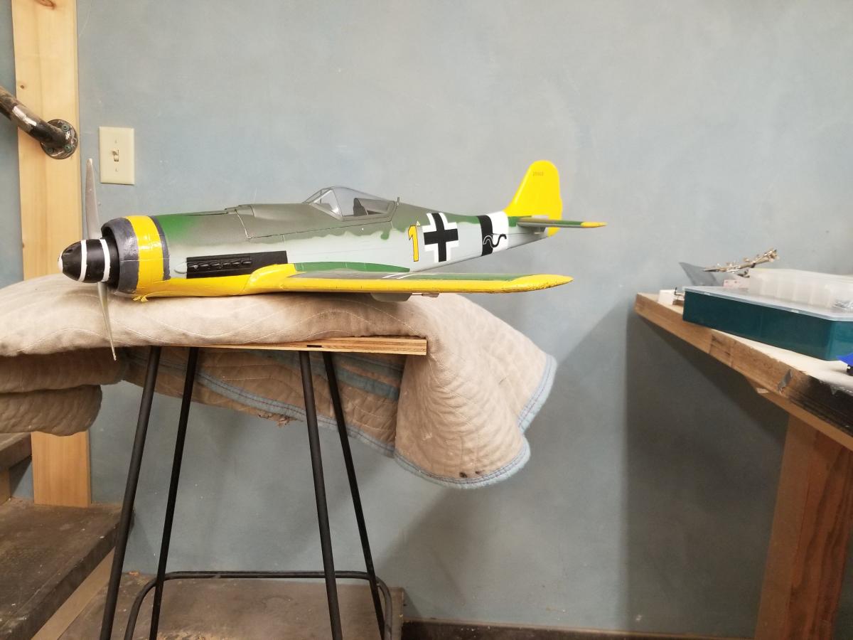

          I just used a dremel to modify the stock spinner. I took a little off then test fit, take a little more until it's near perfect. I just remove plastic until it works. It will fly fine without the spinner 'cover' I cracked mine and have flown it plenty without it.

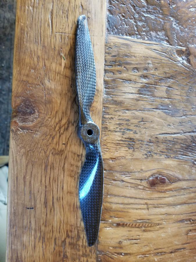

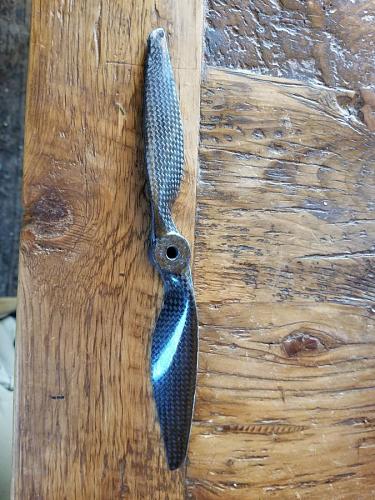

              I thought about a folder too, but was thinking because the cowling is so big that it wouldn't necessarily work as well as I had envisioned. But I didn't try it, so it's all speculation. The apc does work well and I did find some cheap nylon 9x6s on Amazon. And just this week I received this prop, also an amazon purchase via china. I can't speak to it's performance or even balancing yet. Click image for larger version

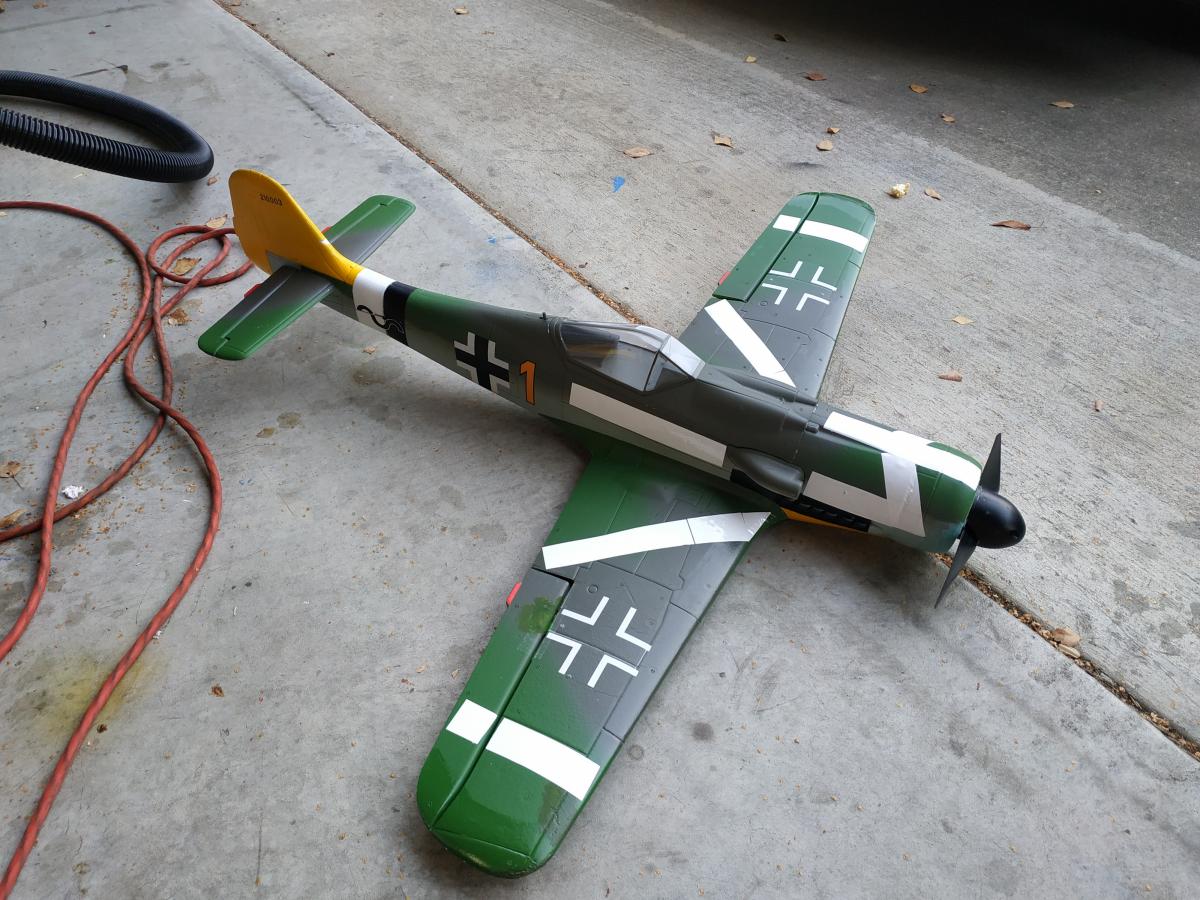

ID:	283499 Here's what I did to my first Dora in attempts to make it easier to see. Its pretty alpine around me, lots of green and dark green. I thought the yellow would help. But I think I'd have to paint the whole thing yellow to really benefit for orientation. It does look cool whizzing by but its a.small plane and fast, so it gets smaller real fast. Congratulations! Once I got the first flights in it became easier to launch because I knew exactly what it takes. Are you running a stabilizer in it? The wing wag my been the gyro turned up just a little too much. I end up at 11 o'clock or even 10 o'clock on the receiver dials. I found anything higher for me would cause the oscillation.

                      Today I put on some white strips to make it easier to see. Maybe I put too much!

                        Whatever helps you to see it and fly it! Mine always look better in the air than in the ground. Well new out of the box they look pretty good.
