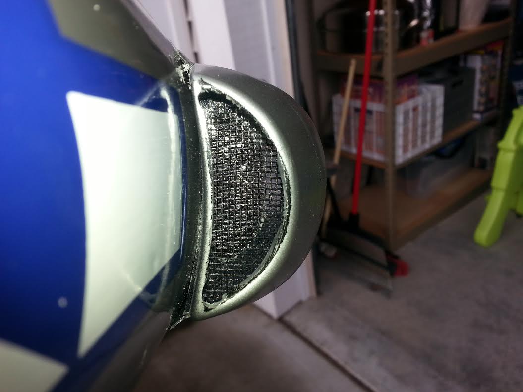

              • In addition to the great mods Alpha has outlined earlier in the thread, another mod I will be doing is putting a screen mesh in the intakes and radiators. You can pick up black screen mesh (used for screen door repair) from any hardware store. I added it to my Legend Models P-38 and it looks fantastic and is another great way to add scale appeal to your P-38.
