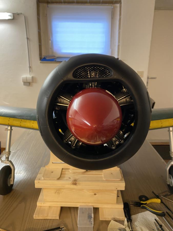

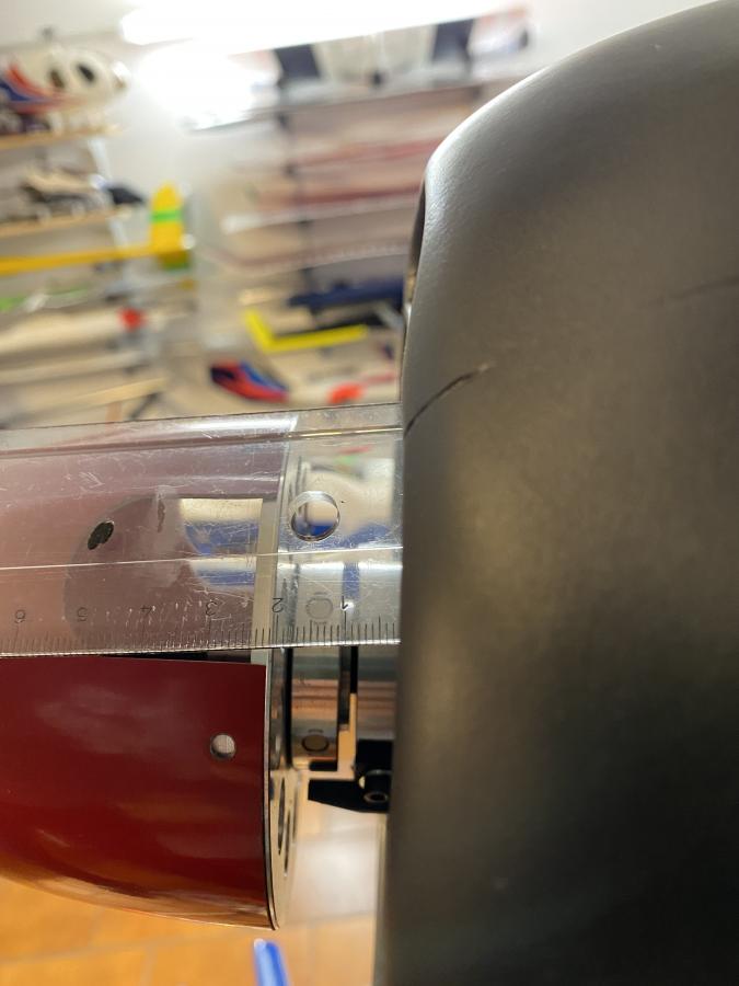

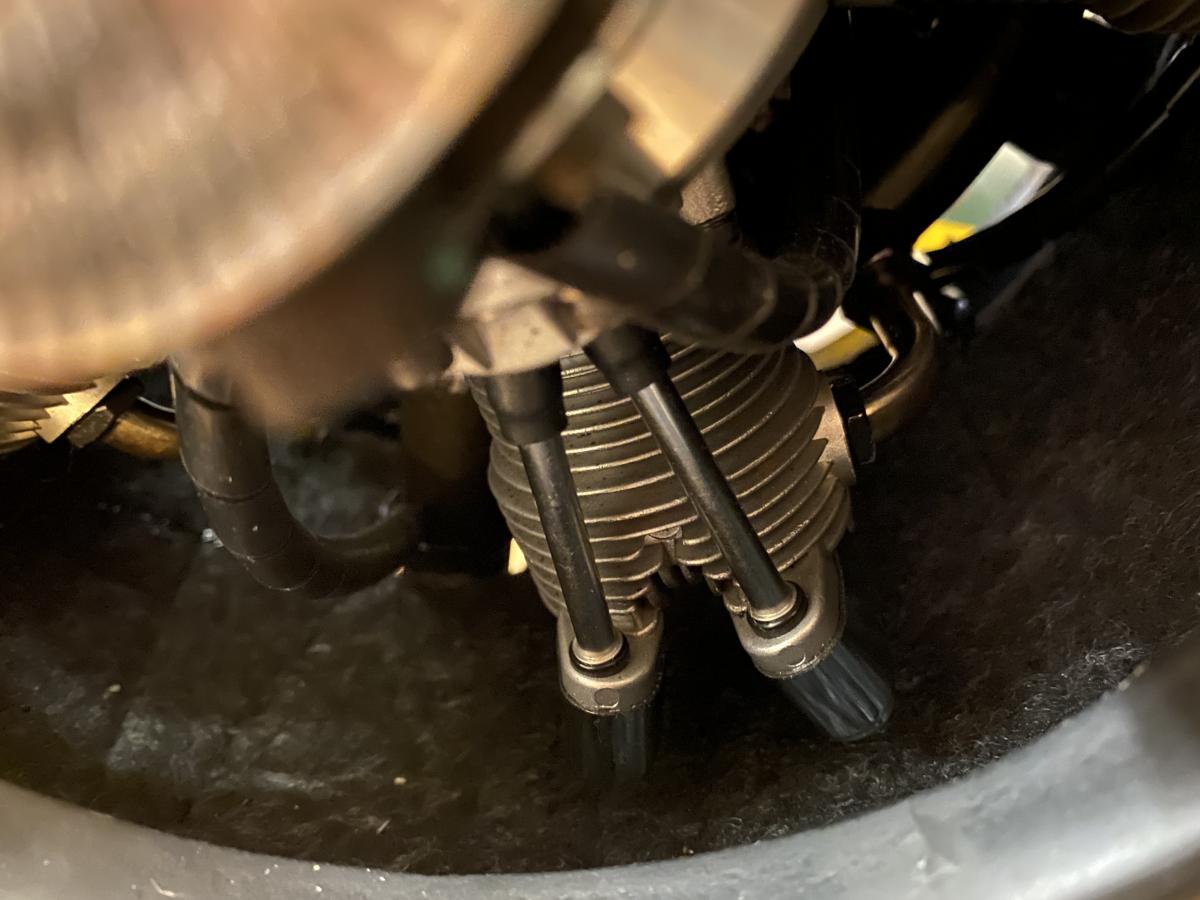

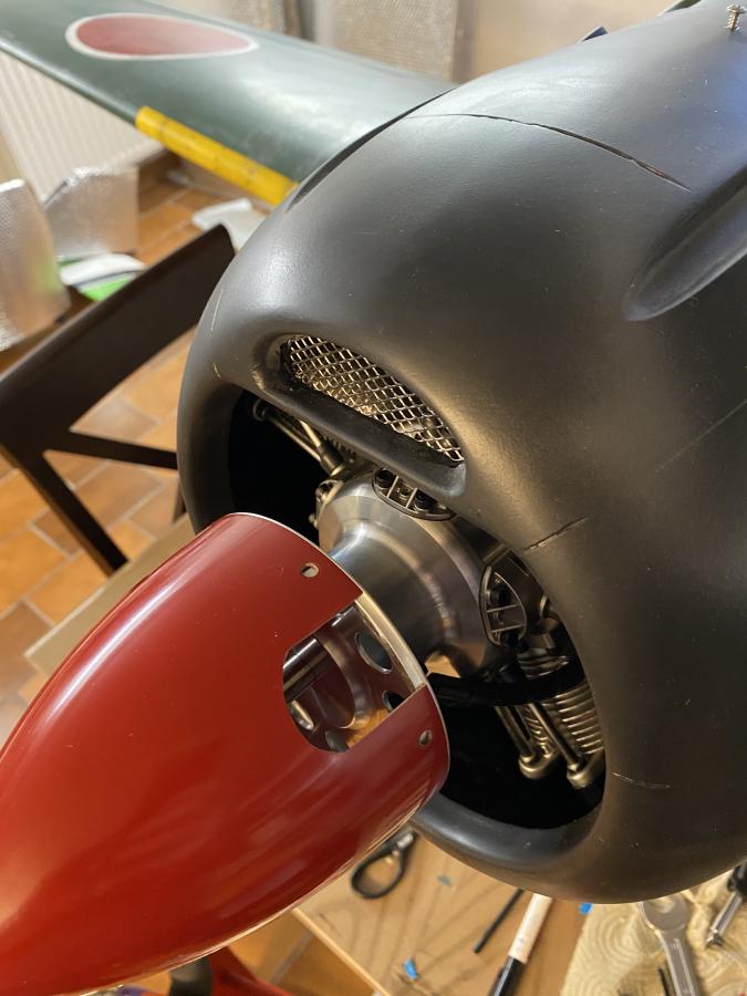

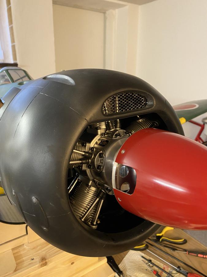

  • SirAbuse
    Originally posted by Trady37
    Thank you Dennis!!
    last question ... would a UMS 7 cyl 90 work in the zero? It’s only about 230mm.
    tom
    Sorry i don‘t know. The Saito FG 73R5 fits in strong but there is 1cm free space around.
    Perhaps you must make litte adjustments to the firewall.
