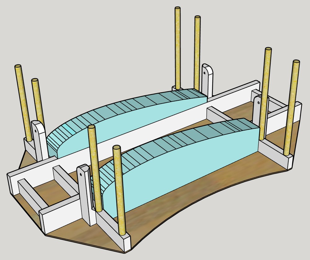

    Banana man thank you very much for the great details on the stand and the zero .

    Hi Joe, thanks, the carrier comes from this Sketchup drawing I did. It was inspired from a background shot in a German YouTube video about an r/c Warbird display from 15yrs ago.
    Its good for plug in wings, but can be altered for other types. I got tired of wrapping wings in bubble wrap and blankets and having them move around and get damaged. I also have the unfortunate habit of forgetting wing joiners, so have a spot to velcro it on the stand. Not very visible in the image posted above are foam covers for the stab tips.
    The cross pieces are lap joints. Everything is glued except the harness supports, they have single bolts. The foam is lagging for hot water pipes. The wing supports are blue foam.
    I've asked my friend for his CMP Zero's CG and any relevant info.
    Click image for larger version  Name:	Zero stand.jpg Views:	0 Size:	127.5 KB ID:	261938

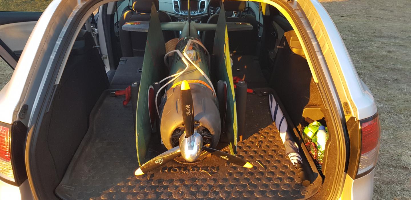

  • Joehockey
    Hey Banana man great model caddy and video ! I was wondering if you would share more info on the caddy and any info on the CMP Zero ?
    I am bashing the large CMP Zero into an electric conversion and would love any tips possible on CG ect . The original owner of the CMP has been a great asset but love to hear other opinions on the model .

    Looks awesome!
    I long will the fuel tank last?
    I am thinking of getting a smoke system and then I need a second tank and if I use one size smaller I can put them side by side.

    I do unless its very windy, you can some landings see here. I flew it again today.
    Made a holder for it, luckily I have a car it fits in.
