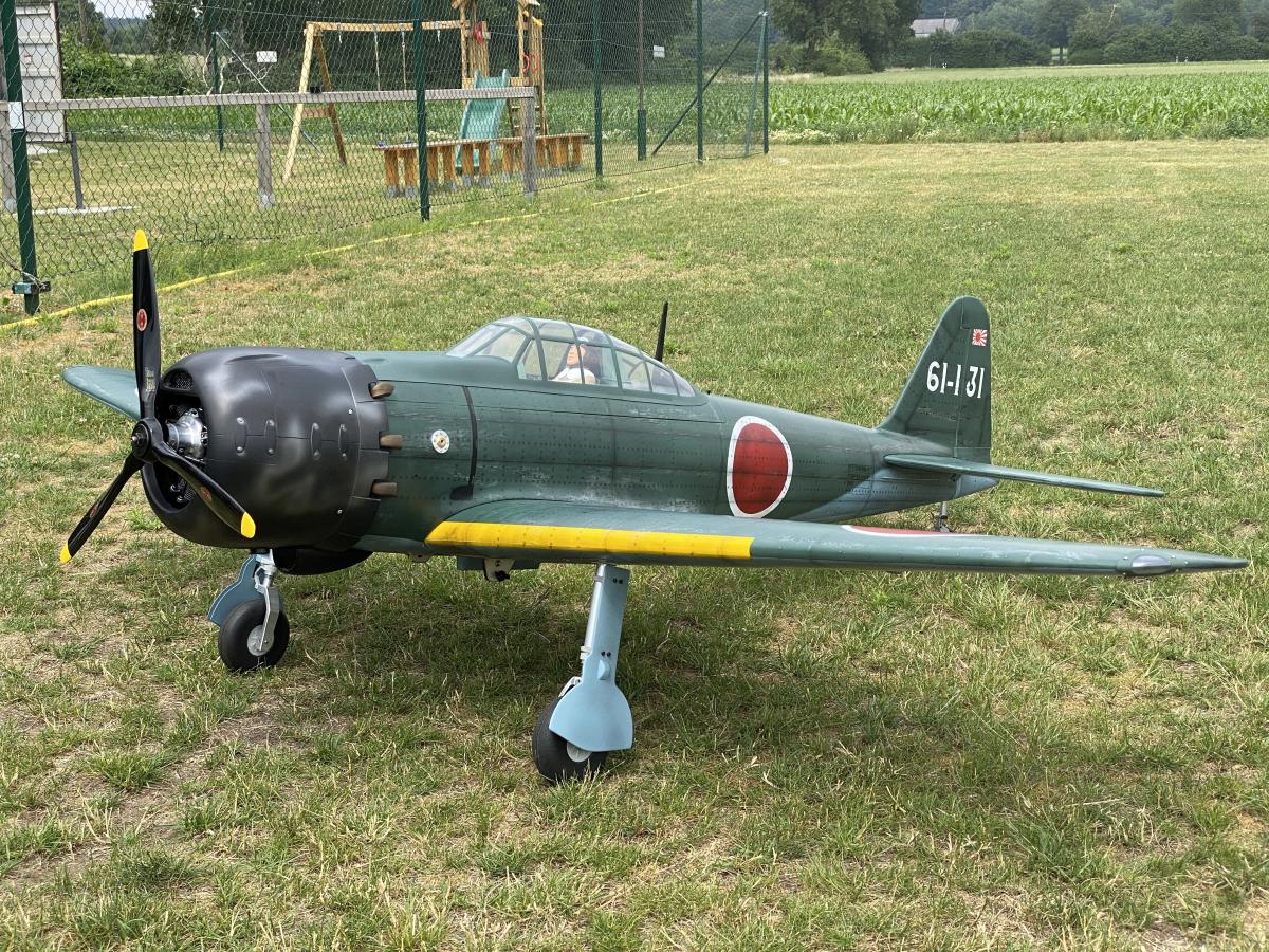

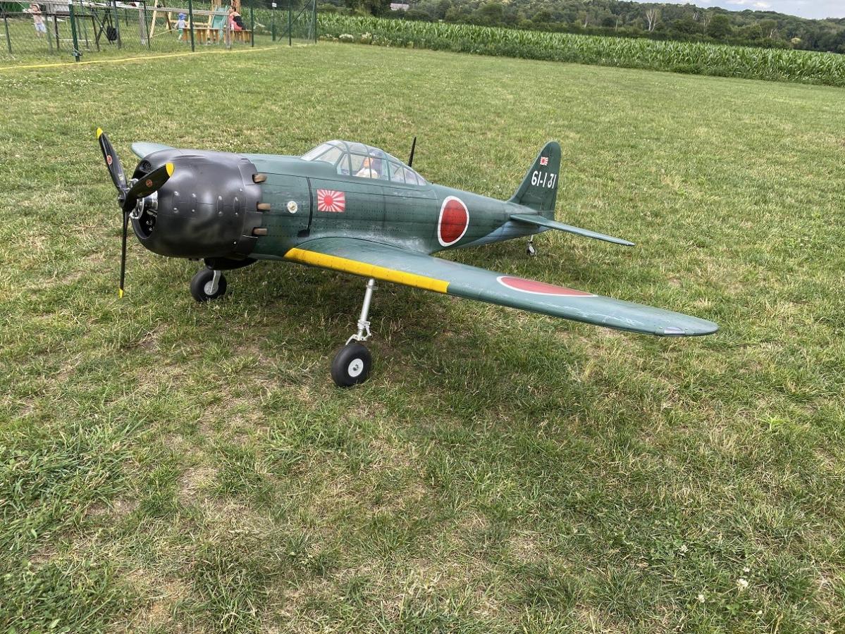

    Sunday was maiden flight. The Zero fly wonderful. It looks tail heavy but it is not.
    I had two problems: First the left wheel gets stuck on the first start of the plane. Propeller demage on the ground an i had to fly without a spinner and with a smaller Biela propeller.
    Second the electric gear doesn't extend in the pre flight check. The gear cover hooked somewhere so we screwed it off.
    Very much luck on the first flight day.

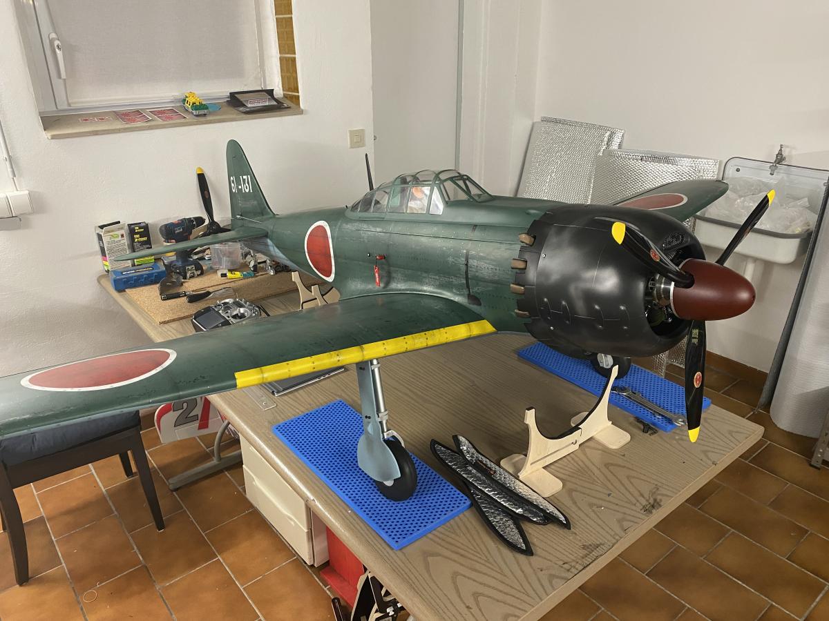

    Almost finished...

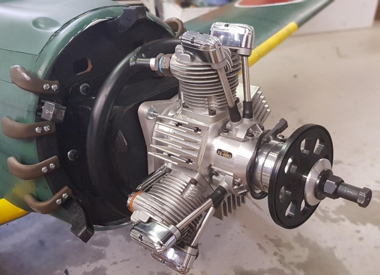

    Maybe the picture shows the mount better. It has 5mm spacers in this image that I've taken away. You'll have to expand and lengthen the cowl slots for the stub exhausts to get prop clearance. The ignition sits on top of the mount behind the engine.
    What I really like about the access to the fuselage and this mount is that you can reach in and prime the engine with your finger, rotate the prop until your finger is just wet, then put the top/canopy back on. This engine starts every time hot or cold within 2 flicks that way.

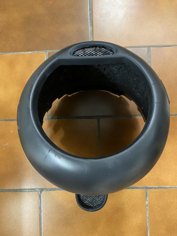

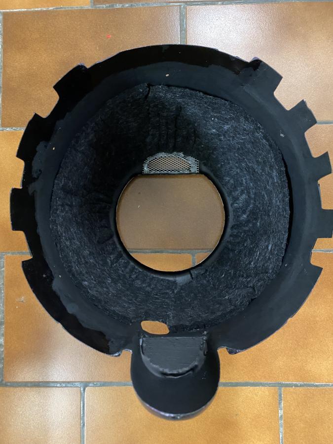

    Here are some build updates:
    Cowling with sound absorption and some grid in the air intake.

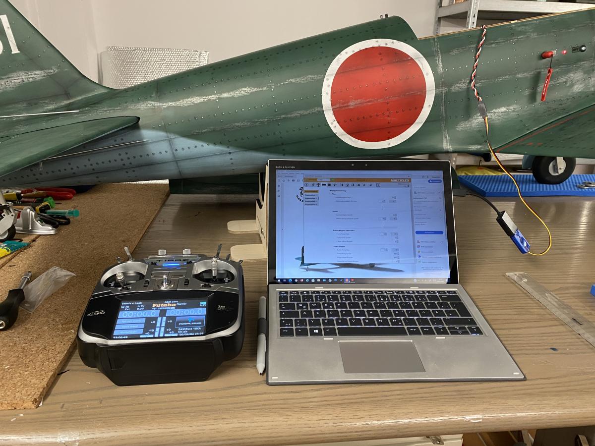

    I adjust a 5x temp sensor (PBS-T250) from PowerPox Systemes to runs with futaba telemetry and
    program the Multiplex WingStabi with SBUS.
