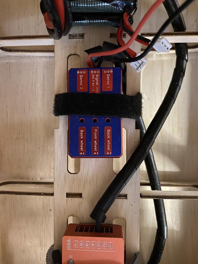

    Has any one had trouble with retract control box? I put power to box, plugged in a retract and hit test, nothing.. I tried both plugs and even hooked rx to it and tried retract sw on tx, got nothing. I want to also lighten spring on retract, as it seems way to stiff. Any help here?
    Thanks Rick
    Do you have pictures of the setup? I assume you have plugged things into the proper ports? Does the blue light come on when you power it? Obviously the box could be broken, but also maybe the wire that you plug the power into has a bad solder joint.
    Could be a number of things that might be fixable, share more info and some pics.

    Hello Rick,
    in Europe we have the blue/red control box with no test button.
    This box has no problems perhaps you buy an new one?
    High risk to land without retract out.
