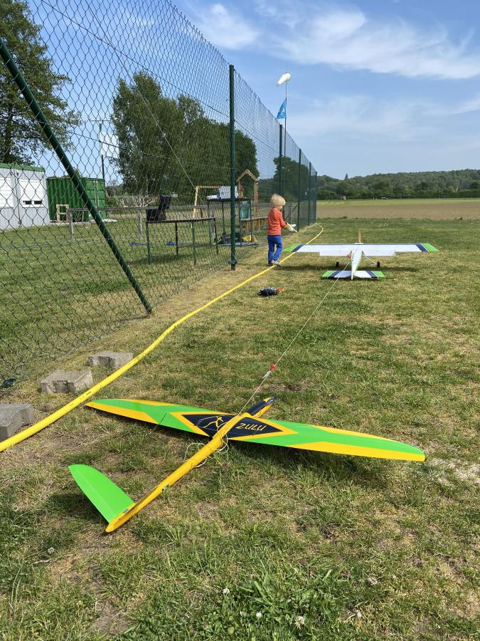

    (My 3 year old son helps me to towing the glider 😂)

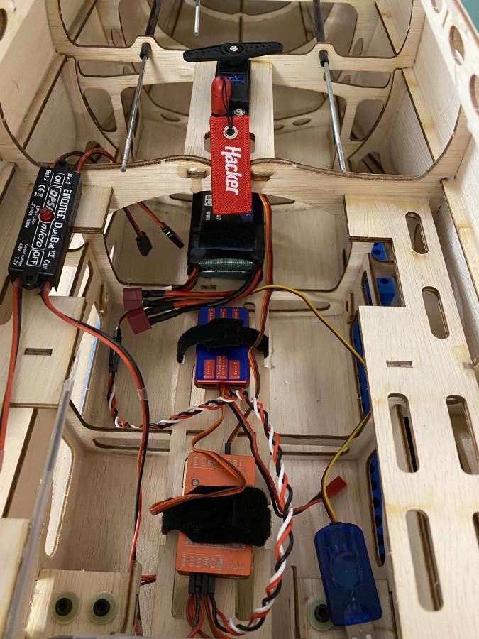

    I haven't glued my tail cone on. I wait for the balance. Thank you for the hint. Engine and cowl assembly finished. Im am testing some positions for the elektric components. I will use two LiFe battery packs to geht some wight under the ruder servo.
    Next i make the wiring clean and properly and let the engine run the first time in his final place.

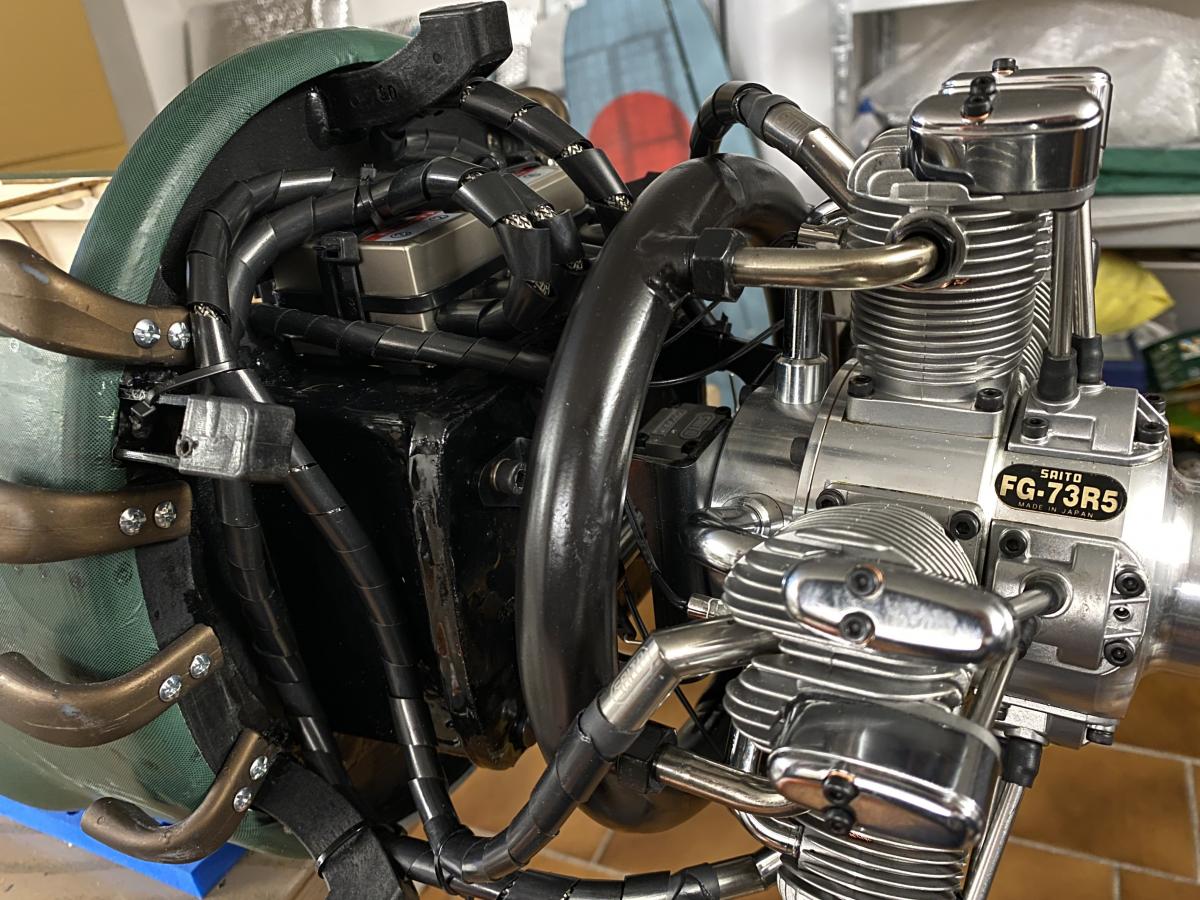

    SirAbuse Thanks for posting photos of your installation, Dennis! The Saito looks right at home in there. What do you plan to do for a spinner?

    Here are some new pictures from my plane. First install of the Saito:
