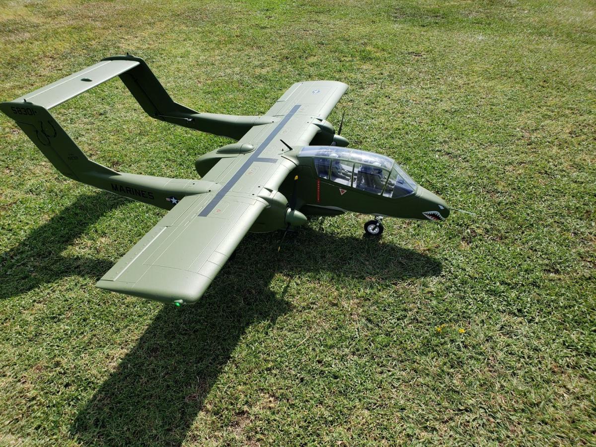

  • Dwalkerp47
    Originally posted by TACP
    I last flew RC's back in 1977 and it was a high wing trainer. My wonderful wife got me the Flightline OV-10 for Christmas. As an enlisted forward air controller in Korea (1980 to 1981), I worked with this airplane many times and always admired it. I was lucky enough to get two back seat rides in it. I love this model. My instructor has me doing pretty well with it. Six flight so far and am starting to feel pretty comfortable with it.
    I'm sure enjoying my OV-10. Pretty cool on being able to get a back seat ride on one.

  • TACP
