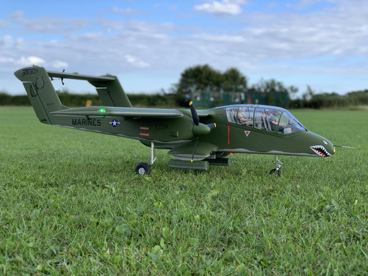

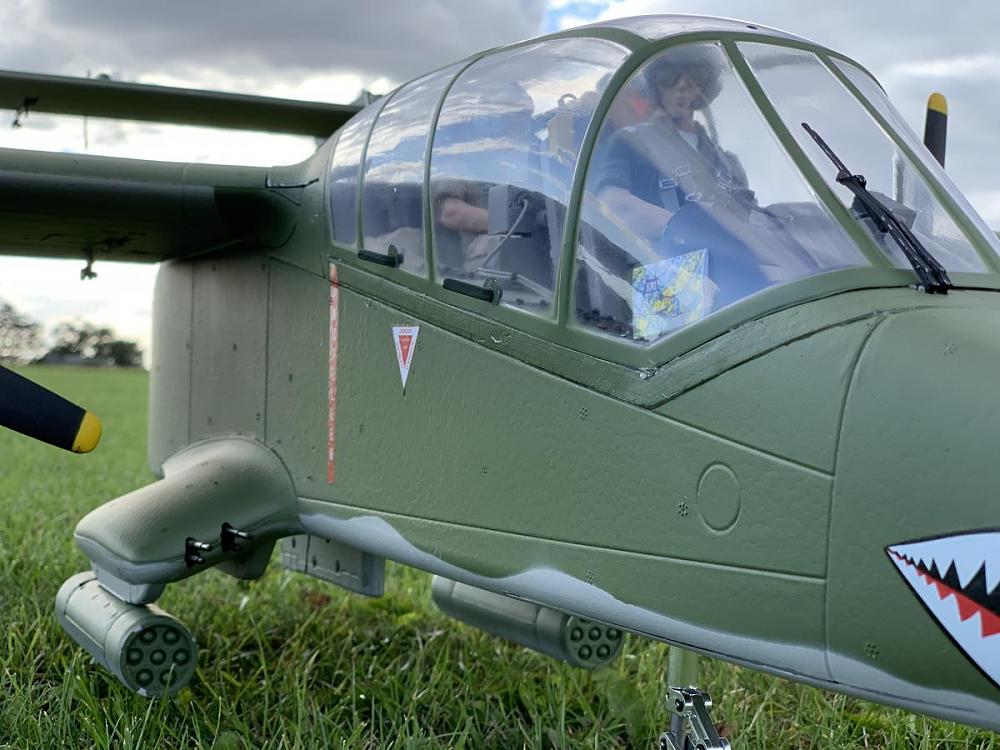

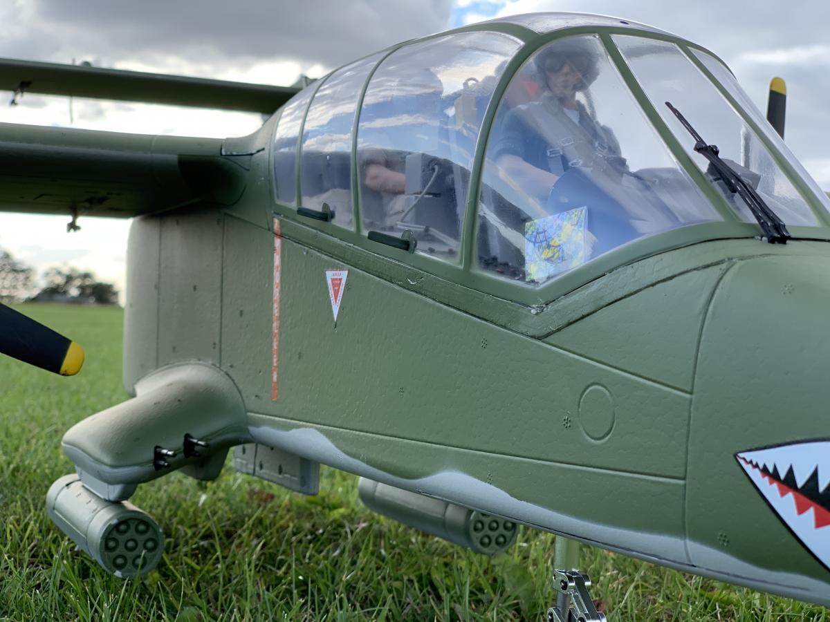

ID:	273023 Static shots from today at the field...

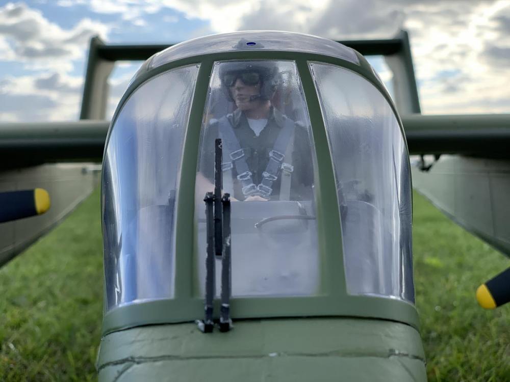

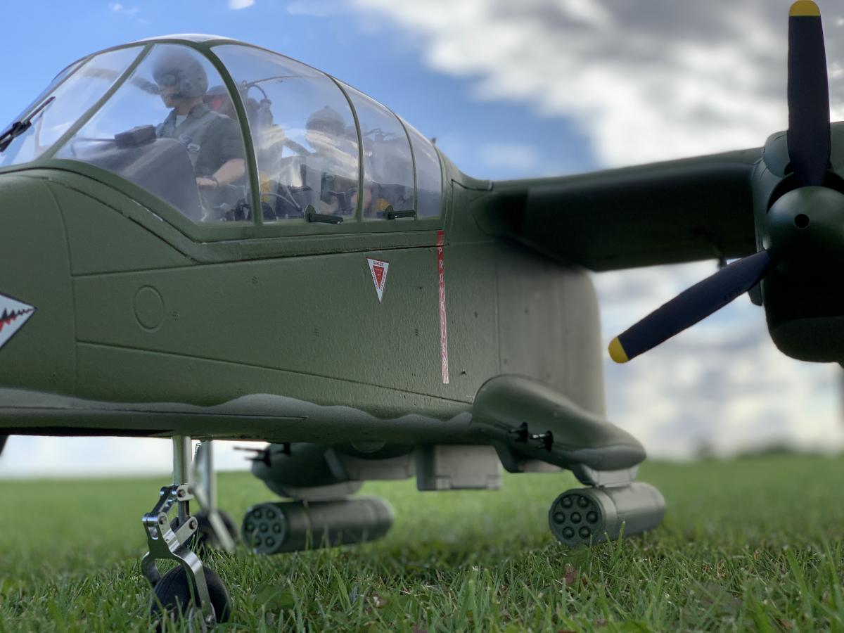

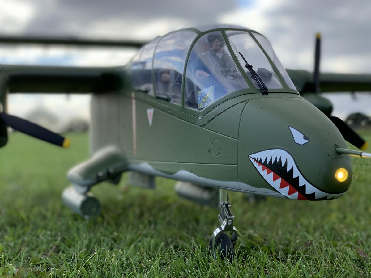

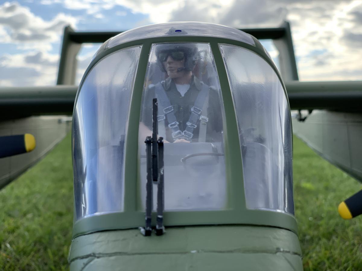

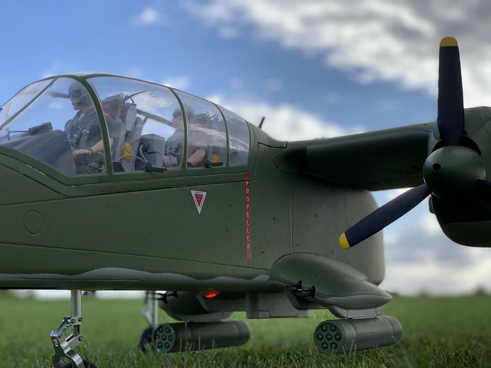

ID:	273005 I have completed upgrading my cockpit and I hope you like it. Here are several photos from the workshop and I then I will post some static shops from the field.
    There are some action shots to follow which I will
    post as soon as I get them from the fellow club member who kindly took those.
