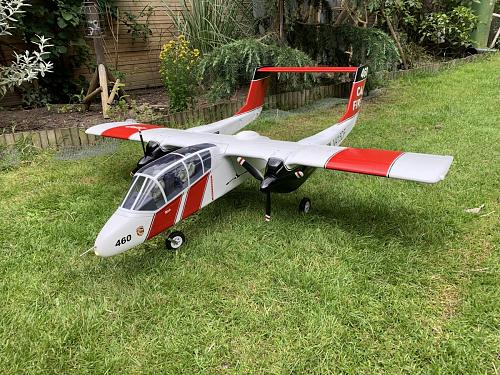

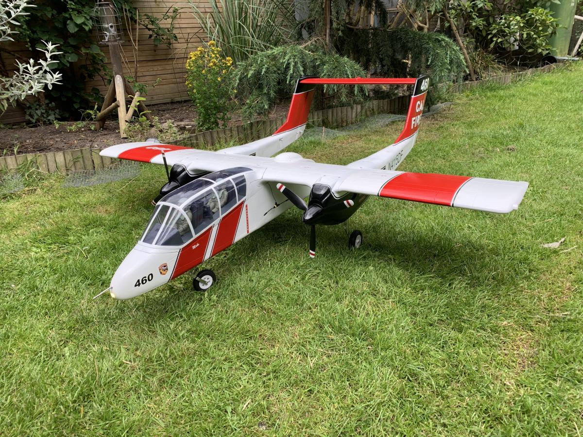

  • Moki38
    My repaint job of the OV-10A Bronco.
    Ov-10A Bronco (CAL Fire colors)
