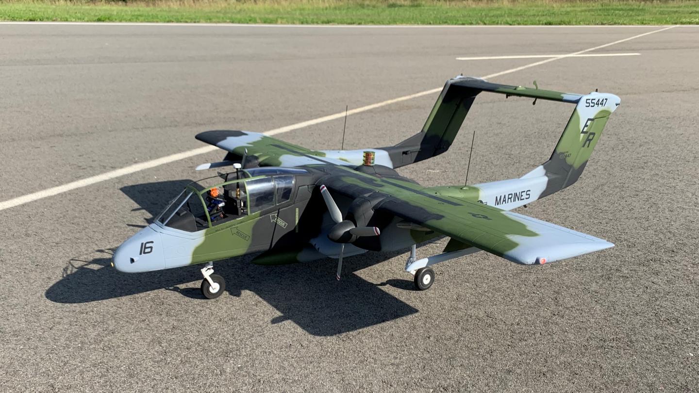

    Still not completely done but very close. I'm especially proud of the FM whip antennas added to the tail booms. On the actual aircraft, they stand up straight when the plane is stationary but in flight, they bend due to the air flow. I was trying to think of a material that would have those qualities, yet still be durable enough to survive the everyday bumps and dings my planes usually endure. The solution is cheap and easy. I took two bristles from a nylon broom we have. Perfect! They even bend in flight. The humps at the antenna bases are 3D printed. I'll upload them to Thingiverse in the next few days.
    Once again, Thank you Motion RC for another great plane!

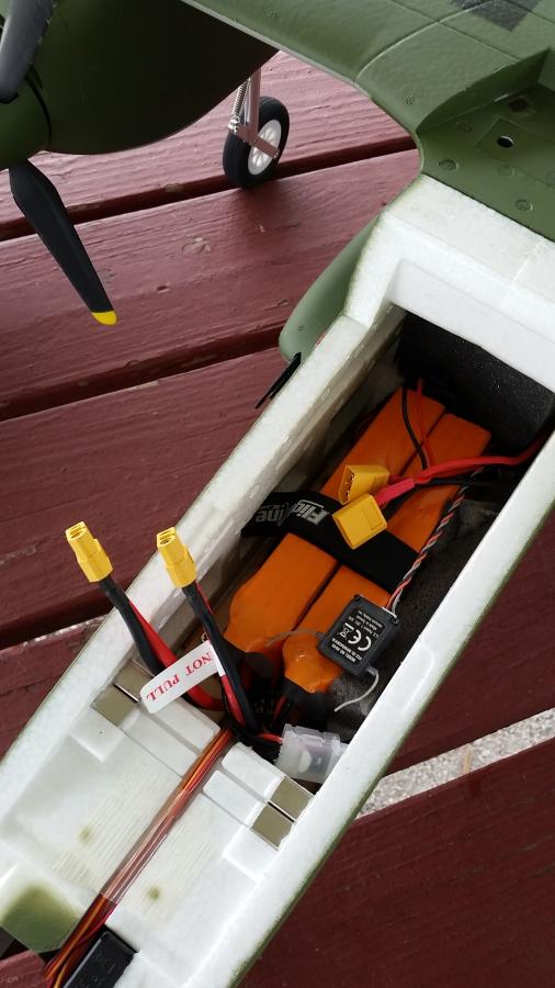

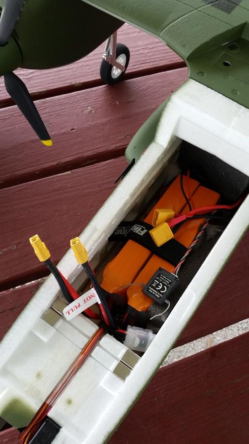

    A few posts back I mentioned I was going to try using a pair of 4-cell 2500's. There was some concern because they are lighter than the 3600's and perhaps there would be a balance issue.
    RONWC mentioned that he didn't have a problem with the smaller packs. My report: I tried them today and had good results. No issue with the balance, and the model performed well during two flights.
    So here's a picture of them installed, you can see they are not pushed all the way forward, they are about an inch back from the front of the battery compartment.
    During the first flight I tested the balance and found that the model was actually still a bit nose heavy (it needed a LOT of down elevator when inverted) So I could probably push these 2500 packs even further back, but it was ok.
    I got about 6 minutes with the 2500's and had about 35% left. (I can go for at least 10 with the larger packs)

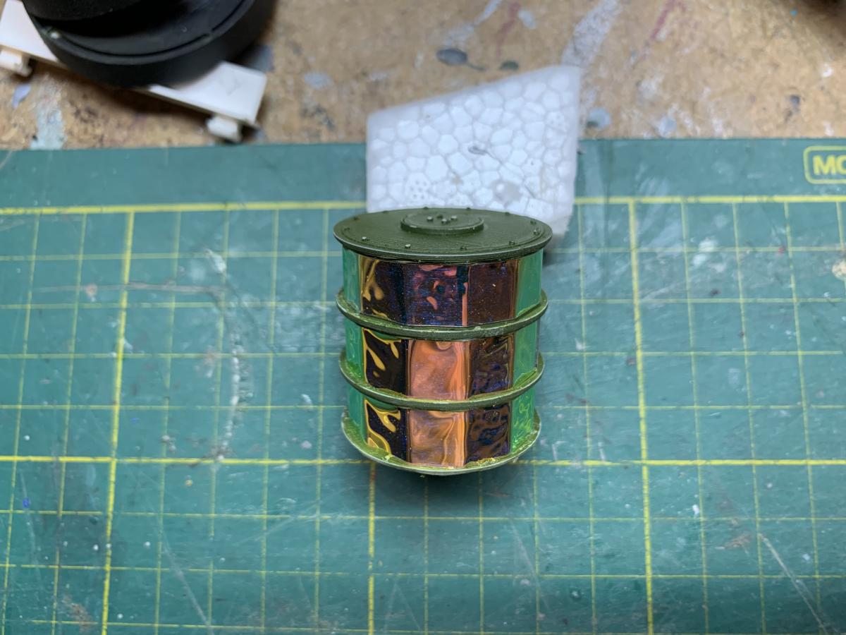

    Well that turned out really sweet! What material did you use to make the reflective panels? My guess is a strip of shiny tape?
    Evan wins the prize. It is window tinting material. I bought a sample a few years ago for around $5 and was using it for my HUD’s. I decided to see how it would look here and I’m quite happy with the results.

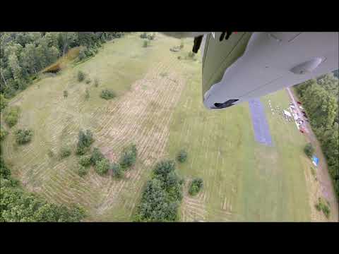

    Here's the video of this mornings flight (WARNING - hat cam video) ...................................
    This flight began with the gyro OFF till about 2/3 to the end. The thing that's more evident in the video is the slight wing rock, which is associated with the tail wag. Once I flipped the gyro ON, the wing rock and the tail wag was gone for the last 1/3 or so of the video.
    The 5-blade Scimitar props made a significant improvement in pull for this plane. Loops could be done from level flight without falling out at the top. However, I did notice (audibly) that from about 9 o'clock to 12 o'clock in the loop, the motors couldn't keep to max revs. Those props really put some drag on the motors. Nevertheless, they pulled the plane through the loop very well (this is at 3500 feet elevation). For now, I'm satisfied with the mod but in time, I'll search for motors that can crank those props to full revs and keep them there throughout all maneuvers. In level flight, those props do give the plane some significantly more hustle. I much prefer the looks of the Scimitar props and they add that extra dimension to the sound. Upon landing, as much as I could poke a finger into the nacelle intakes, the motors did not seem hot.
