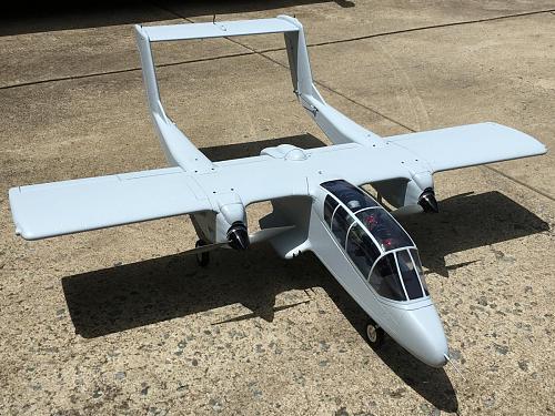

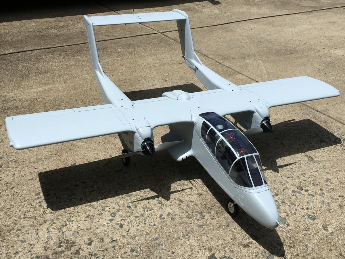

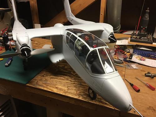

    Exhaust painted .props ,spinners , tank ,missles pods ,wheels done in white
    and wing done waiting for callie graphics..then ready for maiden ..
  • Gilatrout
    Coming along nicely
    Wing repainted and waiting for Callie. Fuselage and booms almost ready for trim color.

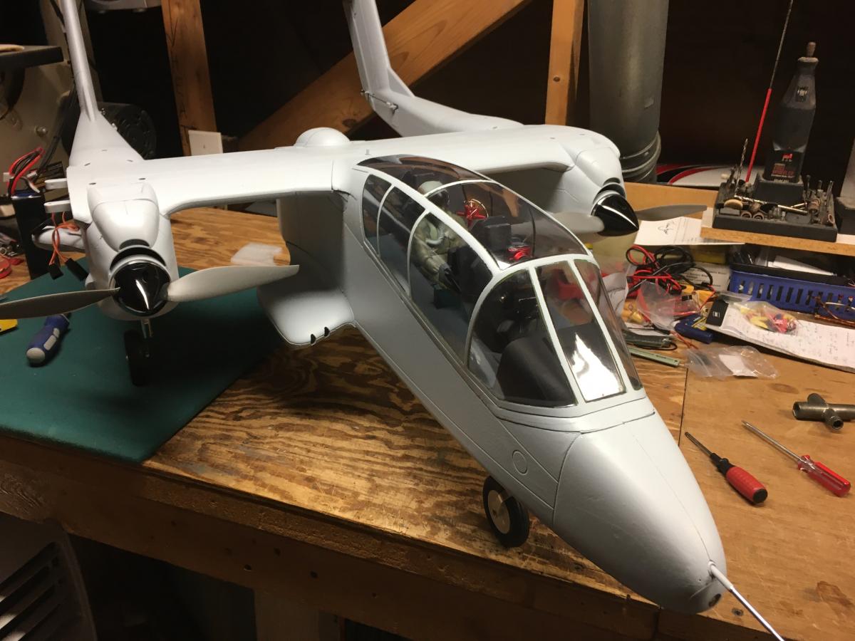

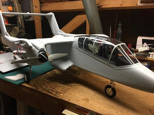

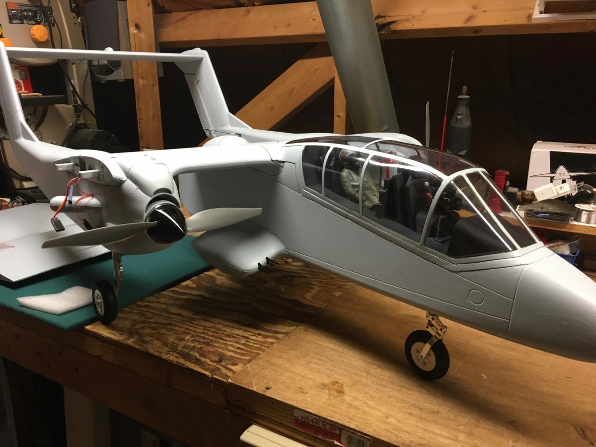

    Click image for larger version  Name:	31B61443-7AB1-427C-AA09-E86EA7B0A217.jpeg Views:	0 Size:	116.8 KB ID:	261823Click image for larger version  Name:	ADC22B99-5B93-490A-AD1A-088E631A036F.jpeg Views:	0 Size:	116.4 KB ID:	261822 Thanks guys. Mine is pulling 56A and 860W per motor on a charged battery. I think that's about three times stock power. Way more than 1:1.
    I haven't weighed it yet but with the added P&T FPV system and repaint it will be a little heavier. I removed the wing ribbon cables and interconnection and right sized extensions and Y's so I've saved some weight there.
    I still need insignia and marking, those will be added after the maiden.
    3221g or 7.1lb or 7lb 1.6oz... Oh, no ordnance or even the center pylon.
    I also had to move my elevator link in one hole on the servo, I was getting way more than book full rate.
