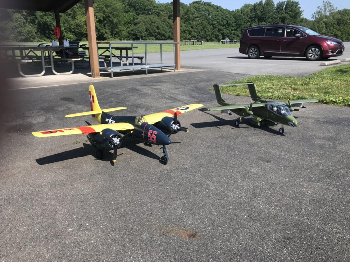

    MB, I agree. This was a great plane to fly. I made my maiden this morning. I don't know which flies easier, my Bronco or my Tigercat. My only regret was that I was at the airfield by myself so no chance for a video. But here she is resting after her maiden. I was sad I left my drop tank at home. Click image for larger version  Name:	OV-10.jpg Views:	0 Size:	310.2 KB ID:	261036
    Funny you should mention TigerCat. My pair for flying this morning.

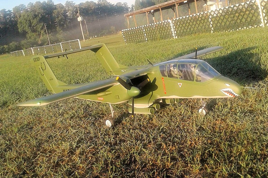

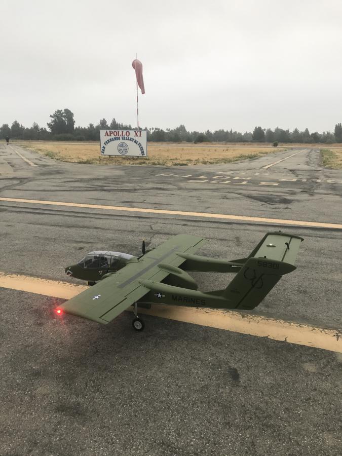

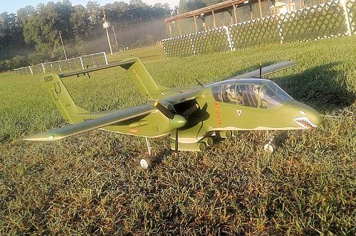

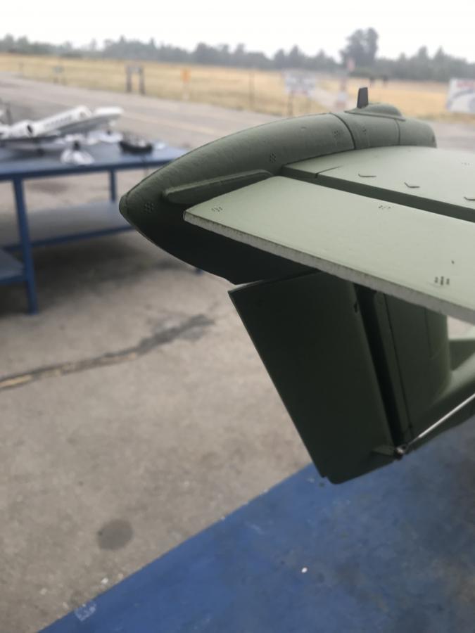

    All built. Maiden set for Monday morning. Followed the build video from MotionRC. That helped. Blue box set up was not the easiest. Bypassed then blue box in a couple areas. Syncing the ESC was not well described. Seems like they got out of sync. Then one prop had the brake and other spun freely at throttle cutoff. But managed to get it back in sync. Will maiden on 4s 3700mah 50c. Car is packed up. Managed to get it on without disassembling.
    EDIT: Successfully Maiden. I was the only one at the field at 6am so no footage. 🤣
    With 4s 3700 pushed all the way forward, still needed quite a bit of down trim. Easy flyer, much like a Trainer. Agree that book flap to elevator mix is reverse. Plane does balloon up with flaps deployed. Slows down well. Good slow flight characteristics. Lands WELL. Good purchase.
    Last pic is where my elevator is positioned for level flight with battery full forward.

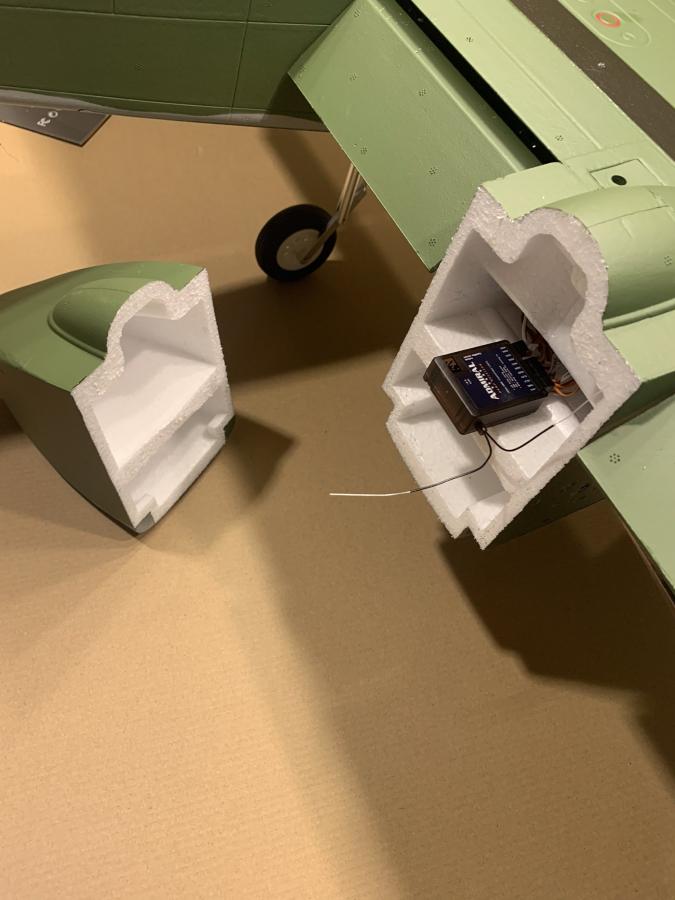

    Just used a fine tooth 6in razor saw, sides first then top and bottom. Since it is only 1/2 in thick on each side it cut easy and fast. Marked cut lines first on the sides with a sharpie. Once the outer skin was cut through all the way around, a Long utility blade took care of the inside foam piece, slipped in from both sides. Hope this helps.

    Well it worked better than I even thought it would. The inside is hollow with a nice platform area ready to use. Lots of room! Cut through 1/2 inch of remaining foam firewall, and access to the blue box area is achieved. 4 1/4 inches Of usable room in addition to another 5 inches in the rear section itself.
    Don
    Did you use a band saw? That's a nice looking cut.

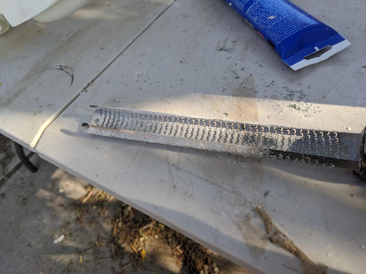

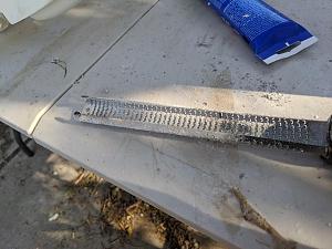

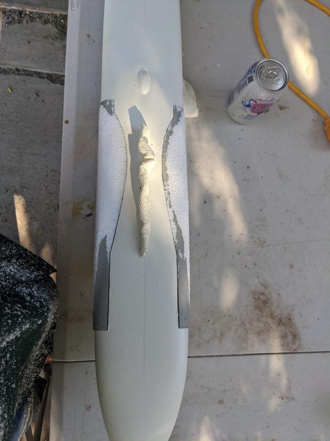

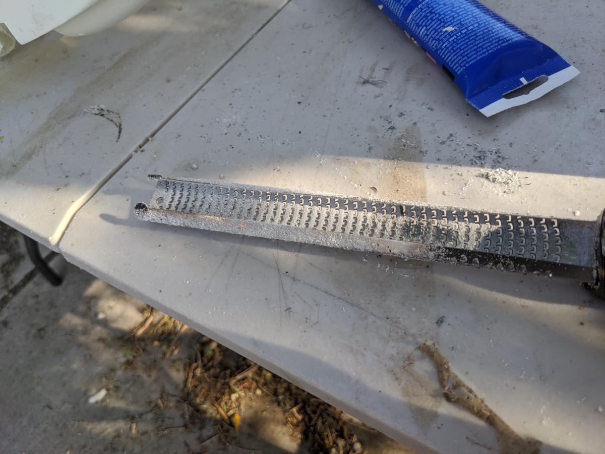

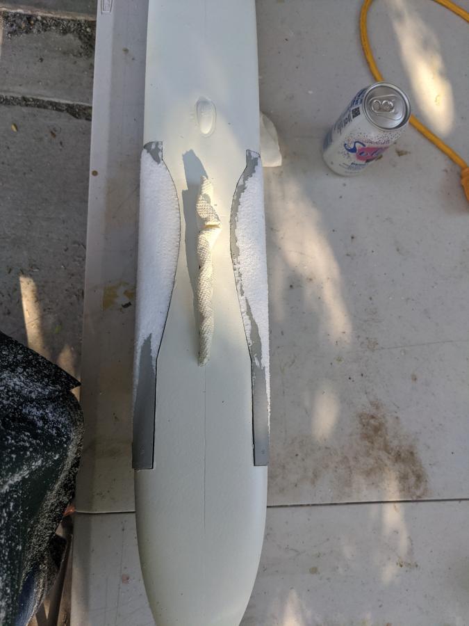

    Roughed in the removed ordinance wings for the Cal Fire repaint. Used a microplane. Works fantastic and doesn't tear up the foam cells. Just don't tell your SO what happened to the cheese grater. Also do it outside or you will have more to explain than just what happened to the grater.

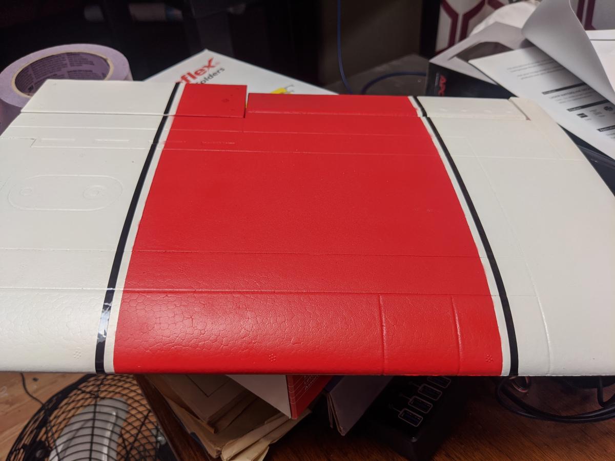

    Getting started...

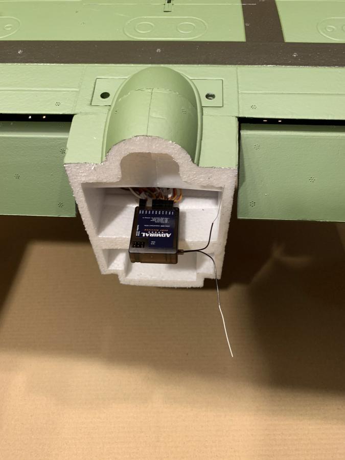

    Receiver installed in Avionics/cargo bay

    Thanks, great spots to move the MCBe and receiver to.

    This is brilliant! Thanks so much for posting this :)
