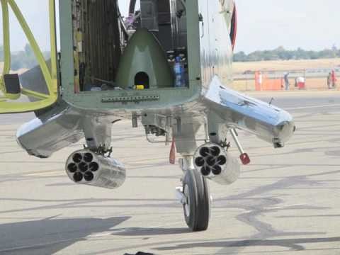

    Here's some 7 tube launchers I designed...scale to fit, I made them for helicopters .

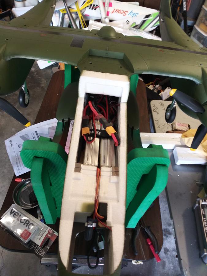

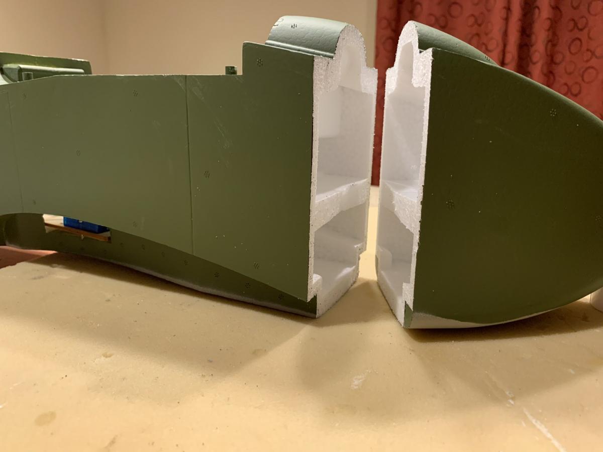

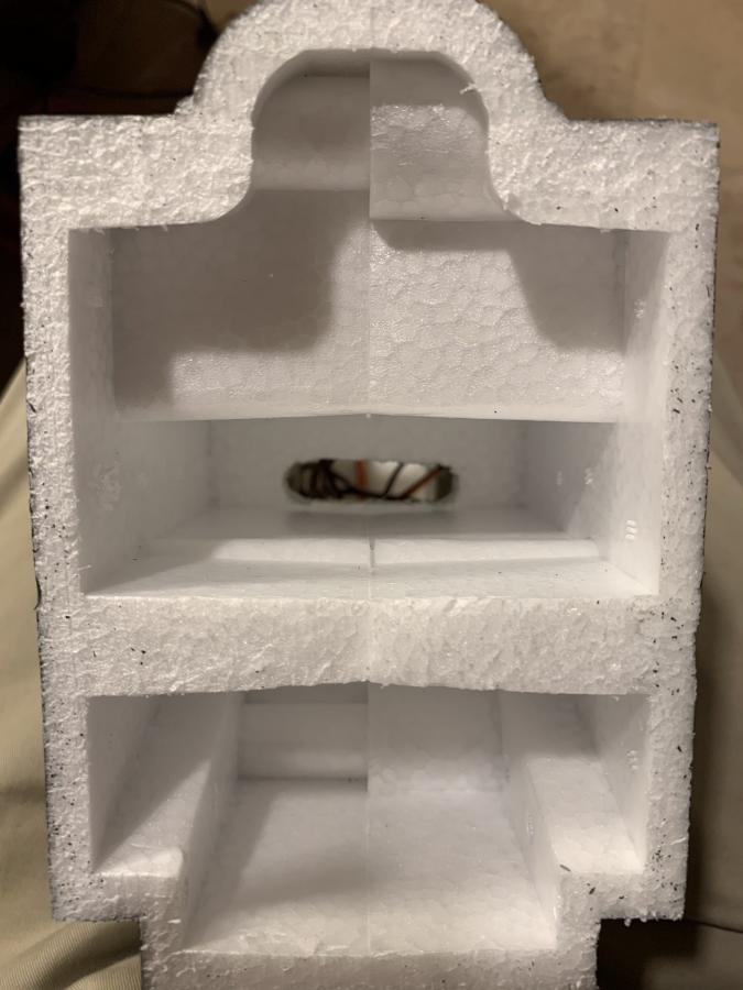

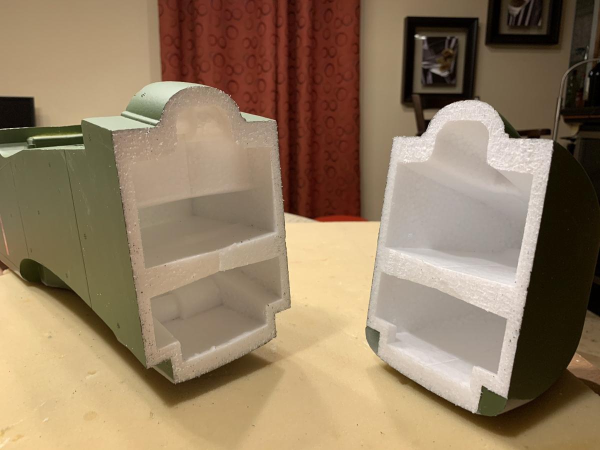

    Well it worked better than I even thought it would. The inside is hollow with a nice platform area ready to use. Lots of room! Cut through 1/2 inch of remaining foam firewall, and access to the blue box area is achieved. 4 1/4 inches Of usable room in addition to another 5 inches in the rear section itself.
    Don

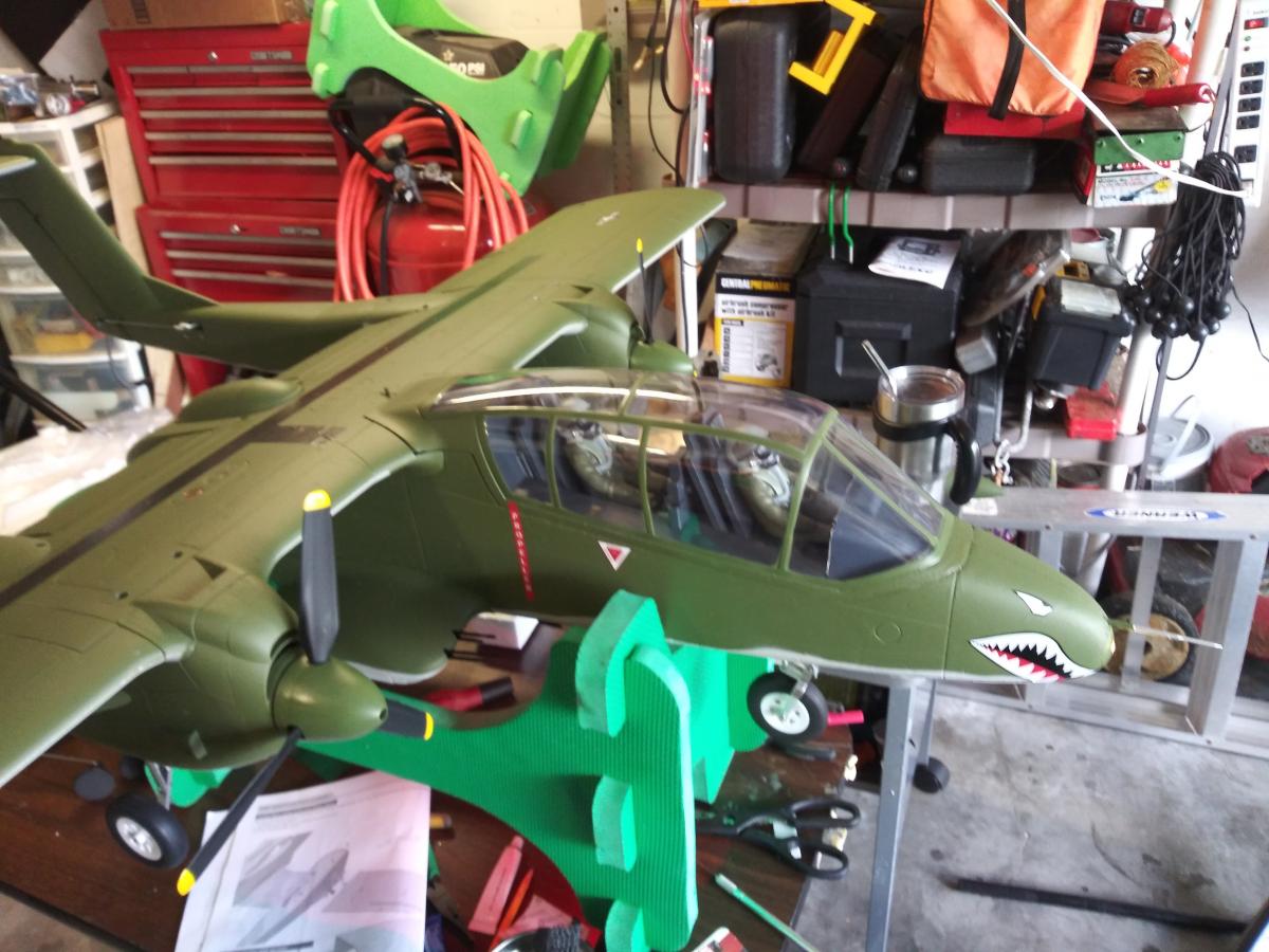

  • jimmyp51d
ID:	260798 Just finished mine.

    Placing the receiver and their antenna(s) between the batteries and the wiring rats nest around the blue box is less than ideal from a signal reliability perspective. I’m thinking of making/cutting the center fuselage rear hatch and hollowing out the area behind the Blue box and wiring rats nest for the receiver and it’s rear facing antennas. Using the new rear hatch for access.

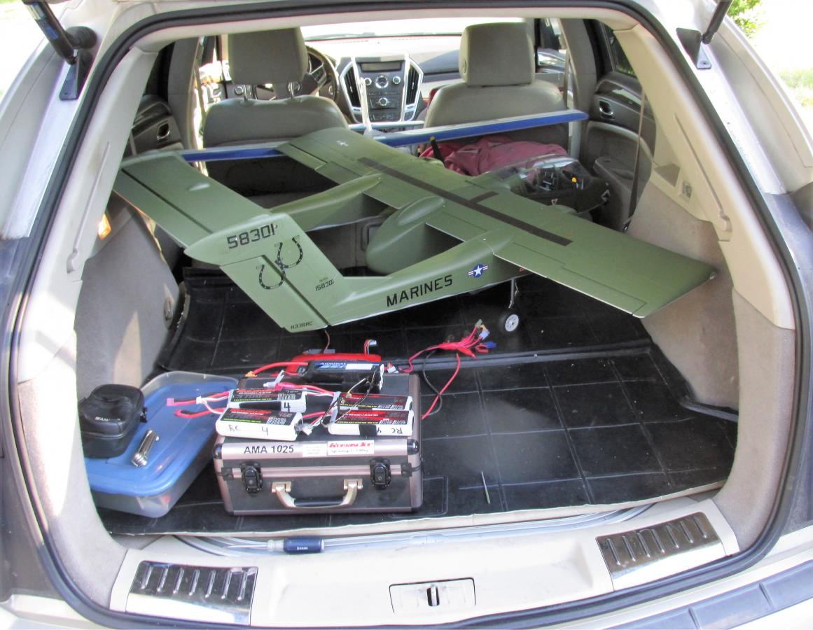

    I is really fun doing touch and goes with about 45 degrees of flaps, no bad habits of any kind that I could find. All in all, a very good looking plane, flys very solid. I had to laugh, barely got it in my SUV in one piece, but could not get it out without removing one wing, which is very easy by the way. Will wring it out more tomorrow and report back.
