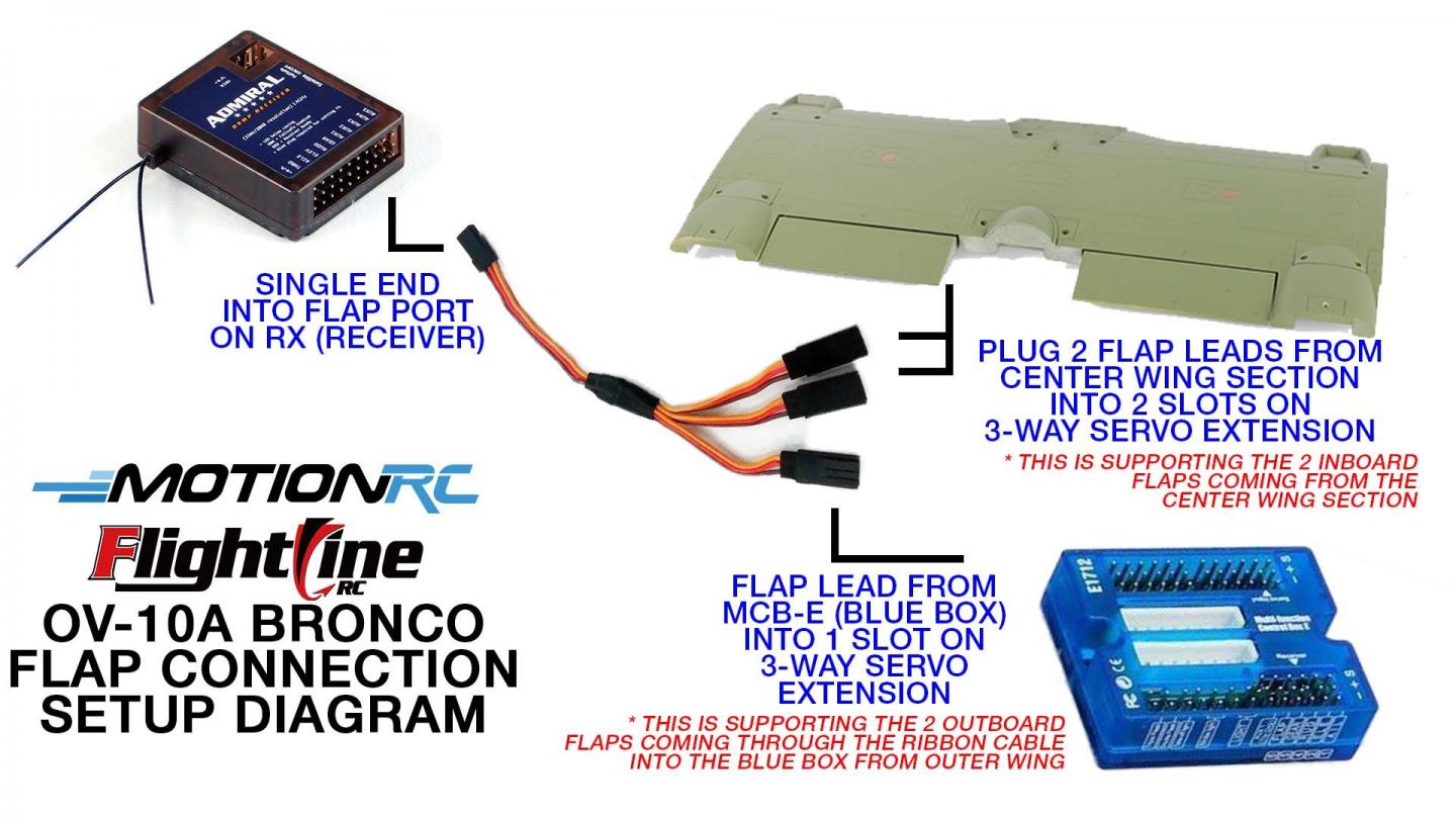

    Pilots! Our CS team is getting lots of questions regarding how to setup the flaps on the OV-10. So I will 100% make a video doing it again although you can see me do it on our live show here: https://youtu.be/P54ud8NdwT0?t=4179
    But, I whipped up a quick diagram that explains it. Basically, you are supplied the 3-way servo extension for the flaps. You will have both inboard flap leads connected to the center wing section, so plug each end of those into 2 of the 3-way extension slots. Then, your outboard flaps signals are sent into the blue box via the ribbon cable, so take the flap lead coming out of the blue box and put that into the third open slot on the 3-way servo extension. Then plug the single end of the 3-way extension into your flap port on your RX
Name:	OV-10 Flap Install Directions.jpg
    Hope this helps!

    Originally posted by RCGuy83
    There has been some confusion on how to wire the flaps using the provided tri-harness. The two outer flaps come into the blue MCB box through the ribbon cables. You take the male to male out put from the blue MCB box and insert it into the tri-harness instead of going straight to your RX. You then take the two inboard flap connections and also insert them into the tri-harness before running it straight to your receiver. In short: take all three cords labeled FLAP, insert them into tri-harness, and go straight to the RX with it.
    Click image for larger version  Name:	IMG_4519.JPEG Views:	81 Size:	89.4 KB ID:	260494
    ALL PILOTS TAKE NOTE OF THIS INSTRUCTION. Spent a few confusing minutes figuring this out as well. I wish I had seen this post first and I wouldn’t had been struggling and wondering what I was doing wrong. Boomer senior moment. 🤪
