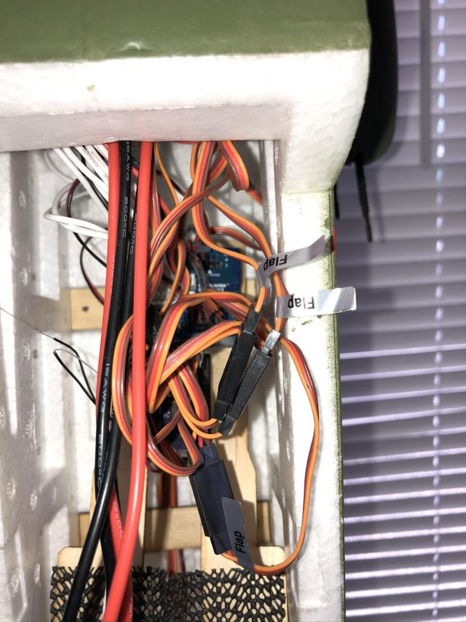

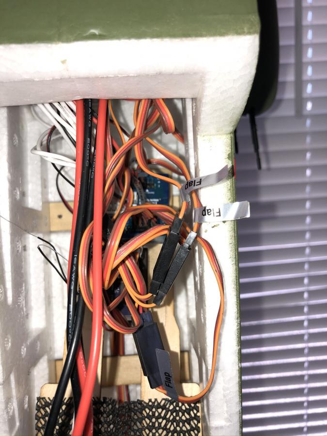

    There has been some confusion on how to wire the flaps using the provided tri-harness. The two outer flaps come into the blue MCB box through the ribbon cables. You take the male to male out put from the blue MCB box and insert it into the tri-harness instead of going straight to your RX. You then take the two inboard flap connections and also insert them into the tri-harness before running it straight to your receiver. In short: take all three cords labeled FLAP, insert them into tri-harness, and go straight to the RX with it.

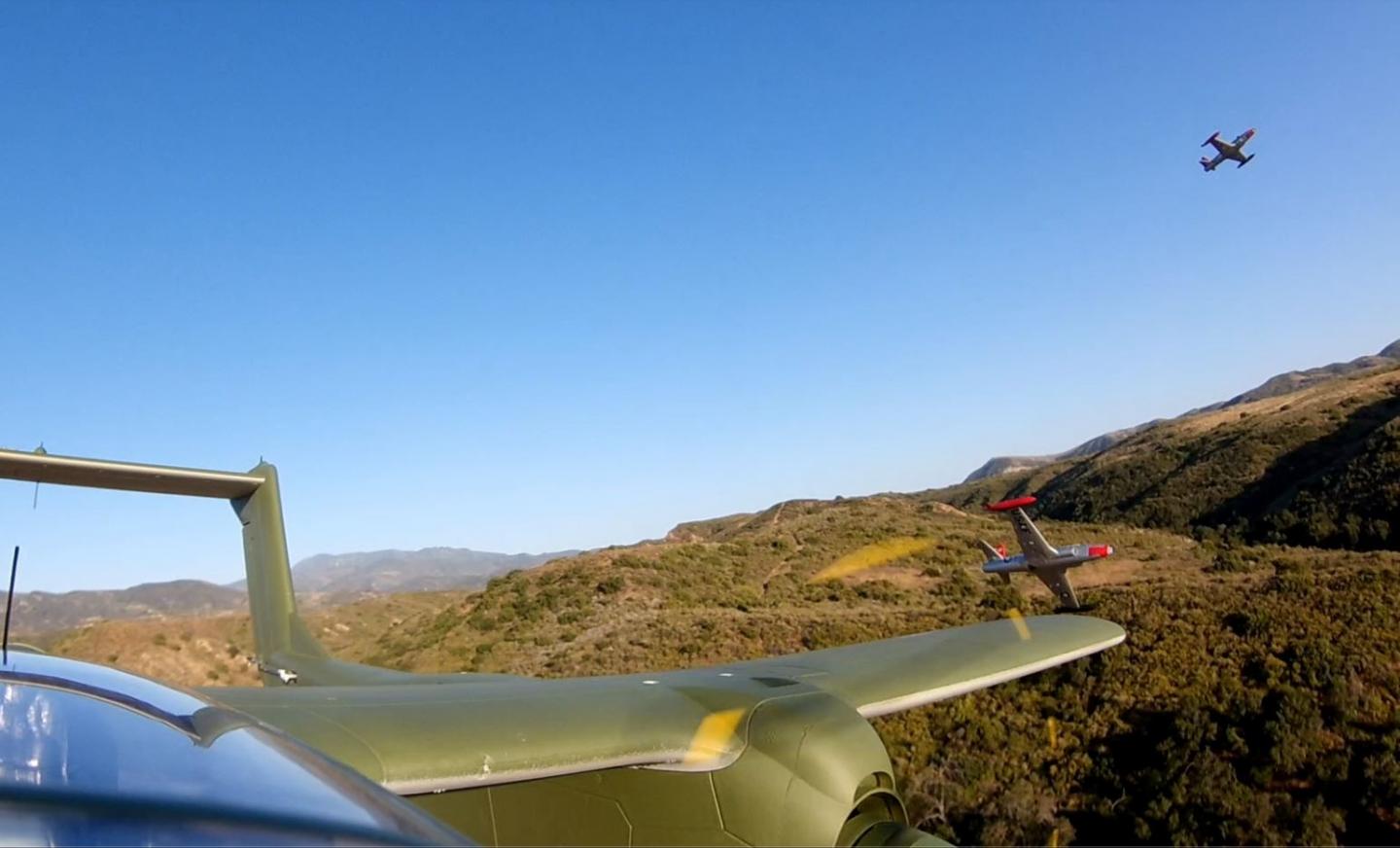

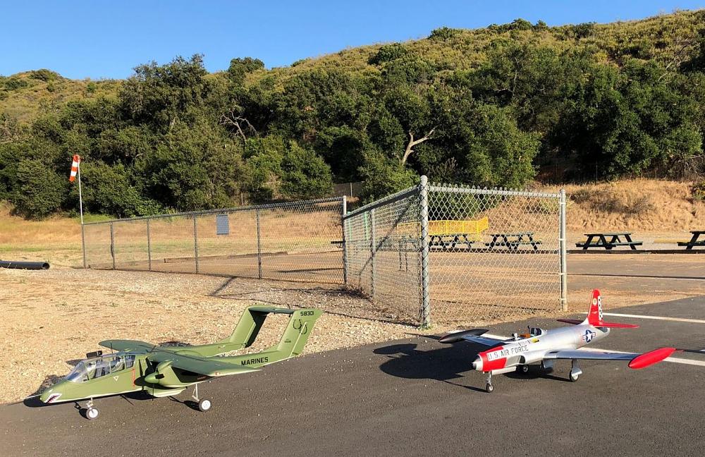

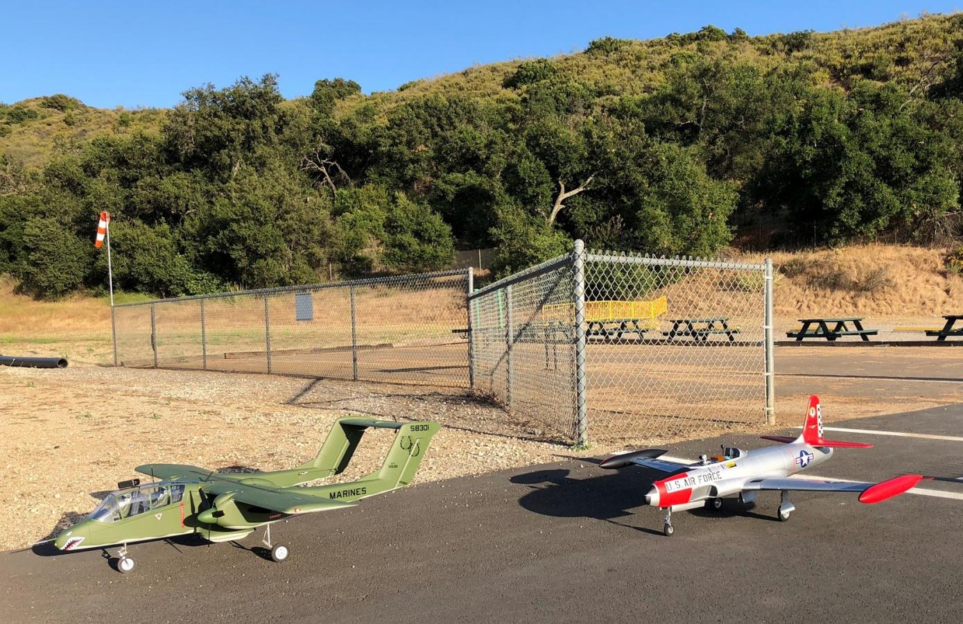

    Notice I left those pictures out of my posts. I still very much enjoy cracking the lid and pulling piece by piece out and geeking out over it but I tried to concentrate on reporting how she flies. Speaking of which last Sunday I was able to fly the Bronco in purely an observation role with 2X Freewing T-33's equipped with DJI HD FPV setups. We planned the flight out on the ground and with my RunCam facing backwards and towards the left wing I flew LOS in a large racetrack oval pattern. The FPV T-33's would seek me out and try and form up on my wing staying as close at they could. Surprisingly they asked me to slow down some so they could form up a little easier. From my LOS view it looked like we were going to have a 3-way mid-air collision several times so I had to fully trust they could see and avoid me. What was neat was with 8+min flight times I could take off, get comfortably into my pattern, play with the T-33's, allow them to land safely, and still had time to play before I needed to land. All three of us were constantly chatting with one another on the flight line which was key to avoiding collisions. It was some very different RC flying, a bit nerve racking, but also really fun! The Bronco is a versatile platform and that giant canopy is itching to be FPV equipped.
