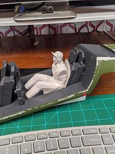

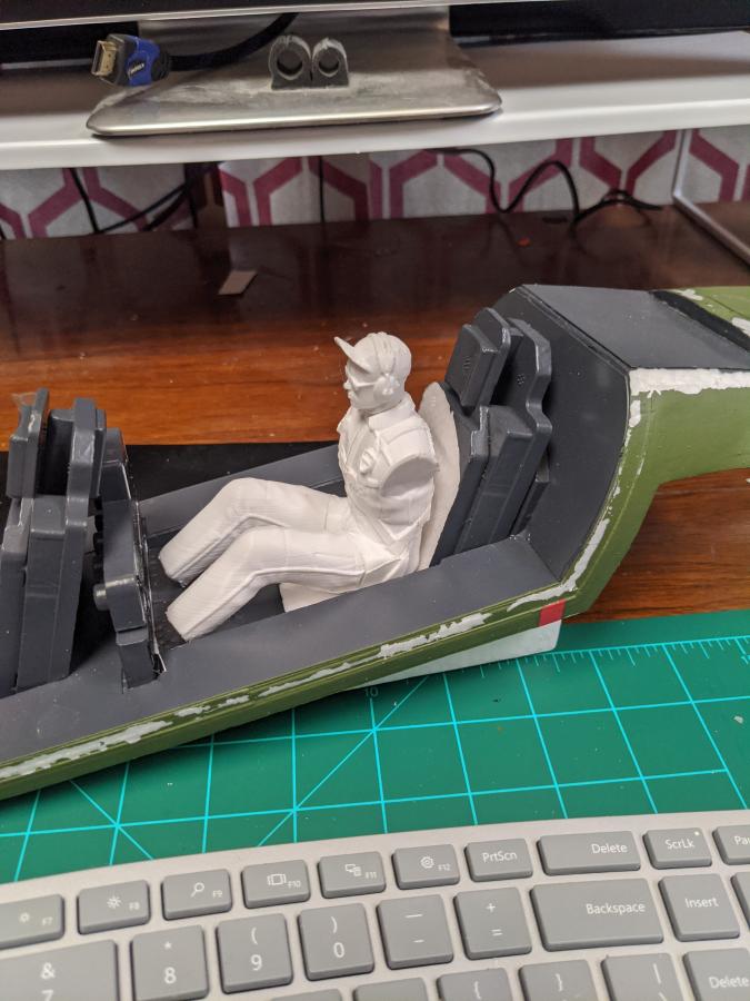

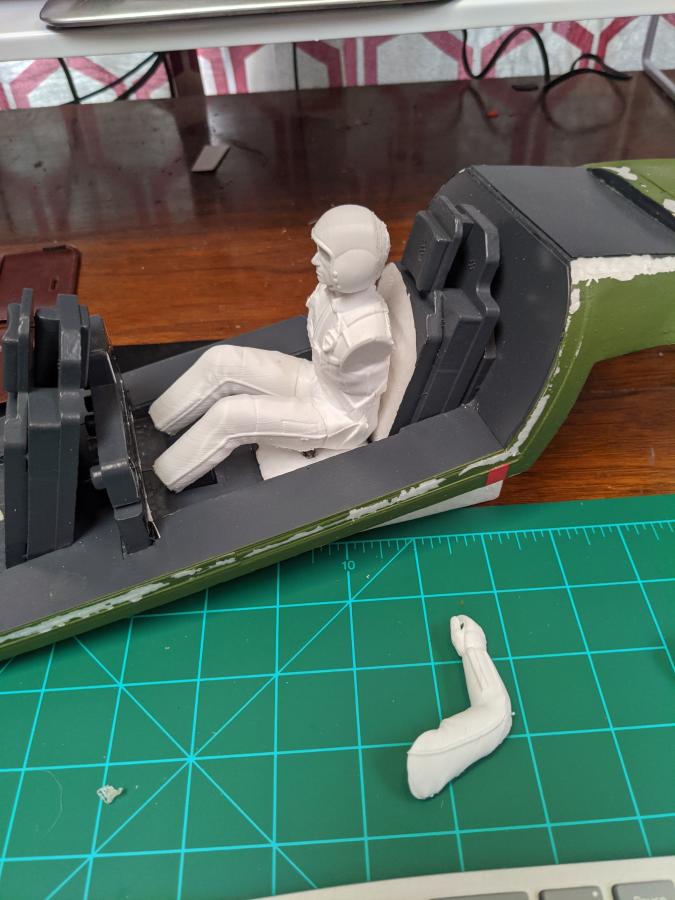

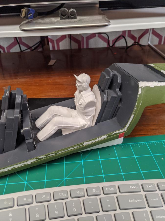

    ​​​​​It's hot, so I'm gonna mess with the cockpit for a while.
    Observer is all printed, I'll attach the arms after I smooth him out some.
    It took some fiddling to get him right. While the plane is listed at 1:8.5, the seat is closer to 1:11.
    He started out as a 1:6 figure I got off Thingiverse, scaled down by 55%. His head comes from other work by the same designer. He'll get a mic and some other details before he takes his seat full time.
    Click image for larger version  Name:	IMG_20200630_083708_01.jpg Views:	0 Size:	70.4 KB ID:	262119
    Click image for larger version  Name:	IMG_20200630_123300_01.jpg Views:	0 Size:	75.5 KB ID:	262124
    I've been avoiding the instrument panel, hoping someone better than I can take on that task.

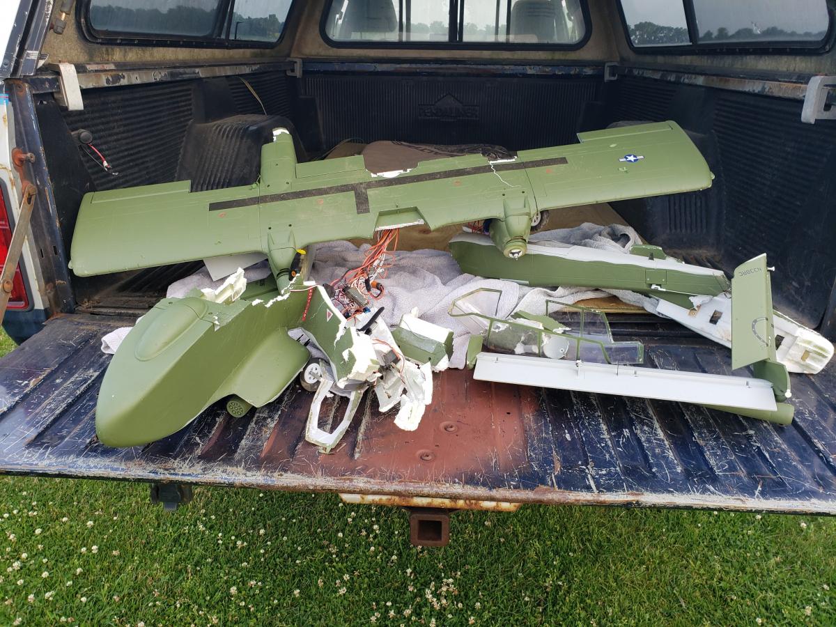

    I tookoff and made a right turn to the downwind led. Abeam of the takeoff point it started a roll to the left, I applied right ailerons to correct with no response from the ailerons. Telemetry showed no loss of signal and no holds. It went in at full power in a nose down attitude. Power was killed just prior to impact with the throttle cut.
    Had you gotten to the point of programming the Receiver? From what I understand you fly the plane with the AR637T first and get it trimmed then go for the AS3X programming and SAFE if you want to. I only ask because I’m going to use the same receiver and am a bit nervous now. It almost sounds like your plane was told to roll left and the correction you made was ignored. If you haven’t you ought to post this on the RC Groups AR637T forum. Andy from Horizon monitors it and may have some insight.

    And it passed a range check? I assume you had the control surfaces all going through the BB? I don’t think that would cause loss of all control and then having it back post crash but it could...
    Originally posted by KC8REH
    Post crash control check did not have any problems with the primary surfaces. Other than the ailerons and rudders were distroyed

    tonight I had a Second crash with My New OV10. Radio range test was Perfect and CG was on the money. I had a similar situation last week that I initially thought was "Dumb Thumbs" on My part. That crash cost me a new main wing, center pod, nose and left gears and retract. 2 props and a canopy. Tonights is a Total loss. Radio is a Spectrum DX8G2 and an AR637T reciever. As3x and safe were Off. Batteries used were Spectrum 4 cell 5000 MAH hard side Smart packe (2). Any ideas would be a Big help. I am sending the TX in to have it tested.
    Alpha I attempted to send this to You off this page but You have too many messages.
    I’m really sorry that happened to you and now I’m nervous. I have a Spektrum Ix12 transmitter and just bought a AR637T for my receiver and they are not cheap.
  • KC8REH
    OV10 Bronco Crashes.
