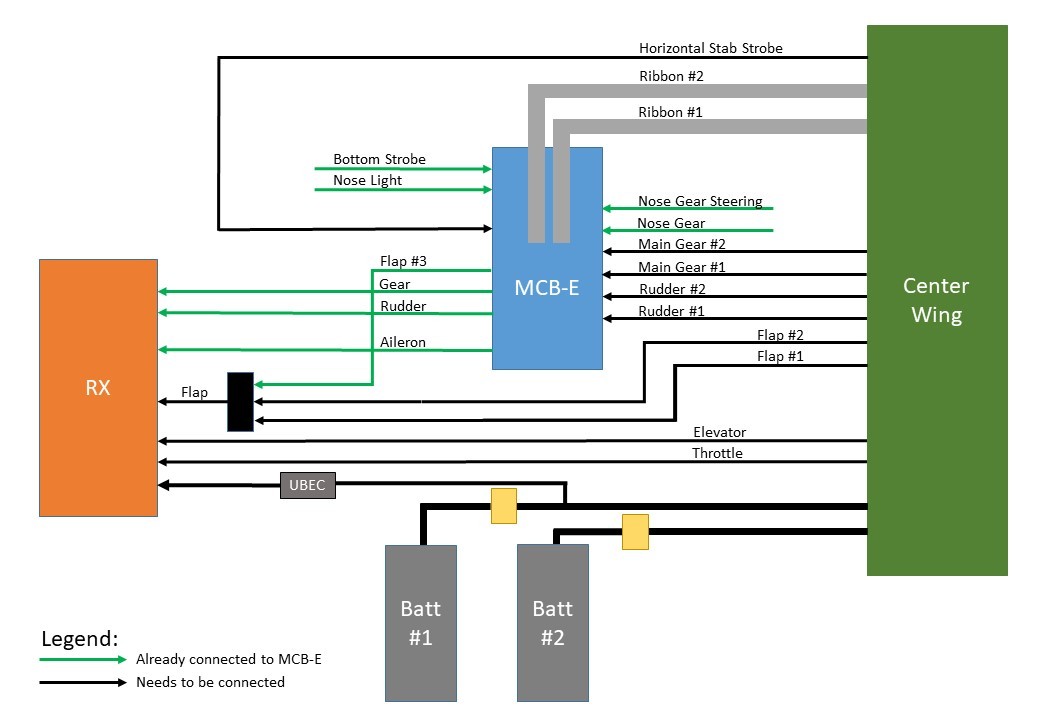

  • Jpmcdo
    Originally posted by Gilatrout View Post
    I did the utility hatch mod. The back half of the fuselage has tons of room to get receiver out of the way. The remote will be installed forward in the main battery bay.
    I've not looked at the blue box closely yet, but I suspect I may reverse the orientation so that the receiver wires point to the rear of the plane. I expect I'll also need to make my own custom leads to account for the greater distance between the blue box and the receiver. Once I get to that part of my build then I'll know more.
    The hatch was cut with a razor saw starting with careful measurements on each side. Then connect the top and bottom cuts. the side walls are thin. Internally there is a shelf which you cant quite get to with the razor saw. I used a hacksaw blade to make the internal cut.
    I then set a couple of 5mm cf rods to hold and register the hatch to the fuselage. I also added a few magnets to help keep things together.
    you will also need to cut an access hole between the rear bay and the battery bay. I used a brass tube with one end sharpened to reach into the cavity..
    The picture attached shows the hatch roughed into the fuselage. I still have some finish work before I'm personally satisfied.
    Thanks, gives me something to think about. I’m probably not going to use a satellite but may rethink that. The antennae wires on the AR637T are very long and will reach forward into the battery compartment away from the other wires. I may just unplug and start over after orienting my receiver. I am a bit reluctant to move forward until I decide on the satellite.
    Originally posted by Jpmcdo View Post
    Have you figured out where you will place the receiver? I’ve spent a few hours trying to figure out how to get it placed inside the fuselage with all the wires and blue box in the way.
    Since it's NOT a gyro RX, it can be mounted in any orientation. I'm using a Lemon 10-ch DSMX/P RX. I've got it mounted on its side, stuck to the wall, just in front of the BB and up high. The satellite is stuck to the roof, upside down, behind the hatch, using some very sticky 3M double sided tape. As I was building the plane, I started to plan the RX placement, so not a lot of thinking or time involved.
