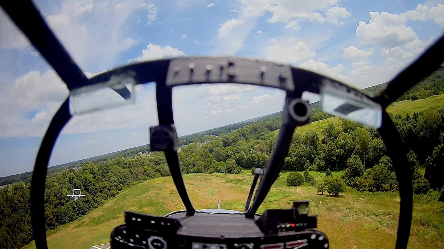

    Mirrors
    These are the 3D printed parts and the looked pretty good with the silver HVAC tape stretched over them. For my FPV use though, I wanted actual mirrors. They work but they are limited in their functionality.

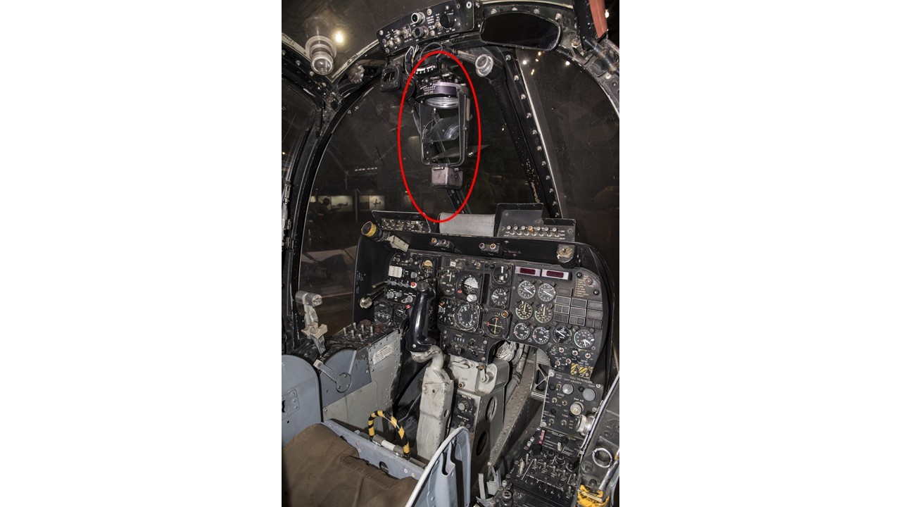

    There's a lot for the cockpit and I really designed it for how it would appear when I fly it in FPV. The aft cockpit is untouched and I don't have plans right now to do anything for it. The gunsight is pretty basic and it blocks a lot of the forward view on FPV so I elected not to use it on my plane but it will work for non-FPV cockpits.

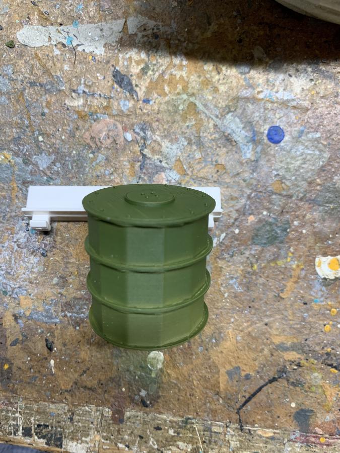

  • vduniec

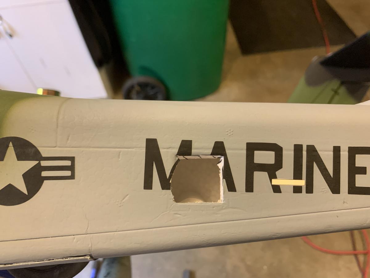

    The Chaff/Flare buckets go on the outside of each tail boom. Place the part according to the picture displayed and press it into the foam so that the back makes an indentation. Then cut out the indented area and the bucket should fit right in with the faceplate sitting around the outside of the fuselage. Be careful when cutting because there are wires that run through the boom.
Name:	Buckets Location.jpg
ID:	266490Click image for larger version
ID:	266491Click image for larger version

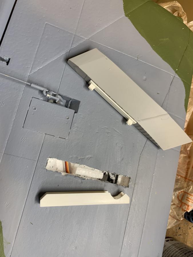

  • vduniec
    Next up is Ordnance. I designed the wing pylons and tanks. There are many other ordnance files that may be accessed from Thingiverse. There are Zuni pods for the Freewing A-4, same scale that can be used. There are also AIM-9 and launch rail there. The launch rail will have to be resized and cut but it's relatively easy to do. So for my contribution I just have the following to offer:
    Wing Pylon
    Wing Tank
    Chaff/Flare Buckets
    The wing pylons are designed for use with the Freewing 90mm F-16 weapons attachment system.
Name:	OV-10 Pylon.jpg
ID:	266481Click image for larger version

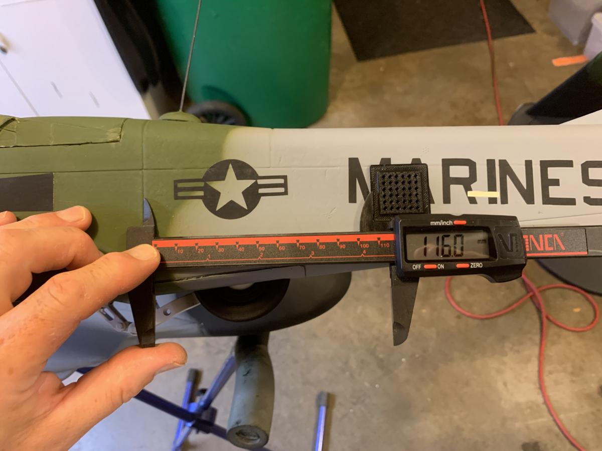

  • vduniec
    Previously posted but in keeping with the grouping, here are the FM Antenna Humps. I used a broom bristle painted black to represent the antenna.
Name:	FM Humps.jpg

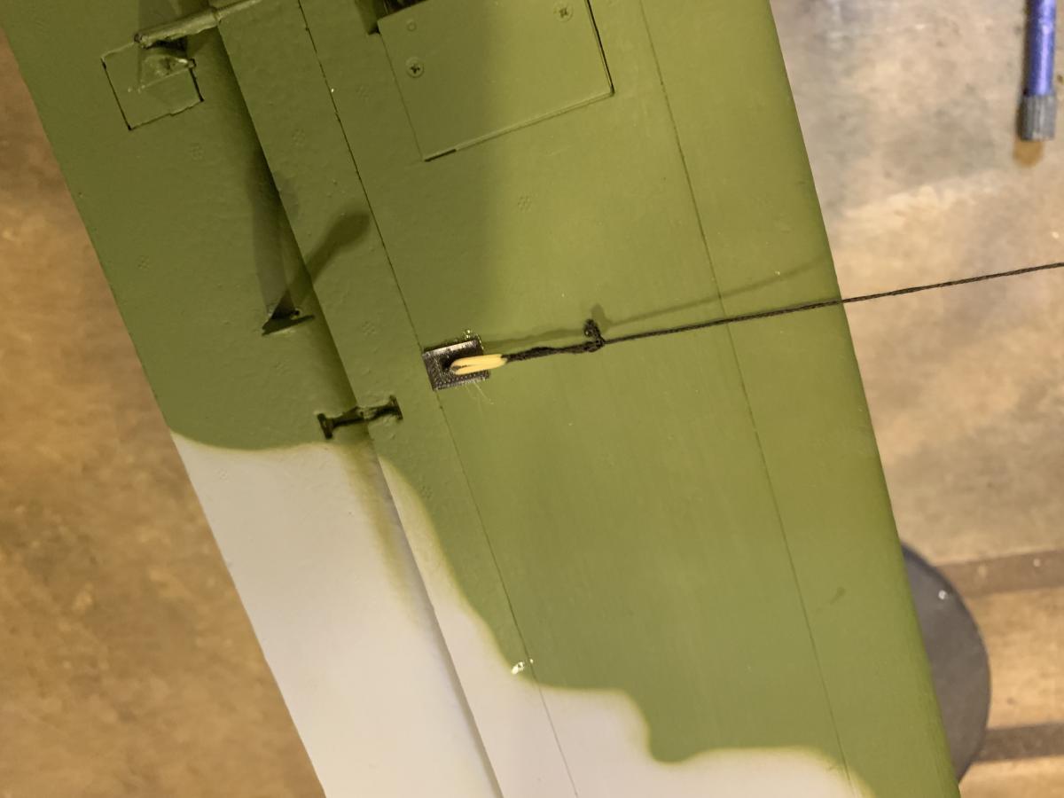

    High Frequency Antenna mounts. The wire mounts underneath the horizontal stabilizer and the atop the aft fuselage next to the IRCM system. In order to make the antenna wire removable during transportation, I affixed one end with a fishing swivel/snap connector and the other end with a small rubber band to keep it under tension.

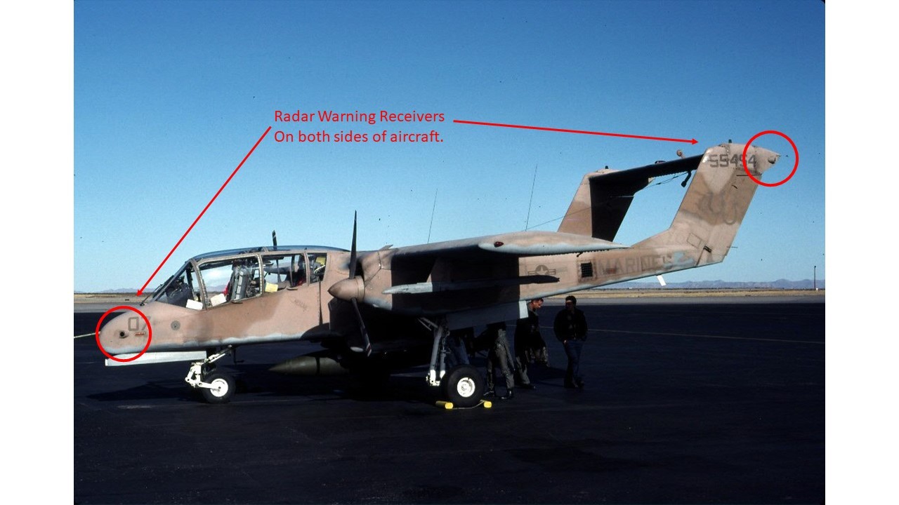

    APR-39 Radar Warning receivers. Positioned on each side of the nose and on the top of both outboard sides of the vertical tails. Combined, these receivers provided 360 degrees of coverage.

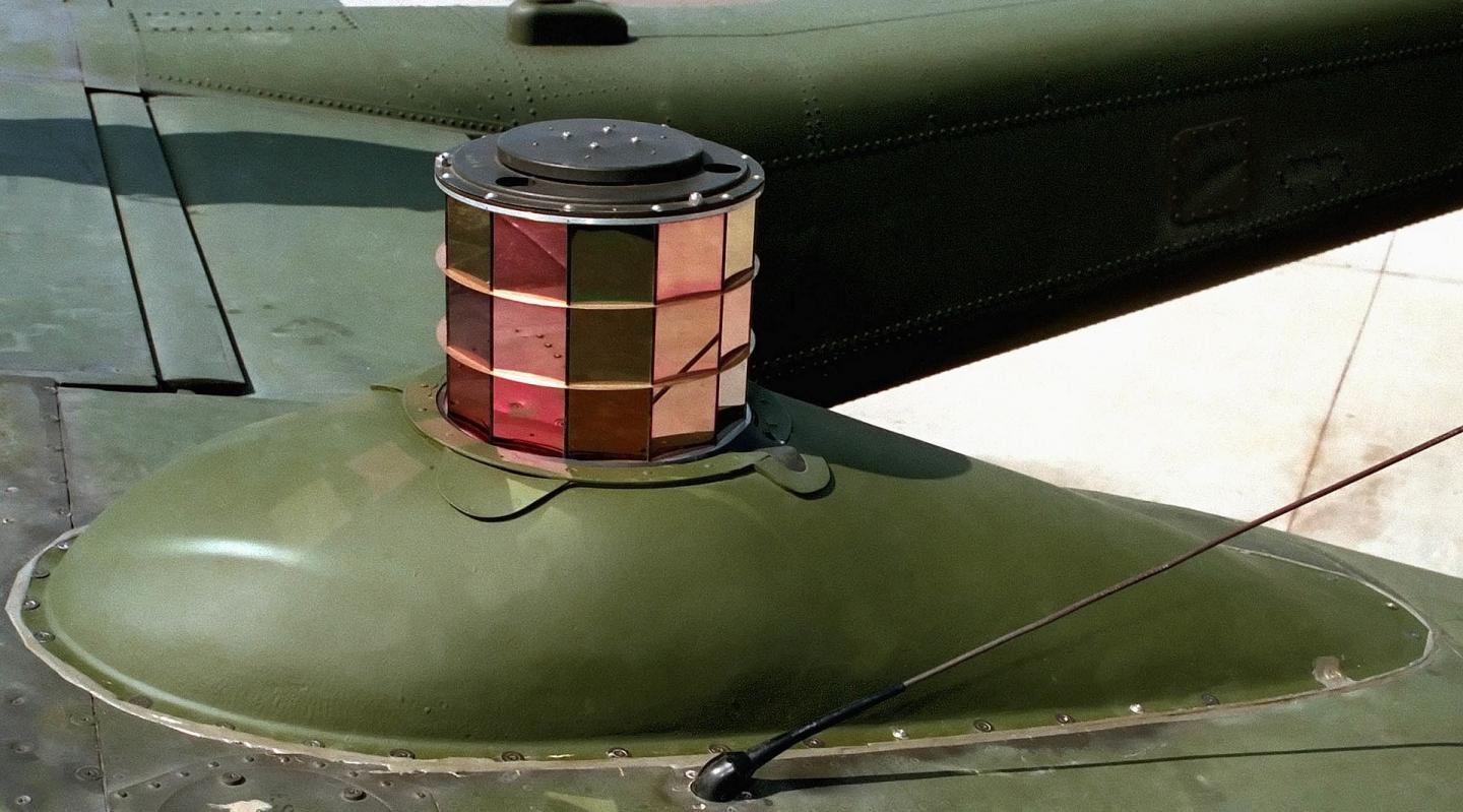

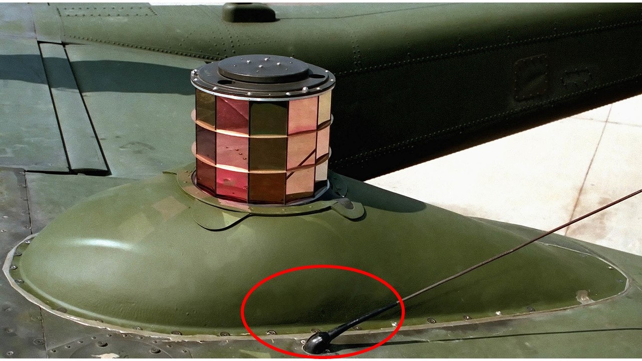

    ALQ-144 IRCM
    The "disco ball" was mounted atop the rear fuselage later in the service life of the OV-10. The part was printed and then painted. For the reflective surface, I use Solyx Specturm Dichroic Sample. https://www.decorativefilm.com/solyx...-dichroic-film The sample is free but you have to pay for shipping. I also use this film for my HUD's in planes and it gives a great effect. I cut the film into strips and used contact cement to glue them in place. I'm pretty happy with the end result.
