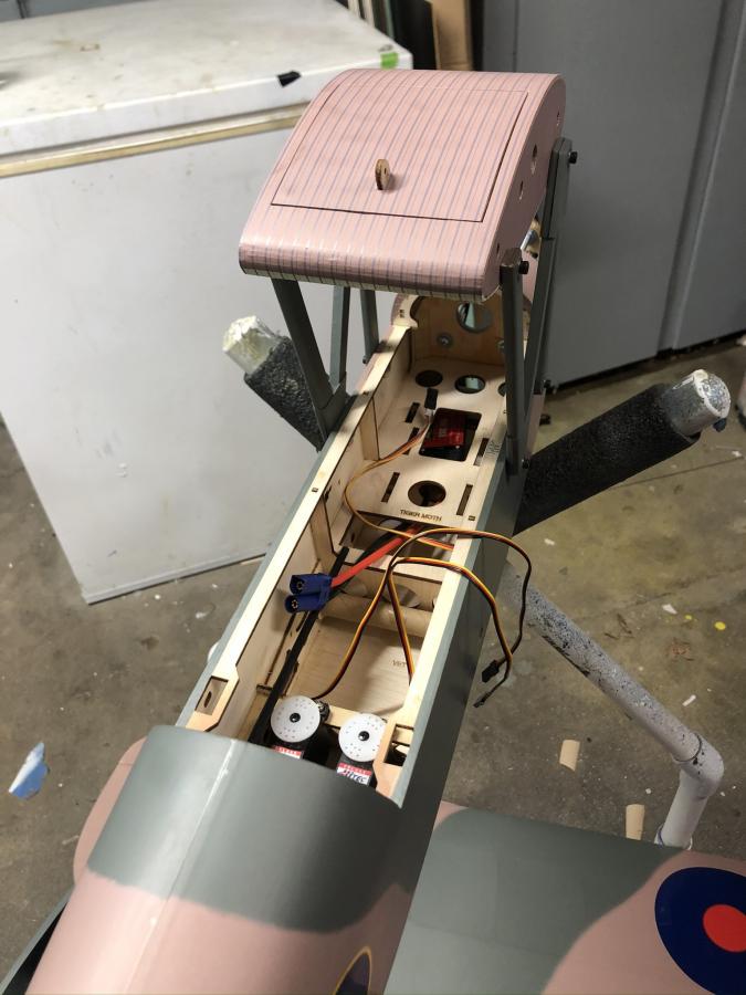

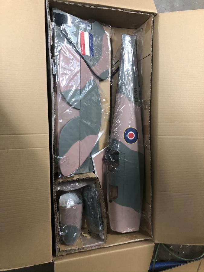

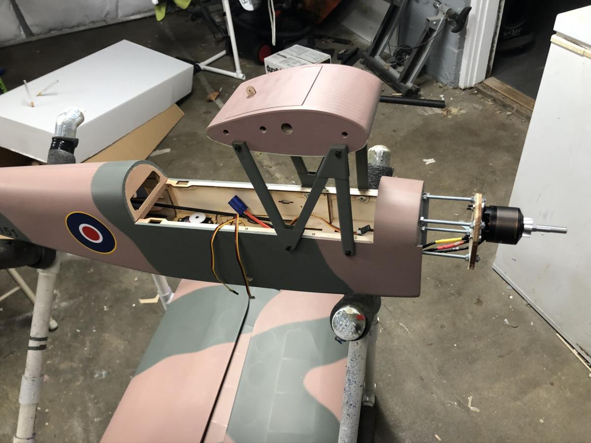

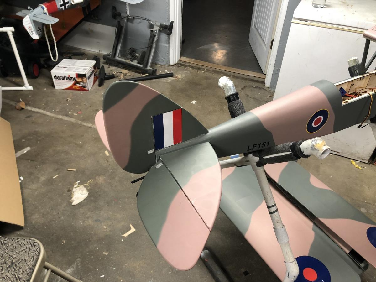

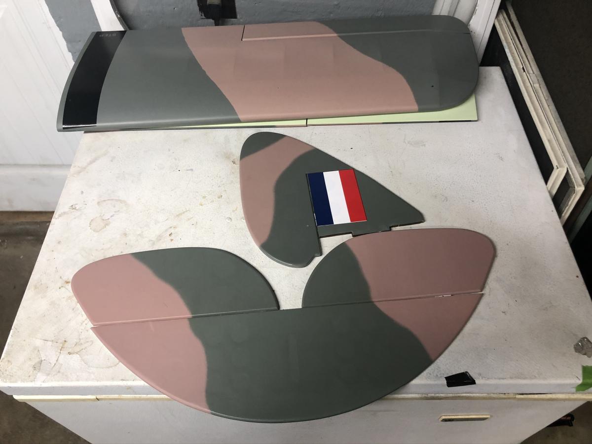

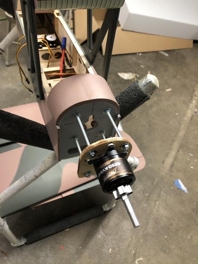

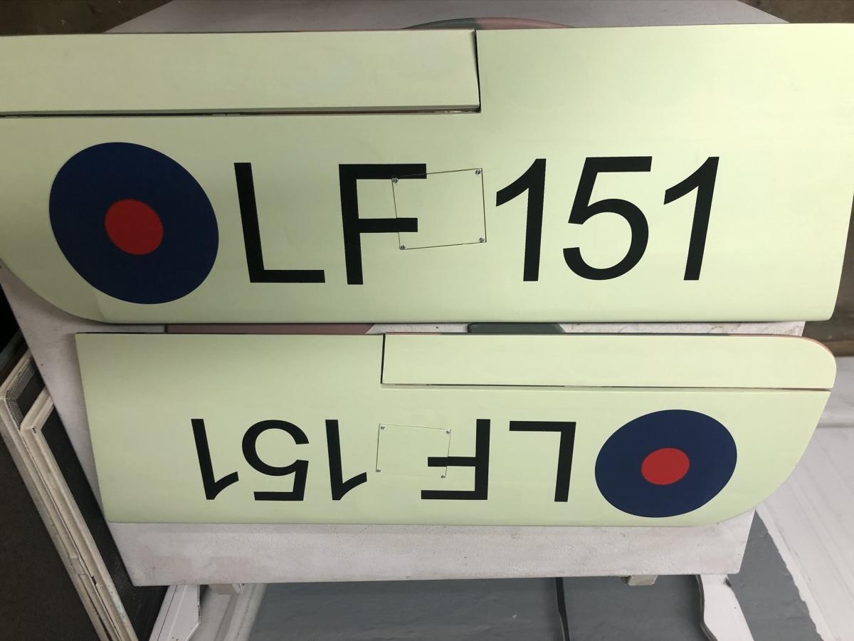

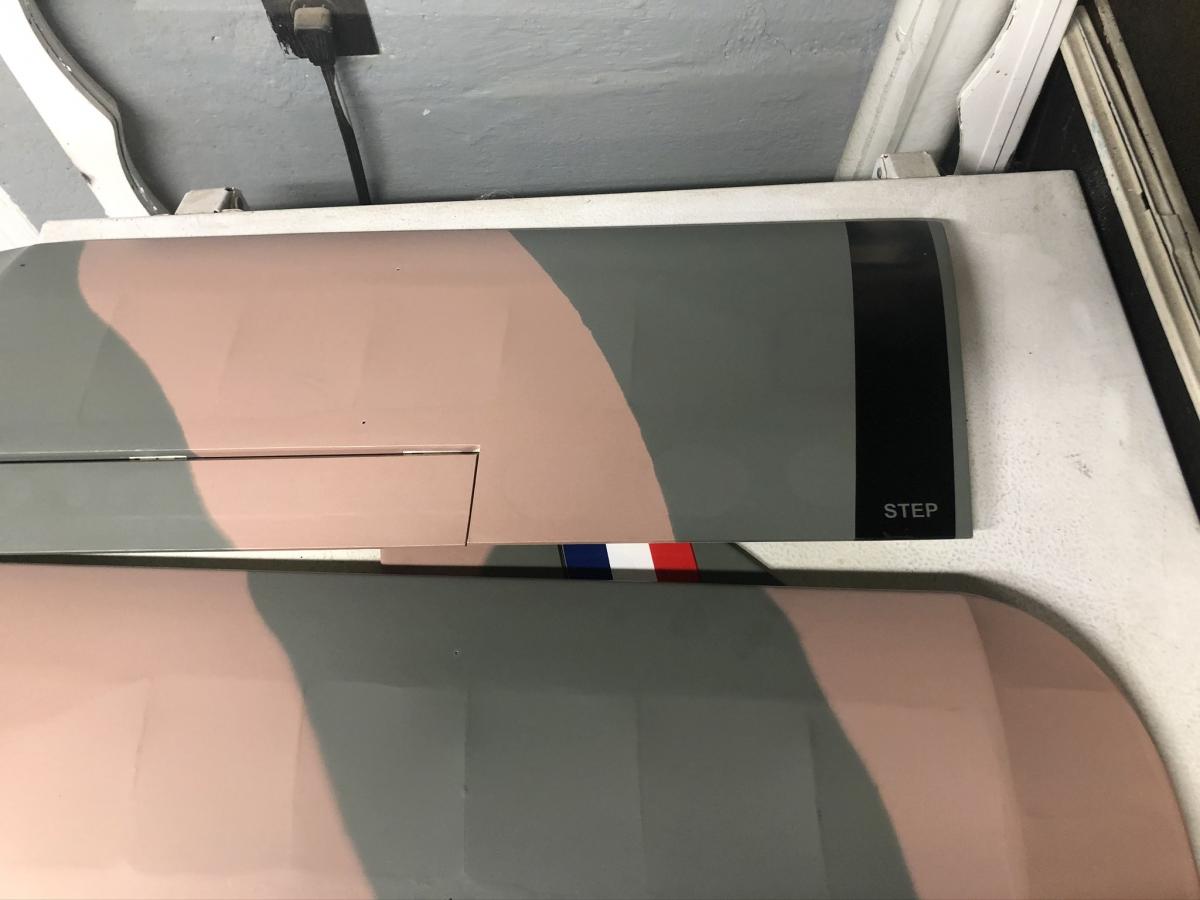

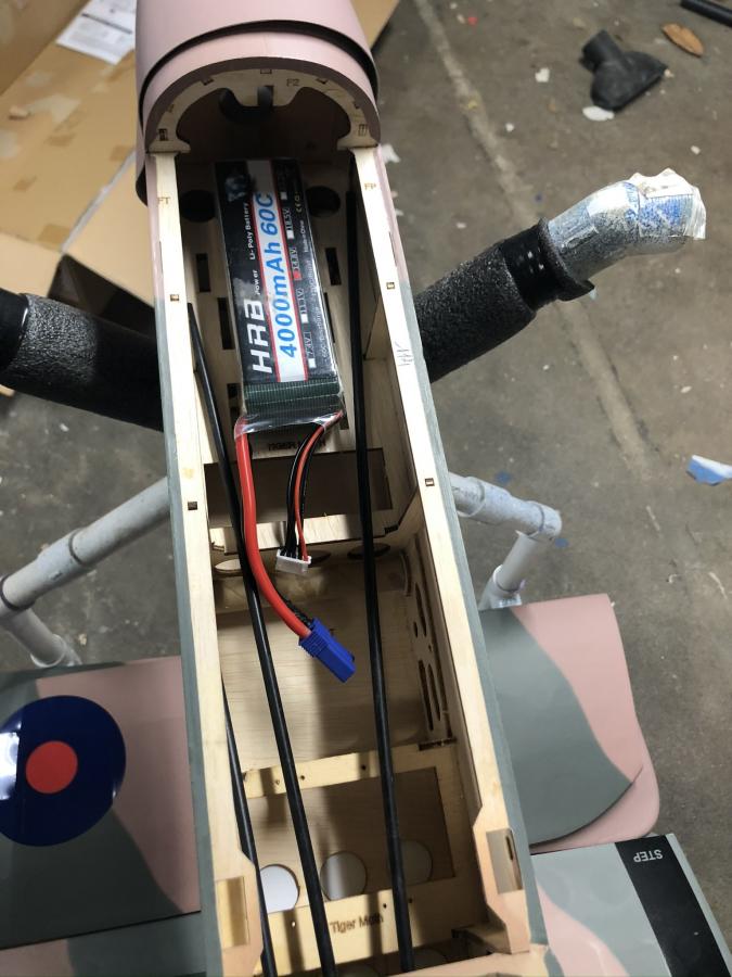

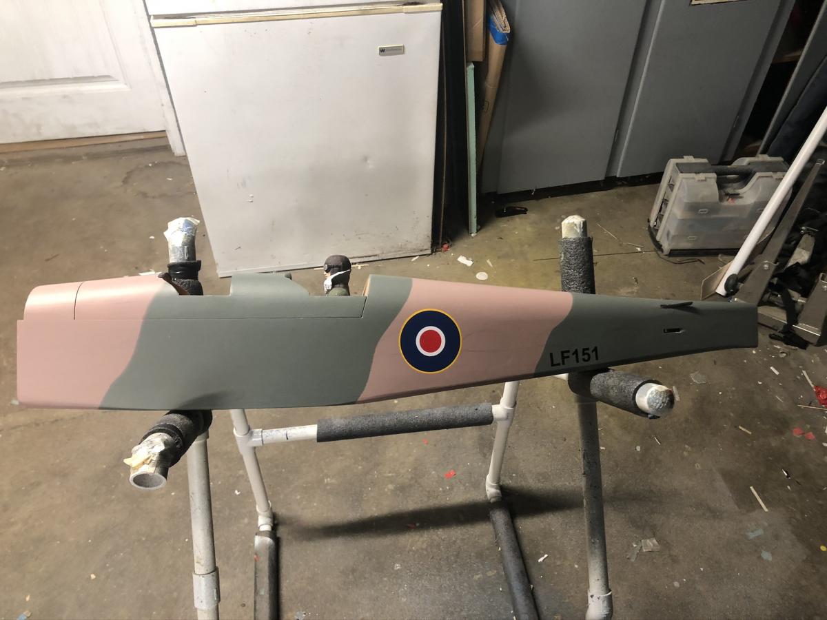

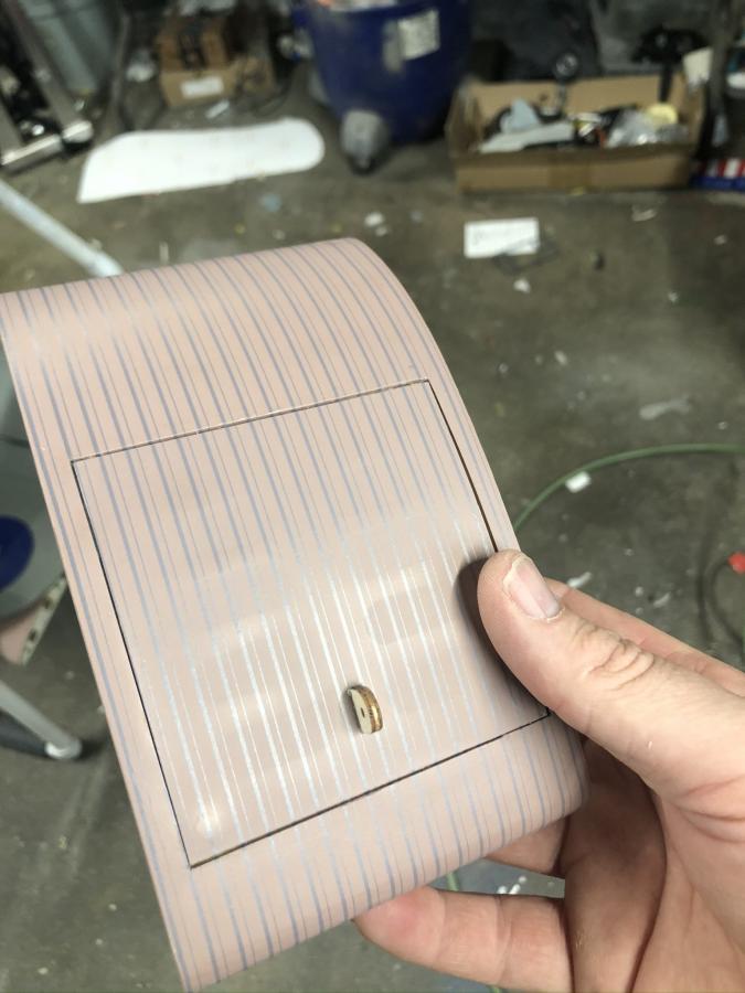

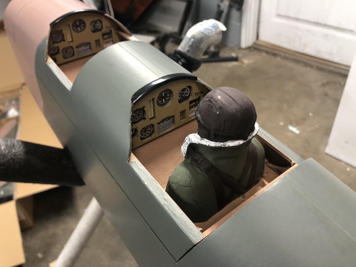

                My Tiger Moth came in last weekend and I have started assembling it. I am very impressed in the quality of this plane especially at the price point MotionRC is selling it. Everything is going together well. The only issue I am having at this point is getting enough weight in the nose to get proper CG, but I kind of expected that with a model designed to have a gas engine. Anyway I am uploading a bunch of pictures and will add some more as I finish up the build. I may maiden it this weekend assuming the weather cooperates (forecast is for rain)

                                  Ordered my Royal Navy version last week, arrived 2 days later. Great going Motion RC. As indicated by another member, there is a concern with balance using electric power systems. I spent this week assembling the plane and the balance is a real problem. I have a 3548 motor with 4S 4000mah battery for locomotion. It's a smaller motor but well suited to the 4S battery. Test flights will be in the morning. If it flies well, I may go back and build a motor box to mount on the firewall. This will allow room to open the firewall and move the battery about 3" forward and loose some the dead weight. I ended up adding more than 18 oz under the motor to get things right. For metric folks, that's 520g of ballast. My flying weight is 3550g or 7.8 lbs. Once I start test flights, I'll adjust the balance point to suit my style. I may end up loosing a few ounces when done.
                                  Alignment of the wings are another area of concern. There is a twist introduced by installing the wing struts. The twist does provide washout to the top wing which is good, but that also means washin on the bottom wing. This is not unusual for biplanes but forcing it by the struts is troublesome. It may cause a wing failure with the added stress that was not built into the wing during construction. Flying will tell if this will be a weak point or not.
