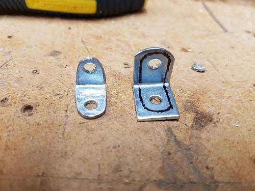

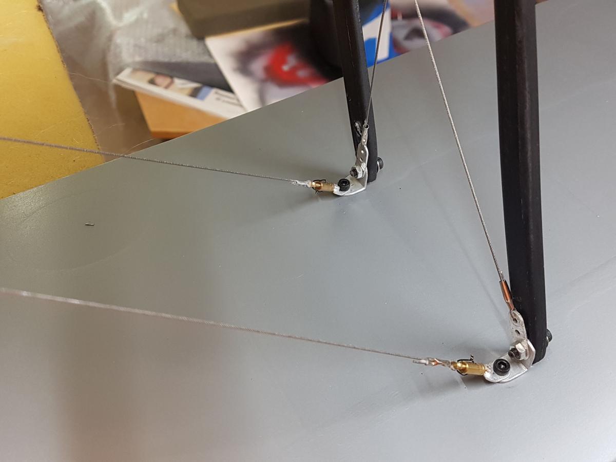

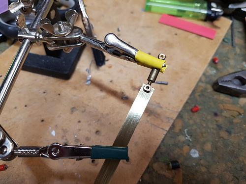

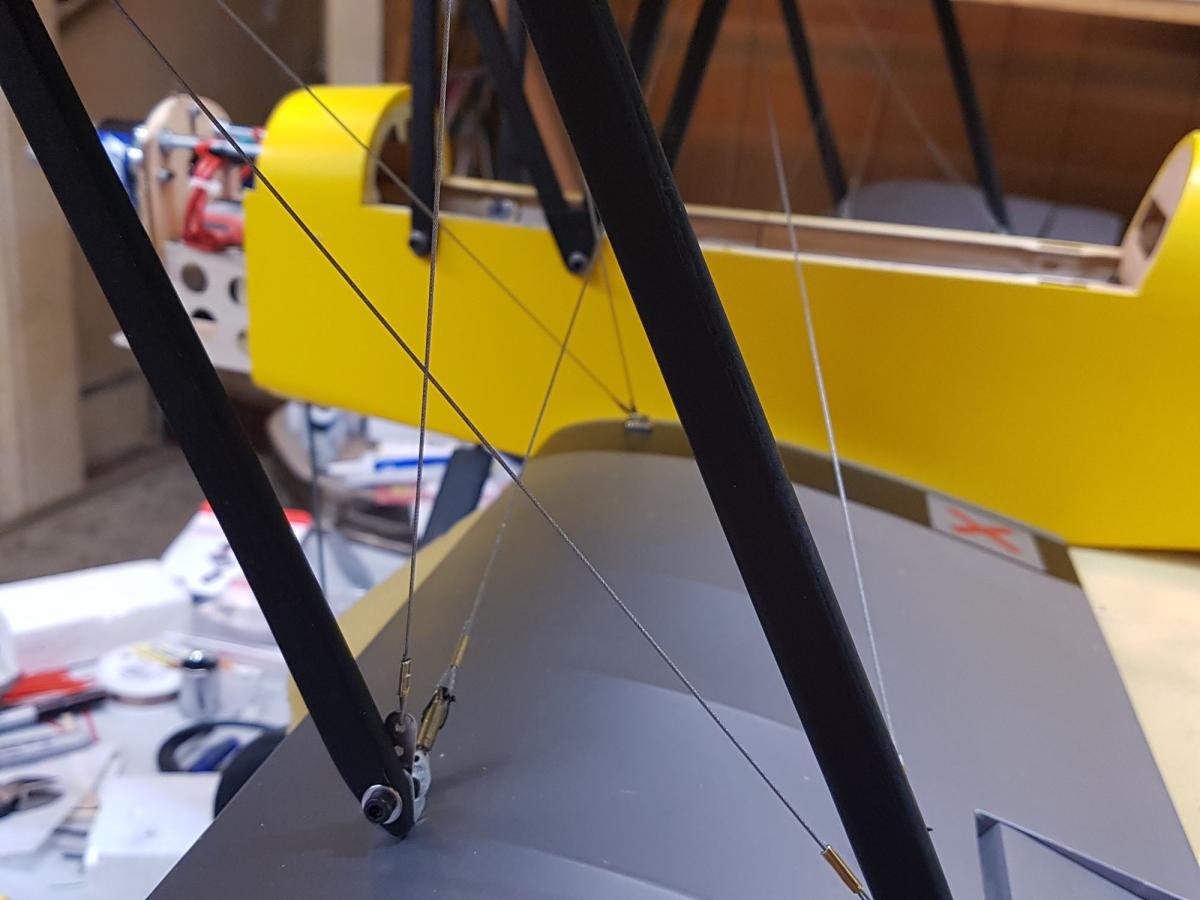

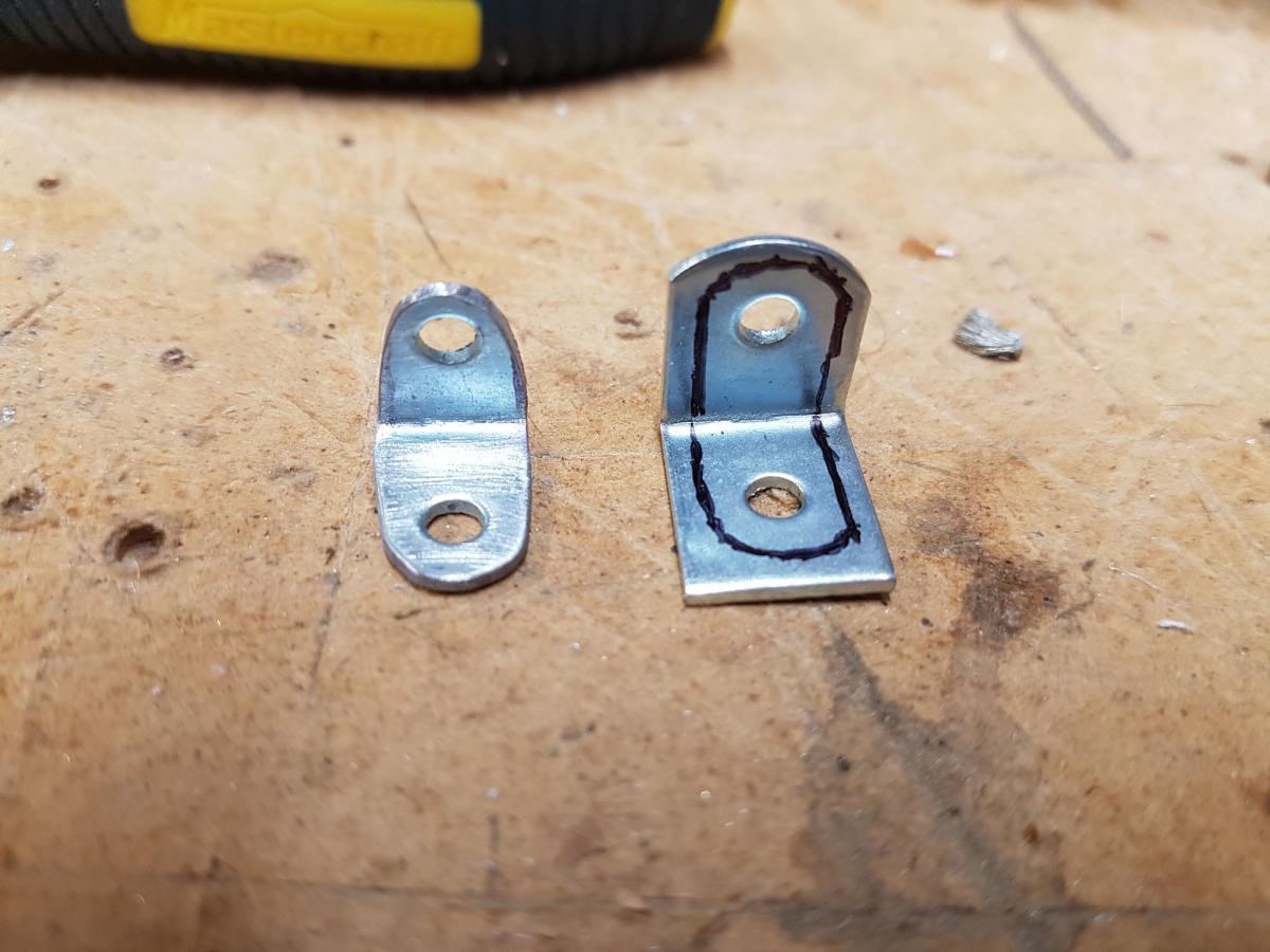

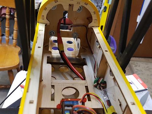

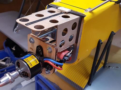

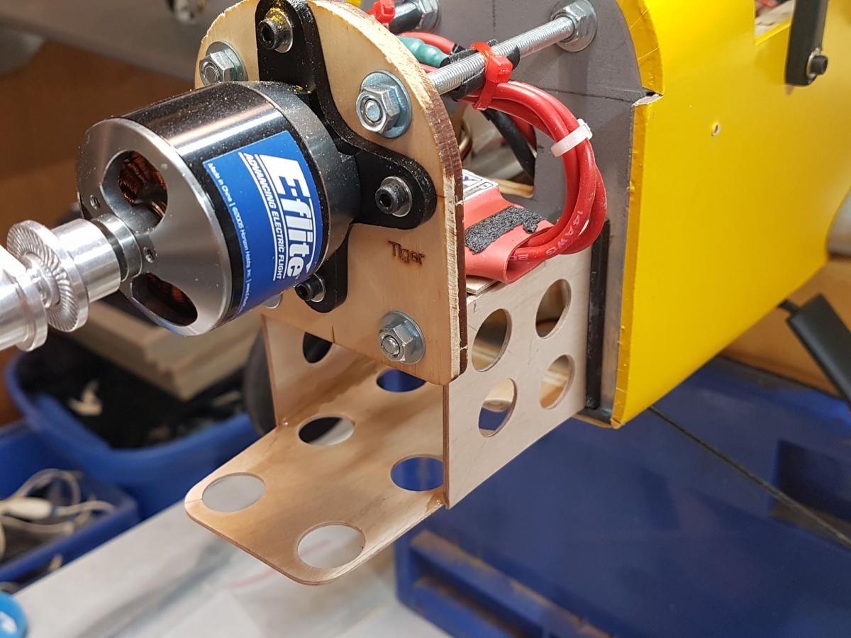

                I'm getting towards the end of putting together my Cambridge version and hope to maiden next weekend. The rigging was modified some to allow the use of turnbuckles I ordered from I don't know where many years ago- it's nice to be able to adjust the tension on each wire separately. I ground down the oversize L brackets and also cut down the wing struts and center braces to a size I thought looked better. I stole a roll of beading wire from my wife's stash and used that instead of the supplied stuff- the .76mm, 49 strand (really!) beading wire is very flexible and much easier to work with.
                The battery box modification has allowed the plane to balance properly (barely) with a 5600 4s (564g) all the way forward. I've yet to decide how to secure the battery as so little is left in the fuselage the usual velcro straps would be hard to manipulate. I'm leaning towards a sliding piece of wood and thumbscrew in the firewall to push down on the battery but not sure- any recommendations are welcome.

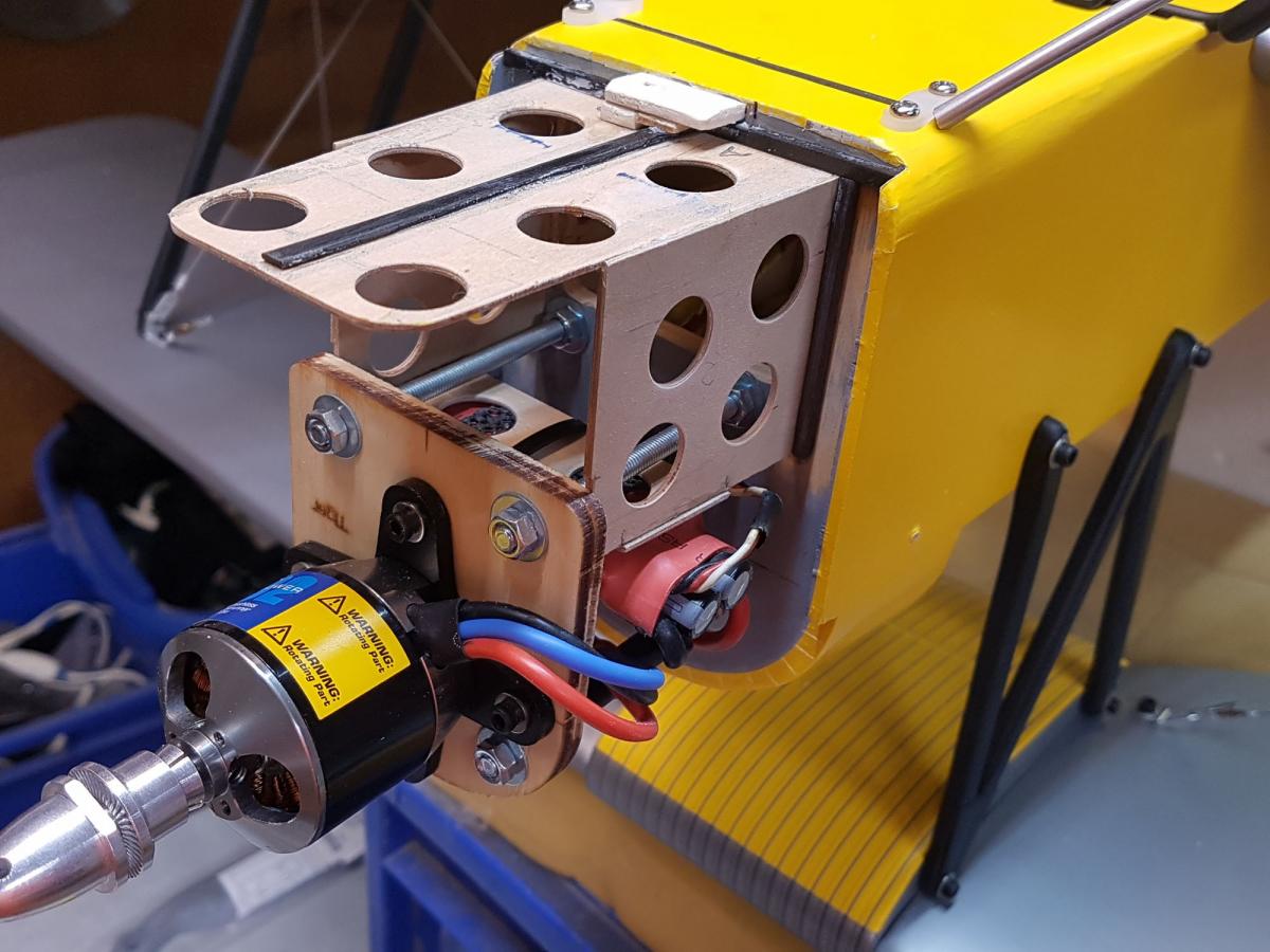

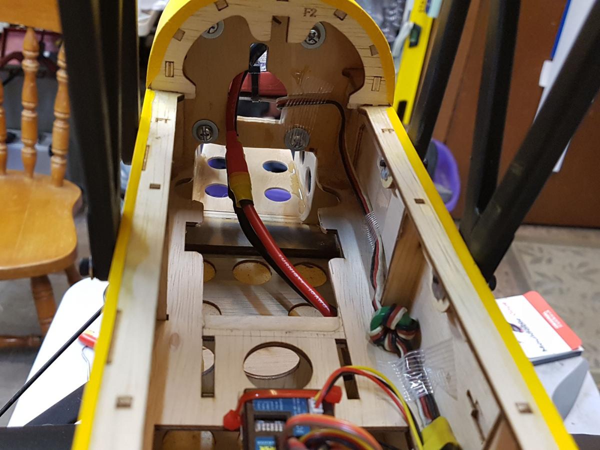

                        Got my Tiger Moth completed! I did go with the recommended setup and hit the CG issue, but I nailed it.
                        I am using the 5000mAh Admiral which is recommended, so all I did was cut the middle of the nose wall to fit the pack perfectly and added a shelf on the motor mount along with a shelf in the hatch. For the shelf in the hatch, I used 6 4-inch pieces of paint sticks glued together and it fits like a glove.
                        I may need a tad bit of weight, but I am right there at the 112mm CG mark.

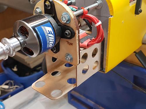

                                        Here are two pictures of my CoG location. It is actually closer to 143 mm, given the offset of the measuring scale.
                                        My son held a straightedge along the leading edge of the fuel tank so I could measure the point on the upper wing better.
                                        My plane flys well using this as the balance point. It flys inverted as well with no issues.
