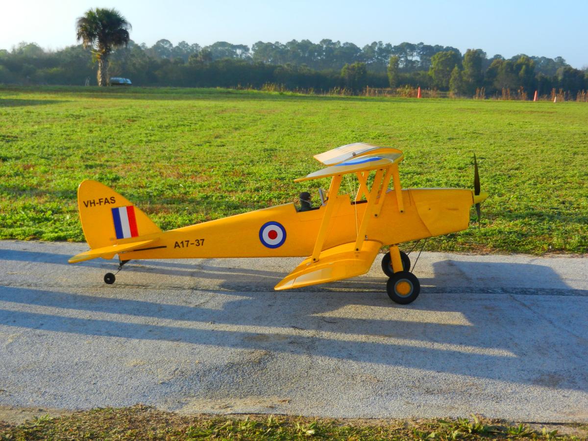

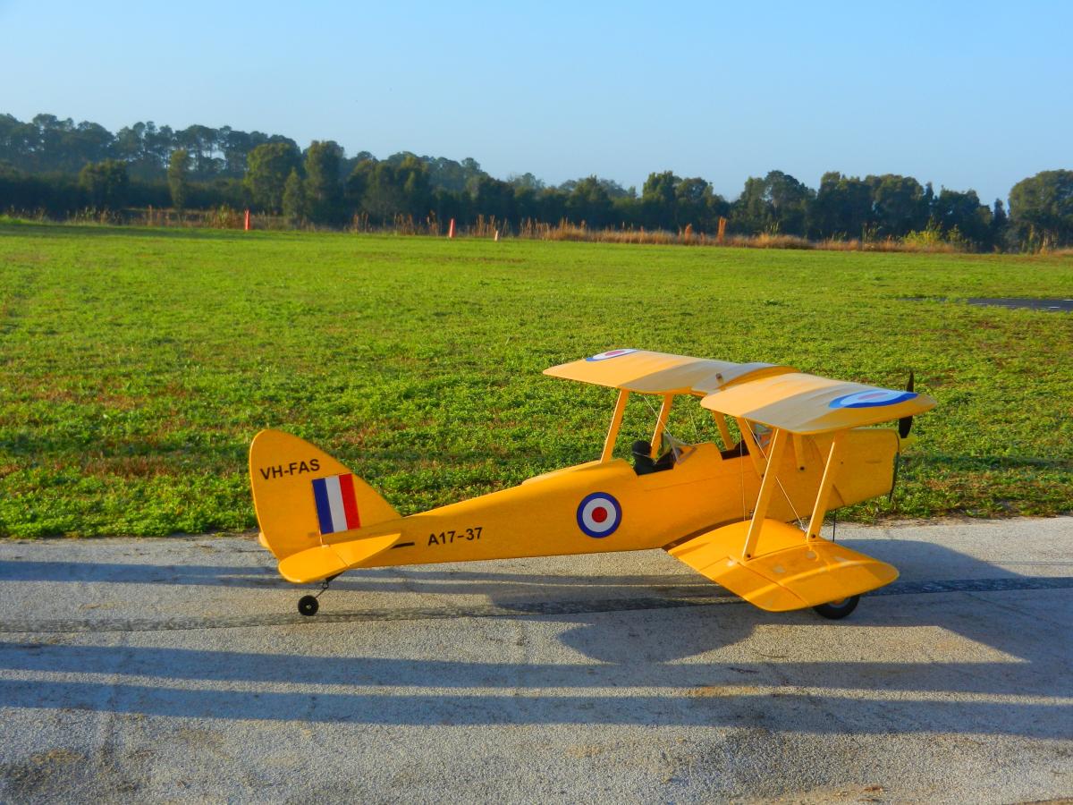

  • Still pictures of Stan's NEXA 1400mm Tiger Moth!

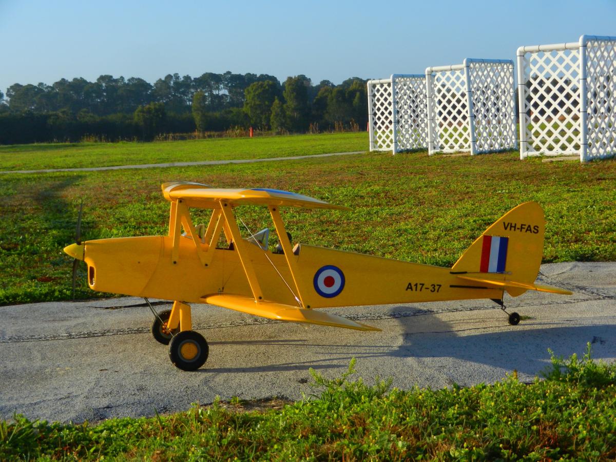

        • Finally got my yellow Moth into the air for the first time. What a lovely, well behaved airplane! Flies scale real well. Looks super on the low passes. I love it! I'm using electric. Not as cool sounding, but a lot less mess. 😉

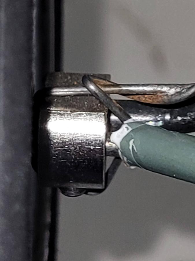

                                  • I have to remove the wings to transport my TM to the flying field. To reduce assembly/disassembly time, I made the following modifications. (I don't use the wire rigging.) The wing pins are made from 0.25" dia aluminum rod, 1.5" long and threaded (used a threading die) on one end. The pins are common box nails cut to length, soldered to the L brackets. Standard wheel collars. The clamp blocks are hardwood, tapped using 1/4-20. After cutting, flood the threads with CA. After it sets up, chase the threads again. Epoxy to fuse sides. Uses nylon 1/4-20 screws. Have been using for 2 months. Works well.

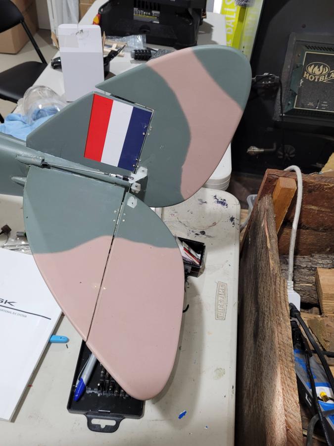

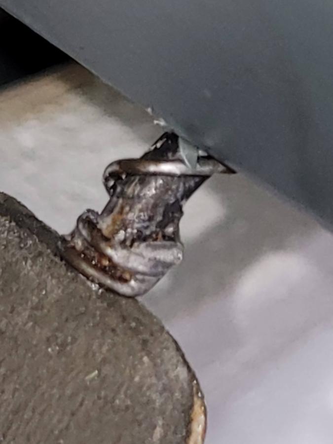

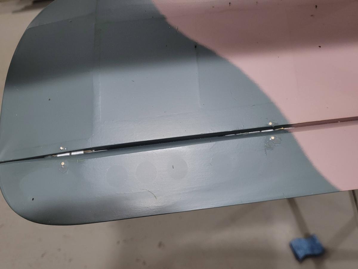

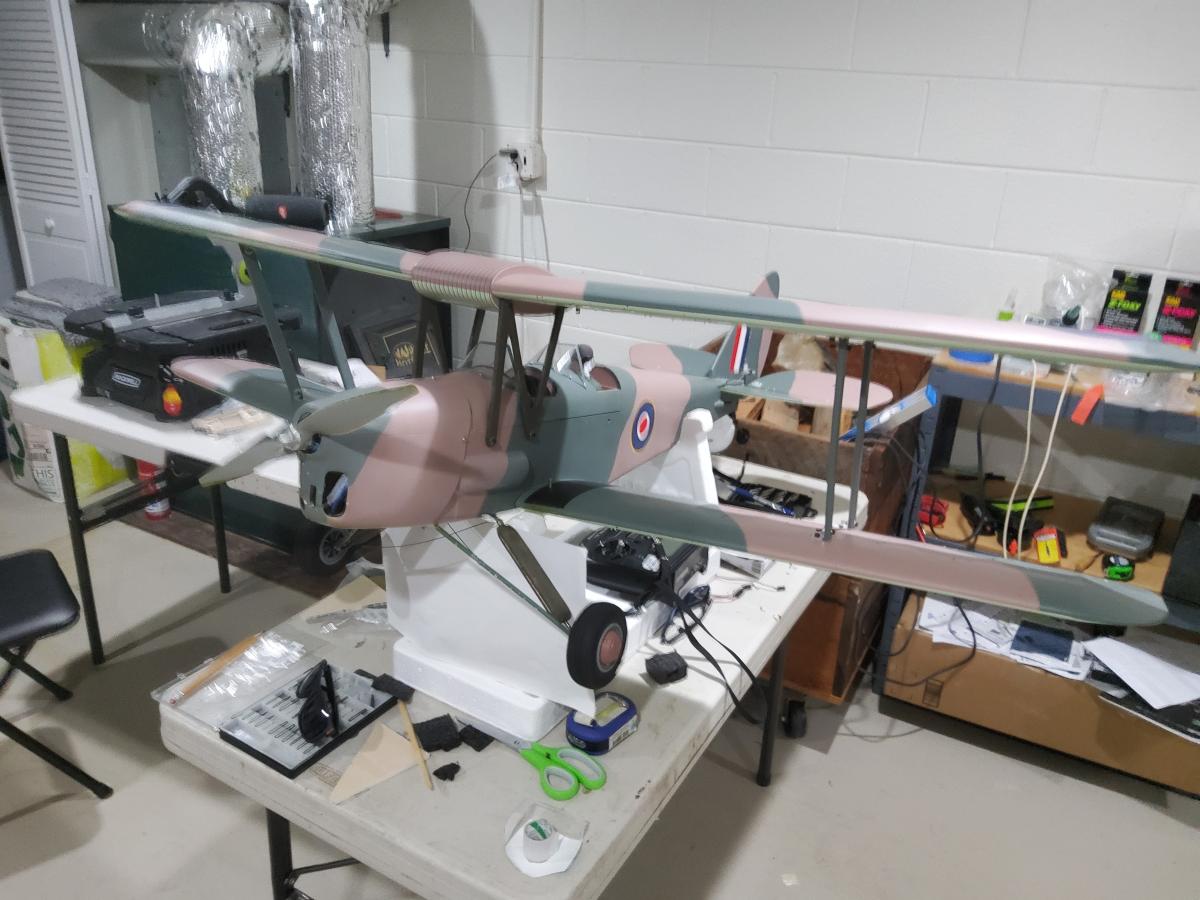

                                        • Looking for a little insight. I bought the Nexa DH.82 Tiger Moth British Camo 1400mm (55") Wingspan - ARF and fitted it with a RimFire 32, 60A ESC, 4S-4000 lipo. The plane is so tail heavy that even with the firewall cut to allow the 4S-4000 all the way to the front of the cowl, replacing the small standoffs with 1/4-20 screws, a 4 ounce brass prop hub, I still need about 6 to 8 ounces of lead behind the engine before it balances at the recommended CG. This ends up making the 6.5 pound plane closer to 8+ pounds. At that weight, how will this thing fly?
                                          Originally posted by fredz99 View Post
                                          If you don't read the blog, you're ambushed. I wouldn't recommend this kit.
                                          I just did, and yeah, I feel like I was ambushed. This plane needs extensive rework. I'll probably strip the covering off and try lightening the tail section. They must have started using not so light, light ply in their construction and failed to care about redesigning for this flaw.
