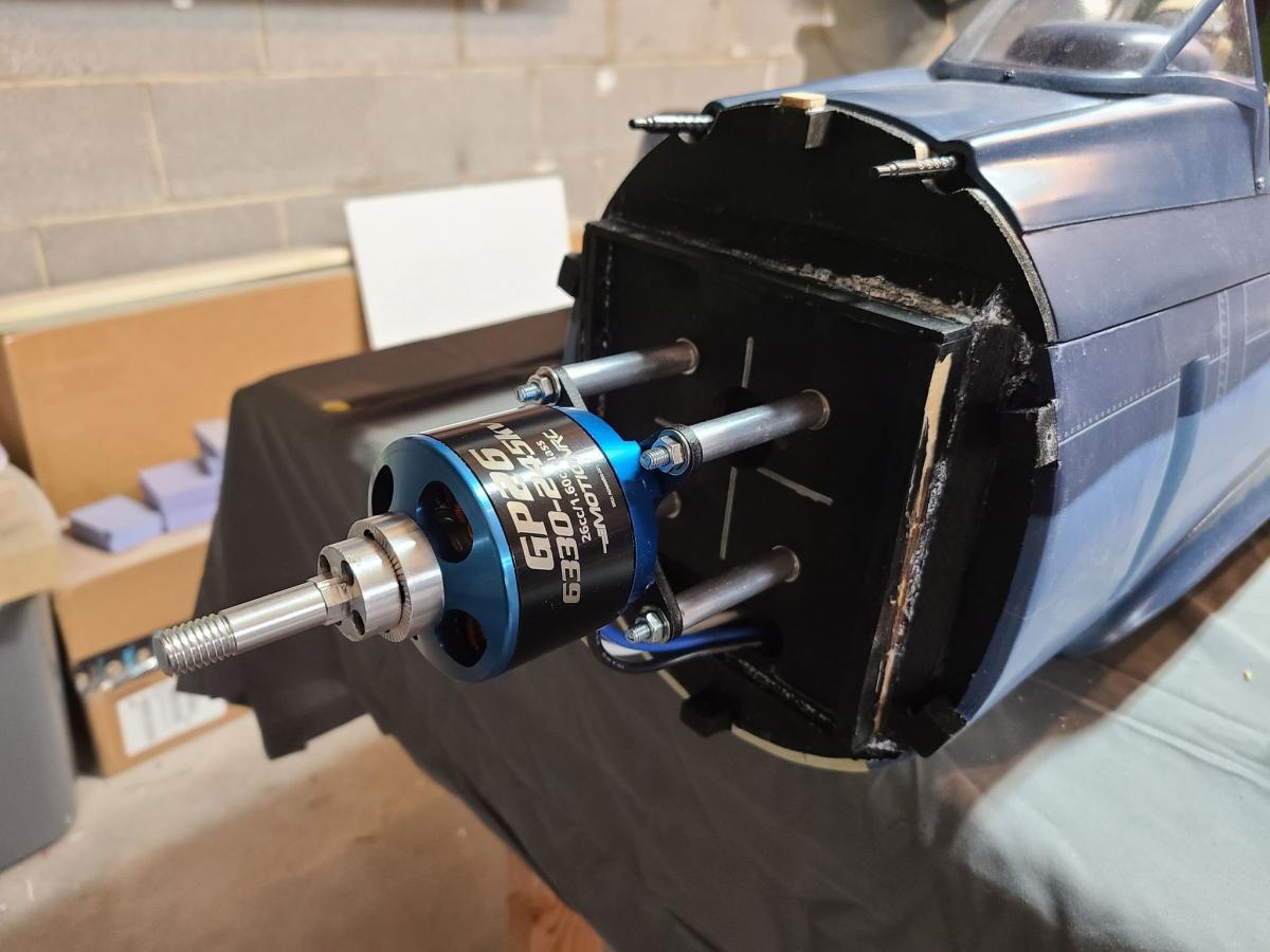

                            Great plane and great video. I am a novice but I am currently building this model for my brother who has ALS so it's a challenge on several fronts. I have had a couple of questions and MotionRC has been very helpful and suggested that I join this group. For this post I just have a question for RCjetdude regarding your build. I have attached a photo of your prop shaft adaptor. I believe that you made the change from the stock shaft that comes with the Admiral GB26 so that you could use the 3 blade prop from the Corsair. Do you mind sharing the part numbers for this modification including the hub and three bladed prop? Thanks in advance.

                              First of all , welcome to HobbySquawk. You are correct. I modified the prop shaft that came with the GB26 motor by simply cutting the shaft off leaving about 1/8" of it. The diameter of the GB26 shaft fits perfectly in the back of the 1600mm Corsair prop adapter thus centering it. Then it is just a matter of drilling and tapping 4 holes to secure the Corsair prop shaft with M3 x 10 socket head cap screws. The parts I used were FLW3040910, P418120 and MO1505521. I weighed each blade and made them all weigh the same then balanced the prop. My aluminum standoffs ended up being 55mm long but that is with the extra 10mm thick base of the Corsair prop adapter.
