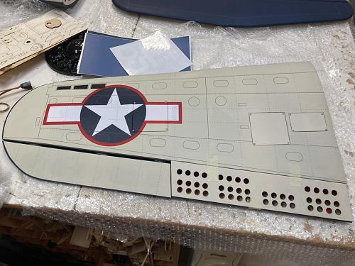

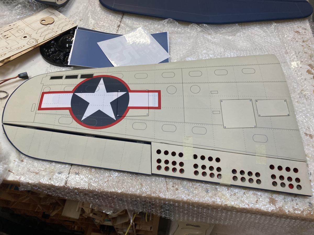

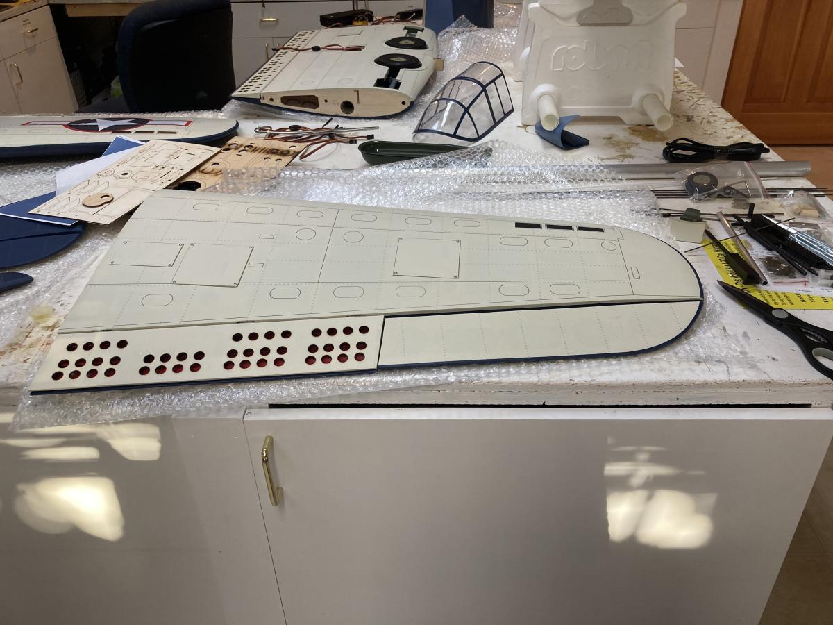

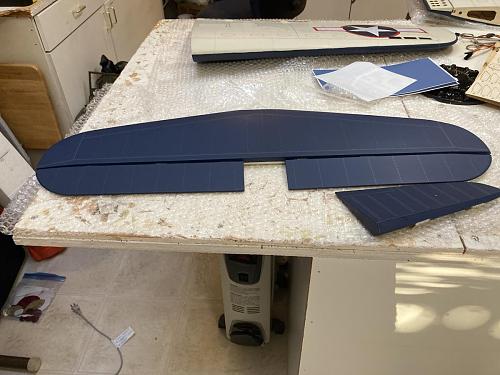

                    Ok finally made enough room to open up the box and set out all the contents. No obvious damage to the kit and no big surprises. Looks really good for this price. Canopy could fit fuselage better and it would’ve been nice to have the canopy parts sized for operable conversion. Wondering about a source for aluminum standoffs for electric motor.

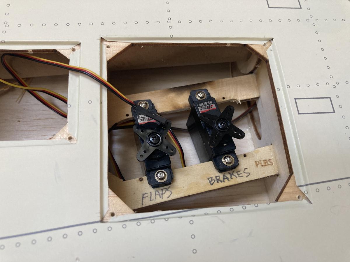

                          #52
ID:	326541Click image for larger version
ID:	326540Click image for larger version

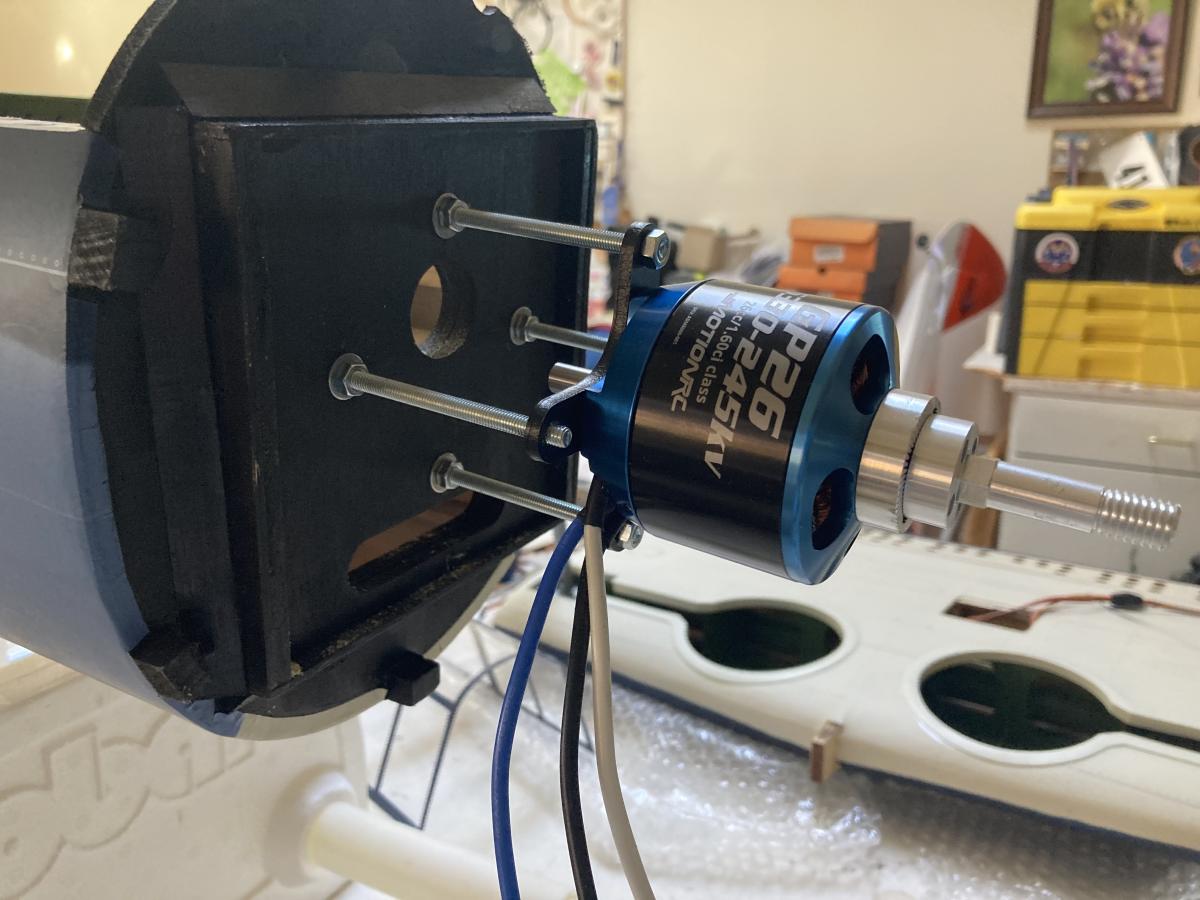

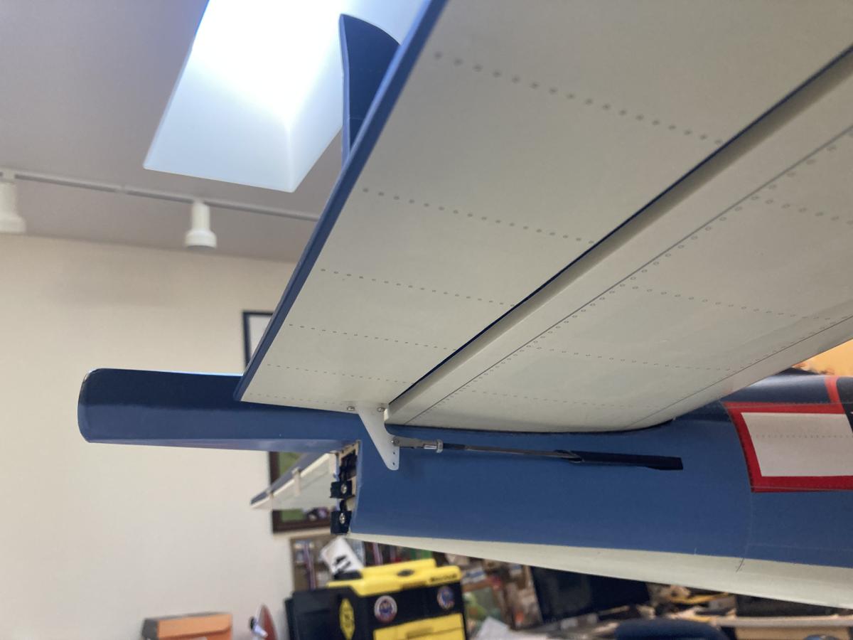

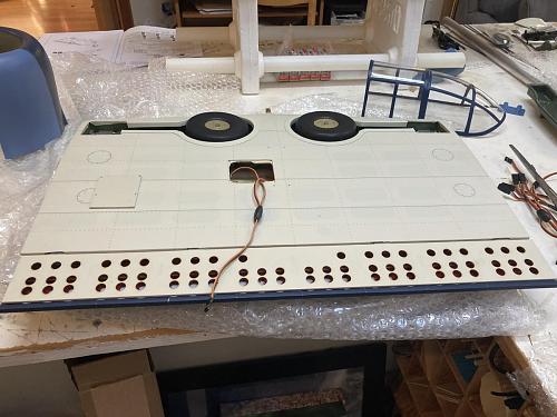

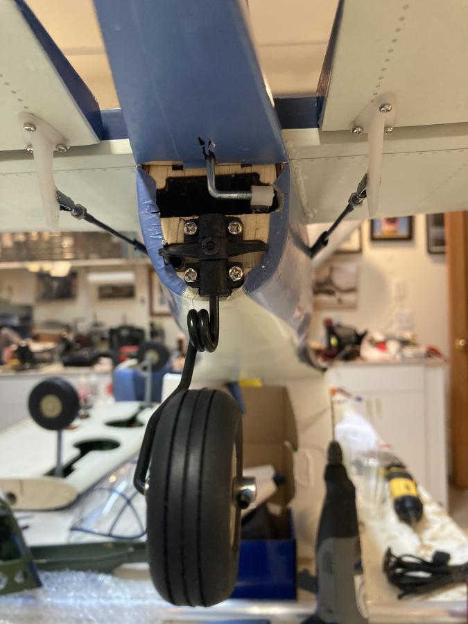

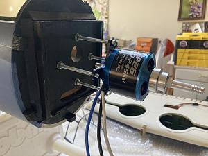

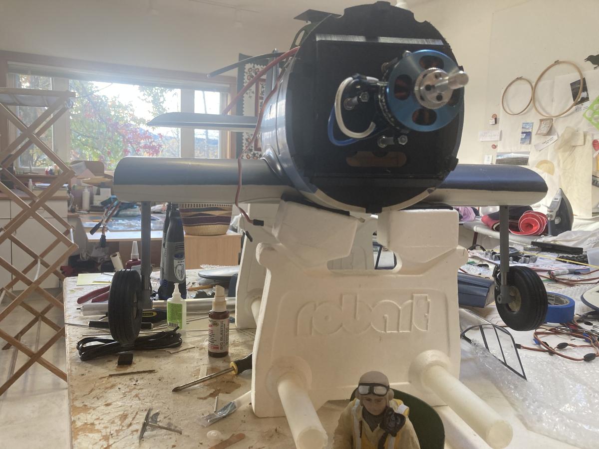

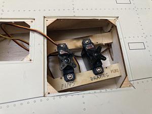

ID:	326539 Hey Tidroplane, what did you use for standoffs for that electric motor? Also, here’s a few shots of the kit. I have removed the hatch under the wing center section and joined the power leads from the two retracts with a y harness. Next, I have to put together a temporary battery/receiver/esc setup to drop the mains in order to work on them.Click image for larger version

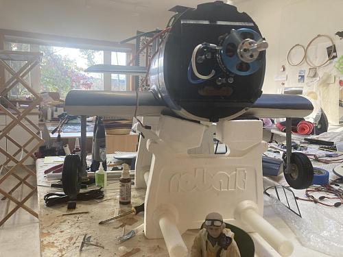

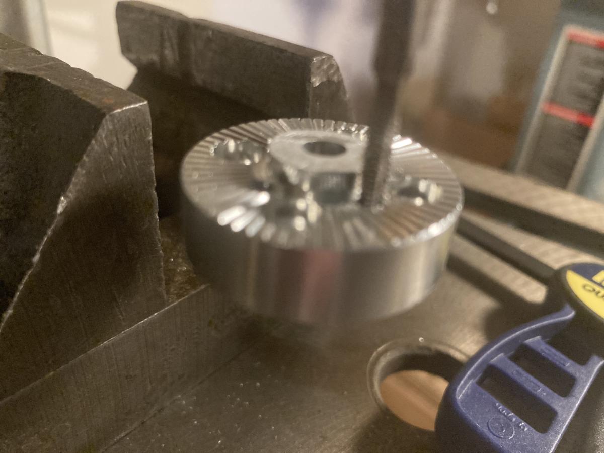

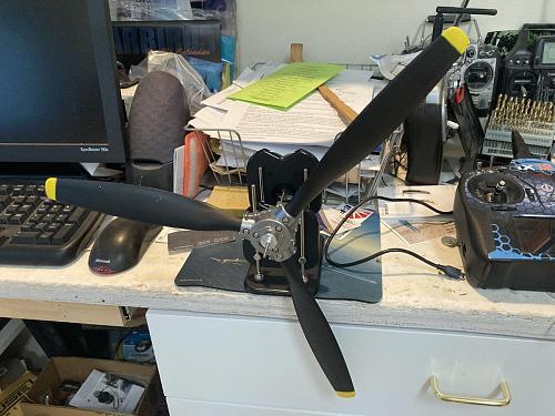

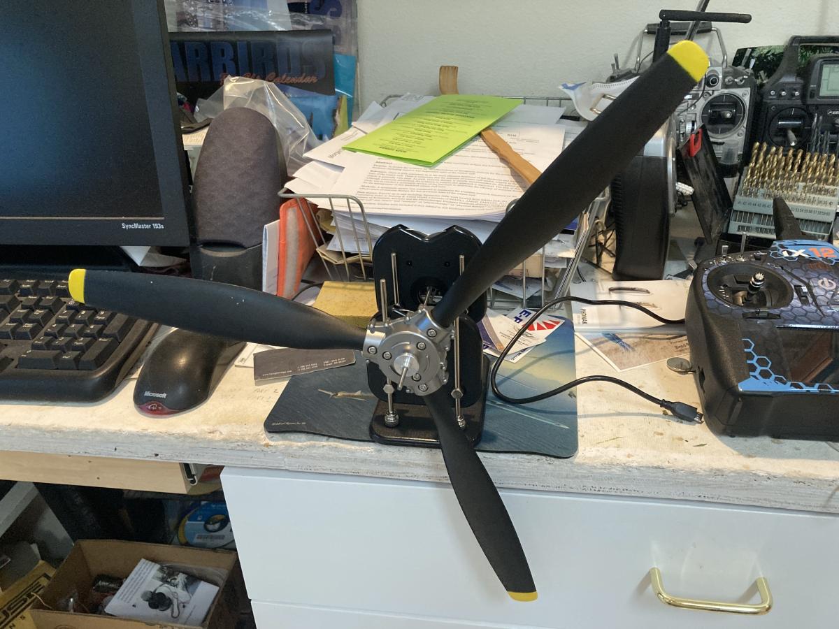

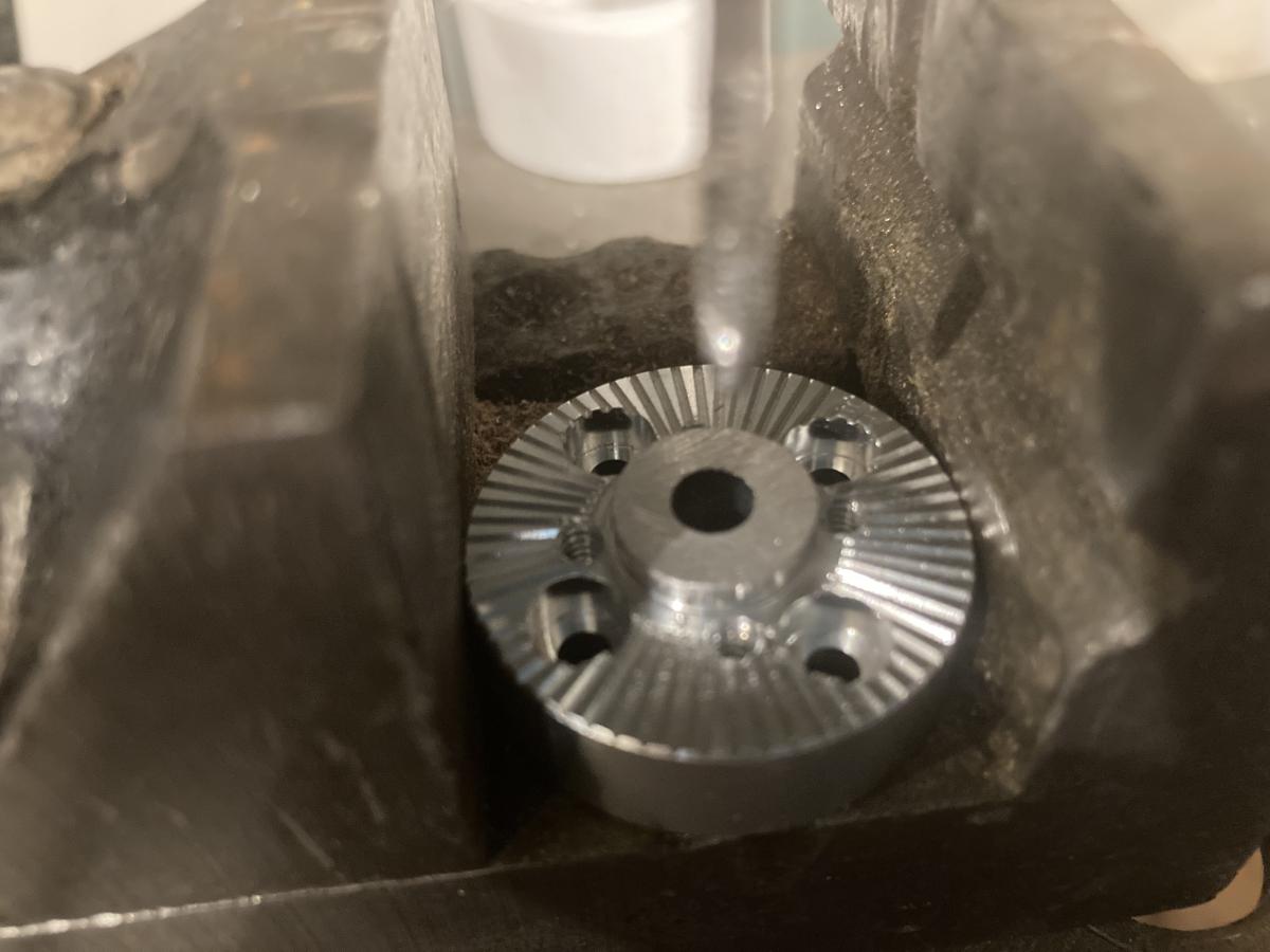

ID:	326915 Ok, got the cutting,drilling ,and tapping done for attaching the Corsair prop shaft to connect to the supplied prop shaft that came with the electric motor. The credit here goes to rcjetdude for coming up with this idea. Next will be the standoffs.

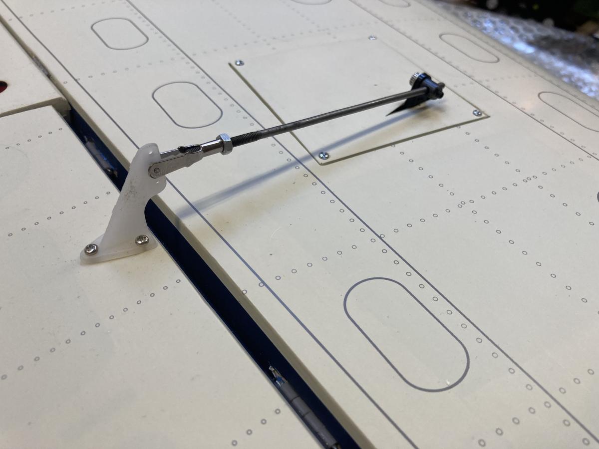

                                #55

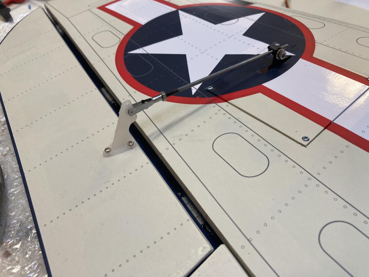

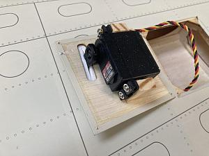

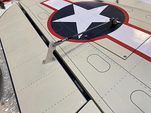

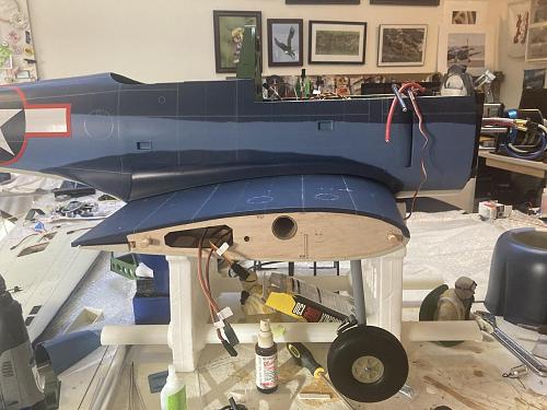

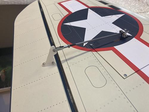

                                :star_struck:Okay making progress. All servos and hinges installed in outer wing panels for flaps and ailerons. No linkage yet though. Standoff bolts in place and length established for aluminum standoff tubes. Rcjetdude was right on. 55mm using the Corsair prop. Horizontal stabilizer glued in place as well. Aros has a friend who is using files from rcjetdude to make me a more detailed dummy radial engine for this beast. I have a receiver, esc, and batteries coming soon. Shipping times have seriously slowed down lately.
                                • downwindleg
                                  • 1279
                                  • Friday Harbor, Washington

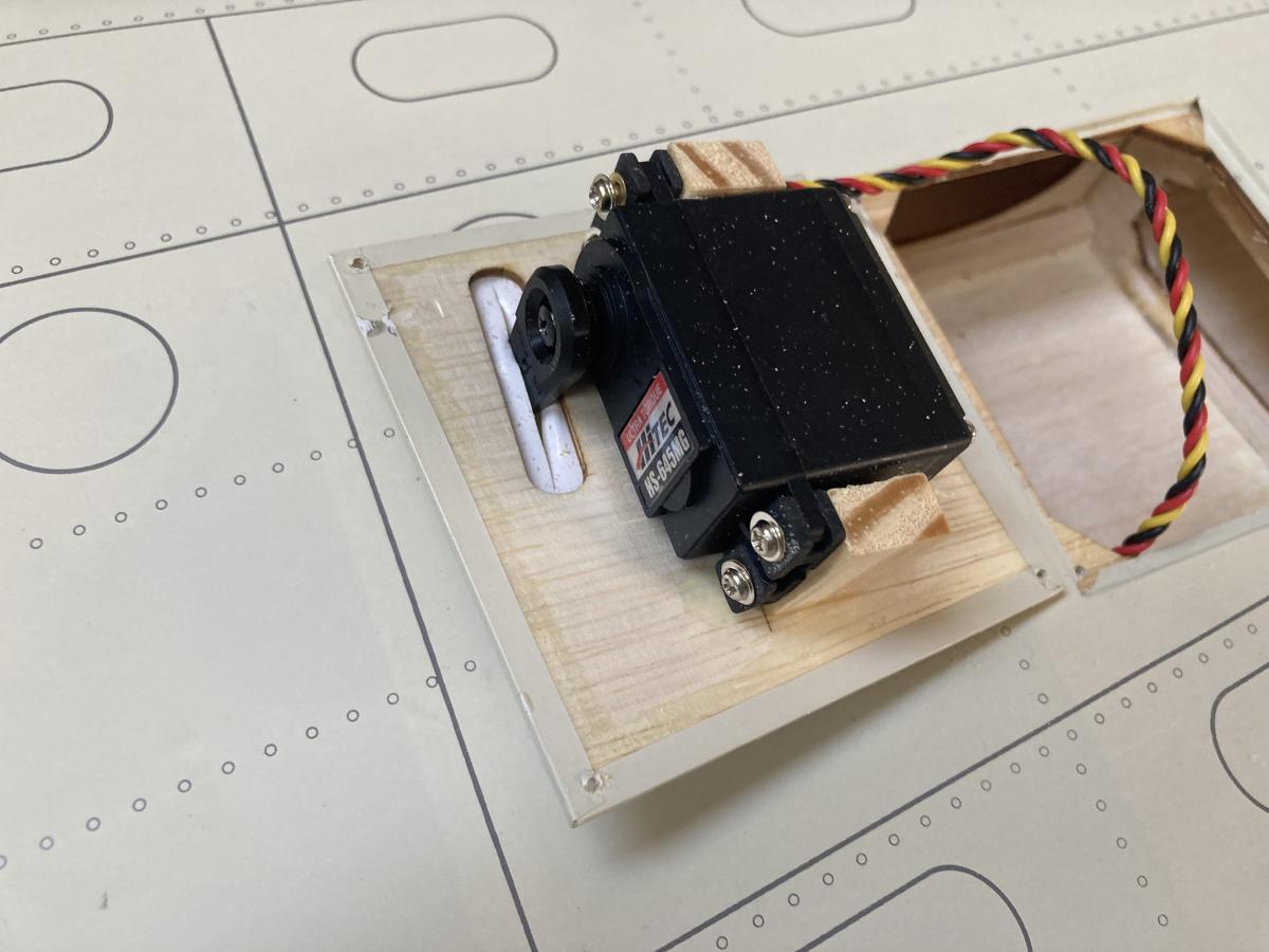

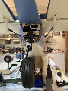

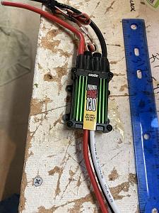

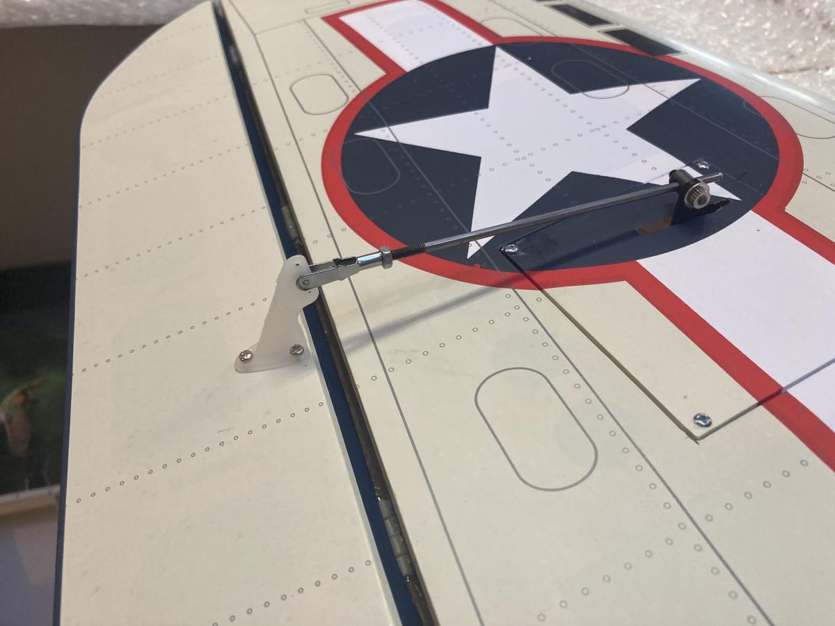

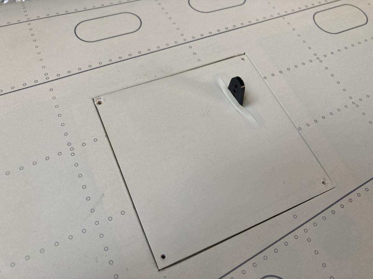

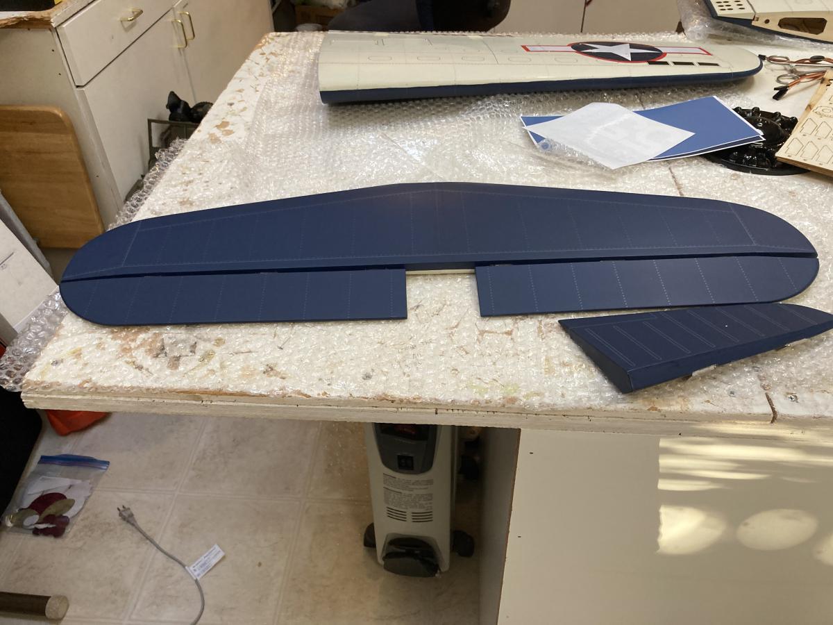

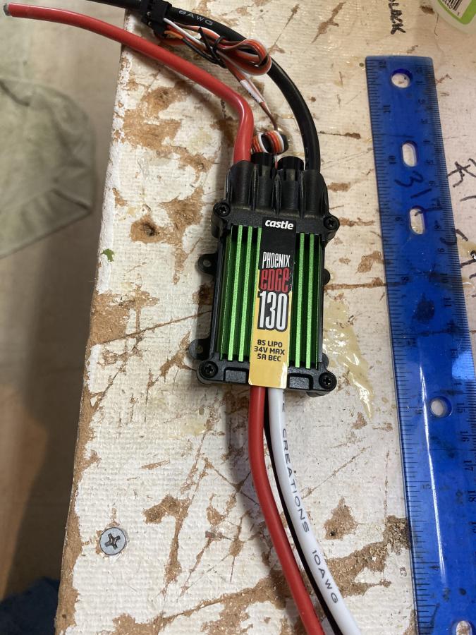

ID:	327568 Ok more progress. Got the esc today. Played it safe and went to 130 amps. Finished installing elevator hinges and linkage and installed control horns and connected them to the pushrods. Got linkage in for ailerons.
                                  • downwindleg
                                    • 1279

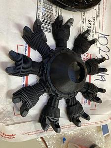

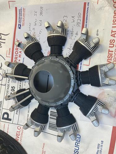

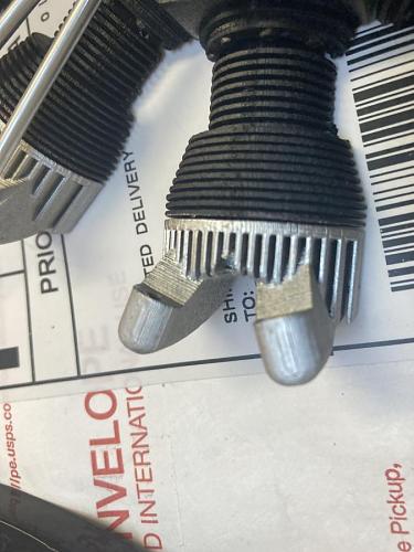

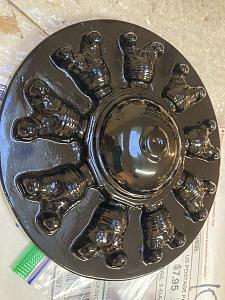

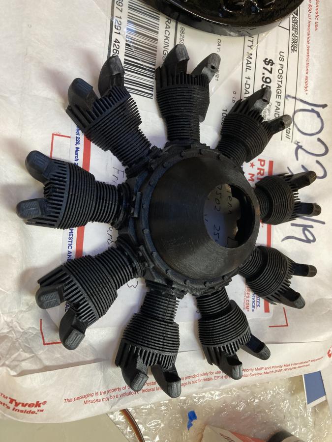

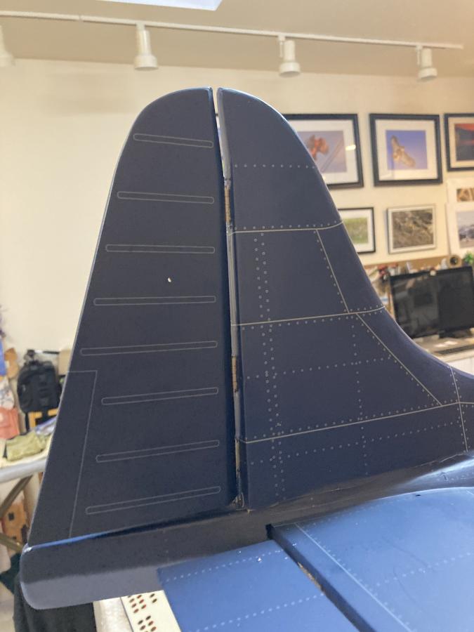

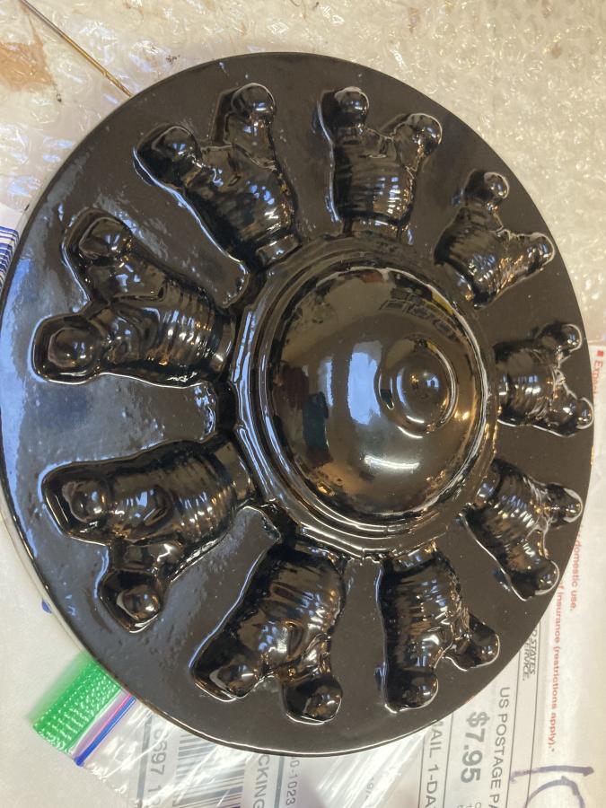

ID:	327734 Okay, here’s the dummy radial supplied in the kit and also, the dummy radial made by a friend from files supplied by rcjetdude. Also completed the rudder and tail wheel installation and linkage.
                                    • downwindleg
                                      • 1279

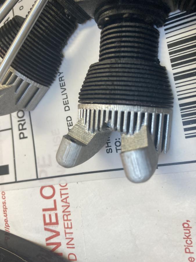

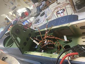

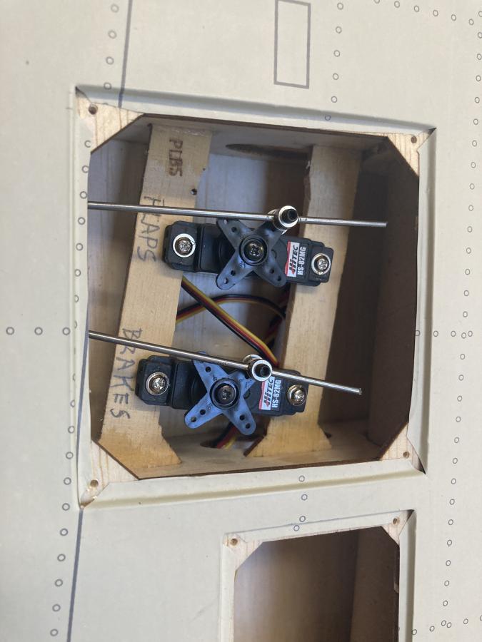

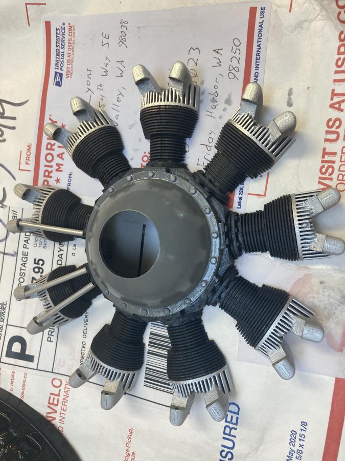

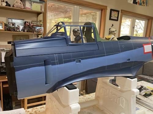

ID:	328763 Ok latest update. I have all servos installed and linkage connected with the exception of the center wing section. Making progress on the dummy radial with cylinder heads and crankcase painted. I have a new and improved ignition ring on the way from my friend Glenn and the three blade Corsair prop is finally balanced.

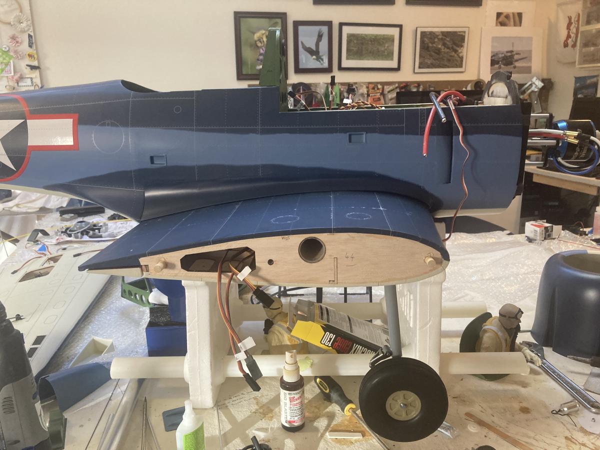

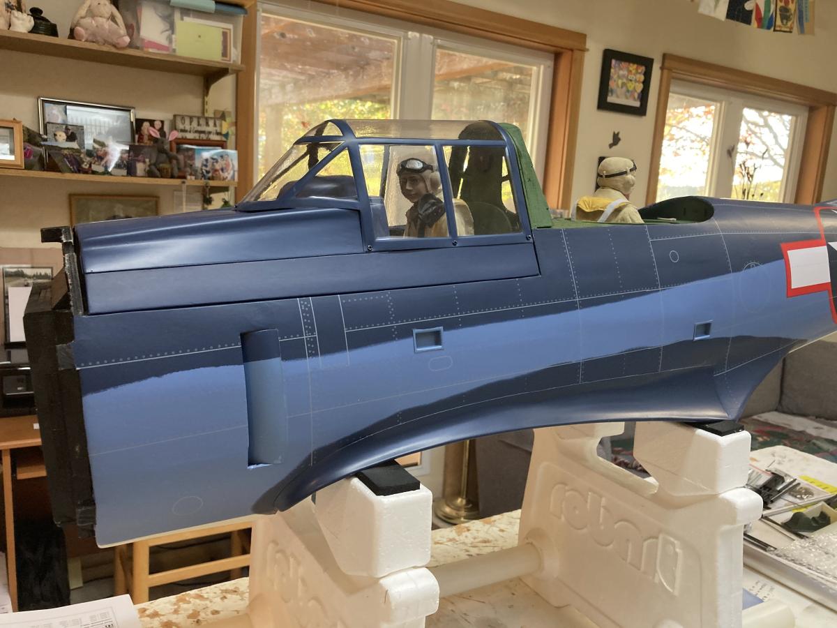

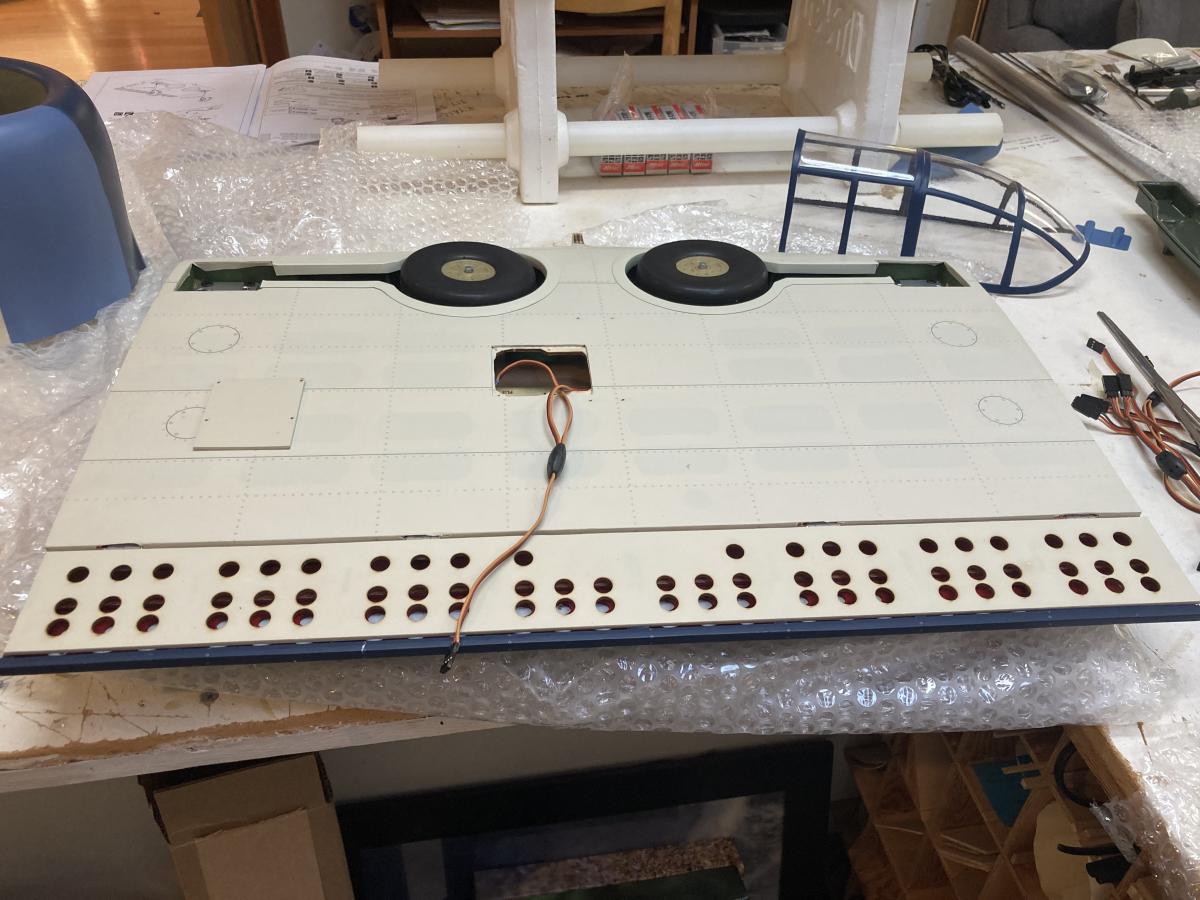

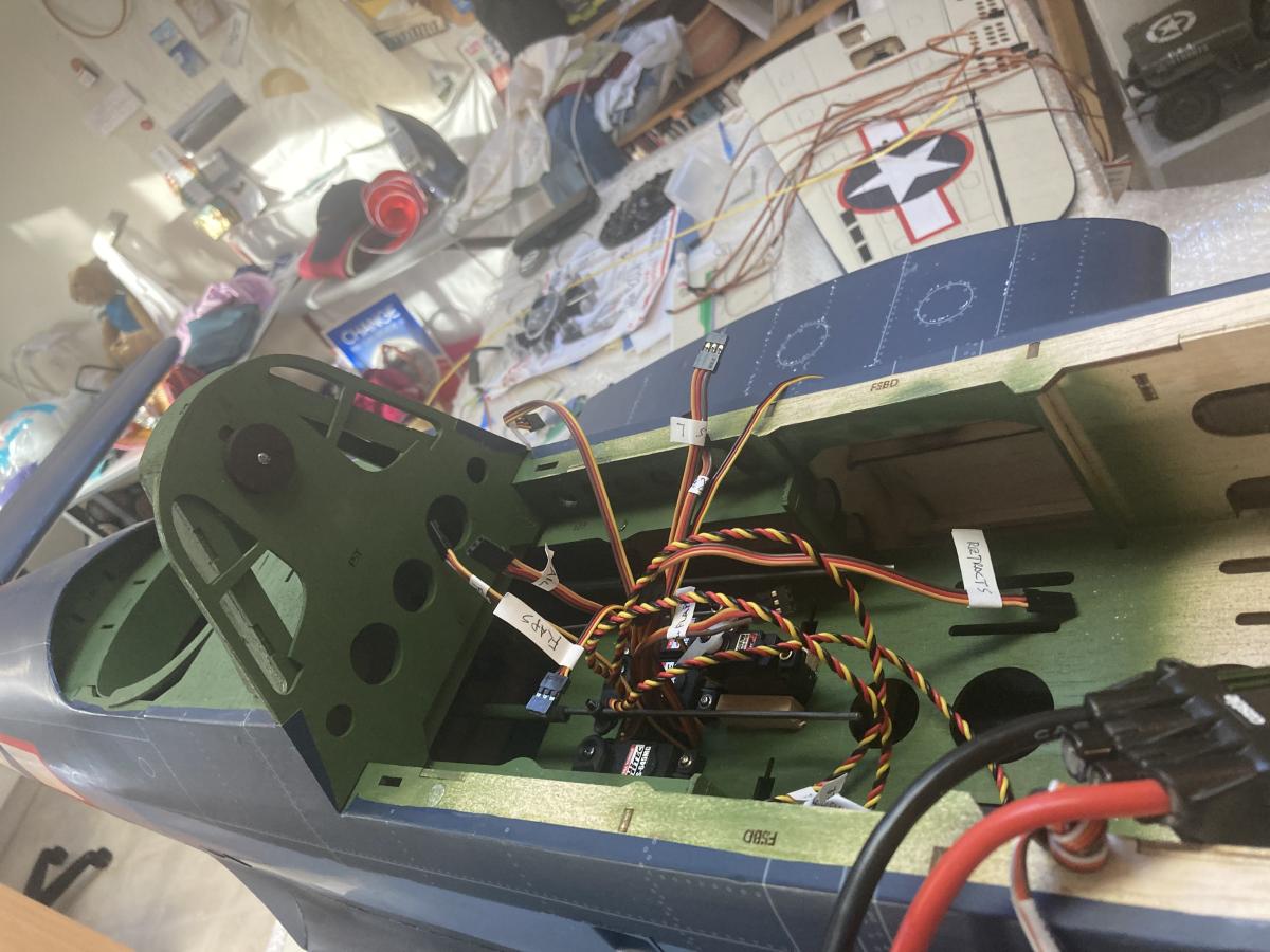

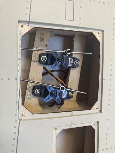

ID:	329059 Woohoo!! Finally joined the wing center section to the fuselage. Had to bring labeled servo lead extensions up through the top of the center section and feed them into fuse for connecting to receiver later. The other end of most leads terminate at wing joint for connecting to flaps, dive brakes, and ailerons ​​​. Wing fit looks good along fillets. No instructions on this but there are two holes in the bottom of the center section that are exposed by cutting out the covering that allow for the two nylon wing bolts to screw into the fuse. I cut it with a star shape so the covering could fold in around the holes. Click image for larger version
