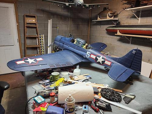

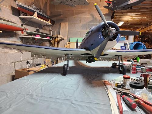

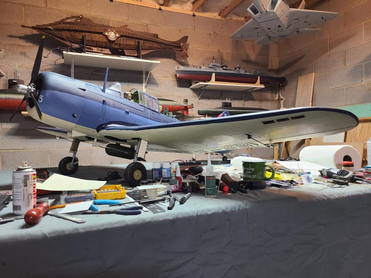

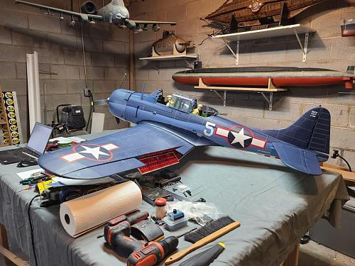

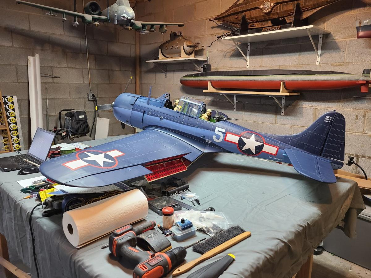

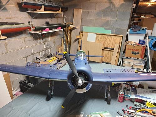

      I am almost done with my Dauntless. A few more details to paint, some servo extensions and check the CG. After that it will be a matter of programming the radio. Later I will add a Shockwave 3 sound system. It is a big bird! The wing fit perfectly. Aside from a few minor things that I had to "re-engineer", it went together well. No complaints.

            Looks like you shortened the gear doors! Is that more scale? What did you use for the exhausts through the cowl? Thanks
              #26

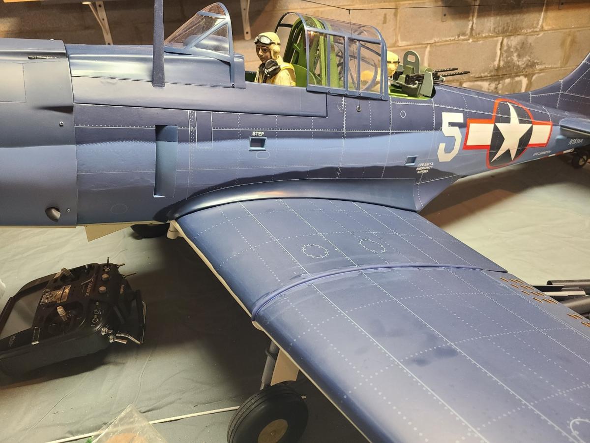

              I did shorten the gear doors because as they have you mount them the wheels would contact them under full compression of the struts. For now they will do. I may change them later to be more proper. Longer and hinged to the wing. As for the exhausts I designed and 3D printed them with a flange to glue to the inside of the cowl. Simple. Nothing fancy. The flaps/dive brakes really stand out with all those holes and red interiors.

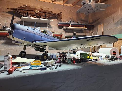

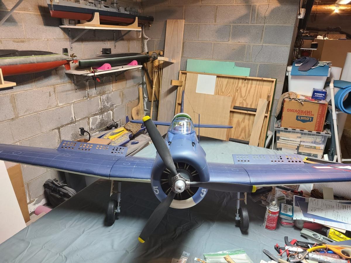

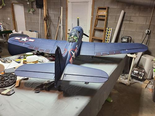

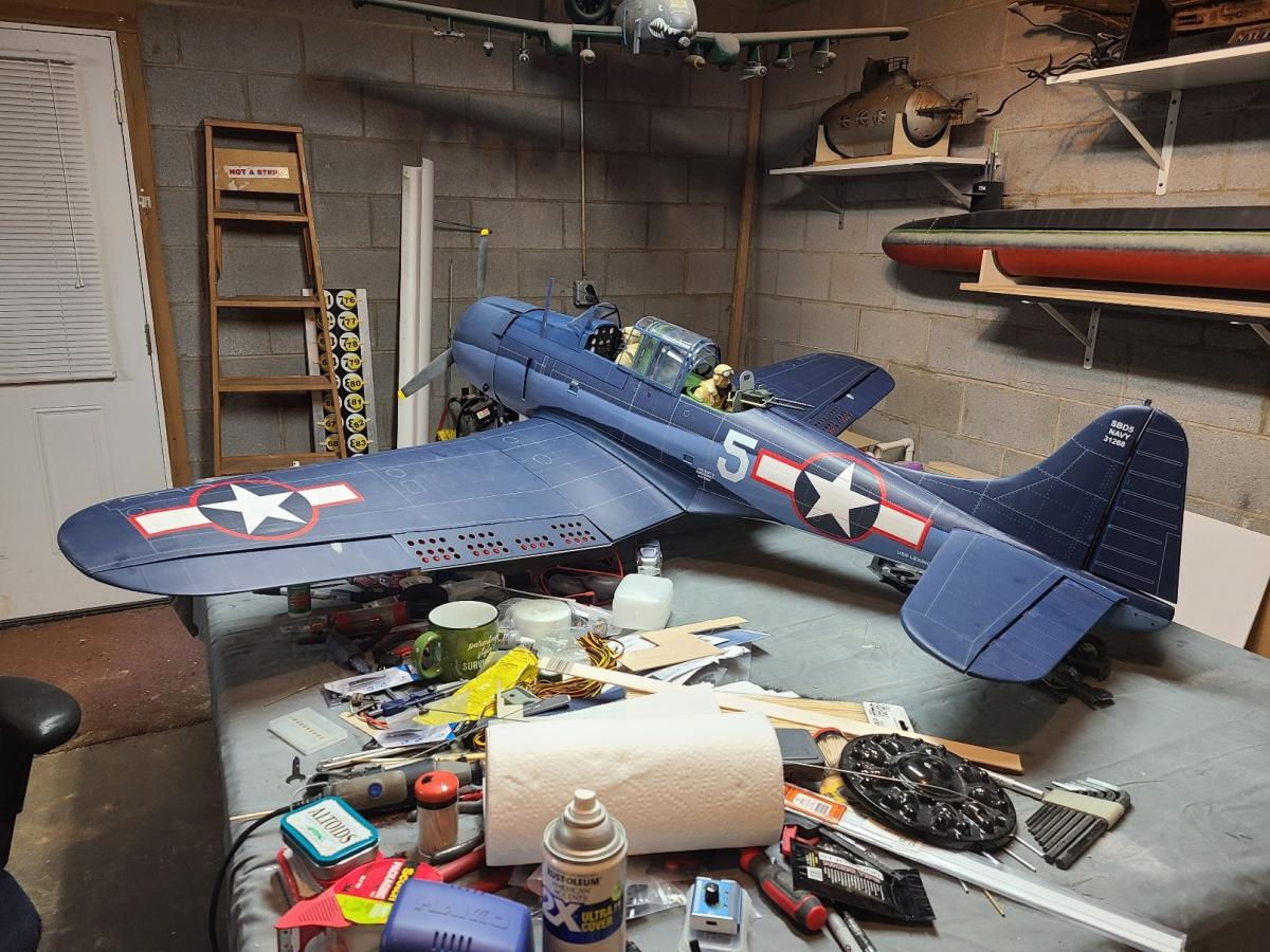

                    My Dauntless is completely ready for a maiden. It CG'd perfectly with two Admiral 4S 6000 Pros. Granted, I also have a 4" speaker in the nose, a 3D printed dummy radial engine and an 18 x 12 three blade prop on it. Came in at 17.6 lbs AUW. The edge trim that is provided in the kit and intended to be opened up and glued flat to the seams between the center wing section and outer sections was a wasted effort. At least I could not figure it out so I will resort to an alternate method.
