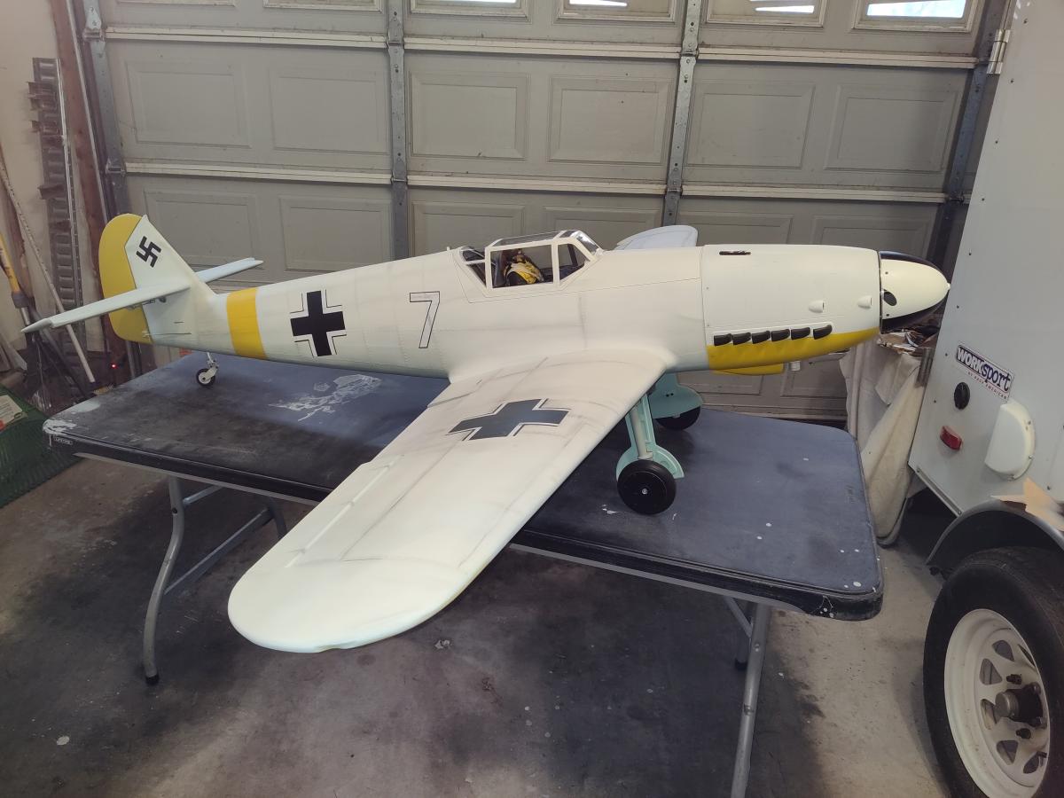

            Almost finished just waiting on some pull pull hardware and will do some weathering on the cowl and tail surfaces.
