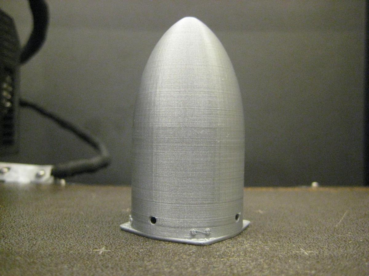

        Hi Steve: print went very well. I'll pick up a tap for it tomorrow at Ace. I like your profile of this bullet shaped prop dome, better than what we came up with over 2 years ago. After I sand and prep it, I'll probably use some Alclad alumiinum paints to paint it. Should be able to test it in the next week or so with my Ol' Cock P-47D that had the CE prop on it. Will keep U advised!
        Thanks again!
        Cheers
        Davegee

            Hi Steve: I didn't see an interior profile yet, but I can see through the CE prop dome as I look at it from behind. I think it will be plenty strong, based on a similar profile we did 2 years ago. There shouldn't be much stress on this prop dome as all the stress is on the nut and prop hub behind it. I flew several flights with the one we came up with and it has never been an issue.
            I like the shape of your CE prop dome more than what we came up with back then. I printed two of them that I plan to test on two of my jugs. I might be able to do that tomorrow and sometime next week, weather permitting. I'll attach a pic I just took of one hand torqued to the prop shaft of "Ole Cock." The M10 150 tap you suggested worked out great.
            Cheers
            Davegee

              It's looks good to me, though I am certainly not an expert in any form on this.
              There is some small detail near the base in a couple pictures, do you think that is worth the effort?
              It appears to be a flat metal plate, a hole at each prop center, and screws that are wire locked.
              Best, Steve

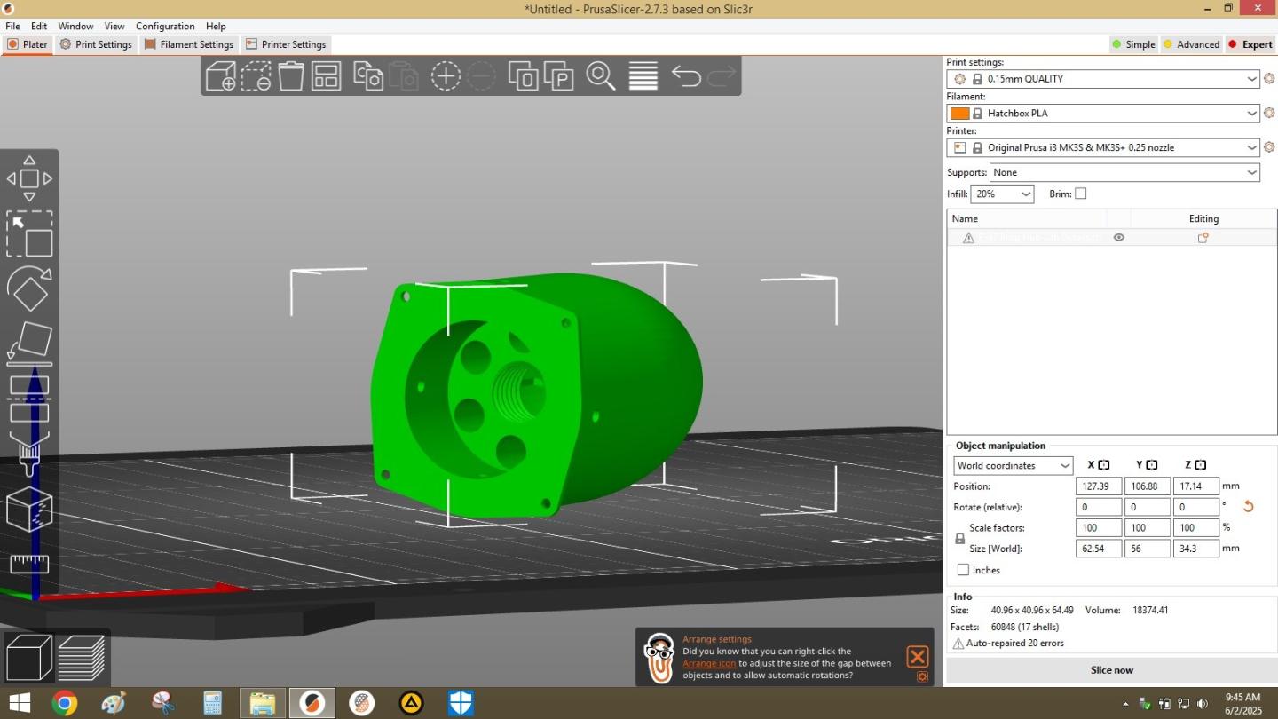

                          Dave,
                          I added some detail to the Curtis Prop Hub.
                          The thing is alignment.
                          It is totally dependent upon the M10 threaded shaft how that will line up when threaded into place.
                          Without the motor's threaded shaft, it is a wild guess.
                          In any event, here's the STL. [ATTACH]n426764[/ATTACH]
                          Best, Steve
