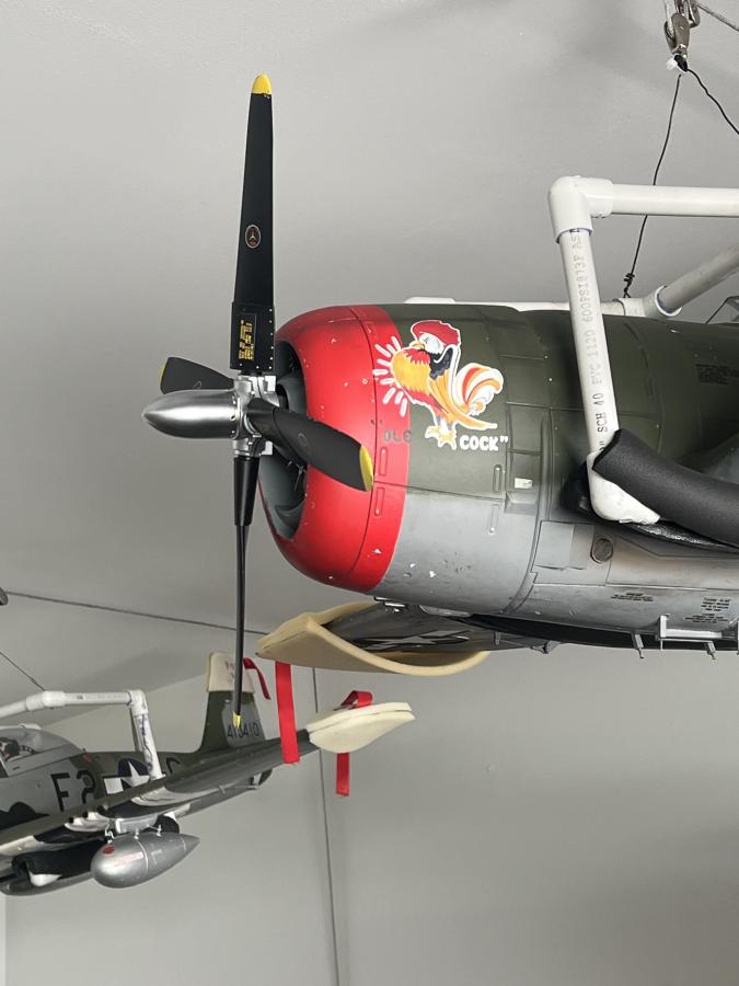

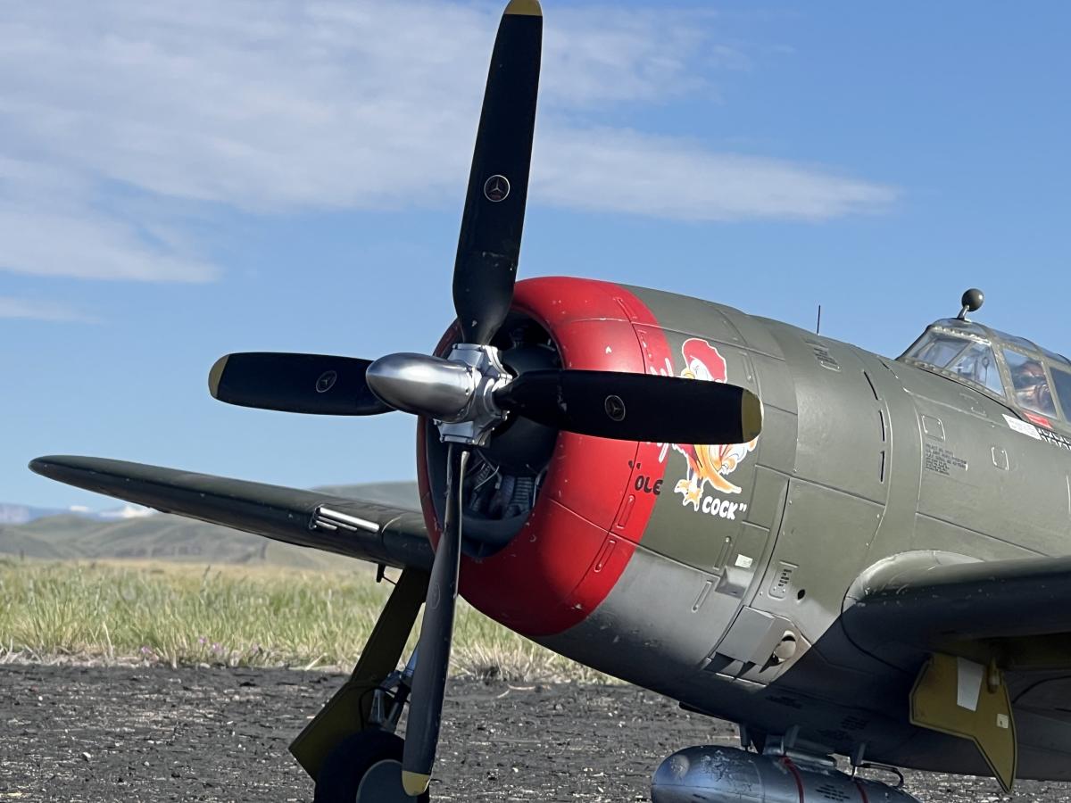

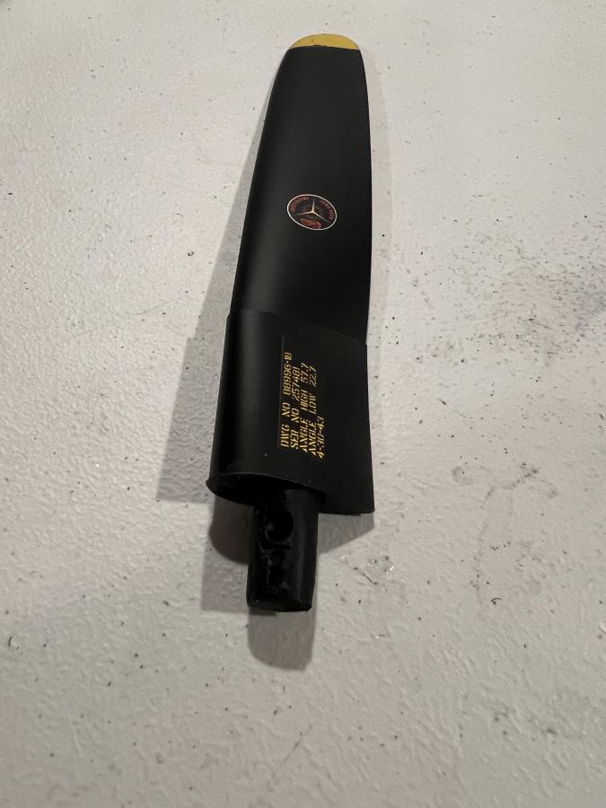

                            I just finished a new mod for my Curtiss Electric propeller that has cuffs on it. Actually, it's just a scale cuff addition to the standard FMS V3 Corsair 1700mm prop. but it should be fairly close to the real thing without making a mold for a totally new prop with the attached cuffs.
                            Anyway, a HUGE debt of thanks to Elbee for coming up with the scale 3D printed Curtiss Electric prop dome, as well as an improved 3D printed cuff design that easily slides through the prop shaft at the bottom of the prop and tacks into place for good keeping with a flexible glue like Canopy glue. I don't think there is any way these will come off in flight like my original vinyl ones I did before. Those lasted for a while, but sooner or later the stress of flight popped them off so I had to go with a new direction for scale props.
                            I should be able to flight test these on my FMS P-47 "Ole Cock" next week to confirm that they are solid and won't pop off somehow like my first generations ones did.
                            Here's a few pics. I should have better ones out at the field next week.
                            Cheers
                            Davegee

                                  Hi Craig: the size was fairly close with previous attempts I made, but these are closer to the exact size. My original vinyl ones were just pieces of black vinyl or thin plastic folded over on itself and glued at the seam where they came together. They slid on the prop ok but had to be glued onto the prop to stay on. They were open at both ends. Because of that, I think air loads in flight would run through those open areas and popped the cuffs off now and then. Nonetheless, when that happened, there was NO decrement to the flying characteristics of the airplane. They did make a fairly loud "POP!" that sounded pretty cool, though!
                                  Elbee came up wth a 3D printed cuff design that is closed off on the end closest to the prop base but there is a hole in it that allows passage of the prop shaft to go through it to then screw into the prop hub. I'm thinking that rotational forces will want to push the prop cuff out towards the end of the propeller and depart the airplane, but this prop cuff is very strong for its weight and I am fairly confident that they will withstand those pressures and remain in place on the prop . The "acid test" of course will be ground full power testing, and flight testing that I hope to do early next week. I'll report back how it goes. Elbee's design is excellent and follows the shape of the prop like a hand in glove. I made a minor change to the design to enlarge it slightly to help the cuffs slide onto the prop shafts better, but that done, it works great!

                                          I took out my P-47 "Ole Cock" for a test flight with the new designs for the prop cuffs, courtesy of Elbee. I did a high power runup on the ground first. I was used to the sound that my V1 cuffs that I have been experimenting with, sort of a vibrating sound, not too bad, but noticeable over when you don't have the cuffs on. I decided to do at least one flight anyway. I don't need full power with this big FMS V3 prop, usually about 75 percent power and it gives a very realistic takeoff and climbout to the real thing. On this first takeoff I heard a "POP!" "POP!" in pretty short order during the takeoff roll. I immediately knew that at least two of the cuffs had popped off under the strain of the spinning motor. I was used to this from previous tests and continued the flight. It was pretty normal and I brought it back in for a landing. Unfortunately, the tail wheel did not come down (even though it has been extremely reliable in the past) and I got some very minor abrasion damage to the bottom of the tail area where it had contacted the runway as it slowed down to a stop. Minor repair, doing that now.
                                          Upon examining the prop, two of the four cuffs had indeed departed the airplane (symmetrically, on opposite sides of the hub) and I found the remains of them on the runway. They had broken on each side where they contacted the leading and trailing edges of the prop. For some reason, the other two cuffs stayed on, not sure why. I used a drop or two of rubbery canopy glue on each cuff and they all seemed secure when I pushed and pulled on them several times while putting them on.
                                          I tried one more flight to see how losing two of the cuffs would affect the airplane in flight. This became a very challenging flight and with the aircraft in a clean configuration it seemed like it was Really left wing heavy out of trim. It was controllable but I brought it down after a few more laps. I'm pretty certain that losing two of those cuffs caused this unusual flight characteristic and it was a bit of a challenge to get it safely on the ground. But that I did, made a normal landing to a safe stop.
                                          What to take from this experience? I think first, I'll go back to the standard propeller configuruation using the V3 props. I never have any problems with those. Second, I can still use the beautiful Elbee Curtiss Electric prop dome that looks so great. It had nothing to do with the flight performance in a negative way at all.
                                          I am going to print up two more of the Elbee cuffs and put back on that prop to use as a static model for now. When I fly though, I'll put the non-cuffed prop on for better performance.
                                          I think the best solution would be to make a prop from a mold that has the prop cuffs altready molded into the parts, like what the E Flite 1.5m P-51D has on its props. That would probably be expensive to do, and I probably won't go that route.
                                          The FMS 1.6m P-47D razorback is still one of my favorite foamie warbirds to fly. This has been an interesting experiment, and I'm still glad I undertook doing it. The cuffs really add some realism to the propeller to make it look like the Curtiss Electric props used back then. Perhaps there is some design refinement that can be done to match why two of the four cuffs stayed on while the others didn't. Hmmm...
