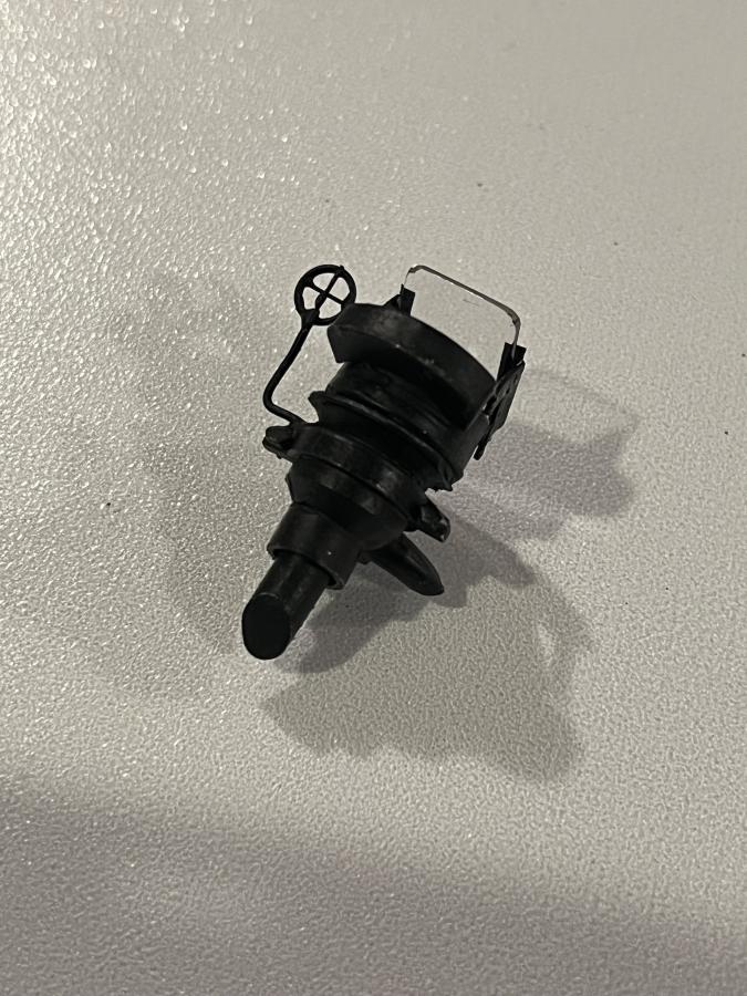

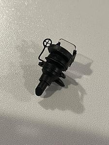

      Rex: just completed the Mk II reflector gunsight like the one used on Lucky and many other early P-47s. It should be easy to glue the two flanges on the front of it to the control panel of your plane after you have removed the gunsight that came with the model. Not a great pic but I think it will look much better and more accurate for your contest.

        Davegee,
        That looks great. All the OEM cockpit parts are just spot glued for the airplane day at our full-size airport. I'll remove everything to cut the floorboard out. Putting Cub back together so the 47 will soon see the worktable. Thank you so much for the scale items.
