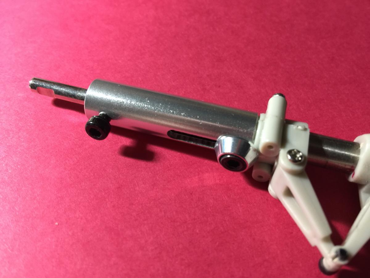

Well this just sucks. I have finished the build on my Tcat #2 and today getting around to installing the landing gear upgrades. Right off the bat the lower set screw/grub screw strips and I can't seem to do anything about it. So I have to leave the stock nose gear in place and have just now finished with the Mains with no trouble. What a bunch of ka-ka... At least I imagine having the upgrades on the Mains is a good deal. And I don't feel like buying a brand new front retract and who knows where all that wire disappears to? Crap.......
Had the same with mine, had to drill the set screw out. PITA, but worth it once you have it changed over. Word of caution, again....
Don't trust that anything on the upgrades are tight. Check every grub screw and Foam-Tac the new ones when you install them.
I had a couple of hangar incidents that convinced me.
Grossman56Team Gross!
How did you manage to drill the set screws out? I had no luck trying a drill, reverse drills, easy outs, just could NOT get a bite or clear out the set screw. Ended up removing the entire assembly and even no luck with my drill press. Had to put the damn tube in a vice and use a hack saw, hammer and chisel and tear the hell into the aluminum tube til it finally pealed away. Then get the long wire fed back thru the middle of the fuse so I could get it plugged back into the board. Everything back and works fine but what a major PITA to get it done just because 2 cheap Chinese set screws stripped right at the start. This is Tcat 2 and I don't think I want to buy the upgrade set for #1 after this round of crap.3 Photos
Hello Gunner......................your frustration is not an isolated case. ALOT of modelers are not aware of certain activities that occur with the assembly of these foam ARF's.
This issue with inexpensive (read CHEAP) inferior grade material fasteners that are Loctited into aluminum is certainly problematic and one of the most common issues found.
For those that are in the know due to having already faced the same crap you're going through always add heat to these set screws usually with the tip of a solder iron so as to soften/liquefy the Loctite prior to attempting to put a wrench on it.
This allows the release of the metal set screws lock on the mating aluminum threads so as not to strip/tear them out.
Like any good successful mechanic, a good set of tools, namely allen wrenches(SAE & Metric) in a modelers case is also part of the key to success of model assembly/maintenance.
Best regards, ;)Warbird Charlie
Warbird Charlie: Hmmm, that is some interesting info about the set screws being loctited at the factory. Explains not only why the 2 were so tight they stripped out but why the other 2 were so tight when they did come loose. Like Sherlock Holmes once said: " The obscure becomes obvious once it has been explained...." I suppose it isn't such a bad idea if you never plan to do the upgrade, or if it wasn't even an available item. What I thought would be my first and only nose gear involvement was when I had a sudden crosswind upon landing, and hit the nose gear first and busted the hard steel 5MM pin that the aluminum tube attaches to. Initially unable to find a replacement, CZ Cubflyer came to my rescue and mailed me 2 of the remaining 9 he had from a 10 pak he bought earlier for a fix. The pins ARE now available in the PARTS section of the F7F Tigercate location on the website.

OV is spot on.
If you’ve been buying, building, and flying long enough, you’ll find out it’s a matter of having the correct technique and tools!
I have small box’s of old spare landing gear I use to fabricate parts from rather than buying new. Grub screws are the worst, especially when red locktite has been applied. Indeed heat them up first.
Grub screws also only use a portion of the threads available in any hole so everywhere I can, I remove and replace them with internal wrench screws. They can be cut to fit and utilize the full length of threads available in a hole giving much better gripping ability plus they can be removed time and again easily. I do not care for Phillips head as those strip easily.
Just one example... I now stock chrome plated steel fasteners.
