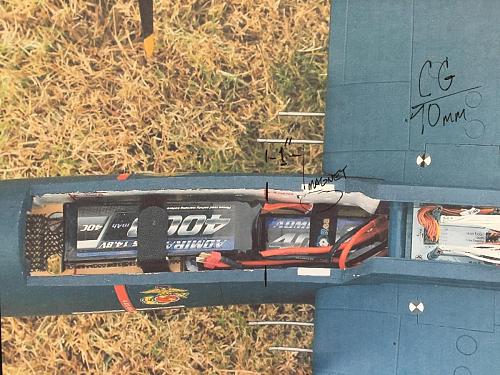

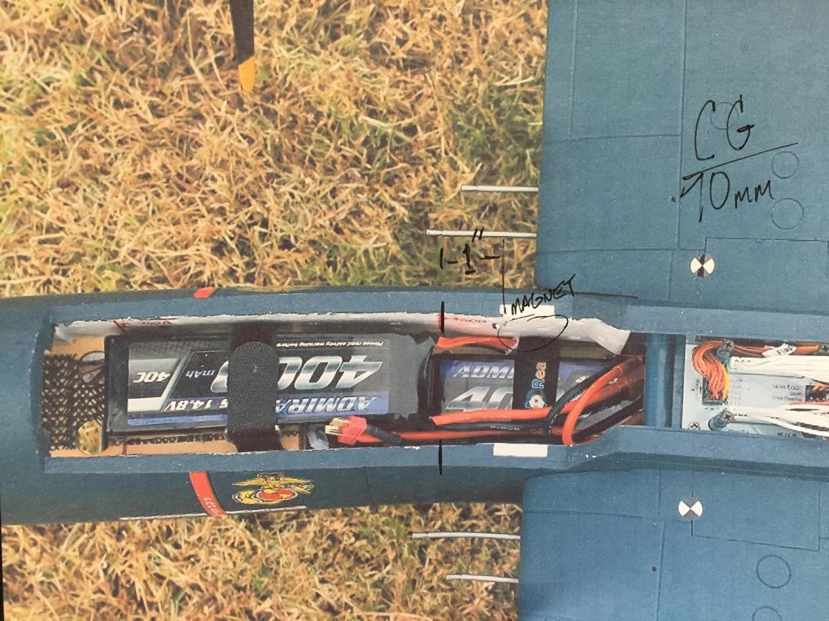

                    My 4000 4s packs just arrived and the test fit worked out to where no shaving was needed for the hatch, now to work out the cg! Woohoo! I'm stoked guys! WHOOA!
                      #110
                      Well I put my batteries as per the flight video with the 4000s where Ryan was setup. And I'm about 1/4 inch on the nose heavy side still, (checking with gear down) so 57mm. So now just trying ideas to get closer to where it needs to be hopefully without adding weight...
                        #111
                        Here's where I have them for 67mm.
                          #112
                          57mm CG.................NO NO NO Rifleman
                          You CG aft swinging gear with gear up first of all, thus when it is down you will have a somewhat nose heavy condition which is OK.........a lot better than a tail heavy bird when retracted.
                          A picture is worth a 1000 words. This is where my flies rock solid.

                            #113
                            That's what I was looking for, thanks for that! :)
                              #114
                              Minor cuts needed to move the battery straps around, but I got it and the cg was on the same point yours was, right at 70mm
